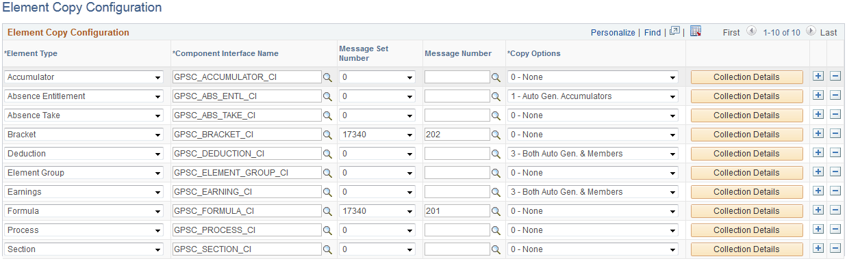

Element Copy Configuration Page
Use the Element Copy Configuration page (GPSC_ECPY_CIDTL) to associate component interfaces with element types that can be copied.
Navigation:
Set Up HCM, and then Product Related , and then Global Payroll & Absence Mgmt, and then Elements, and then Element Copy Configuration
This example illustrates the fields and controls on the Element Copy Configuration page.
Customers cannot edit the setup for the delivered element types.
Field or Control Description
Element Type
Select the type of element that you want to configure for copying.
PeopleSoft Global Payroll and Absence Management delivers element copy configuration for the following element types:
  • Absence Entitlement
  • Absence Take
  • Accumulator
  • Bracket
  • Deduction
  • Earnings
  • Element Group
  • Formula
  • Process (process list)
  • Section
Component Interface Name
Enter the name of the component interface you want to associate with the element type.
Message Set Number
If you want special instructions to display for an element type after copying it, select a value of 17340. Select 0 if no special instructions are required for the element type.
Message Number
If you select 17340 in the Message Set Number, enter the message number corresponding to the special instructions that you want to display when the element type is copied.
Copy Options
Define which copy options are available on the Element Copy page. Options are:
  • 0 - None: Select to make both the Create Auto Gen Accumulator and the Copy Member Elements check boxes unavailable on the Element Copy page.
  • 1 - Auto Gen. Accumulators (auto generated accumulators): Select to make the Create Auto Gen Accumulator check box available on the Element Copy page.
  • 2 - Member Elements: Select to make the Copy Member Elements check box available on the Element Copy page.
  • 3 - Both Auto Gen. & Members (both auto generated accumulators and members): Select to make both the Create Auto Gen Accumulator and the Copy Member Elements check boxes available on the Element Copy page.
Collection Details
Click to access the Component Interface Collection Items Sequence Override Page for an element type.

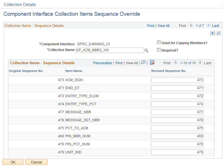

Use the Component Interface Collection Items Sequence Override page (GPSC_ECPYCICOL_SEC) to configure the sequence numbers for collection fields.
Navigation:
Click the Collection Details button on the Element Copy Configuration page.
This example illustrates the fields and controls on the Component Interface Collection Items Sequence Override page.
Use this page to override the sequence numbers defined as part of the component interface (CI) metadata. This is necessary when the collection’s key field is controlled by a non-key field or a derived record field on the PeopleSoft Internet Architecture (PIA) page. In this case, the CI metadata table assigns a lower sequence number for the collection’s key field, but for the purposes of element copying, we need to assign a value to the non-key field first and then to the key field to satisfy the component logic. For example, for a learning element’s supporting element override (SOVR) page, the element type (a non-key field) should be assigned a value first before assigning the supporting element (key field). To control this, it is necessary to configure a sequence number override.
Customers cannot edit the sequence overrides defined for the delivered element types.
Collection Name
Enter the name of the collection for which you want to define sequence numbers.
Used for Copying Members?
Select to designate the collection as being used for copying member elements. When you select this check box, the system automatically selects the Required? check box .
Required?
Select to make it a requirement to copy the collection details from the source element when creating the new element.
Revised Sequence No.
Enter a sequence number for the collection item.

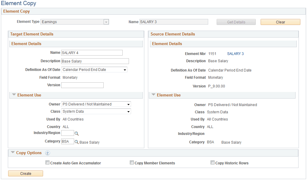

Element Copy Page
Use the Element Copy page (GPSC_ECPY_MAIN) to copy existing elements.

This example illustrates the fields and controls on the Element Copy page.
Element Copy page
Element Type
Select the type of element that you want to copy from the following options:
  • Absence Take
  • Accumulator
  • Bracket
  • Deduction
  • Earnings
  • Element Group
  • Formula
  • Section
Name
Enter the name of the element that you want to copy.
Get Details
Click to display the Source Element Details group box for the element that you are copying, and the Target Element Details group box for the element that you are creating. The Copy Options group box also appears when you click this button.
Clear
Click to remove the selected values from the Element Type and Name fields. When you click this button, the page no longer displays the Source Element Details, Target Element Details, and Copy Options group boxes.
Once the page is cleared, you can enter new values to copy another element.
Displays details for the element that you are copying. You can use these details as an easy reference as you are creating your new element. Click the element name link to access the PeopleSoft Global Payroll: <Element> Name Page, where you can access the full definition of the source element.
Use the fields in this group box to define parameters for the element that you are creating. For more information on defining basic element parameters, see PeopleSoft Global Payroll: Defining Element Names.
Name
Enter a unique name for the new element.
Note: The name you enter here must meet all the existing guidelines for naming an element.
Description
Enter a description for the new element.
Definition As Of Date
Select the date on which the system is to retrieve the element definition during a process run. Options are:
Calendar Period Begin Date: The begin date of the calendar period to which the element is linked.
Calendar Period End Date: End date of the calendar period to which the element is linked.
Payment Date: Payment date of the calendar period to which the element is linked.
Process Begin Date: Begin date of the calendar period in which the element is processed.
Process End Date: End date of the calendar period in which the element is processed.
Selections are limited for some elements. For example, Calendar Period End Date is the only valid option for section elements.
Retroactivity is also a consideration for this field. During recalculation, the system always respects this day and uses the appropriate date based on individual recalculation period calendars.
Field Format
Defines the format for the resolved value. Available values are based on the element type and can include Date, Decimal, Character, Monetary, or Pointer (for calculating generic formulas for a variable).
For some element types, such as earnings and deductions, you cannot change the displayed field format.
Note: The difference between Decimal and Monetary is that Monetary is currency-controlled and requires the entry of a currency code.
Version
You can enter up to 14 alphanumeric characters in this field to identify the element definition. When you save the definition, the system adds a prefix of INT_ to indicate that this is a user-defined value. You can use the Global Payroll utilities to stamp and package elements by version.
Owner
Identifies who controls and maintains the definition of the element. Values are:
Customer Maintained: Identifies the elements that you created. All fields are available for entry. This is the only valid value for customer created elements.
PS Delivered/Maintained: The element is delivered and maintained by PeopleSoft.
PS Delivered/Not Maintained: The element is delivered, but not maintained by PeopleSoft (for example, sample data or statutory data). You can update any editable fields.
PS Delivered/Customer Modified: Indicates that you have taken control of a PeopleSoft-delivered or maintained element.
PS Delivered/Maintained/Secure: The element is delivered and maintained by PeopleSoft. You can edit the name, description, override levels, results, custom fields, and comments (and for system elements, Use as Chartfield and prompt view). Any changes that you make can be overwritten by future PeopleSoft updates.
Class
Indicates the type of rule for the element. Values are:
Customary: Sample rules that are created by PeopleSoft. They are not statutory requirements, but are commonly followed rules. An example of when a customary rule is used is with tariffs. Customary rules are often used in a production environment.
Not Classified.
Sample Data: Rules that are created by PeopleSoft for sample data purposes. They are not used in a production environment.
Statutory: Rules that are created by PeopleSoft for calculating rules that are required by law.
System Data: Rules that are created by PeopleSoft. They are either system elements or system data that are delivered with the application—for example, common constants and dates.
The Class field works with the Owner field to determine the level of support and security.
Used By and Country
Indicate whether the element is used by all countries or a specific country. The new element that you are creating inherits these values from the element that you are copying.
Industry/Region
To classify your element further, select an industry code or region code. You define industry codes on the Industry/Region Types page. If an element is created for a specific industry, select an industry code here. Typical industry codes include Banking, Insurance, and Metallurgy.
Category
To classify your element further, select a category code. Category codes are defined on the Categories page (GP_PIN_CATEGORY).
Copy Options
Create Auto Gen Accumulator (create auto generated accumulator)
Select to generate auto generated accumulators for the new element that are based on the auto generated accumulators defined for the source element.
Note: This check box is not available for all element types.
Select to associate the new element with the accumulator members of the source element.
Copy Historic Rows
Select to copy all of the effective-dated rows of the source element. When this check box is deselected, the system copies only the most recent effective-dated row of the source element.
Create

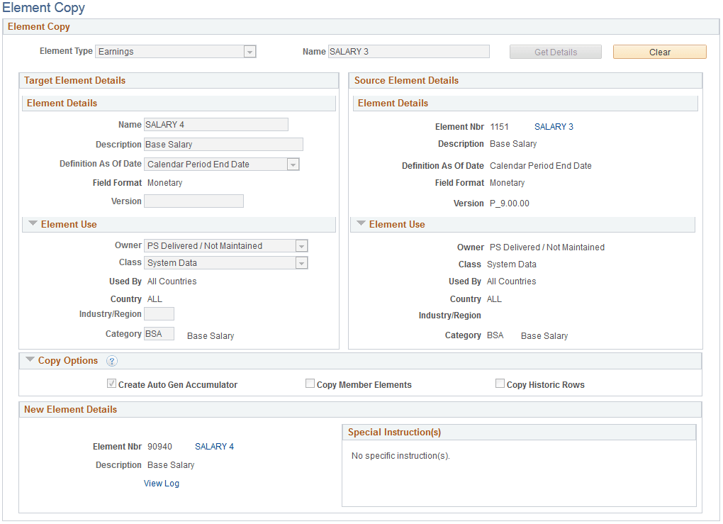

Click to create the new element based on the selected source element. After creating the new element, the New Element Details and Special Instructions group boxes appear at the bottom of the page.
This example illustrates how the Element Copy page appears after you create a copy of an element by clicking the Create button.
Example of the Element Copy page after element copy creation
The New Element Details group box displays the element number, name, and description of the newly created element. Click the element name link to access the PeopleSoft Global Payroll: <Element> Name Page for the new element. Click the View Log link to view detailed information about how the system created the new element.
The Special Instructions group box displays any additional steps you need to take to complete following the creation of the new element. For example, when you create a new formula element, the Special Instructions group box indicates that you must still manually validate the new formula.
