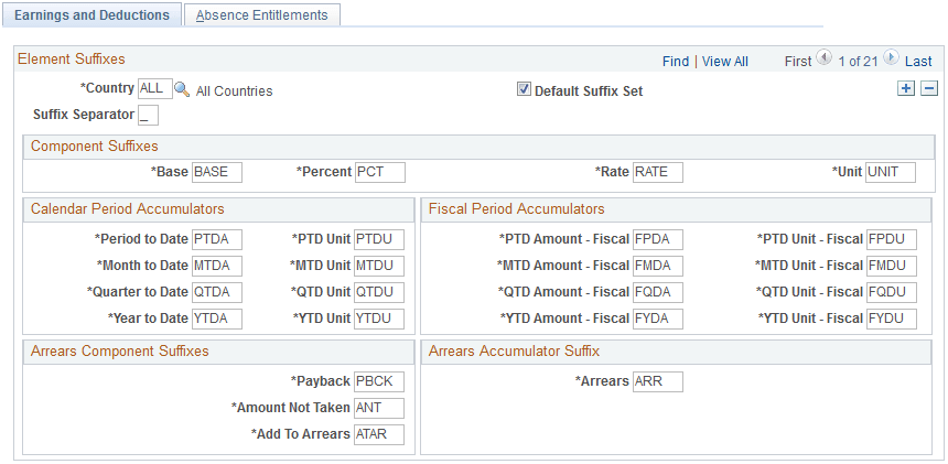

Earnings and Deductions Page
Use the Earnings and Deductions page (GP_SUFFIX1) to define suffixes for earnings and deductions components and accumulators in the base language that you've selected.
Navigation:
Set Up HCM, and then Product Related, and then Global Payroll & Absence Mgmt, and then System Settings, and then Element Suffixes, and then Earnings and Deductions
This example illustrates the fields and controls on the Earnings and Deductions page.
Field or Control Description
Country
Select the country for which you are defining the suffixes.
When you do this, the system populates the fields on the page with predefined suffixes in the correct language for this country. You can change the predefined suffixes.
Default Suffix Set
Select to indicate that these are the default suffixes to use for elements defined as All Countries in the Used By/Country fields on the Element Name page.
Note: If the system can't find a match between the Country field on this page and the Country field on the Element Name page, it uses the default suffix set to name components and auto-generated accumulators.
Suffix Separator
Separates the element name from the component suffix. For example, if you create an earning element defined as EARN1 = Unit x Rate, the system creates three elements: EARN1, EARN1_UN, and EARN1_RT. In this example, the separator is an underscore. You can identify the separator as anything you want, or leave this field blank.
Component Suffixes, Calendar Period Accumulators, Fiscal Period Accumulators, Arrears Component Suffixes, and Arrears Accumulator Suffix
Using the language of the specified country, enter the suffix to be appended to each type of component or automatically generated accumulator.
