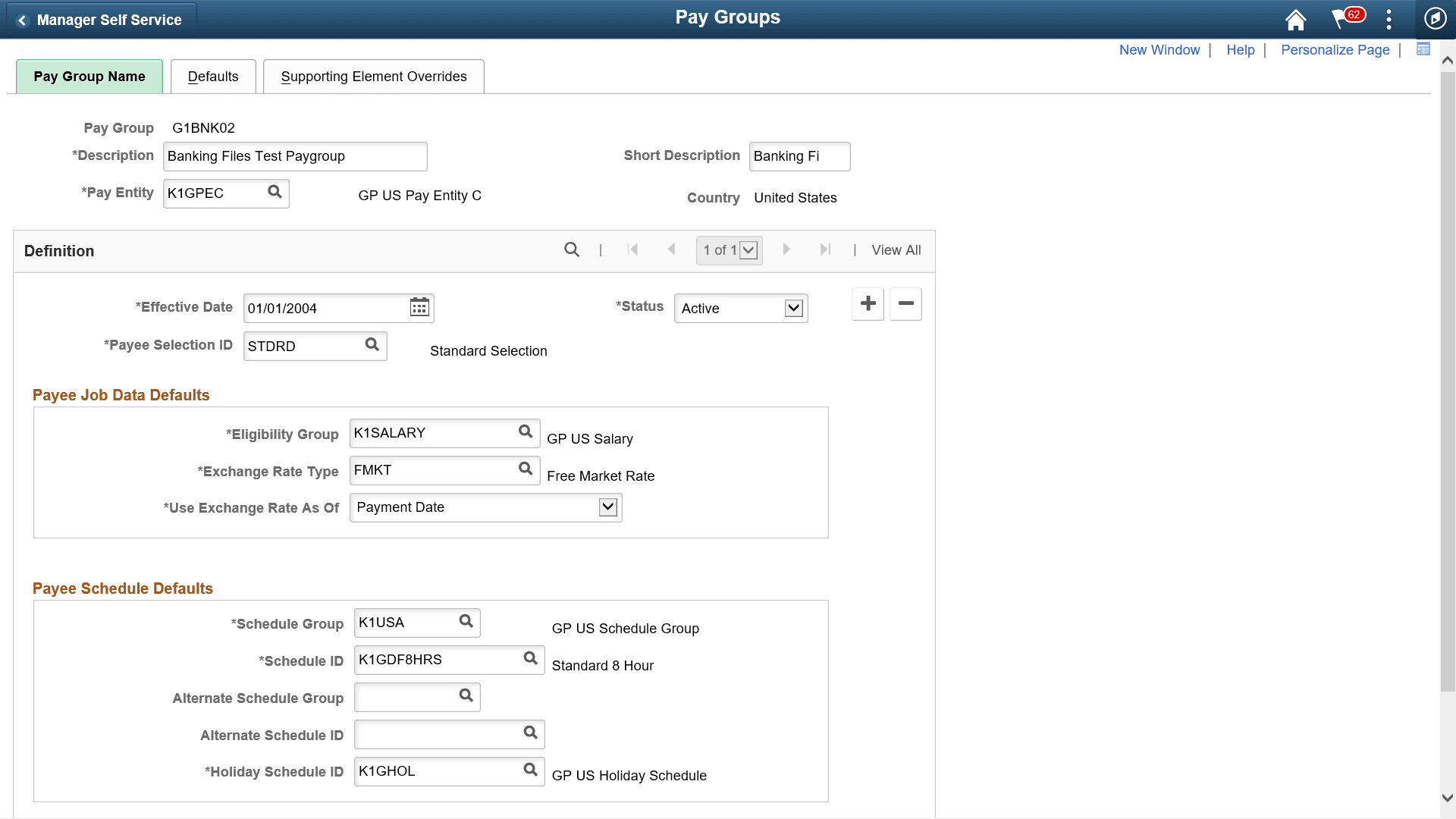

Pay Group Name Page
Use the Pay Group Name page (GP_PYGRP_NAME) to define pay group parameters.
Navigation:
Set Up HCM, and then Product Related, and then Global Payroll & Absence Mgmt, and then Framework, and then Organizational, and then Pay Groups, and then Pay Group Name
This example illustrates the fields and controls on the Pay Group Name page.
Pay Group page
Field or Control Description
Pay Entity
Select the pay entity to associate with this pay group. You can link each pay group with only one pay entity.
WARNING:
Once you've processed a payroll, never change the pay entity. Doing so can corrupt your data.
Payee Selection ID
Select the payee selection criteria to associate with the pay group.
For details, see Defining Payee Selection Criteria.
Payee Job Data Defaults
In this group box, you can define numerous default settings for a pay group. The effective date applies to the entire group box; therefore, you can change these options simultaneously if you have schedule, business process, or rule changes.
Not every payee in a pay group has the same eligibility group, exchange rate type, or holiday schedule. You can override any default for an individual on the Job Data - Payroll page. Defaults can be overridden for certain periods of time through effective-dating. On the Job Data - Payroll page, the Global Payroll group box that includes eligibility group, exchange rate type, and holiday schedule information appears only if you set the Payroll System field to Global Payroll.
See Understanding Payee Data, PeopleSoft Human Resources Administer Workforce: Understanding Job Data.
Eligibility Group
Select the default eligibility group to associate with this pay group.
Apply elements to payees in pay groups through eligibility groups. An eligibility group must be associated with a pay group. A payee is assigned to an eligibility group through the default defined at the pay group level. This default value can be overridden at the payee level.
Note: Payees in an eligibility group are eligible for elements at the payee level, but if a payee isn't in an eligibility group for which an element is valid, that payee cannot be eligible for that element.
Exchange Rate Type
Select the default exchange rate type that's used for currency conversions for this pay group during processing. You can specify an element in a currency other than the processing currency. During processing, it is converted to the processing currency, using this exchange rate information. Define exchange rate types on the Enterprise Components: Market Rate Type Page.
Use Exchange Rate As Of
Select the effective date for use in retrieving the exchange rate. The options correspond to the dates that you associate with this pay group. Values are Pay Period Begin Date, Pay Period End Date, and Payment Date.
Payee Schedule Defaults
Define scheduling defaults for a pay group. Payees can be assigned a work schedule and an alternate work schedule based on the scheduling defaults defined for the payee's pay group.
Schedule Group
Select the schedule group for the pay group. Schedule groups enable you to categorize schedules into specific groups.
Schedule ID
Select the schedule ID for the pay group.
Rotation ID
Select the rotation ID for the selected the schedule ID. Rotation IDs are used with rotating schedules. Rotating schedules can be assigned to several payees with different schedule begin days.
Note: The Rotation ID field only appears if you select a rotating schedule.
Alternate Schedule Group
(Optional) Select an alternate schedule group for the pay group.
Alternate Work Schedule
(Optional) Select an alternate work schedule. A payee can be associated with an alternate work schedule for some absences.
Alternate Rotation ID
(Optional) Select an alternate rotation ID for the pay group.
Note: The Alternate Rotation ID field only appears if you select a rotating schedule.
Holiday Schedule
Select the holiday schedule for the pay group. The pay group's holiday schedule is used in processing if you do not select a different holiday schedule for the payee on the Job Data - Payroll page. However, the pay group holiday schedule is not entered as a default on the payee's Job record.

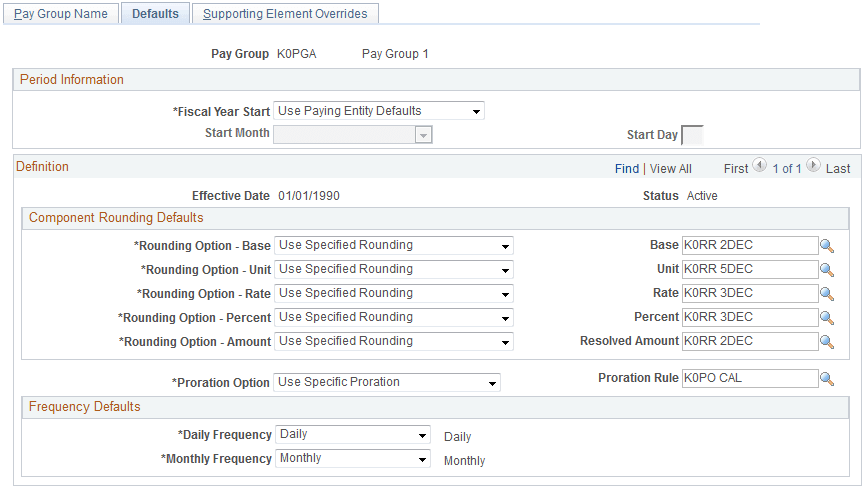

Defaults Page
Use the Defaults page (GP_PYGRP_DFLT) to define default rounding, proration, and frequency conditions for a pay group.
Navigation:
Set Up HCM, and then Product Related, and then Global Payroll & Absence Mgmt, and then Framework, and then Organizational, and then Pay Groups, and then Defaults
This example illustrates the fields and controls on the Defaults page.
Defaults page
Period Information
Define dates for your pay group's fiscal year.
Fiscal Year Start
Define the start date of your organization's fiscal year for this pay group. Values are:
Use Paying Entity Defaults: The next two fields become unavailable.
Use Specified Start Date: Complete the next two fields.
Start Month and Start Day
Enter the first month and the first day of the start month in your organization's fiscal year.
Component Rounding Defaults
Specify default rounding rules for earnings and deductions at the pay group level. You can specify rounding for individual earnings and deductions when those elements are defined or direct the system to follow the pay group default settings.
Rounding Option - Base, Rounding Option - Unit, Rounding Option - Rate, Rounding Option - Percent and Rounding Option - Amount
Select an option to determine whether these components of an earning, deduction, or entitlement element can be rounded before calculation. Values are:
No Rounding: Prevents rounding of the component.
Use Specified Rounding: Enter a rounding rule in the corresponding field on the right.
Resolved Amount
Select the rounding rule to apply to the resolved amount for earnings and deductions.
Rounding occurs after the system resolves the element's calculation rule. Also applies to an earning or deduction element for which the calculation rule is defined as Amount. Values are:
No Rounding: Prevents rounding of the amount.
Use Specified Rounding: Enter a rounding rule in the field on the right.
Proration Option
Select either No Proration or Use Specific Proration.
Proration Rule
If you selected Use Specific Proration in the Proration Option field, enter the proration rule that is to be used as the default proration rule for elements being used to process this pay group. In defining an earning or deduction element, you can have the system use the pay group default value or have it specify a unique rule for a certain earning or deduction element.
Frequency Defaults
Use this group box to define the frequency defaults used in multiple pay calculation components.
The system calculates the daily and monthly pay rates that appear on the Job Data - Compensation page based on the frequency factors associated with the pay group assigned to each payee (on the Job Data - Payroll page). As a result, if you use these corresponding daily and monthly rate system elements directly within your Global Payroll rules, you will need to ensure that the frequency factors associated with the pay group coincide with the values to which you expect these values to resolve. Otherwise, rates may not be in sync (because the system retrieves daily and monthly rates directly from Job Data.)
