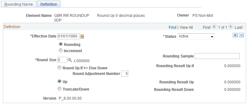

Use the Rounding Rules - Definition page (GP_ROUND_RULE) to define how numeric values are rounded.
Navigation:
Set Up HCM, and then Product Related, and then Global Payroll & Absence Mgmt, and then Elements, and then Supporting Elements, and then Rounding Rules, and then Definition
This example illustrates the fields and controls on the Rounding Rules - Definition page.
Field or Control Description
Rounding
Select to use traditional rounding rules.
Increment
Select to set rounding increments.
When you select this option, the Increment field appears, where you define the incremental value.
Round Size
This field appears when you select the Rounding option. Specify a round size from the list. Values are 01 through 11, or 0 to 5 decimal places.
The example fields on the bottom right half of the page enable you to view examples of each type of rounding.
Round Up if >= Else Down
Select to round up if the result is greater than or equal to the value you enter in the Round Adjustment field, based on the number of digits or decimal places entered. If the result doesn't exceed or equal the value, the result is rounded down.
The default value is 5 for rounding.
If you select the Rounding option, you can enter only one digit in the Round Adjustment field. If you select the Increment option, you can enter a value of up to eight digits. This digit looks at the decimal place to the right of what is being rounded. For example, if you're rounding to the tens (one decimal place), it looks to the hundreds field.
Up
Select to round up, based on the number of digits or decimal places entered. It rounds up if the value to the right of the digits or decimal places specified is greater than zero. The system looks at all the remaining digits or decimal places, not just the next digit.
Truncate/Down
Select to truncate (round down), based on the number of digits or decimal places entered. All digits or decimal places to the right of the number specified are changed to zero, and the rest are truncated.
Rounding Sample
Enter a value to see how the system would round the amount based on your page selections.
