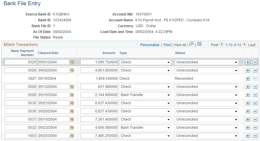

Bank File Entry Page
Use the Bank File Entry page (GP_BNK_FILE_ENTRY) to enter bank transactions manually, if a bank file has not already been loaded using the Component Interface or another method of importing the payment transactions into the bank tables.
Navigation:
Global Payroll & Absence Mgmt, and then Payment Processing, and then Bank File Entry
This example illustrates the fields and controls on the Bank File Entry page.
Field or Control Description
Currency Code
Currency retrieved from the Source Bank ID. This field is display only.
Bank File ID
A unique sequence number assigned whether the bank file is loaded using component interface or manually.
As Of Date
Enter the day on the bank statement or represents the date on the bank file.
Load Date and Time
Defaults to the current date and time when the bank file is entered or loaded through component interface.
File Status
There are three valid values:
Ready: Assigned when the bank file is first entered manually or loaded using the component interface
In Progress: Set if the bank file was previously reconciled and contains exceptions.
Complete: Set when all transactions in the bank file have successfully been reconciled.
Bank Payment Number
Enter the check number or reference for any bank charges or fees.
Cleared Date
Enter the date the checks were presented for payment at the bank. (clear date)
Amount
Enter the check or transaction amount that cleared the bank.
Type
Enter the type of method of payment. Valid Values are Check , Transfer, and Wire.
Status
Enter the status of the transaction. The default value is Unreconciled.
The values that are auto-assigned as result of running the payment reconciliation process are: Unreconciled, Reconciled, Amount Difference, Different Pay Method, Duplicate, and Not Found. The remaining values that are user assigned if there is a manual reconciliation are: Stop Payment, Re-Numbered, Expired, Unclaimed, Void, and Date Difference.
