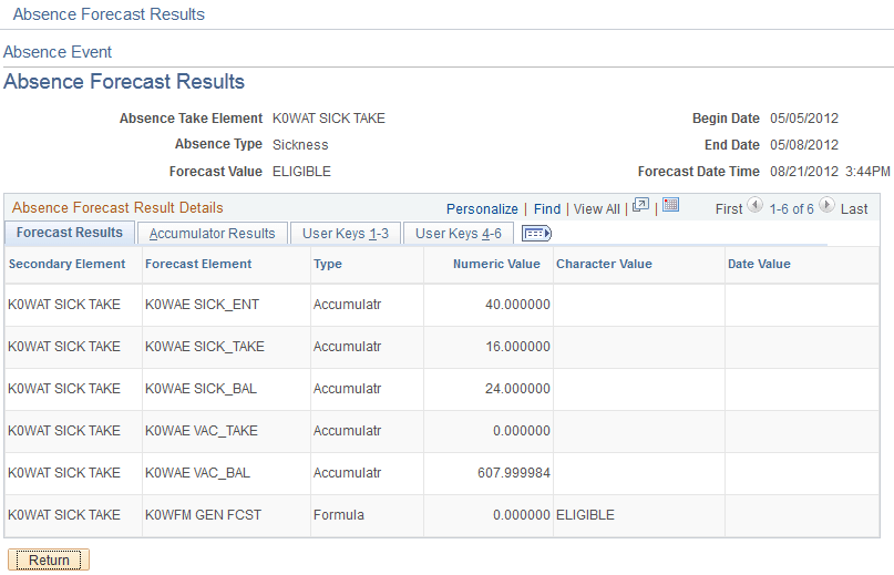

Forecast Results
This tab displays the forecasted value for each element that appears on the Absence Take - Forecasting page, along with related take elements.
Field or Control Description
Secondary Element
Displays the name of the take element that the results pertain to. This can be the take element listed on the Absence Take - Forecasting page, a redirected take element, or a "mapped to" take element that's associated with that take.
Note: You identify redirected take elements on the Take - Negative Balance page and "mapped to" elements on the Absence Take - Day Formula page. Redirected take element can be redirected to other take elements. For example, if A redirects to B, which redirects to C, then C can appear in this field.
Forecast Element Name and Type
Displays the name of the element for which a value has been forecast, followed by its type.
A value displays for each element listed on the Take - Balance Inquiry page.

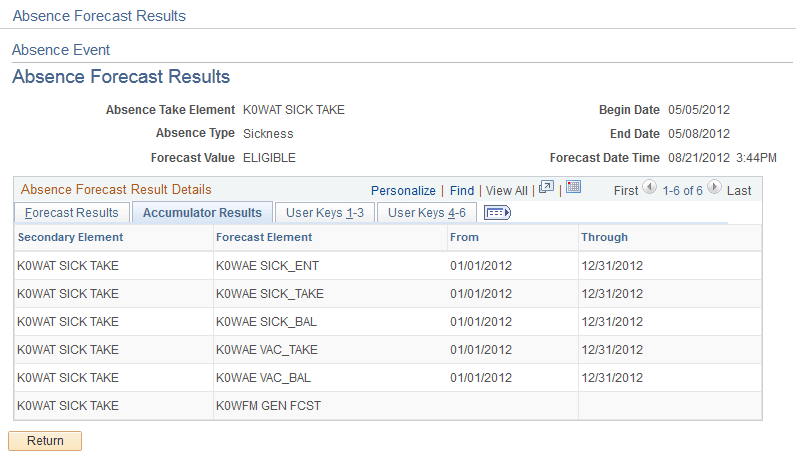

Accumulator Results
Select the Accumulator Results tab.
This example illustrates the fields and controls on the Absence Forecast Results page: Accumulator Results tab.
The begin and end dates of the accumulation period are displayed for any accumulators that are included in the Forecasting Results Element List on the Absence Take - Forecasting page.

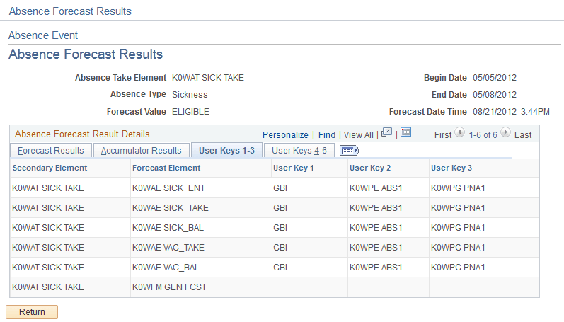

User Keys
Select the User Keys tab.
This example illustrates the fields and controls on the Absence Forecast Results page: User Keys tab.
The values of the accumulator's user keys are displayed for any accumulators that are included in the Forecasting Results Element List on the Absence Take - Forecasting page.

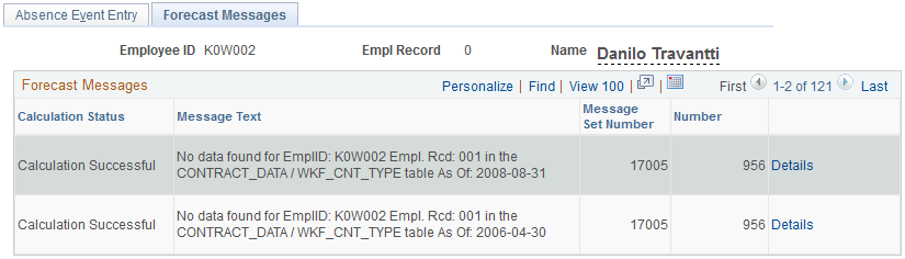

Forecast Messages Page
Use the Forecast Messages page (GP_ABS_FCST_MSG) to review the messages that are generated during the Forecasting process.
Navigation:
Global Payroll & Absence Mgmt, and then Payee Data, and then Maintain Absences, and then Absence Event, and then Forecast Messages
This example illustrates the fields and controls on the Forecast Messages page.
Calculation Status
Identifies the phase of processing during which the error or warning occurred.
Message Text
Displays the abbreviated text of the message and other information about the message.
