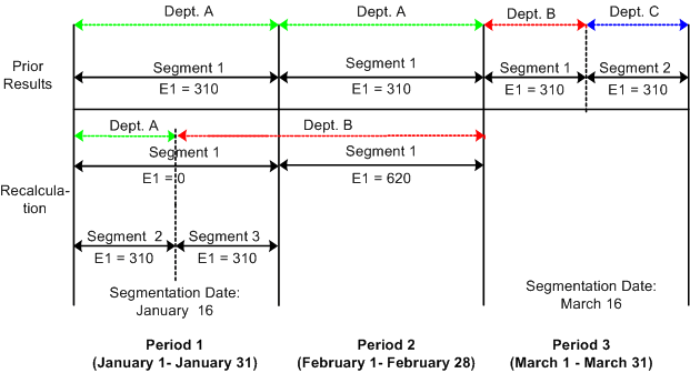

Example 2: Period Segmentation Combined with Retro
The following example of retro with period segmentation illustrates how the system moves retro deltas from a segmented recalc period into a segmented current period, selecting the first slice/segment as the forwarding target using retro matching criteria.
Scenario:
  • Retro in period 3 is back to period 1 due to a change in department ID (from department A to department B) on January 16, which triggered period segmentation in the January recalc calendar (assume that the original period was not segmented).
  • The value of E1 increases from 310 a month to 620 a month in March, retroactive to January 1 (assume that E1 is defined to be prorated).
  • On March 16, the department ID changes from department B to department C. This affects only the current period, resulting in a segmented current calendar.
This diagram below shows an example of period segmentation in both the recalc period and the current calendar; no payment keys are used and retro match criteria are satisfied.
Example of period segmentation in recalc period and current calendar
Period 1 Period 2 Period 3
V1R1
V1R1
V1R1
Segment 1 (January 1 - 31)/Dept. A
E1 = 310
Segment 1 (February 1 - 28)/Dept. A
E1 = 310
Segment 1 (March 1 - 15)/Dept. B
E1 = 930 [310 + (310 + 310)]
Segment 2 (March 16 - 31)/Dept. C
E1 = 310
V1R2
V1R2
E1 (reversal segment) = <310>
Segment 2 (January 1 - 15)/Dept. A
E1 = 310
Segment 3 (January 16 - 31)/Dept. B
E1 = 310
Delta = 310 [(310 + 310) - 310]
Segment 1 (February 1 - 28)/Dept. B
E1 = 620
Delta = 310 (620 - 310)
  • Delta 310 is created in period 1; V1R2 is forwarded to period 3, V1R1, segment 1.
  • Delta 310 created in period 2; V1R2 is forwarded to period 3, V1R1, segment 1.
The system calculates retro deltas for January by summing the deltas for the reversal segment (segment 1) with segments 2 and 3. And when it calculates the deltas for February, it subtracts the value of E1 in V1R1 from E1 in V1R2. The system then pulls the deltas from the January and February recalc periods (310 + 310) into the first segment of the current calendar that satisfies retro matching criteria—that is, segment 1 in the March payroll calendar.

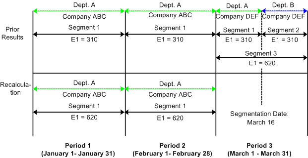

Example 3: Period Segmentation Combined with Retro—Payment Keys Used
The following scenario illustrates how the system handles retro deltas when retro matching criteria have been satisfied, a payment key has been defined (in addition to the standard retro matching criteria), but the payment key of the recalc period does not match that of the current calendar.
Scenario:
  • The value of E1 increases from 310 a month to 620 a month in March, retroactive to January 1. This causes the January and February calendars to be recalculated.
  • On March 1, the payee transfers from company ABC to company DEF. Company ID is defined as a payment key.
  • On March 16, the department ID changes from department A to department B. This affects only the current period, resulting in a segmented current calendar.
This graphic is an example of a company defined as a payment key.
Example of company defined as a payment key (retro match criteria are satisfied)
V1R1
V1R1
V1R1
Segment 1 (January 1 - 31); Dept. A, Company ABC
E1 = 310
Segment 1 (February 1 - 28); Dept. A, Company ABC
E1 = 310
Segment 1 (March 1 - 15); Dept. A, Company DEF
E1 = 310
Segment 2 (March 16 - 31); Dept. B, Company DEF
E1 = 310
Segment 3 (March 1 - 31); Dept. A, Company ABC
E1 = 620 (310 + 310)
V1R2
V1R2
E1 = 620
E1 = 620
  • Delta 310 is created in period 1; V1R2 is forwarded to period 3, V1R1, segment 3.
  • Delta 310 is created in period 2; V1R2 is forwarded to period 3, V1R1, segment 3.
When the system first calculates the retro deltas for January and February, it tries to pull them into the first segment of the current calendar (March) based on retro matching criteria. However, these deltas were generated for a payee in company ABC, and the payee is now in company DEF (there was a company transfer on March 1). Because Company is defined as a payment key, the deltas cannot be forwarded to the first segment of the current calendar (March) even though all other retro matching criteria have been satisfied. Therefore, the system creates a separate segment with the same begin and end dates as the March pay period and moves the deltas into the new segment.
These examples refer only to forwarding retro because only forwarding retro generates adjustments to be processed in the current period—unless your method is corrective, and you have defined elements to be forwarded. In the case of corrective retro combined with segmentation, the system calculates retro deltas as it does in the above examples. However, unlike forwarding retro, recalculated values for the elements replace the previous calculation. Differences between the net pay from the previously calculated period and the recalculated period are processed by banking.
