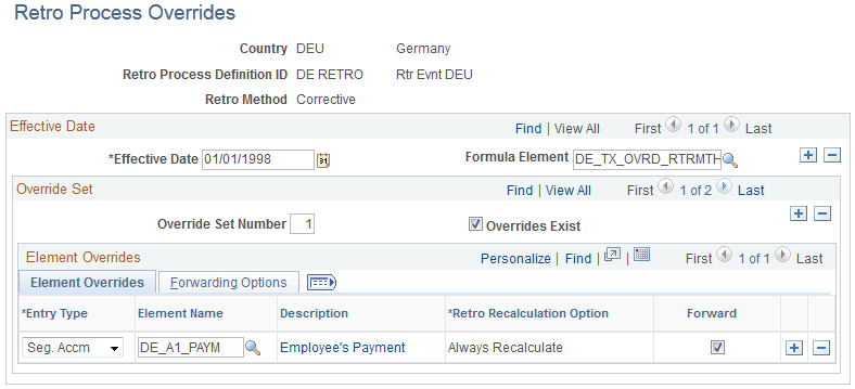

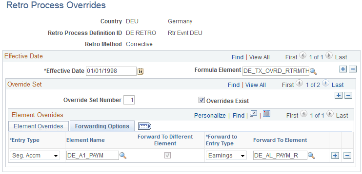

Retro Process Overrides Page
GP_RTO_OVR_DEFN
  • Specify the elements that are to be forwarded when the standard retro method is forwarding.
  • Define overrides to the standard corrective retro method.
  • Override the Retro Recalculation Option defined on the earning and deduction definition pages.

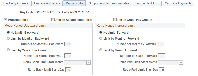

Retro Limits Page
GP_PYENT_RETRO
  • Define the backward and forward limits for retro processing at the pay entity level.
  • Override pay group matching criteria for unprocessed retro deltas.
  • Enable the retention of accumulator balances during retro processing.

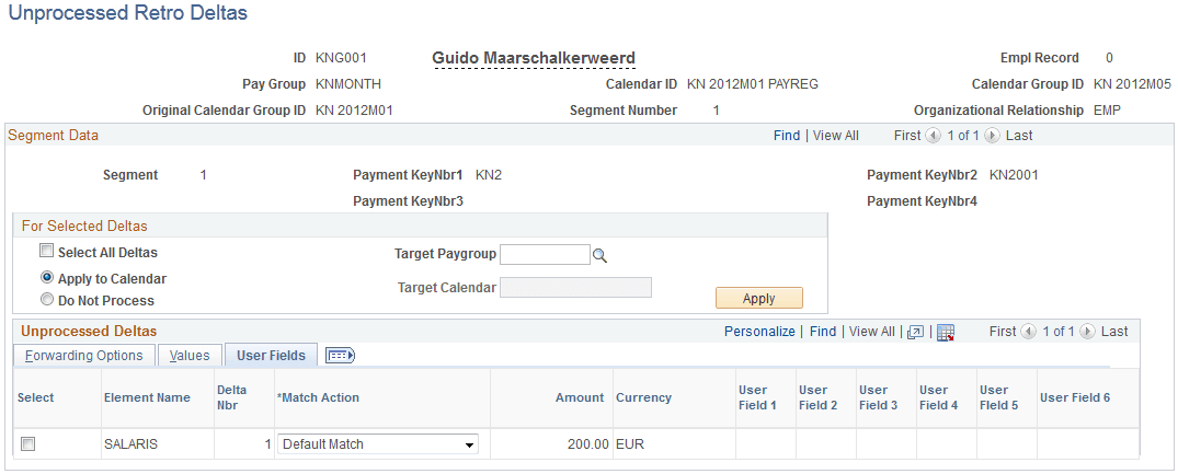

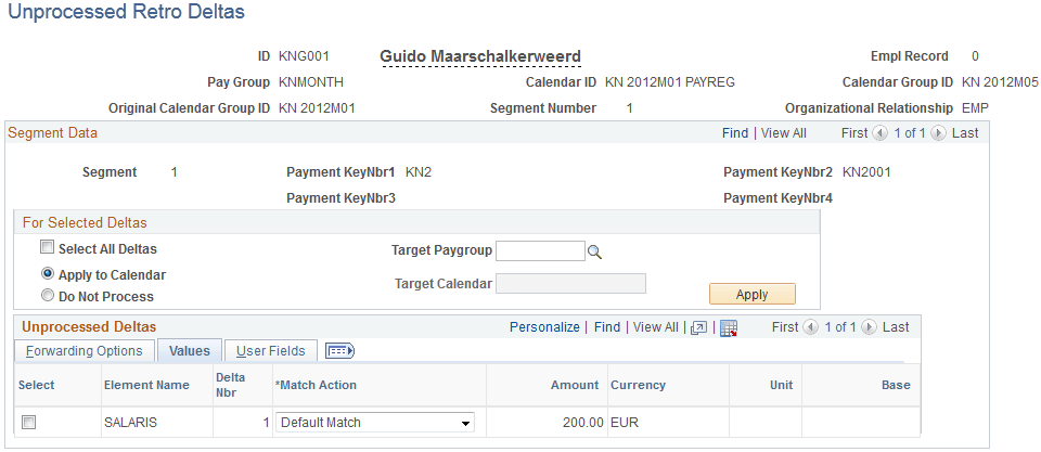

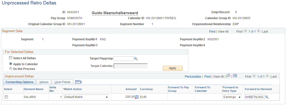

Unprocessed Retro Deltas Page
GP_UDELTA
Manage unprocessed retro deltas.

  3. Select elements to be forwarded, and set up overrides to the corrective method.
    If the default retro method is forwarding, use the Retro Process Overrides page to individually select elements to forward. Global Payroll does not assume that every element in a process list should be forwarded—even when the default method is forwarding.
    If the default retro method is corrective, but you want to forward certain elements, identify the elements to forward on the Retro Process Overrides page.

  6. Determine which pay entities allow retroactive processing.
    Use the Pay Entity Retro Limits page to enable retroactive processing of calendars in a pay entity.
  7. Specify backward and forward limits.
    There are two pages on which you can set backward and forward limits:
    • Use the Pay Entity Retro Limits page to establish default backward and forward limits for retro processing (optional). This tells the system how far back in time to go to recalculate closed calendars that are associated with a pay entity, and how long after a payee becomes inactive he/she is eligible for retro processing.
    • If necessary, override the default backward and forward limits for specific payees using the Assign Retro Limits page.

  9. Manage unprocessed retro deltas.
    During forwarding retro—or when using corrective retro with forwarding exceptions—the system forwards deltas from the recalculated calendar as adjustments to the current calendar when certain conditions (matching criteria) have been met. If forwarded retro deltas cannot be processed because the default matching criteria are not met, you can manually direct the deltas to an appropriate calendar by using the Unprocessed Retro Deltas page.
Use the Retro Process Overrides page (GP_RTO_OVR_DEFN) to .
Navigation:
Set Up HCM, and then Product Related, and then Global Payroll & Absence Mgmt, and then Triggers, and then Retro Process Overrides
This example illustrates the fields and controls on the Retro Process Overrides.
Understanding Rules for Forwarding Elements and Defining Overrides to Corrective Retro
If your retro method is forwarding, you must individually select elements to be forwarded on the Retro Process Overrides page. Global Payroll does not assume that every element in a process list should be forwarded—even when the retro method is forwarding.
If your default method is corrective, but you want certain elements to be forwarded, you must specify the elements you want forwarded on the Retro Process Overrides page.
Defining Elements to Be Forwarded (when the retro method is forwarding):
If your default retro method is forwarding:
  • Specify each element that is to be forwarded (on the Retro Process Overrides page).
  • The only types of elements that can be forwarded are earnings, deductions and accumulators. (Only deltas from segment accumulators can be forwarded.)
  • If an element is an earning or a deduction, you can either forward the value of the element's retro delta to the same element, or define a separate "Forward To Element" to receive this value.
  • When you forward the delta for an earning, the "Forward To Element" can be an earning or a deduction.
  • When you forward the delta for a deduction, the "Forward To Element" can be an earning or a deduction.
  • If you forward a segment accumulator, you cannot forward it to the same element (or even a different accumulator) because a segment accumulator can be forwarded only to an earning or a deduction.
  • If the forwarded element contains components and is forwarded to a different element, the component adjustments will be applied only if the "Forward To Element" calculation rule is the same. For example, if the element is defined as Percent of Base and the "Forward To Element" is defined as a Percent of Base, then the differences for the amount and the base are forwarded. If the "Forward To Element" does not obey the same rule, then only the adjustment amount is forwarded.
With forwarding retro, you can define balance accumulators to behave in a corrective manner at the accumulator definition level and on the Earning/Deduction Accumulators pages.
Defining Overrides to Corrective Retro:
If your default retro method is corrective, but you want to forward the delta for a specific element (that is, you want to override the default method for this element):
  • You must forward the retro delta to a different element by designating a "Forward To Element" on the Retro Process Overrides page. This element receives the value of the element's retro delta in the current period. However, you must have already defined the element on one of the element definition pages.
    You cannot forward a retro delta to the same element if your method is corrective.
  • When you are forwarding the delta for either an earning or a deduction, the "Forward To Element" can be either an earning or a deduction.
  • When you are forwarding the delta for an accumulator (only segment accumulators can be forwarded), the "Forward To Element" must be an earning or a deduction (it cannot be another accumulator).
  • If the forwarded element contains components and is forwarded to a different element, the component adjustments are applied only if the "Forward To Element" calculation rule is the same. For example, if both the element and the "Forward To Element" are defined as Percent of Base, then the differences for the amount and the base are forwarded. If the "Forward To Element" does not follow the same rule, then only the adjustment amount is forwarded.
  • If you forward the Net Pay element, banking will not reverse the net pay element from the prior calculation, nor will it insert the new recalculated net pay entry.
Common Page Elements
Field or Control Description
Retro Process Definition ID (retroactive process definition ID)
Identifies the retro process you defined using the Retro Process Definition page.
Retro Method
This is the default retro method that you associated with the selected Retro Process Definition for the country that appears at the top of the page. If you selected Retro Method Varies on the Retro Process Definition page, you must select a method to access the Retro Process Overrides page.
Effective Date
This is the effective date of the overrides that are part of your retro process definition. Different overrides can apply at different times (depending on the effective date).
Formula Element
This formula determines which set of overrides to use if multiple overrides are effective on the same date. When this formula is resolved, the value that it returns must match one of the values in the Override Set Number field. For example, your formula might specify that if condition A is met, return 10; if condition B is met, return 20; and if condition C is met, return 30. Each number corresponds to a different set of overrides. So if condition A is met, the formula returns a value of 10, and the system uses the overrides that you defined as part of override set number 10.
Override Set Number
This number identifies the set of overrides to be applied to your retro process definition (and country) at a specific point in time. You can define different sets of overrides with the same effective date and use the formula that you selected in the Formula Element field to determine which set to apply.
Overrides Exist
Select if overrides are associated with the Override Set Number. Specify the overrides in the Element Overrides group box.
Element Overrides
Select the Retro Process Overrides - Element Overrides tab.
Entry Type
Enter the type of element for which you want to override the default retro method. Values are:
Deduction
Earnings
Seg. Accm (segment accumulator): Only segment accumulators are listed in the Element Name column.
Element Name
Select the elements for which you want to define overrides. The elements listed are those that you defined on the earning and deduction definition pages.
Indicate whether you want the element to be recalculated during retroactive processing. Values are:
Always Recalculate: Recalculates the element during retro.
Do Not Recalculate: Does not recalculate the element during retro.
Use Element Definition (the default): Tells the system to go to the element definition to determine whether to recalculate the element.

Forwarding Options
Select the Retro Process Overrides - Forwarding Options tab.
This example illustrates the fields and controls on the Retro Process Overrides - Forwarding Options tab.
Forward to Different Element
Select to forward the value of an element to a different element in the current period.
  • If your default method is forwarding, and you specify an element to be forwarded, that element is forwarded to itself unless you select this check box and specify a "Forward To" element.
  • If your default method is corrective and you decided to forward an element, this check box is selected, and you must define the element to receive the value of the original element.
  • If a segment accumulator is selected, this check box is selected automatically and is unavailable for entry.
Forward to Entry Type
This is the type of element that is to receive the value of the original element in the current period when you select Forward to Different Element. Values are Deduction and Earnings.
Forward to Element
Select the name of the "Forwarded To" element that will receive the value of the original element.

Retro Limits Page
Use the Retro Limits page (GP_PYENT_RETRO) to .
Navigation:
Set Up HCM, and then Product Related, and then Global Payroll & Absence Mgmt, and then Framework, and then Organizational, and then Pay Entities, and then Retro Limits
This example illustrates the fields and controls on the Retro Limits page.
Retro Limits page
After you have defined a retro method and the events that trigger retro processing, you must specify the backward and forward limits for retro processing at the pay entity level. This tells the system how far back in time to go to recalculate closed calendars, and how long a payee is eligible for retroactive processing after being inactivated or terminated.
You can override backward and forward limits you define at the pay entity level using the Pay Entities - Retro Limits Assignment page at the payee level.
Retro Period Backward Limit
Use the fields in this group box to limit the number of calendar periods that Global Payroll can reprocess going into the past.
To determine how far back to go, the system compares the backward limit defined on the Retro Limits page to the retro trigger effective date. If the trigger effective date comes before the backward limit date, the system uses the backward limit date to determine the first retro period. If the backward limit date comes before the trigger effective date, the system uses the trigger date to determine the first retro period to process.
Process Retro
Select to enable retroactive processing at the pay entity level. You can override your selection at the payee level.
Accum Adjustments Persist(accumulator adjustments persist)
Select to retain adjustments to accumulator balances when retroactive processing causes an accumulator to be recalculated in a prior period. This option may be needed because Global Payroll does not automatically include adjustment amounts when recalculating accumulator balances. For example, if you select this check box and reprocess a prior period in which an accumulator with a value of 1000 received an adjustment of 100, the system computes the incoming balance as the sum of the original accumulator and the user-entered adjustment, and returns a value of 1100. Otherwise, the system ignores the adjustment and returns a balance of 1000.
Note: The preferred approach to managing accumulator balances is to correct the elements (earnings, deductions, entitlements, or takes) that contribute to the accumulator, rather than to adjust the accumulator directly. This is because other accumulators that store period-to-date amounts or other values based on the calculation of the same elements will not be automatically updated, possibly resulting in calculation or reporting errors.
Note: To adjust accumulator balances, use the Adjust Accumulator Balance page.
See Adjusting Accumulator Balances.
Deltas Cross Pay Groups
By default, this check box is deselected and the system applies standard matching criteria to determine whether to forward retro deltas when the retro method if forwarding. In other words, the system forwards retro deltas only if:
  • The pay group of the deltas that are to be forwarded matches the pay group of the current calendar.
  • The pay entity of the deltas that are to be forwarded matches the pay entity of the current calendar.
  • The run type of the deltas that are to be forwarded matches the run type of the current calendar.
    You can override this criteria so that the system automatically forwards retro deltas when the current period run type does not match the run type of the deltas by listing additional run types in the Retro Adjustment Sources group box of the Run Types page. However, all other matching criteria must still be met.
    See Defining Run Types.
  • The process order timestamp of the retro deltas precedes the process order timestamp of the current Pay Process Stat record.
To override the requirement that the pay group of the forwarded deltas match the pay group of the current calendar, select the Deltas Cross Pay Groups check box. The system will then automatically forward deltas to non-matching pay groups.
Note: If you do not select Deltas Cross Pay Groups and a retro delta cannot be forwarded due to a pay group mismatch, you can manually select the pay group to which to forward the delta on the Unprocessed Retro Deltas page. Similarly, if a delta cannot be forwarded because the run type of the delta does not match the run type of the current calendar (or you have not added the current calendar run type to the list of valid run types on the Run Types page), you can manually forward the retro delta to a calendar with the correct run type on the Unprocessed Retro Deltas page.
Note: The only matching criteria you can override are pay group and run type matching criteria. You cannot override pay entity matching or process order timestamp criteria: if the pay entities do not match or the process order timestamp of the retro deltas does not precedes the process order timestamp of the current Pay Process Stat record, you cannot forward deltas either automatically or manually.
See Unprocessed Retro Deltas Page.
No Limit - Backward
If you select this option, retro processing begins with the first period that includes the trigger effective date and goes forward.
Note: Selecting this option does not mean that there are no limits to how far back you can go. The No Retro Processing Before date limits how far back in time you can go to process retroactivity.
See Setting Backward and Forward Retro Limits.
Limit by Months - Backward and Number of Months - Backward
To define a limit in months, select this option and enter the number of months that the system can calculate into the past. The system determines the maximum number of months to go back starting from the begin date of the first calendar in the current calendar group for the payee.
Limit by Years - Backward and Number of Years - Backward
To define a limit in years, select this option and enter the number of years that the system can calculate into the past. The limit year, in conjunction with the Retro Back Limit Start Month and Retro Back Limit Start Day fields, determines how far back the system can go when processing retroactivity.
For example, if Number of Years - Backward is 2, Retro Back Limit Start Month is 06 (June), Retro Back Limit Start Day is 01, and the current period begin date is April 1, 1999, then the backward limit is June 1, 1997. The system allows retroactivity 2 years from the current period begin date, but not prior to June 1 of that year.
Select the calendar month to use as the backward limit.
Select the day to use as the backward limit.

Retro Period Forward Limit
Use the fields in this group box to specify the amount of time that retroactive data can continue to be processed after a payee is terminated or becomes inactive.
Process Retro
This field determines whether the pay entity allows retroactivity to be processed. You can override your selection at the payee level.
No Limit - Forward
If you select this option, retroactive data can be processed indefinitely for inactive payees belonging to this pay entity. Although eligible for retro processing, the inactive payee is still restricted by the backward limits.
Limit by Months - Forward and Number of Months - Forward
To define the forward limit in months, select this option and enter the number of months to continue calculating retroactivity after a payee becomes inactive. The system determines the maximum number of months using the Inactive date of the last active job.
Limit by Years - Forward and Number of Years - Forward
To define the forward limit in years, select this option and enter the number of years beyond the inactive date to process retro. The year, in conjunction with the Retro Fwd Limit Start Month and Retro Fwd Limit Start Day, determines how long after the inactive date the system allows retroactive processing.
Retro Fwd Limit Start Month (retro forward limit start month)
Enter the calendar month to use as the forward limit in conjunction with the year in the Number of Years - Forward field.
Retro Fwd Limit Start Day (retro forward limit start day)
Enter the day to use as the forward limit in conjunction with the year and month entered in the Number of Years - Forward and Retro Fwd Limit Start Month fields. For example, if the Number of Years is 2, the Retro Fwd Limit Start Month is 06 (June), the Retro Fwd Limit Start Day is 01, and the termination date is January 1, 1999, the limit for processing retroactivity would be June 1, 2001. In this example, the system knows to allow retroactivity for 2 years from the Inactive date, but not after June 1 of that year.

Use the Unprocessed Retro Deltas page (GP_UDELTA) to manage unprocessed retro deltas.
Navigation:
Global Payroll & Absence Mgmt, and then Absence and Payroll Processing, and then Prepare Payroll, and then Unprocessed Retro Deltas
This example illustrates the fields and controls on the Unprocessed Retro Deltas page.
Matching Criteria: Managing Unprocessed Retro Deltas
During forwarding retro—or when using corrective retro with forwarding exceptions—the system automatically forwards adjustments from the recalculated calendar to the current calendar when the following matching criteria have been met:
For each EmplID (employee ID)/Empl Record (employee record number) combination:
    You can override this requirement by selecting the Deltas Cross Pay Groups option on the Retro Limits page. If you do this, the system automatically brings retro deltas into the current period even if the pay group associated with the deltas does not match the payee's current pay group. However, all other matching criteria must still be met.
    See Retro Limits Page.
    You can override this requirement by entering additional run types in the Retro Adjustments Sources group box on the Run Types page. If you do this, the system automatically brings retro deltas into the current period for those run types that have been associated with the payee's current run type. However, all other matching criteria must still be met.
    See Defining Run Types, Retro Limits Page.
  • If these conditions are not met, you can use the Unprocessed Retro Deltas page to manually forward adjustments to the appropriate target calendar from the source calendar that generated the retro deltas. On this page you:
    • Specify the calendar ID and pay group of the target calendar (the target pay group must have the same pay entity as the source calendar).
    • Redirect the deltas to another element (optional).
    • Mark the deltas as do not process (if you do not want them to be forwarded at all).
Example: Manually Forwarding Retro Deltas
Suppose that a payee moves from pay group A to pay group B at the beginning of the current period, and that previous periods must be recalculated due to retroactivity. The current calendar for pay group B no longer matches the original calendar from which adjustments are being retrieved (pay group A). In situations like this—when pay groups no longer match—you must tell the system where to forward (target) the retro deltas.
Segment Data
The fields in the Segment Data group box enable you to identify the source pay group, calendar ID, calendar group ID, and payment keys of the unprocessed retro deltas.
Pay Group
Pay group that is associated with the payroll run from which the unprocessed retro deltas originated.
Calendar ID
Calendar that is associated with the payroll run from which the unprocessed retro deltas originated.
Calendar Group ID
Calendar group that is associated with the payroll run from which the unprocessed retro deltas originated.
Payment Key#1 . . . Payment Key#4
Values of payment keys 1 through 4.
For Selected Deltas
In this group box, specify an action for unprocessed retro deltas.
Select All Deltas
Select this check box and click the Apply button to select all rows of deltas in the Unprocessed Deltas group box. Then deselect the check box for any row that you do not want to be included after you select the Apply to Calendar option.
Apply to Calendar, Target Pay Group, and Target Calendar
If you select Apply to Calendar, the retro delta is pulled into the Target Pay Group and Target Calendar you enter in the fields to the right. This action overrides normal calendar matching.
In the Target Pay Group field, select the target calendar pay group for the retro deltas. You can select from the pay groups that have the same pay entity as the source calendar.
In the Target Calendar field, select the target calendar ID for the deltas. You can select from the open calendars associated with the targeted pay group.
Do Not Process
When you select this option, the unprocessed retro deltas are not pulled into any calendar as a retro adjustment. Once saved by the user, these deltas are marked as processed and no longer appear on the page.
Apply
When you click Apply, all the retro deltas in the Unprocessed Deltas group box are selected. The Match Action field in the Unprocessed Retro group box will be populated with the action that you specify in the For Selected Deltas group box.

Forwarding Options
Select the Unprocessed Retro Deltas - Forwarding Options tab.
Forward to Pay Group
Displays the pay group values that have the same pay entity as the source calendar. Select the pay group to which you want to target the deltas.
Forward to Calendar
Displays the open calendars that are associated with the selected pay group. Select the calendar to which you want to target the deltas.
Values are Earnings and Deductions.
Forward to Element Name
This field displays values based on the entry type selected in the previous field. Here you can redirect the deltas to a different element.

Select the Unprocessed Retro Deltas - Values tab.
This example illustrates the fields and controls on the Unprocessed Retro Deltas - Values tab.
Unit
This value is a component of the element.
Base
This value is a component of the delta amount for the element.
User Fields
Select the Unprocessed Retro Deltas - User Fields tab.
This example illustrates the fields and controls on the Unprocessed Retro Deltas - User Fields tab.
This tab displays the user fields defined for each element.
