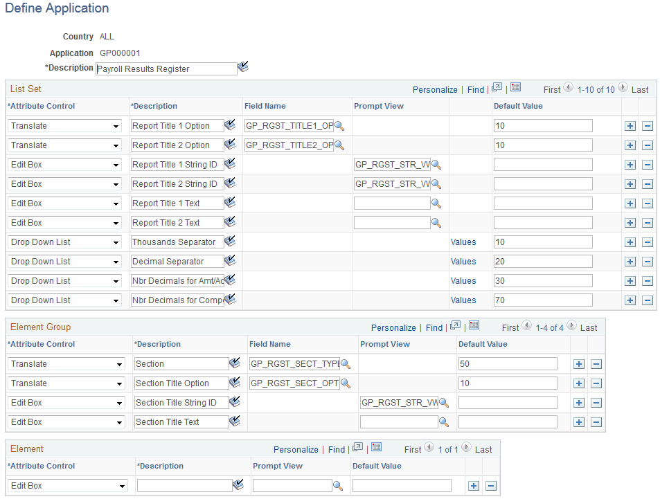

Define Application Page
Use the Define Application page (GP_ELN_APP) to define attributes attached to a list set, an element group, or an element.
Navigation:
Set Up HCM, and then Product Related, and then Global Payroll & Absence Mgmt, and then Elements, and then Define Application
This example illustrates the fields and controls on the Define Application page.
PeopleSoft delivers an application of GP000001 with a country of ALL (shown in the preceding exhibit), designed to work in conjunction with the Payroll Results Register report. You should not modify this delivered application. Link this delivered application with a list set of your choosing, and use it to control the format of the Payroll Results Register report and the data that it contains.
See Reporting Payroll Data.
There is no minimum number of attributes required for each level (represented by the three group boxes). An application definition can be created without specifying attributes. This may be done for applications for which you intend to use the list set solely to group multiple element groups. There is a maximum of ten attributes for each level.
Attributes defined at the list set level apply to all of the element lists in the set.
