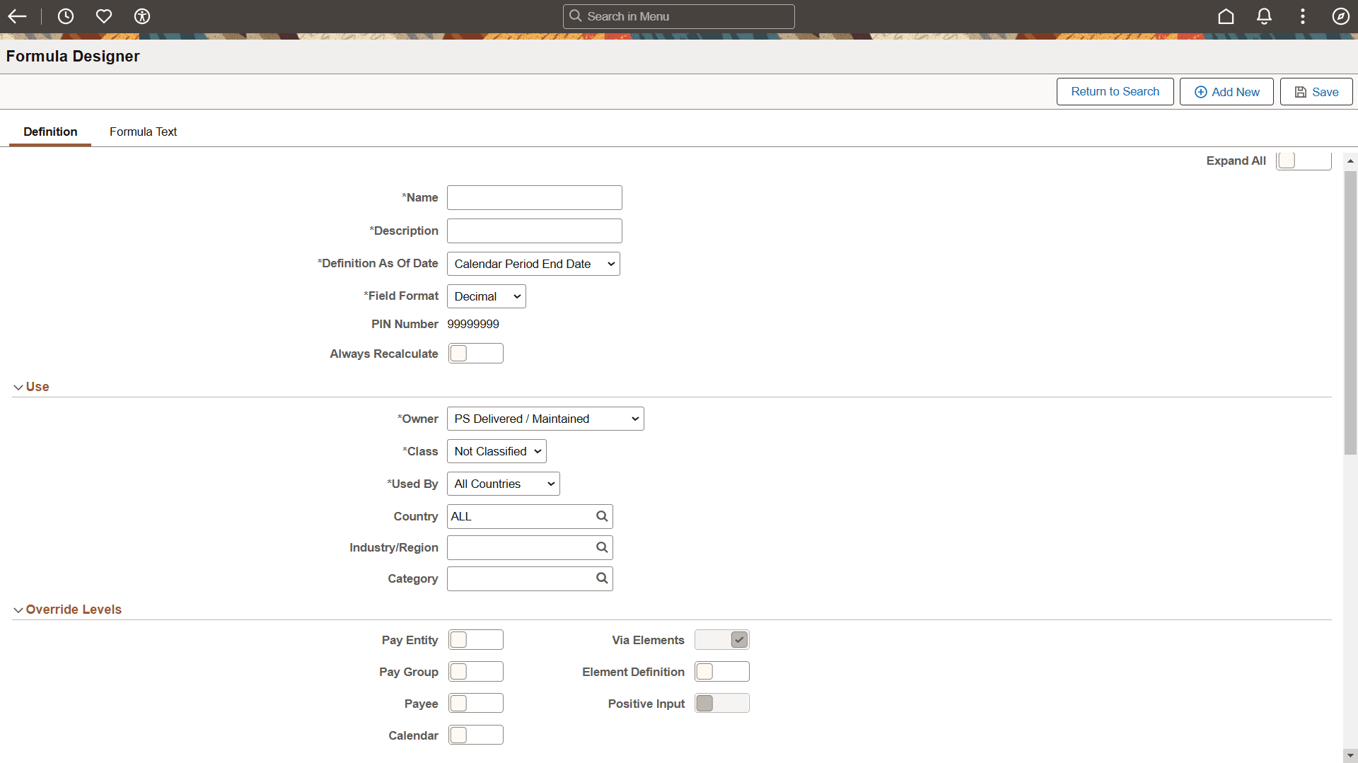

Formula Designer - Definition Page
Use the Formula Designer - Definition page (GP_FRML_MAIN_FL) to name the formula element and define its basic parameters.
Navigation:
Set Up HCM, and then Product Related, and then Global Payroll & Absence Management, and then Elements, and then Supporting Elements, and then Formula Designer, and then Add New
This example illustrates the fields and controls on the Formula Designer - Definition page (1 of 2).
Formula Designer Definition page 1
This example illustrates the fields and controls on the Formula Designer - Definition page (2 of 2).
Formula Designer Definition page 2
Field or Control Description
Name
Enter the formula element name.
Description
Enter a meaningful description for the formula element.
Definition As of Date
Select the date on which the system is to retrieve the element definition during a process run.
Available options are:
  • Calendar Period Begin Date: The begin date of the calendar period to which the element is linked.
  • Calendar Period End Date: End date of the calendar period to which the element is linked.
  • Payment Date: Payment date of the calendar period to which the element is linked.
  • Process Begin Date: Begin date of the calendar period in which the element is processed.
  • Process End Date: End date of the calendar period in which the element is processed.
Field Format
Select the required format for variables.
  • Character: The field length for variables with a character field format is 30 spaces.
  • Date
  • Decimal: The field length for variables with a decimal field format is 12.6
  • Monetary: The field length for variables with a monetary field format is 12.6.
Note: When you assign a value to a variable either directly or by means of another element (for example, an array), consider whether the variable can support the assigned value in terms of field length and field format. For example, 50 characters of text should not be assigned to a character variable with a field length of 30 spaces. Similarly, a monetary value should not be assigned to a variable with a character format.
PIN Number
Displays the pin number of formula element.
Always Recalculate
Applies only to the period of time that is being resolved and is selected by default. If selected, the system recalculates the element every time that it encounters it in the calculation process. If this check box is clear, the system uses the previous resolved value of the element.

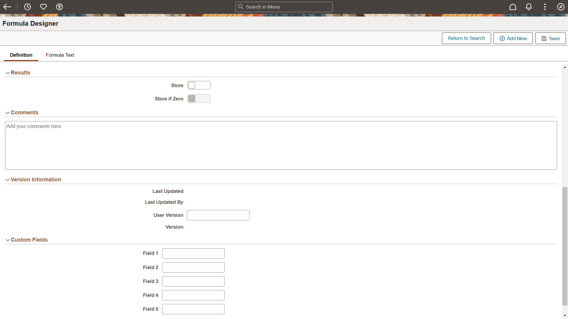

In this group box, you specify when to store the resolved value of the element in the result tables. The options vary by element type.
Select these options with caution to avoid creating large tables that are difficult to manage. Consider storing only the values that you need for reporting and auditing purposes or for retroactivity or other situations where you need to refer to the prior value of an element.
Store
Select to store the resolved value of the element in the result table during processing. For certain element types, you can specify the conditions under which the value is stored by selecting an option below the check box.
When Store is clear, the resolved value is never stored.
Store if Zero
Appears for all element types except earnings and deductions. You cannot select this check box without first selecting Store.
The Store if Zero check box is a way to further define what is sent to the results tables.
Select Store if Zero to store a resolved value even when the value is 0.
If you select Store but not Store if Zero, the element is written to the result tables only if the resolved value is not equal to zero, blank, or null. If you select both check boxes, the resolved value is written to the result tables, even if it is zero, blank, or null. If you select neither check box, the system never stores the resolved value.
Comments
In this group box, you can provide detailed comments for an element. The comments that you enter are for informational purposes only and do not affect payroll processing.
Version Information
User Version
You can enter up to 14 alphanumeric characters in this field to identify changes you make to the element definition. When you save the definition, the system adds a prefix of INT_ to indicate that this is a user-defined value. You can use the Absence Management utilities to stamp and package elements by version.
The value that you enter here appears in the Version field of the pages that you update.
Version
Displays the version of the element. The prefix P_ identifies versions released by PeopleSoft. The prefix C_ identifies versions created by customers.
The system clears the version from this page when any of the following conditions occur:
  • You save the page after making changes.
    (The version is cleared only on the page that you make corrections to.)
  • You enter a value in the User Version field and save the page.
    (The version is cleared only on the page to which you make corrections.)
  • You run the Stamping process for the element.
    In this case, the element is stamped with the new version.
Note: Version may be entered in either the Definition page or the Formula Text page. The sync will be based on which details are changed.
Custom Fields
In the Custom Fields group box you can add user-defined fields to a formula definition.

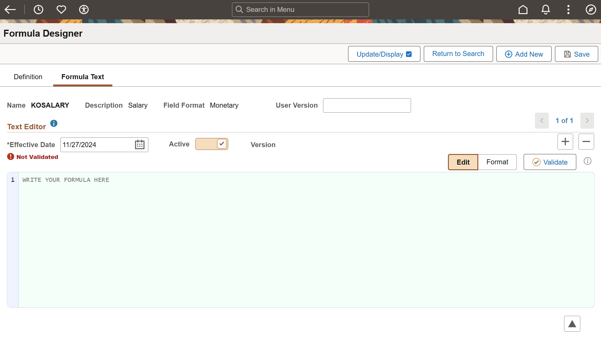

Formula Designer - Formula Text Page
Use the Formula Designer - Formula Text page to define your formula, edit it and confirm that it's correct.
This example illustrates the Formula Designer - Formula Text page.
Formula Text2 page
Info icon
Click the information icon to access the help page for Formula Designer.
User Version
You can enter upto 14 alphanumeric characters in this field to identify changes you make to the element definition.
Effective Date
Select the date from which the formula definition is effective.
Active
Select the Active button to activate the formula definition.
Edit
Click the Edit button to edit the formula definition.
Format
Click the Format button to format the formula definition.
Users have the option to toggle between edit and format modes to observe the application of color coding. For details, see the Syntax Highlighting section in this topic.
Validate
Click this button to validate your formula. (Validating a formula automatically saves the formula.). For details, see the Validating your Formula section in this topic.
Related Actions icon
Click the Related Actions icon to access Refer an Element menu. Selecting this menu will navigate you to Element Browser page. For details, see Browsing Elements.

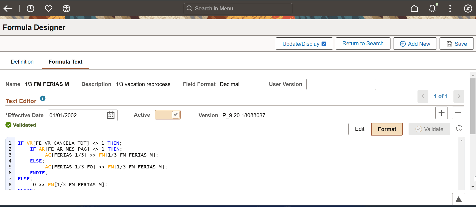

After you define your formula, save it, then validate and edit the formula. Whenever you alter the formula, re-validate it.
If the formula passed validation then you can see Validated status in the Text Editor group box as shown:
The Formula Designer page with successful validation is shown in this example.
Validated page
In both legacy formula elements and Fluid Formula Designer, modified formulas will be synchronized and can be edited.

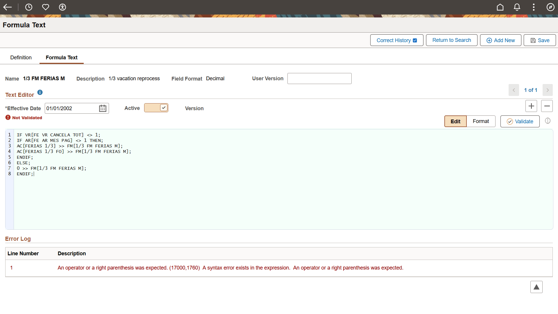

If the validation is not performed or validation fails, the status is shown as Not Validated and the formula will not be executed in the payroll.
This example illustrates the Formula Designer page with failed validation.
Not Validated Formula page
Access the Error Log section, where you can identify the specific lines where errors have occurred along with their respective causes. By clicking on the line number, you will be directed to the location of the error, allowing you to make the necessary corrections and validate once more.

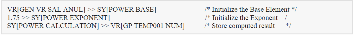

Using Power Calculation in Formula Designer
You can use the delivered power calculation system elements in the Formula Designer to perform exponentiation (raising a base to a power) within the Global Payroll rules. This capability streamlines complex mathematical logic and eliminates the need for custom functions to handle exponentiation.
For details on power calculation elements, see Using System Elements.
Steps to Use Power Calculation Elements
  1. Assign the Base Value
    Set the value to be raised to a power using the POWER BASE system element. This value can be a constant or come from a variable element in your formula.
  2. Assign the Exponent Value
    Set the exponent using the POWER EXPONENT system element. This value can also be statically assigned or sourced dynamically from a formula variable.
  3. Retrieve and use the Result
    The result of the exponentiation, that is POWER BASE raised to POWER EXPONENT, will be stored in the POWER CALCULATION system element. You can move or use this value in further computations by assigning it to a variable element or as part of additional logic.
Example: Calculating a Salary Growth Factor
Simple Exponent with Constant Exponent
Example1
In this example:
  • The annual salary variable ( GEN VR SAL ANUL) is set as the base.
  • The exponent is set to 1.75.
  • The formula calculates the result (salary to the 1.75th power) and stores it in GP TEMP001 NUM.
