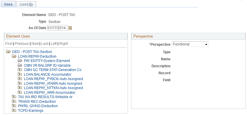

Uses Page
Use the Uses page (GP_PINTREE_EFFDT) to view a map of elements that a focus element uses.
The element relationship map must be built before the data is displayed.
Navigation:
Set Up HCM, and then Product Related, and then Global Payroll & Absence Mgmt, and then Elements, and then View Element Relationships, and then Uses
This example illustrates the fields and controls on the Uses page.
Uses page
Element maps include fields that contain PIN_NUM only. So, when looking at the map for an earning element, you don't see fields for frequency, currency, and other non-element information.
Field or Control Description
Element Name
Displays the name of the element that you selected on the search page. This is the focus element.
Type
Displays the element type of the focus element.
As Of Date
To see the relationship map that was in effect on a specific date, enter the date in this field.
Element Uses
Click the element name to view its member elements. This information appears in a tree structure that expands or collapses as you click the + or − folder before an element name.
Perspective
To see additional information on a related element, click the element name in the Element Uses group box and select a view in the Perspective field.
Perspective
Select the format for the data in this group box. Values are:
Functional: Displays descriptive names of the data.
Technical: Displays technical names for the data.
Type
Functional: Displays the name of the element type for the selected element.
Technical: Displays the 2 character code of the element type for the selected element.
Name
Displays the name of the selected element. (The name is the same in the functional and technical views.)
Description
Displays the description of the selected element. (The description is the same for the functional and technical views.)
Record
Functional: Displays the descriptive name of the record in which the selected element resides.
Technical: Displays the technical name of the record in which the selected element resides.
Field
Functional: Displays the descriptive name of the field that stores the element's value.
Technical: Displays the technical name of the field that stores the element's value.
