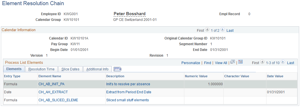

Element Resolution Chain Page
Use the Element Resolution Chain page (GP_AUDIT_CHAIN) to view elements that were resolved for a payee during processing.
Navigation:
Global Payroll & Absence Mgmt, and then Absence and Payroll Processing, and then Review Absence/Payroll Info, and then Element Resolution Chain
This example illustrates the fields and controls on the Element Resolution Chain page.
Field or Control Description
Begin Date and End Date
Displays the begin and end dates of the calendar in which the element was processed.
Element Name
Click to access the Detail Audit Chain page where you can view the order in which the element resolved.

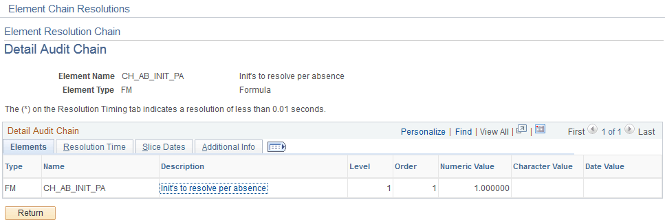

Detail Audit Chain Page
Use the Detail Audit Chain page (GP_AUDIT_DTL_SEC) to view the order in which each element was resolved and the numeric, character, or date value to which the element resolved.
Navigation:
Click the Element Name link on the Element Resolution Chain page.
This example illustrates the fields and controls on the Detail Audit Chain page.
The Order field shows the order of resolution.
