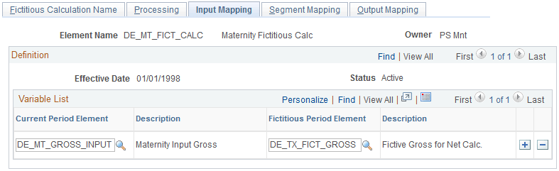

Input Mapping Page
Use the Input Mapping page (GP_FICT_CALC2) to specify elements from the current period for overriding the original values for the selected elements in each of the fictitious periods.
Navigation:
Set Up HCM, and then Product Related, and then Global Payroll & Absence Mgmt, and then Elements, and then Supporting Elements, and then Fictitious Calculations, and then Input Mapping
This example illustrates the fields and controls on the Input Mapping page.
Input Mapping page
Field or Control Description
Current Period Element
Enter an element whose value is to be passed to the previous period.
Fictitious Period Element
Enter a previous period element whose value is to be overridden in the previous period.

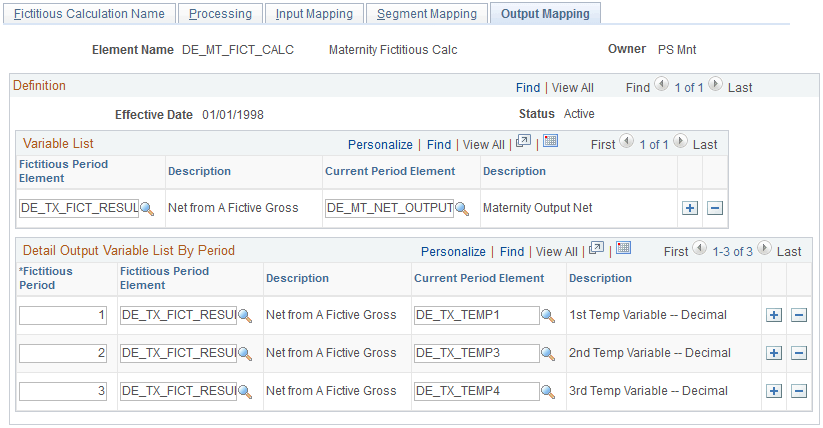

Output Mapping Page
Use the Output Mapping page (GP_FICT_CALC4) to specify elements from the fictitious calculation (summed or averaged) to be passed back to the current period and stored in the current period's elements.
Navigation:
Set Up HCM, and then Product Related, and then Global Payroll & Absence Mgmt, and then Elements, and then Supporting Elements, and then Fictitious Calculations, and then Output Mapping
This example illustrates the fields and controls on the Output Mapping page.
Output Mapping page
Enter an element whose sum or average (based on the calculation type of the previous period rule) value is to be passed to the current period.
Enter an element to store the result of a calculation in a previous period.
Fictitious Period
Enter a number to designate the order in which the system shall process the fictitious periods. The lowest number is processed first, and so on.
Enter an element whose value is to be passed to the current period.
Enter an element to store the result of the calculation in the previous period.
