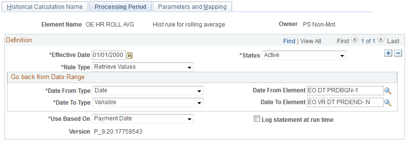

Historical Rules - Processing Period Page
Use the Historical Rules - Processing Period page (GP_HIST_RULE1) to define the details of the processing period for the historical rule.
Depending on what you select as the rule type, some fields may not be available for entry.
Navigation:
Set Up HCM, and then Product Related, and then Global Payroll & Absence Mgmt, and then Elements, and then Supporting Elements, and then Historical Rules, and then Processing Period
This example illustrates the fields and controls on the Historical Rules - Processing Period page.
On the Processing Period page, you create the periods from the date from to the date to date. You then map the selected result data to the processing periods. If no data exists for an element in a period, it is set to spaces for character and date elements and to zeros for numeric and monetary elements.
Field or Control Description
Rule Type
Select the type of historical rule from these options:
Use in Fictitious Calculation: Select when you want to use a historical rule element in a fictitious calculation element to determine which pay periods to recalculate.
Retrieve Values: Select when you want to use a historical rule element in a formula to retrieve previously calculated values.
Go back from Date Range
Define the date from, date to type, date from element, and date to element to establish the rule's date range. If you select a Retrieve Values rule type, this field appears as Go Back From Date Range. If you select a Use in Fictitious Calculation rule type, this field appears as Go Forward From Date Range.
Select from the following values in the Date From Type and Date To Type fields:
Bracket
Cal Date (calendar date): Enter a date instead of an element that resolves to a date. In the next field, specify the date to start going back from (for historical rules) or to start going forward from (for fictitious rules).
Date
Formula
SystemElem (system element)
Variable
Use Based On
Select a date that tells the system which data values from the GP_RSLT tables are processed by a historical rule. Select from these values: Period End Date, Period Begin Date or Payment Date.
Log statement at run time
Select this check box to see the text of the SQL statement dynamically generated by the array module during batch processing. You can direct the output display into a file by selecting the Redirect Output option in PeopleTools Configuration Manager.
Example

If you select Period Begin Date, the historical rule processes only June, May, and April. It does not process July, because July 1, 2003 (the period begin date) is later than the date from date of the historical period (June 27, 2003). It also does not process March, because March 1, 2003 (the period begin date) is before the date to date of the historical period (March 28, 2003).
Historical rules start from the date from date and look at periods and segments in the reverse order in which they were originally processed and go back to the date to date.
If you select Period End Date, the rule processes May, April, and March. It does not process June, because June 30, 2003 (the period end date) is later than the date from date of the historical period (June 27, 2003). It also does not process February, because February 28, 2003 (the period end date) is before the date to date of the historical period (March 28, 2003).
If you select Payment Date, the rule processes May, April, and March. It does not process June, because July 2, 2003 (the payment date) is later than the date from date of the historical period (June 27, 2003). It also does not process February, because March 2, 2003 (the payment date) is before the date to date of the historical period (March 28, 2003).

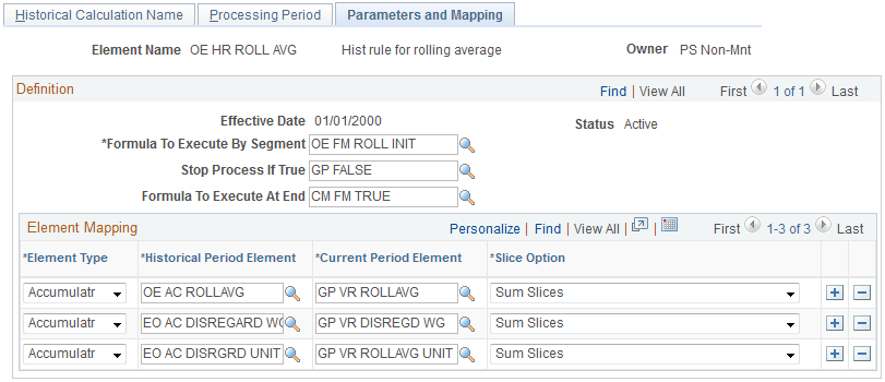

Parameters and Mapping Page
Use the Parameters and Mapping page (GP_HIST_RULE2) to define the formula for a historical rule.
Navigation:
Set Up HCM, and then Product Related, and then Global Payroll & Absence Mgmt, and then Elements, and then Supporting Elements, and then Historical Rules, and then Parameters and Mapping
This example illustrates the fields and controls on the Parameters and Mapping page.
Depending on whether you specified a historical or fictitious rule type on the Processing Period page, different fields appear on this page.
When you run a payroll, the system resolves the Formula to Execute by Segment field per historical period until the Stop Process If True variable is not equal to zero or the last historical period is processed. The system then resolves the formula specified in the Formula To Execute at End field.
Formula to Execute By Segment
Enter the formula to be resolved for each segment or period.
Enter a variable. The process keeps looping through periods, resolving the formula for each period, until this variable doesn't equal zero, the date to date is reached, or no more data is found.
Formula To Execute At End
Select the formula to resolve when period processing is completed.
Use Period If True
This field appears for Use in Fictitious Calculation rule types only. Enter a variable. After each call to the Formula to Execute By Segment field, this variable is checked for zero or one. If it's set to one, the fictitious calculation process uses the period for which the formula was called.
Element Mapping
The grid in the Element Mapping group box lists the elements for retrieval from the Global Payroll result tables for a historical rule.
Element Type
Select the type of element—such as the earning, deduction, or variable—to retrieve.
Historical Period Element
Enter the element that you want to retrieve.
Current Period Element
Enter the variable in which the retrieved value is to be stored. This variable becomes available for use in the Formula to Execute By Segment field.
Slice Option
Specify how the system resolves multiple instances of an element in the historical period. Values are:
  • Sum Slices: The system sums all slices.
  • Use Last Slice: The system uses the value of only the last slice.
  • Sum Slices - Current Empl Rcd: The system sums all slices, but only for rows of data where the EMPL_RCD equals the current EMPL_RCD.
  • Use Last Slice - Cur. Empl Rcd: The system uses the value of only the last slice, but only for rows of data where the EMPL_RCD equals the current EMPL_RCD.
