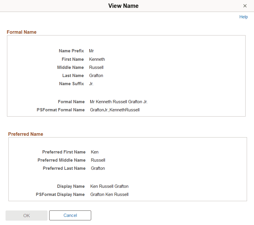

Add Name Page
View Name Page
Edit Name Page
NAME_EDIT_GRP_SEC
Add, edit, and refresh name information.

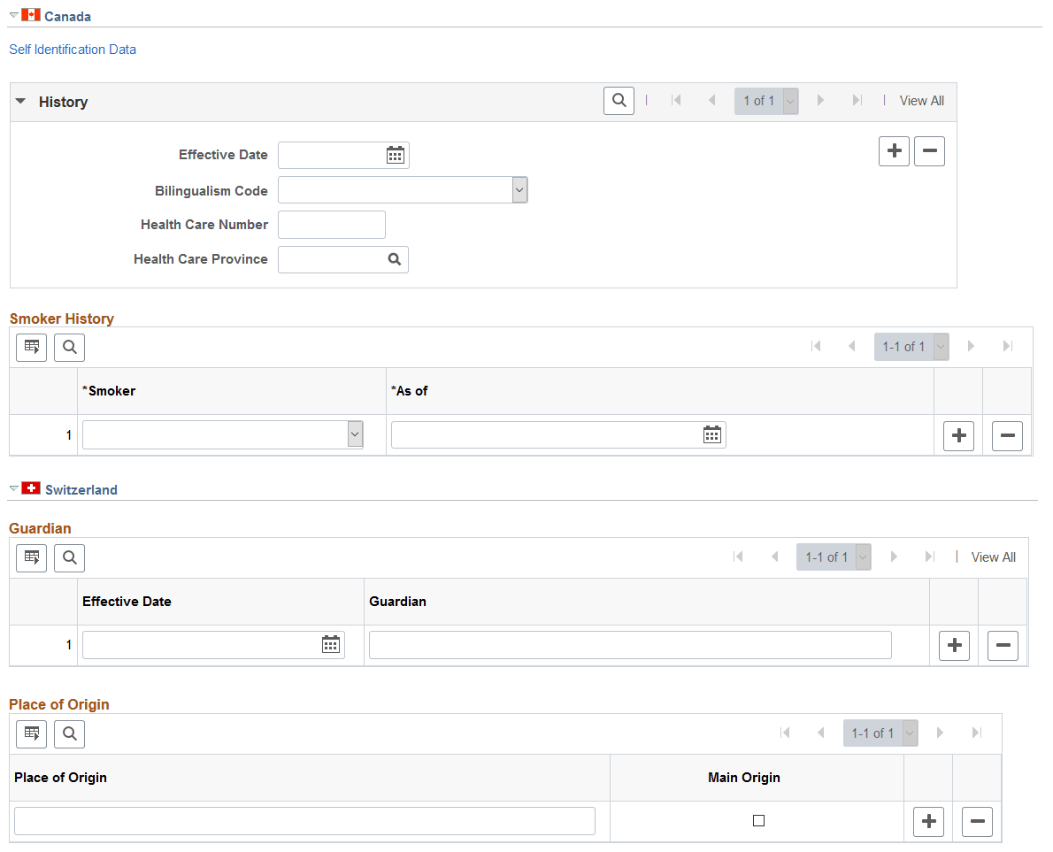

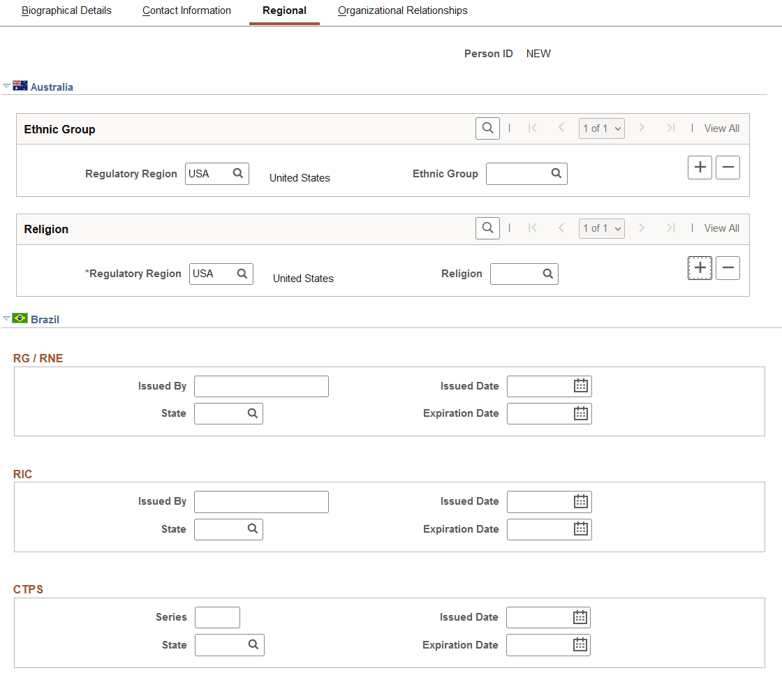

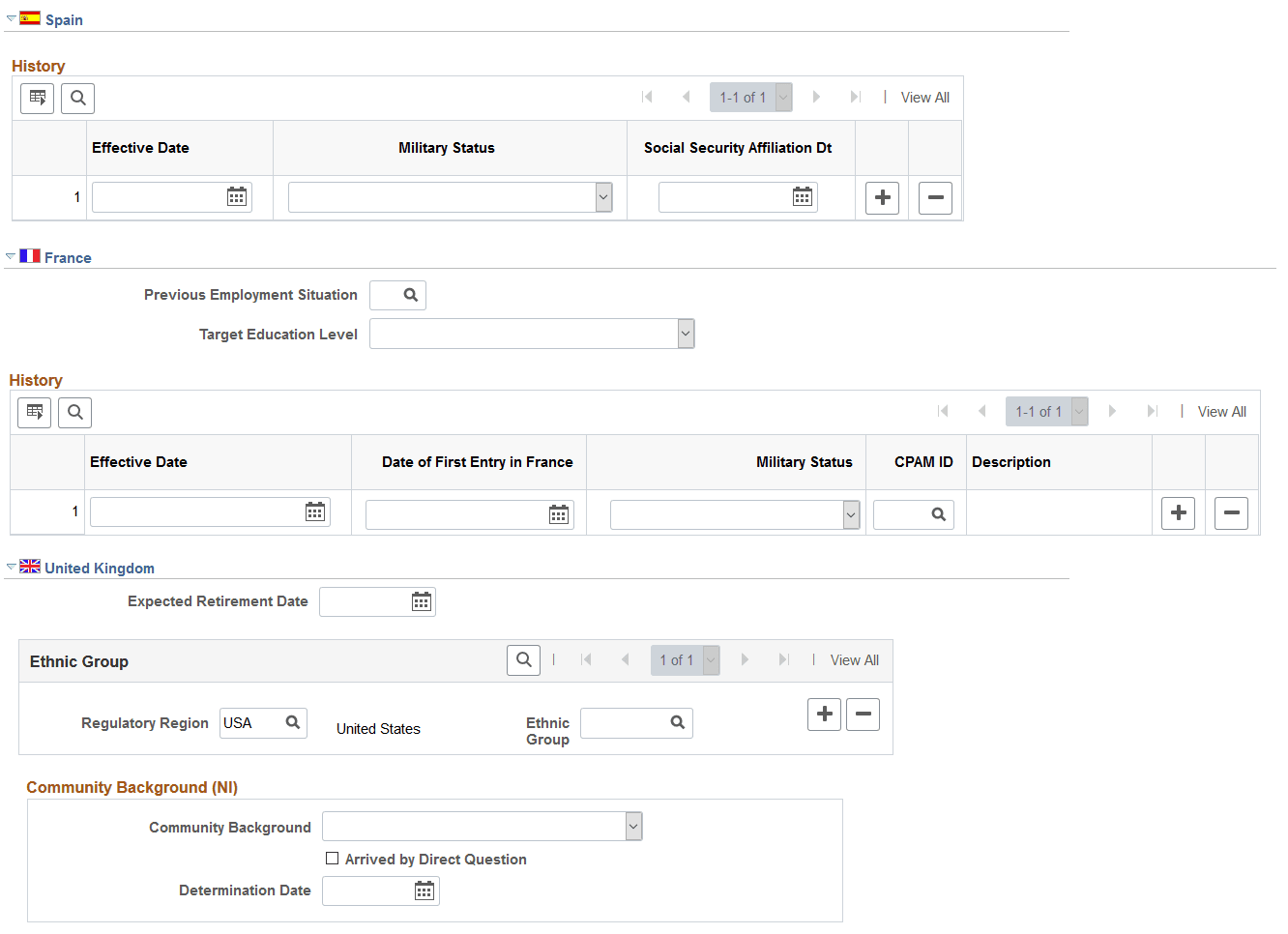

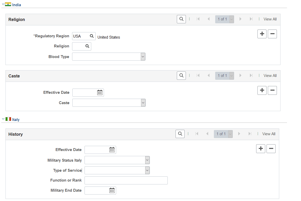

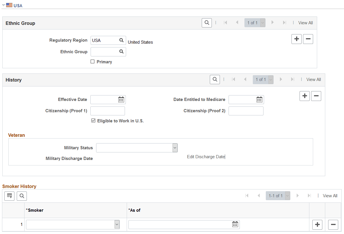

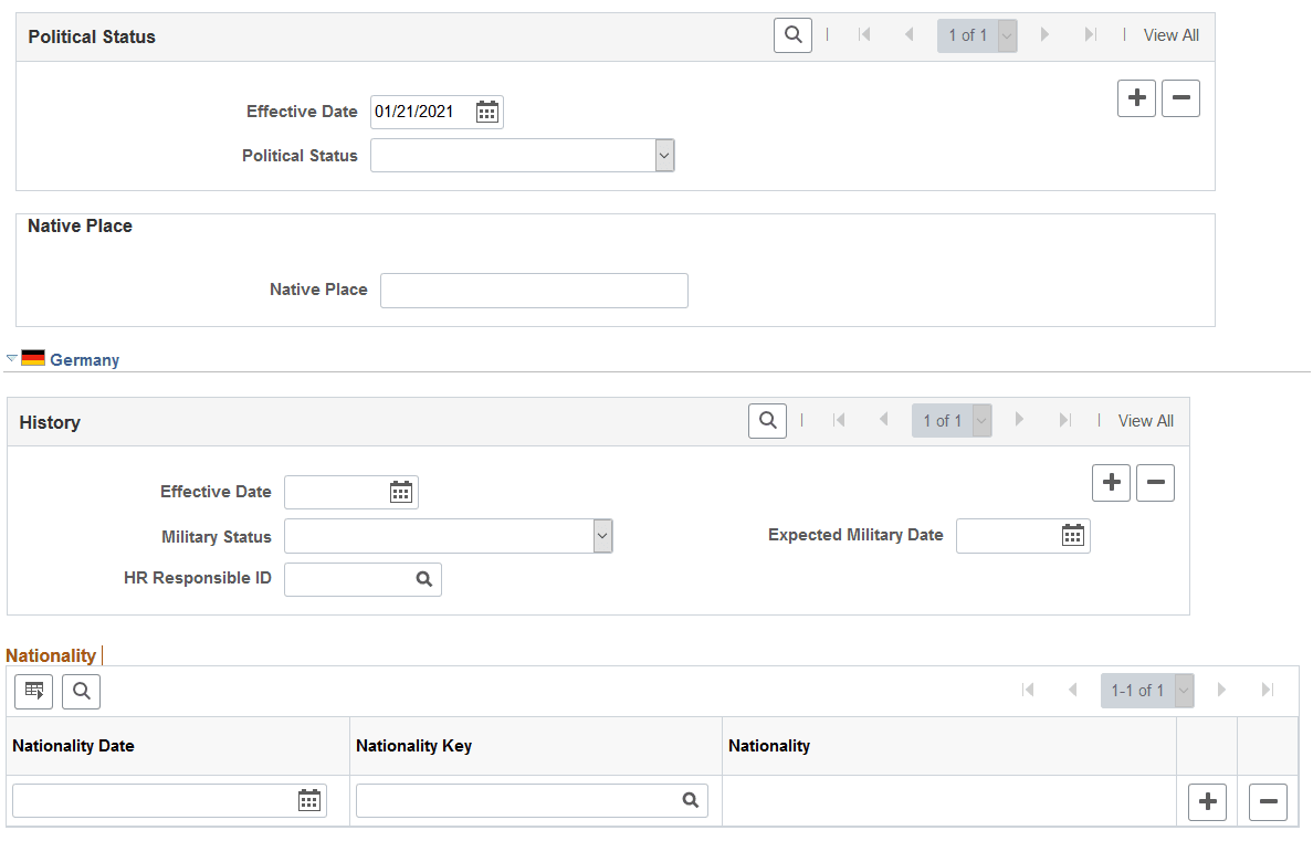

Add a Person or Modify a Person - Regional Page
PERSONAL_DATA3
Enter country-specific personal information.
Self Identification Data Canada Page
CAN_SELF_ID_DATA
Enter Canadian ethnicity data for a person, including whether the person is a visible minority and whether the person is an aboriginal person.
Be sure this page is appropriately secured to protect the confidentiality of this data.

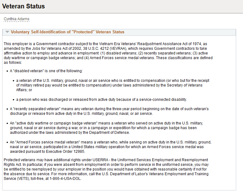

Veteran Status Page
HR_VETERAN_STATUS
Employees use this self-service page to enter and update self-identification veteran information.
When the employee submits the Veteran Status page, the system displays the veteran self-identify data in the Veteran group box on the Regional page in the Personal Information – Add a Person or Modify a Person component.
Administrators can update the selection on the Regional page.

Common Elements Used When Maintaining Personal Data
Field or Control Description
Smoker and As of
Indicate if the person is a smoker and enter the date on which the person started smoking. A person's smoker status affects benefits eligibility and rate determination in PeopleSoft Human Resources (HR) Manage Base Benefits and is required for regulatory reporting.
Ethnic Group
Select an ethnic group. You set up ethnic groups on the Ethnic Groups page.
(AUS) Affirmative action reports and the ATSI (Aboriginal and Torres Strait Islander) code come from this page.
(USA) Values are based on U.S. Federal Equal Employment Opportunities ethnic categories. Use ethnic group information to compile the establishment's affirmative action plan and to generate several equal employment opportunity (EEO) reports.
(GBR) Values are based on U.K. equal opportunity ethnic categories.
Military Status
Enter the person's military status.
Note: Employees can enter and update their own military status in self service, on the Veteran Status Page. Administrators can override and update the selection in the Add a Person or Modify a Person components, and the changes will be reflected in self service.

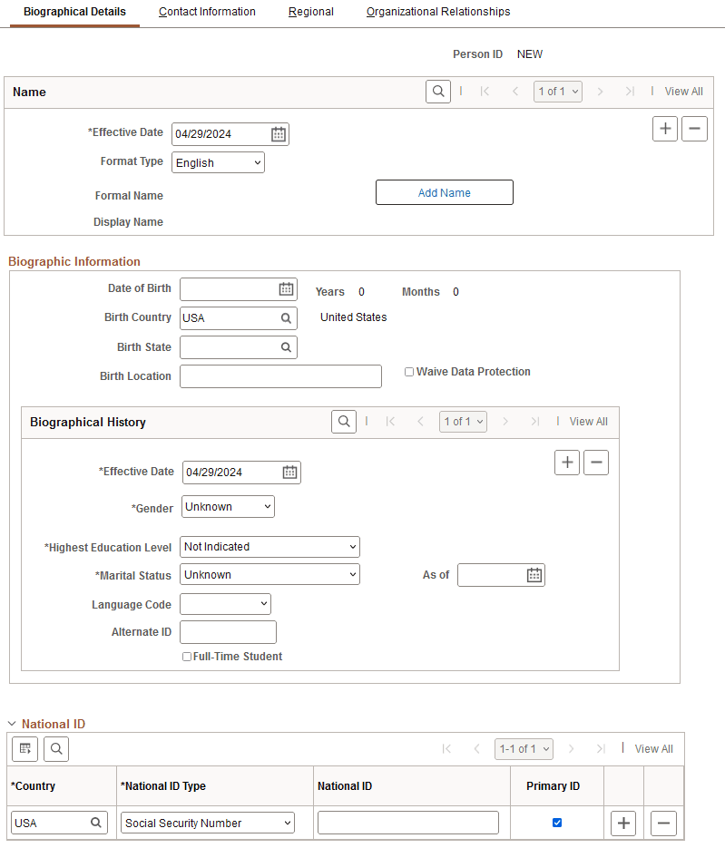

Biographical Details Page
Use the Biographical Details page (PERSONAL_DATA1) to enter name and other biographical information.
Navigation:
  • Workforce Administration, and then Personal Information, and then Biographical, and then Add a New Person, and then Biographical Details
  • Workforce Administration, and then Personal Information, and then Add a Person, and then Biographical Details
  • Workforce Administration, and then Personal Information, and then Modify a Person, and then Biographical Details
This example illustrates the fields and controls on the Biographical Details page. You can find definitions for the fields and controls later on this page.
Person ID
If you are adding a new person and are using system-assigned IDs, the field displays the value NEW until you save this record. Otherwise, the system displays the value that you enter to access the page.
Name
Format Type
Select the name format. This value controls the name field and layout configuration on the Add Name Page.
Note: The name fields and the layout of the Name section is determined by the Name Format Type configuration (see Application Fundamentals: Setting Up Additional Name Information). Therefore, if you change the name format type, the fields listed on the Name page may change.
Formal Name
Displays the person's legal name to be used for official purposes.
Display Name (also known as Preferred Name)
Displays the person's preferred or chosen name. This name will appear on most transaction pages, headers, and reports.
Add Name button
View Name and Edit Name buttons (when working with an existing person record)
Select to access the Add Name Page and add, view, or edit a name.
Biographic Information
Date of Birth
Enter the person's date of birth. If you leave this field blank, a warning message appears when you save the record. You can continue entering information after you acknowledge the message. Though the birth date isn't required for the Administer Workforce business process, the system uses it to calculate a person's age in some benefit and payroll tasks. It also calculates dates, such as the U.K. expected retirement date, based on the person's age.
Birth Country
Select a country. Based on the selected country, the system might display additional fields.
Birth Location
Enter a birth location, usually a city, town, or village.
(BRA) If the selected birth country is BRA (Brazil), this field becomes a prompt field for cities.
Date of Death
This field does not appear during the hiring process. Use this field when updating a person's records.
Waive Data Protection
European community employment and personal privacy legislation specifies that personnel information can't be passed across countries in the European Union without authorization from the employee. Select this check box if you obtain the employee's consent to share personal data with users in other European Union member nations.
Biographical History
Gender
Select the person’s gender. By default, the value is set to Unknown.
Note: (BRA) You must specify the person’s gender (Male or Female) for eSocial reporting to work properly.
If the Enable Gender Identity feature is enabled on the Installation Table, this section will appear differently. See the Gender and Orientation Details section that follows for the additional field definitions.
Highest Education Level
Select a value.
Note: (JPN) For Japanese education-level age-related pay calculations, a form of seniority pay, these values are linked to an education-level age basis as of hire.
Marital Status and As of
Select the person's marital status. Values are: Common Law, Divorced, Head of Household, Married, PACS [(FRA) this field is used in France. Pacte civil de solidarité], Separated, Single, Unknown, and Widowed. When a marital status is changed, the default as of date is the same as the biographical history effective date.
PeopleSoft Payroll doesn't use the marital status that is entered on this page for tax calculations. For U.S. employees, you enter that information in Maintain Payroll Data on the Federal, State, and Local Tax pages. Taxes for Canadian employees are based on net claim amount, which varies depending on the employee status.
Note: Laws in the Netherlands require tracking effective-dated marital status information for employees.
Language Code
Select the person's native or preferred language. Although tracking official or preferred languages is required in some countries in PeopleSoft Human Resources, the system also uses the preferred language when you communicate with people with a relationship to the organization. For example, PeopleSoft Global Payroll for Germany and Switzerland use the language code to print paychecks in the payee's preferred language. Other types of communication also use this as the default language for written communication.
Note: Don't use this field to record the organization's official language or to rate a worker's proficiency in speaking, reading, or writing various languages. Use the Location Table to track the organization's official language. Use the Languages table to record a worker's language proficiency. The Language Code field prompts from the LANG_CD table, which concerns the person's native or preferred language, and not from the LANGUAGE_CD table, which contains the languages into which the application can be translated.
Alternate ID
To use a second type of ID for a person, enter the ID.
Full-Time Student
Select if the person is a full-time student.

National ID
Country
Select the country that issued the worker's national ID.
National ID Type
The system enters the value that you establish for this country on the National ID Type Table page. You can override this default.
Note: (BRA) Add rows to enter one or more of the following IDs for the person: CAIXA, CPF - Person Registry, CTPS - Work Card, Civil Registry ID, Class Entity Registration, Foreigner ID, General Registry, Health National Card, Militar Certificate, NIT Number, New Born ID, PASEP, PIS, and Voter Registration Card.
Note: (BRA) Changes made to a Brazilian person's CTPS - Work Card and PIS national ID types will be recorded on the National ID History page.
National ID
Enter the worker's national ID number. The system checks the format of the entry against the default format that you enter on the National ID Type Table page.
(GBR) For the U.K. the normal format of two letters followed by six digits and then one letter for National Insurance identification appears by default. Other options that are dependent on employee status are available.
(GBR) When you enter a national insurance number, the system uses the NID Prefix GBR page to check that you have entered a valid national insurance prefix. You can't save this page if you have entered an invalid national insurance prefix.
Primary ID
Select if the national ID is the person's primary ID. If this is the only data row for this person, the system selects the check box by default. You can deselect it.
Tax Ref
(SGP) Select if the worker's national registration ID is used as the person's employer tax reference number. This field is for information only.
National ID Expiry Date
(CAN) Enter the expiration date for this National ID.

Add Name Page
Use the Add Name page (NAME_EDIT_GRP_SEC) to add, edit, and update name information.
When viewing or updating an existing personal data record, the page name will appear as View Name or Edit Name.
Navigation:
Select the Add Name button on the Biographical Details Page.
For existing personal data records, select the View Name or Edit Name button.
This example illustrates the fields and controls on the Add Name page.
Add Name page
This example illustrates the fields and controls on the View Name page when Use Formal and Display Name Groups is enabled on the name format type configuration.
View Name page with Formal and Display Name Groups enableddisplay the person's formal and preferred name
The page layout and fields will vary based on the Format Type field value selected on the Biographical Details Page, such as English, Spanish, and so forth. The name fields and the layout is determined by the Name Format Types configuration. Therefore, if you change the name format type, the fields listed may change.
As delivered, the page displays the person's formal name (the legal name that will be used for official purposes) and the display name (the person's preferred or chosen name and the name that will appear on many of the transaction pages throughout the system).
When Use Formal and Display Name Groups functionality is enabled, the Name pages will divide the formal and display name fields into two sections.
For more information on page field configuration and Formal and Display Name Groups, see the documentation for Application Fundamentals: Setting Up Additional Name Information, Name Format Types component.

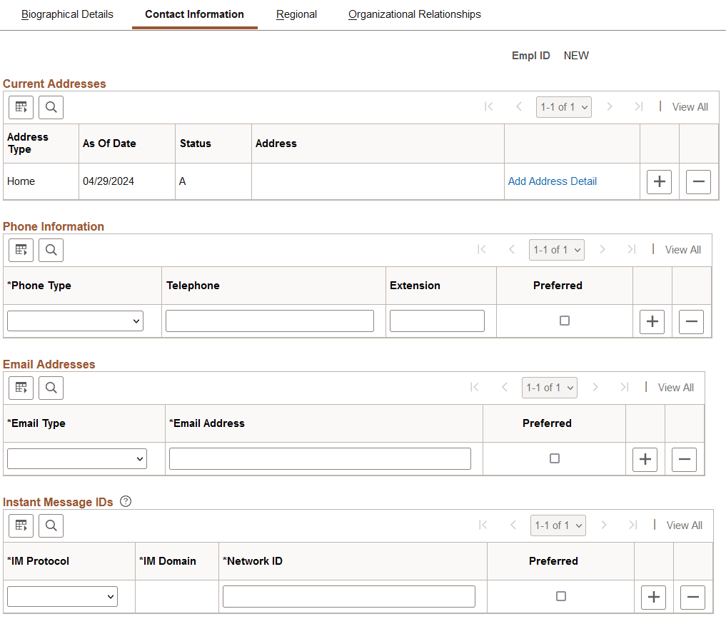

Add a Person or Modify a Person - Contact Information Page
Use the Contact Information page (PERSONAL_DATA2) to enter or edit a person's contact information.
Navigation:
  • Workforce Administration, and then Personal Information, and then Biographical, and then Add a New Person, and then Contact Information
  • Workforce Administration, and then Personal Information, and then Add a Person, and then Contact Information
  • Workforce Administration, and then Personal Information, and then Modify a Person, and then Contact Information
This example illustrates the fields and controls on the Contact Information page. You can find definitions for the fields and controls later on this page.
Current Address
Address Type
Select the type of address that appears in this row. The system automatically displays Home for the first address that you enter.
Note: Payroll for North America requires the person to have one address with type Home to successfully calculate taxes. You must set up each Puerto Rico employee's home address with country code USA and state code PR for proper tax reporting.
Add Address
Click to add an address and access the Edit Address page to edit addresses.
Note: (ITA) When entering Italian addresses, use the Address Search link on the Edit Address page to locate valid cities based on province.
Laws in Belgium, the Netherlands, and Japan require maintaining effective-dated address information for employees.
Phone Information
Phone Type and Telephone
Select the phone type and enter the phone number. The system formats the number based on the standard phone number format. For 10 digit phone numbers the format is 000/000-0000 and for 7 digit phone numbers the format is 000-0000. The system also supports alphanumeric characters and the punctuations $, -, /, (, and ) when entering telephone numbers.
Select Main to designate a phone number as the individual's primary contact number.
Email Addresses
Email Type and Email Address
Select an email type and enter the employee's email address.
Note: If an employee has more than one address, click the Add (+) button after selecting the address type.
Instant Message IDs
Use this group box to enter instant message IDs that appear on application pages when chat is enabled.
Network ID
Enter the employee’s ID for the supported instant chat network.
Note: Google and MSN require special network IDs. The Google chatback badge and MSN user ID will need to be provided by the employee to provide permission for public presence to appear in the system. Please see MSN and Google for more information on network IDs.
IM Protocol and IM Domain
Enter the supported IM protocol for the network ID. Valid values are GTALK, MSN, XMPP, and YAHOO.
The system displays the instant message domain associated with the IM protocol you select except for XMPP. For XMPP, you must select the value of the XMPP server that has been defined by your organization.
See PeopleTools: PeopleSoft MultiChannel Framework, "Configuring Instant Messaging in PeopleSoft MultiChannel Framework"
Preferred
Select if this is the user’s preferred chat network ID.
Some public networks such as GTALK and MSN require special network IDs which can only be obtained through their respective websites.

This example illustrates the fields and controls on the Regional page (1 of 12). You can find definitions for the fields and controls later on this page.

Local country laws that require employers to verify a person's nationality and eligibility to work in that country might require information that you enter here. Much of the data that you enter is required for regulatory reporting in PeopleSoft Human Resources.
(BRA) Brazil
Information entered in this section is used in eSocial reporting.
(RG/RNE) Issued By
Enter the Registro Geral (RG) or Registro Nacional de Estrangeiros (RNE) issuing entity. This information is required if you enter the individual's general registry or foreigner ID number in the National ID group box.
Issued Date and State
Enter this information, which is required if you enter the individual's general registry or foreigner ID number.
Expiration Date
Enter the expiration date for the listed entity.
(RIC) Issued By
Enter the Registro de Identidade Civil (RIC) issuing entity. This information is required if you enter the individual's civil registry number in the National ID group box.
Issued Date and RIC State
Enter this information, which is required if you enter the individual's RIC number.
Expiration Date
(CTPS) Series
Enter the work card number.
Issued Date
Enter the work card's issued date. This information is required if a Carteira de Trabalho e Previdência Social (CTPS) number is provided.
State
Enter the political subdivision of the CTPS issuing agency. This information is required if a CTPS number is provided.
Expiration Date

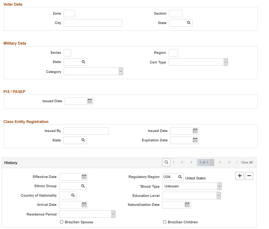

(Voter Data) Zone, Section, City, and State
Enter this information, which is required if a voter registration card is provided.
(Military Data) Series, Region, and Category
Enter this information, which is required if a reserve certificate is provided.
State
Enter the political subdivision of the issued reserve certificate. This information is required if a reserve certificate is provided.
Cert Type (certificate type)
Enter the type of military service. Values are: Aeronautic, Army, Marine, or Other. This information is required if a reserve certificate is provided.
(PIS/PASEP) Issued Date
Enter the date of issuance at PIS / PASEP. This information is required if the PIS/PASEP number is provided in the National ID group box.
(Class Entity Registration) Issued By
Enter the class entity registration issuing entity. This information is required if you enter the individual's class entity number in the National ID group box.
Enter this information, which is required if you enter the individual's class entity number.
Expiration Date
(History) Regulatory Region and Ethnic Group
Enter the regulatory region for the person.
As you enter BRA as the regulatory region for a Brazilian employee, the system performs a number of validations, one of which checks for the presence of the ethnic group value. Specify the ethnic group when the regulatory region is set to BRA; this information is used in several Global Payroll for Brazil reports, including the RAIS and eSocial reports. Do not select Unknown as the ethnic group.
Country of Nationality
Select the nationality for the person from the Country table (COUNTRY_TBL). RAIS nationality codes were used previously.
Educational Level
Select the education level for the person.
Residence Period
Specify whether the residence period of the person is Determined or Undetermined. Used in eSocial reporting, this value is required for individuals who were not born in Brazil.
If the value is not specified for a non-Brazilian-born employee, the system generates a mapping error.
See Also PeopleSoft Global Payroll for Brazil: Monitoring eSocial Events.
Immigration Condition
Select the immigration condition for the person. This field appears when you select a residence period. The list of values is different based on the selected residence period. Possible values include:
Asylum Seeker - This value applies to the Determined residence period only.
Benefited - Mercosur Countries
Benefited - Treaty BRA & POR
Brazilian's Family
Dependent of Diplomat/Consular - This value applies to the Determined residence period only.
Other Conditions
Refugee - This value applies to the Undetermined residence period only.
(CAN) Canada
Click this link to access the Self Identification Data Canada page, where you enter ethnic background information for the person. The Self Identification Data Canada page has two fields:
  • Use the Visible Minority field to indicate if the person's ethnic background is apparent based on physical appearance.
  • Use the Aboriginal Person check box to indicate if the person is a Canadian aboriginal person.
The Self Identification Data link is visible only to users with access to the Self Identification Data Canada page. To secure this page and protect the confidentiality of the ethnicity data, you can use the delivered permission list HCCPHR40CA and the delivered role HR Admin CAN Confdl Data.
Bilingualism Code
Record the appropriate code for the person. If the Official Languages Act applies to the organization, use the bilingualism code as part of the Official Languages reports (PER102CN and PER108CAN) that you submit to the government.
Health Care Number and Health Care Province
Enter a number and select the health care province.
(CHE) Switzerland
Guardian
Minors who are age 18 or younger or people with mental illness must have a parent or guardian sign employment contracts on their behalf. Enter the name of the parent or guardian who is authorized to act for this employee.
Place of Origin
Enter a place of origin. Every Swiss person has at least one place of origin, usually determined by the father or husband's birthplace.
Main Origin
Select if the place of origin in the Place of Origin field is the person's main place of origin. (A person can have more than one place of origin.)

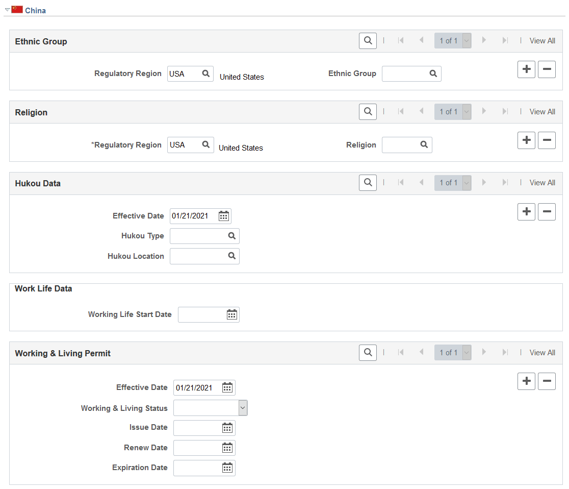

(CHN) China
Regulatory Region
Enter a regulatory region for the person.
Ethnic Group
Enter the person's ethnic group.
Religion
Enter the person's religion.
Hukou Type
Enter the person's Hukou type.
Hukou Location
Enter the person's Hukou location.
Working Life Start Date
Enter the date on which the person first began to work.
Working & Living Status
Enter the status of the worker's working and living permit. Values are: Expired, Granted, and Renewed.
Issue Date
Enter the date on which the working and living permit was issued.
Renew Date
Enter the date on which the working and living permit was renewed.
Expiration Date
Enter the date on which the working and living permit expires.
(DEU) Germany
Expected Military Date
If the person hasn't already completed military service, enter the date when service is expected to begin.
HR Responsible ID
Select the ID of the human resources representative responsible for this person.
Nationality Date
Enter the effective date of the person's nationality status. If the employee is a native citizen of the country, enter the person's birth date. If the person is a naturalized citizen, enter the date on which the person became a citizen.
Nationality
Enter the person's nationality by selecting a nationality code.
German labor laws require recording an employee's nationality to determine if the employee is eligible to work in certain industries, particularly those that are related to technology or defense. Use the nationality code to determine the employee's eligibility to work in a regulated industry based on the employee's country's participation in OECD or the European Union. You can maintain information about whether each nationality code participates in the OECD and European Union.
Note: Duevo-compliant nationality codes are established by the Duevo Directive and are provided by the PeopleSoft system.

(ESP) Spain
Social Security Affiliation Dt (social security affiliation date)
Enter the date when the person is assigned a Spanish social security number.
(FRA) France
Date of First Entry in France
Leave blank if the person is a native-born French citizen. If the person is foreign-born, enter the date on which the person first arrived in France. This data is used to maintain work visa information for foreign workers who are employed in France.
CPAM ID (Caisse Primaire d'Assurance Maladie ID)
Enter the code of the CPAM ID that is assigned to the person. CPAM depends on the person's home address. The CPAM is the social security body that compensates persons for illness and work accidents.
(GBR) United Kingdom
Expected Retirement Date
The system calculates and displays this value, based on the system date and the birth date that you enter on this page. This field is for information only; you can't change it.
A person's expected retirement date is based on the birth date that you enter on the Name/Location page. For men in the U.K., the expected retirement date is always the 65th birthday. For women, it is the 60th birthday. The British government is introducing measures to raise the state pension age for women. The retirement age for women will gradually increase to 65 years between 2010 and 2020. This table shows the expected retirement dates for women in the U.K.:
Birth Date Expected Retirement Age
Before April 6, 1950.
60 years.
After April 6, 1950 and before April 6, 1955.
Retirement date is delayed one month for each month that the woman is born after April 6, 1950.
After April 6, 1955.
65 years.
The calculation that the system uses to determine the retirement age of U.K. employees is stored in FUNCLIB_HR_UK.EXP_RETIRE_DT.FieldFormula.
(GBR) Community Background
The system displays the following fields only if you're logged in as an authorized user. Northern Ireland law requires that only a designated monitoring officer see community background data for employees. The system includes a special user class (UKNIPNLS) and user ID (UKNI) for you to use to enforce these rules.
Select the person's community background: Protestant, Catholic, or Undetermined/Other.
Arrived by Direct Question
Select if you determine the person's community background by asking the employee directly.
Determination Date
Enter the date on which you determine the person's community background category.
The data that you enter about a Northern Ireland worker's community background is required under the Fair Employment Act. Employers must include this information in the Northern Ireland report (UKNI001) that they submit to the administrative body that monitors employment in Northern Ireland. This report provides an annual summary of the state of the workforce for a particular employer and breaks down employees and applicants for employment into their respective community background categories.
(IND) India
Blood Type
Select the person's blood type or select Unknown. When the blood type is entered on this page at the time that an employee is hired, a component interface updates the employee's blood type on the physical exam record. Thereafter, this field is disabled and displays by default the blood type data from the physical exam record.
Caste
Select the person's caste.
(ITA) Italy
Type of Service
Select the type of service that the person performed in the military.
Function or Rank
Enter the function or rank that was held by the person in the military.
Military End Date
Indicate the date on which the person's military service ended, if applicable.

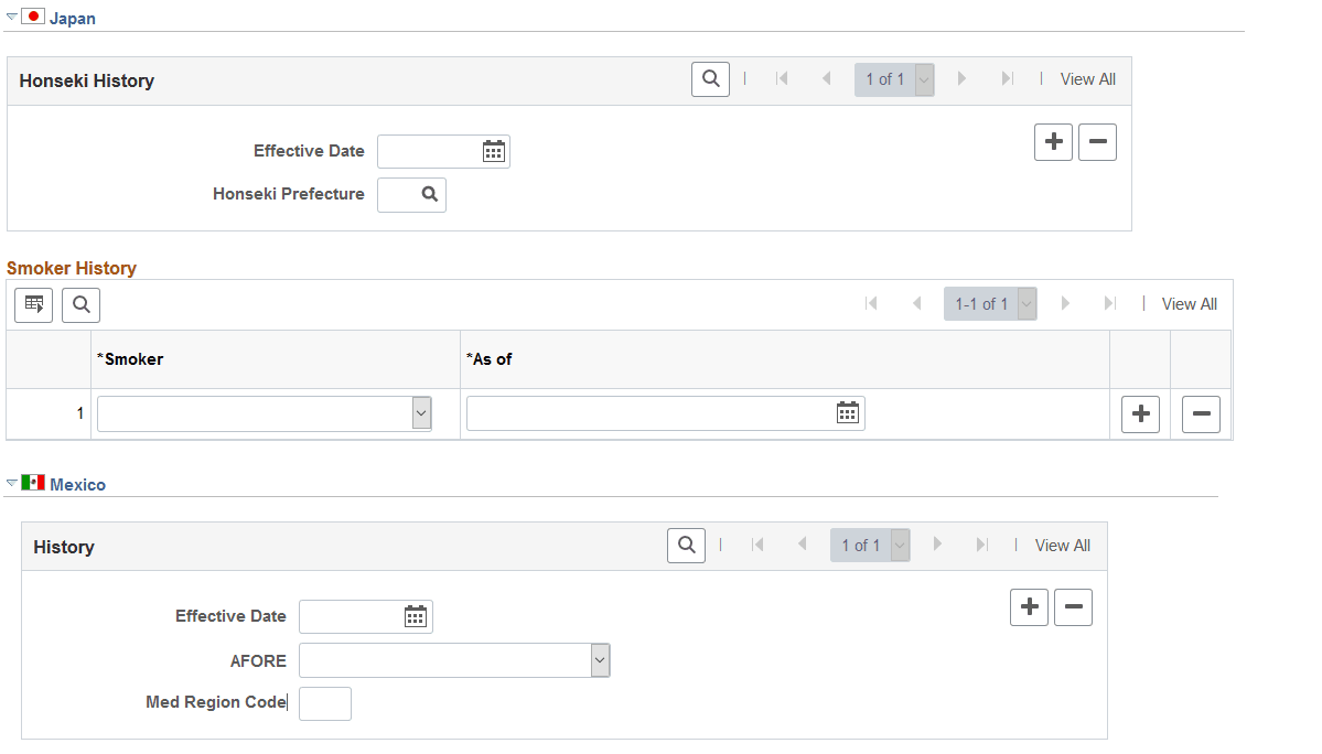

(JPN) Japan
Honseki Prefecture
Select the family prefecture, or place of registration. Tracking a person's Honseki Prefecture is a matter of custom.
(MEX) Mexico
AFORE (Retirement Funds Institution Code Mexico)
Enter the AFORE for the employee. Values include: Banamex, Bancomer, Dresdner, GNP, Garante, ING, Inbursa, Principal, Santander, Tepeyac, XXI, and Zurich.
Med Region Code (medical region code)
Enter the three-character code for the medical region where the person resides.

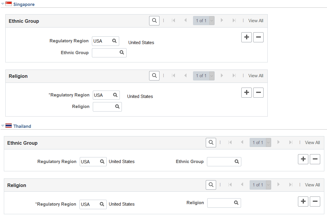

(MYS) Malaysia, (THA) Thailand, and (SGP) Singapore
In Malaysia, Thailand, and Singapore, you use the Ethnic Group and Religion fields for eligibility and calculation of festive advances.
(USA) United States
Ethnic Group
Enter one of more ethnic groups for a person.
Values are based on U.S. Federal Equal Employment Opportunities ethnic categories. Use ethnic group information to compile the establishment's affirmative action plan and to generate several equal employment opportunity (EEO) reports. Ethnicity is also used when populating the Employee table during the Refresh Employees Table process.
The Refresh Employees Table process (PER099) uses this information.
See Understanding the Process of Refreshing the Employees Table.
Primary
Select the primary ethnicity for a person, if applicable.
Date Entitled to Medicare
(Optional) Enter the date on which this person is entitled to receive Medicare coverage.
Citizenship (Proof 1) and Citizenship (Proof 2)
Enter two forms of ID (for example, passport and Social Security card) to prove U.S. citizenship (required by U.S. law).
Eligible to Work in U.S.
Select if the person is eligible to work in the U.S.
Military Status
Shows the military status option selected by the employee on the Veteran Status Page. Administrators can update the selection. Changes made here will be reflected in self service.
The default values is a blank field.

Veteran Status Page
Employees use the Veteran Status page (HR_VETERAN_STATUS) to enter and update self-identification veteran information.
Navigation:
Self-Service, and then Personal Information, and then Veteran Status
The Fluid self-service Veteran Status page (HR_VET_STATUS_FL) is also available for smart phones and tablets. See PeopleSoft eProfile: Veteran Status Page in your PeopleSoft eProfile product documentation.
This example illustrates the fields and controls on the Veteran Status page (1 of 2).
(Classic) Veteran Status page (1 of 2)
This example illustrates the fields and controls on the Veteran Status page (2 of 2).
(Classic) Veteran Status page (2 of 2)

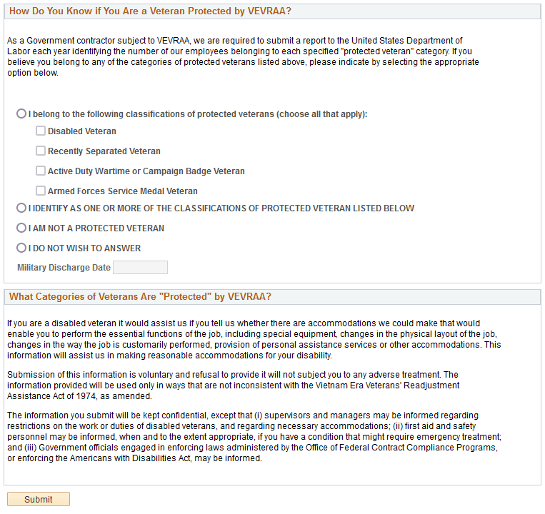

PeopleSoft uses the Text Catalog to deliver the page with verbiage compliant with OFCCP self-identification veteran regulations. Administrators can change the text as necessary.
How Do You Know if You Are a Veteran Protected by VEVRAA?
You must select one of the radio button options. Fields become available or unavailable based on the selection made.
When the employee submits the Veteran Status page, the system displays the veteran self-identify data in the Veteran group box on the Add a Person or Modify a Person - Regional Page in the Personal Information – Add a Person or Modify a Person component.
