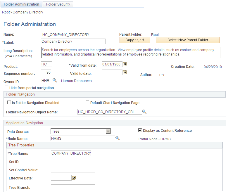

Folder Administration Page
PORTAL_FLDR_ADM
Update the portal folder definition for the Company Directory.

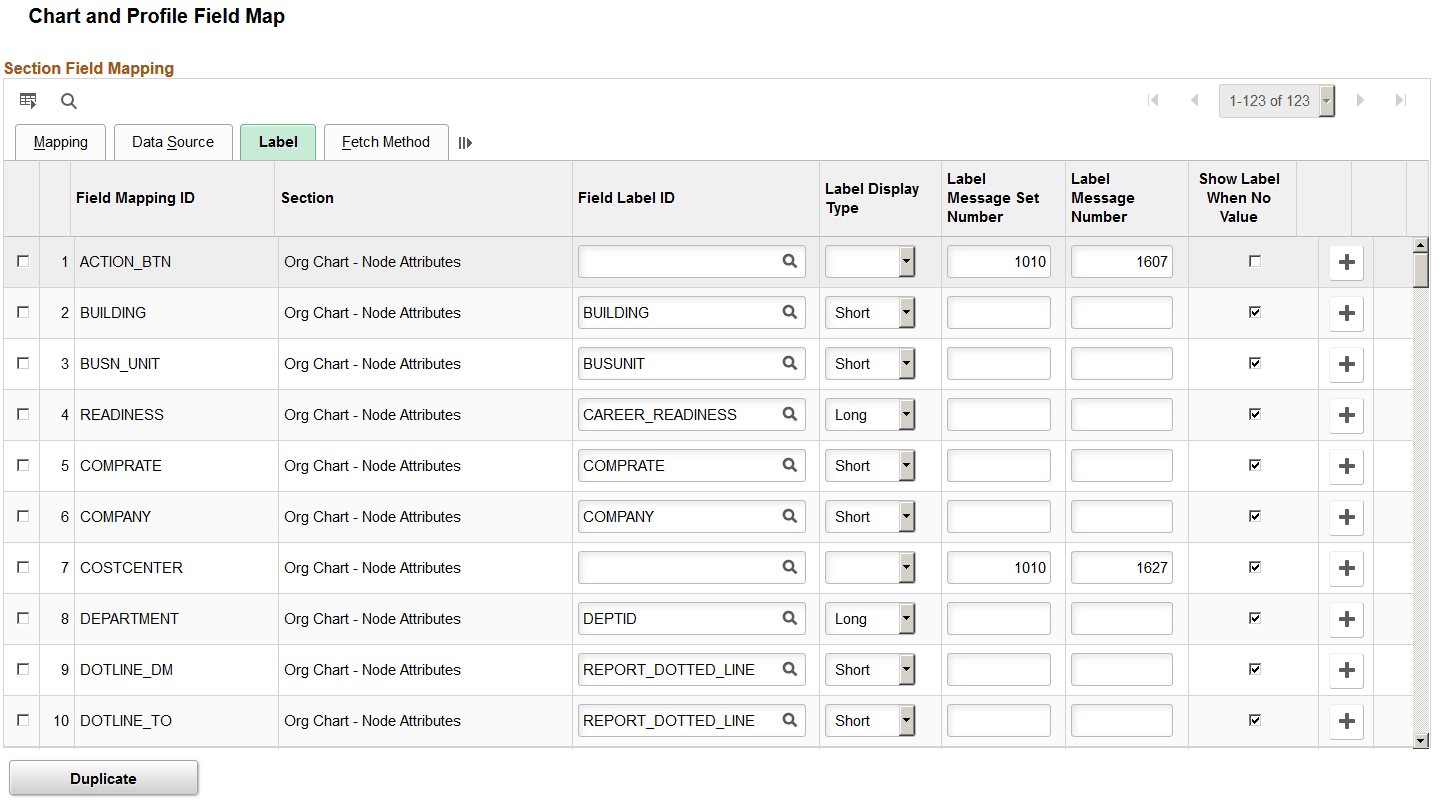

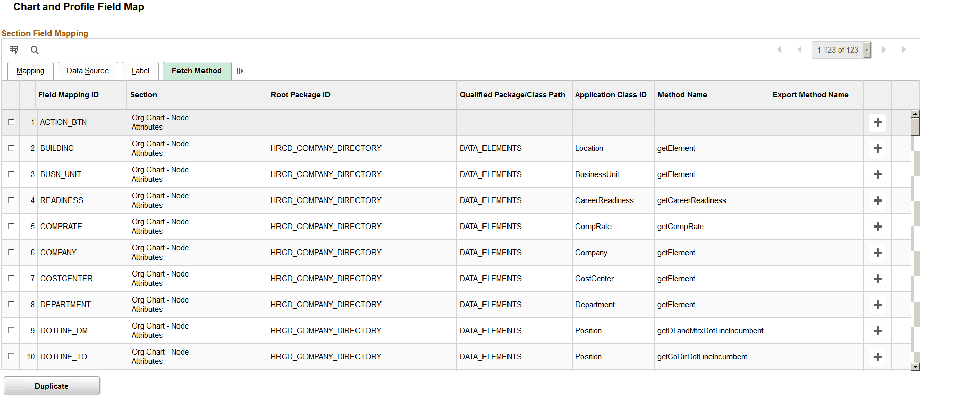

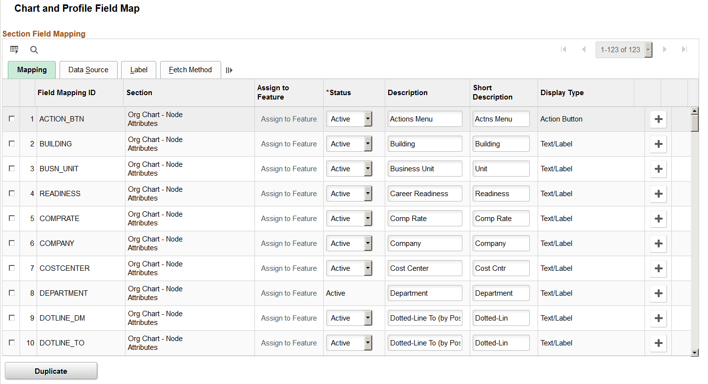

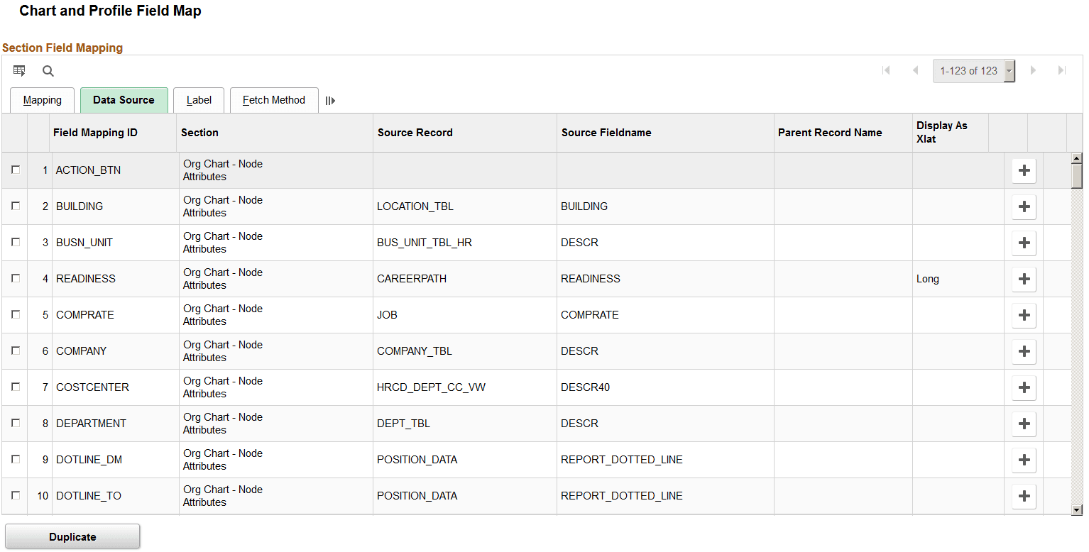

Chart and Profile Field Map Page
HRCD_SETUP_FLD_MAP
Define the org chart and profile field page mappings. Maintain or add additional fields that should be available on the Org Chart and Profile pages of the Org Chart Viewer.

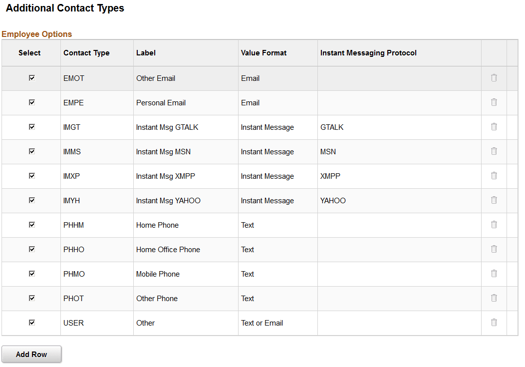

Additional Contact Types Page
HRCD_ADDTL_CNTCT
Define additional contact types that will be available to the user on the Profile, Edit Additional Contacts page of the Company Directory.

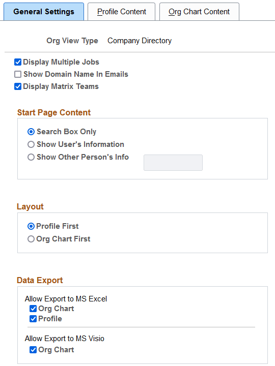

Chart and Profile Settings - General Settings Page
HRCD_SETUP_GENERAL
Define default startup page content and layout settings for each org view type.

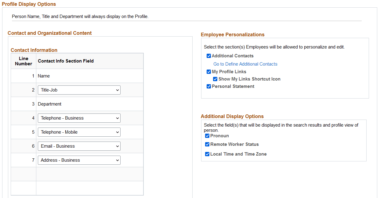

Chart and Profile Settings - Profile Content Page
HRCD_SETUP_PROFILE
Select the contact information, HR details, and employee personalization field options that should appear on the Profile page for each org view type.

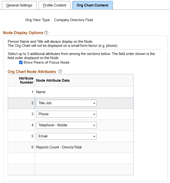

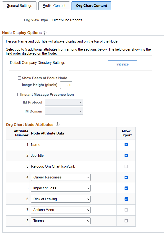

Org Chart Content Page
HRCD_SETUP_OC_NODE
Select the organization chart field options that should appear on the Org Chart page for each org view type.

  3. Update the Company Directory (HC_COMPANY_DIRECTORY) folder definition to ensure the tree name is equal to the tree created in step 1. This information is used for the Org Chart Viewer, Company Directory folder.
    This step needs to be performed any time the tree name is changed.
    See Folder Administration Page.

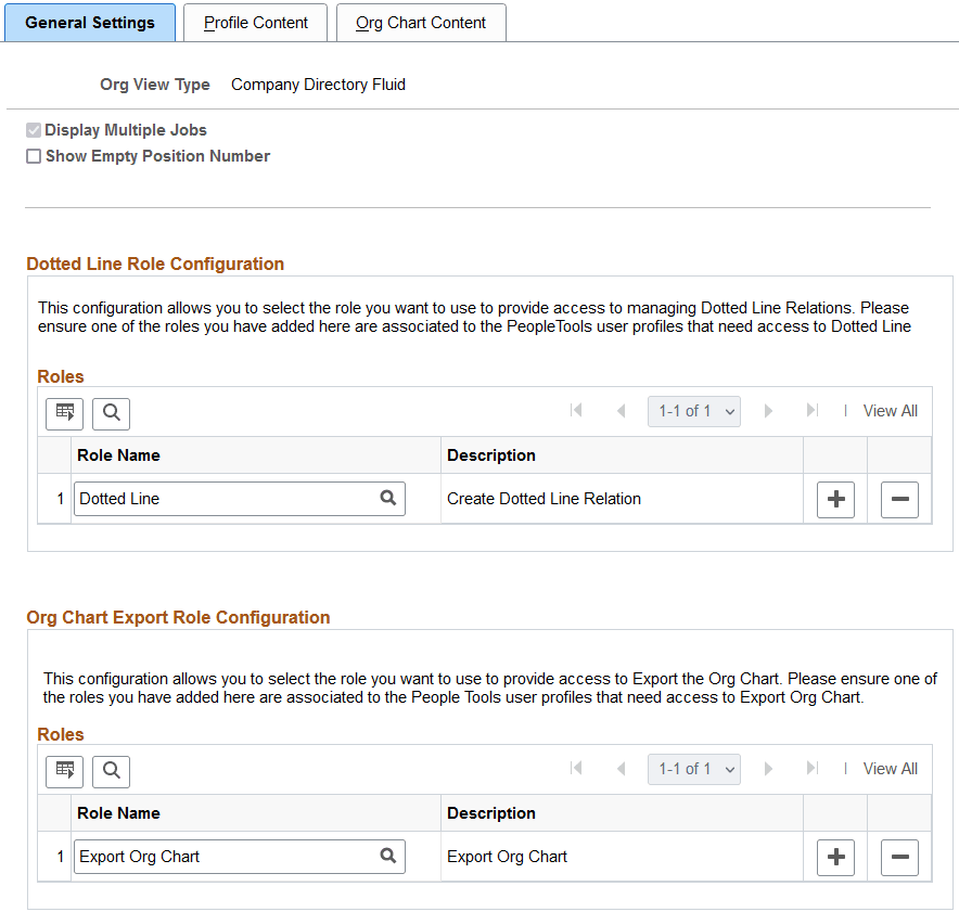

Understanding the PeopleSoft Fluid User Interface for the Company Directory
The Fluid Company Directory uses much of the same setup as you would to support the company directory on a workstation or mobile devise (see Understanding the Org Chart Viewer and Company Directory Setup Steps). Remember these important steps when working with the Fluid Company Directory feature:

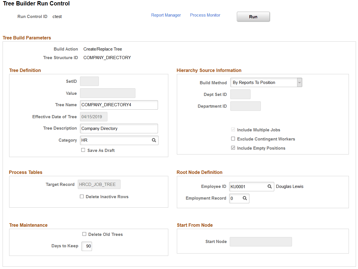

Tree Builder Run Control Page
Use the Tree Builder Run Control page (HR_TREEBLD_RNCTL) to run the Job Tree Builder process to create or rebuild an entire tree, update a portion of a tree starting from a specific node, or update the tree's source data table without making any alterations to an existing tree.
Navigation:
  • Set Up HCM, and then Common Definitions, and then Org Chart Viewer, and then Tree Builder Run Control
  • Set Up HCM, and then System Administration, and then Utilities, and then Job Tree Builder, and then Tree Builder Run Control
This example illustrates the fields and controls on the Tree Builder Run Control page. You can find definitions for the fields and controls later on this page.
Use the Job Tree Builder (HR_TREEBLD_RNCTL) component to create trees. You can use trees to define your reporting structures for the Company Directory and Matrix Teams configured to use a tree.
The Job Tree Builder Run Control page executes the HR_TREEBLD Application Engine process. This process creates trees of jobs using the selected Build Method option.

Field or Control Description
Build Action
Indicate whether you want to create or rebuild an entire tree, update a portion of a tree starting from a specific node or location on a tree, or update the trees source data table without making any alterations to an existing tree. Valid values are:
  • Create/Replace Tree
    Creates a new tree or, if a tree exists for the Tree Definition parameters entered on this page, deletes and recreates the tree.
  • Update Existing Tree-From Node
    Updates an existing tree from a tree node identified in the Start Node field. The start node cannot be a root node from an existing tree. All nodes under the selected tree node will be refreshed according to the hierarchy Build Method selected.
  • Update Process Tables Only
    No tree processing occurs. The target table is updated, enabling you to manually add new Jobs added by the process to the tree using Tree Manager.
Tree Structure ID
Select a tree structure ID. The value selected in Tree Structure ID field determines the fields that are required to uniquely identify a tree and it tells the process which type of tree it should build when the process is run.
For example, Matrix Teams use the MATRIX_BY_JOB tree structure ID and Company Directory trees use the COMPANY_DIRECTORY tree structure ID.
Note: If you are building a job tree for the Company Directory or Matrix Teams, you must enter the corresponding Tree Structure ID values.
The system uses the HR_JOBTREE_META table to retrieve meta-data from the tree structure ID to auto-populate the following fields on this page: Set ID, Tree Name, Tree EffDt, Tree Description, Category, Target Record, and Exception Table. The tree structure ID also determines the fields that are required in the Tree Definition group box.
Tree Definition
Many of the fields in this group box are available when the Build Action values Create/Replace Tree and Update Existing Tree-From Node are selected.
SetID and Value
Enter the set ID and set control value of the tree, if applicable. Availability of this field depends on the configuration of the tree structure ID.
For example, these fields are not available when using the COMPANY_DIRECTORY or MATRIX_BY_JOB tree structures required by the Org Chart Viewer, Company Directory or Matrix Teams features.
Tree Name
Enter the name of the tree.
This field is available when the Create/Replace Tree and Update Existing Tree-From Node Build Action values are selected.
Note: For the Company Directory to work properly, you need to update the portal definition to use the same tree name you have identified here.
Effective Date of Tree
Enter an effective date for the tree. If a date is not provided, the process will use the system date when creating the tree. This enables you to leave this field blank and set up the run control as a recurring process.
This field is required for the Update Existing Tree-From Node build action. When updating an existing tree, you must point the process to a unique tree, so an effective date is required. When you select the Update Existing Tree-From Node build action option, this field provides by default the current tree for the SetID, Set Control Value, and Tree Name field values you entered on this page. SetID and Set Control Value field values may not be required for all tree structure IDs.
This field is available when the Build Action values Create/Replace Tree and Update Existing Tree-From Node are selected.
Tree Description
Enter the description of this tree.
This field is available when the Build Action value Create/Replace Tree is selected.
Category
Enter the tree category for a tree.
Save As Draft
Select this check box when you want to save the tree in draft mode. To change the status of the tree, run the process again with the Save As Draft check box deselected or save the draft as a valid tree through Tree Manager.
Hierarchy Source Information
Use this group box to specify how the system should define the hierarchical structure of the tree. The fields in this group box are available when the Build Action values Create/Replace Tree and Update Existing Tree-From Node are selected.
Build Method
Select the method the process will use for deriving reporting relationships based on Job Data.
Valid Build Method options are:
  • By Department Manager ID
  • By Part Posn Mgmt Dept Mgr ID
  • By Part Posn Mgmt Supervisor
  • By Report To Position (Number)
  • By Supervisor ID
    For the first five build methods listed here, the Job Tree Builder process uses the existing Direct Reports API data service to determine the reporting structure for building the job tree. This data service is capable of navigating an organization structure and returning a list of workers that report to a particular manager.
    Also, for these build methods, the process uses Employee ID/Empl Record entered on the Tree Builder Run Control page to set the root node of the job tree. The process then determines the jobs reporting to the root node by making a request to the Direct Reports API data service using the Build Method, Employee ID/Empl Record, and Tree EffDt entered on the run control page. Nodes are created for all jobs returned by the data service. This process is repeated down the reporting chain for every job in the hierarchy.
    See Application Fundamentals: Understanding Direct Reports Functionality.
  • By Dept Security Tree
    The method is available only with the build action Create/Replace Tree.
    This build method does not use the Direct Reports API to determine a reporting structure. Instead, this build method uses the department security tree and the manager information for the departments to determine the reporting structure.
    To build the job tree, the process traverses the specified department security tree starting from the department node specified. For each department node in the department security tree, the process determines the node's manager, and then creates a tree node for each of the department managers. For each manager node, the process creates nodes for the department members reporting to the appropriate department manager. If an employee reports to a department that is not assigned to an active manager, then the process assigns that employee to the next manager up the tree.
    Departments can have the following manager types: Manager ID, Manager Position, or not be assigned to a manager.
    If Position Management is being used, a department may be assigned to a Manager Position that could be associated to multiple active incumbents.
    See Application Fundamentals: Maintaining Departments.
    Note: When creating trees using By Dept Security Tree, it is recommended that you audit the source Dept Security tree and run the Repair Tree utility on the source Dept Security Tree to correct any invalid level numbers. For this build method, the Job Tree Builder assumes the level numbers for the nodes to be correct.
    See PeopleTools: PeopleSoft Tree Manager, "Auditing and Repairing Trees" for more information on the Repair Tree utility.
Dept Set ID (department set ID) and Department ID
Enter the department set ID and department code when you select the Build Method option By Dept Security Tree. The batch process will start from this department in the Dept Security tree and work downwards from that node.
When you enter or change the Dept Set ID value, the Department ID field provides the root node of the Dept Security tree as a default value and the Root Node Definition fields default the employee ID associated with the department of the root node. If the department is assigned to a manager position, the Employee ID field will provide by defaulted the lowest employee ID of the active incumbents of that position.
Include Multiple Jobs
Indicates if the tree is to include nodes for both primary and non-primary jobs. If this field is not selected, only nodes for active primary jobs will be included in the tree.
For the tree structure ID COMPANY_DIRECTORY, this value comes from the Chart and Profile Settings - General Settings page and the check box is not available on this page.
Note: For the tree structure ID COMPANY_DIRECTORY, if you have selected the Display Multiple Jobs check box on the Chart and Profile Settings - General Settings page, the system will allow additional jobs in the search only when these jobs are present in the tree. Therefore, if you change the Display Multiple Jobs setting on the Chart and Profile Settings - General Settings page, you should run the Job Tree Builder process to ensure that all jobs are captured on the tree.
Exclude Contingent Workers
Select to exclude contingent workers who do not have direct reports.
Note: To maintain the integrity of the hierarchy, contingent workers with active direct reports are always included in the tree, whether or not this check box is selected.
Include Empty Positions
Select to include empty positions within your Company Directory tree. When you build your tree with this check box selected, empty positions will display within the fluid Company Directory pages.
This option is available when your organization uses partial or full Position Management and you select a Build Method that is position-based (By Part Posn Mgmt Dept Mgr ID, By Part Posn Mgmt Supervisor, or By Reports To Positions).
This video provides and overview of viewing empty positions on the Company Directory:
Video: Image Highlights, PeopleSoft HCM Update Image 28: Company Directory-Display Empty Positions
Process Tables
Target Record
The Target Record field is display only. This field is populated based on the Tree Structure ID value. The target record refers to the table containing the source data for all trees created using the selected Tree Structure ID.
Delete Inactive Rows
Select this check box to have the process delete rows in the process table associated with inactive employee jobs.
The fields in this group box are available when the Build Action value Create/Replace Tree is selected.
Employee ID and Employment Record
Enter the employee ID and his or her employment record number that should serve as the topmost node, or root node, of the tree.
Tree Maintenance
Delete Old Trees
Select this check box for the process to delete trees older than the number of days listed in the Days to Keep field.
Days to Keep
Indicate the number of days back to keep trees.
Start From Node
The field in this group box is available when the Build Action value Update Existing Tree-From Node is selected.
Start Node
Select a node from the tree specified in the Tree Definition group box of the page.
The Job Tree Builder process will delete any nodes reporting directly or indirectly to the start node specified. Then it will create nodes based on the Build Method value selected.
Note: Depending on how the existing tree was created, an employee may have multiple nodes in the existing tree. For example, this can occur when: - The employee has or had multiple jobs. - The employee reports to a position that has or had multiple incumbents. - The employee is or was assigned to a department with multiple managers (Manage Positions with multiple incumbents). If the prompt list shows multiple nodes for the same person, then review the tree in Tree Manager to ensure that you are selecting the appropriate start node.
Use the Folder Administration page (PORTAL_FLDR_ADM) to update the portal folder definition for the Company Directory.
The portal folder HC_COMPANY_DIRECTORY is delivered to use the tree name COMPANY_DIRECTORY. If your organization uses another name, you will need to update the portal folder definition in order for the Company Directory to work properly to match the tree name you entered when creating your tree.
Navigation:
PeopleTools, and then Portal, and then Structure and Content
Click the Edit link for the Company Directory folder.
This example illustrates the fields and controls on the Folder Administration page. You can find definitions for the fields and controls relevant to the Company Directory later on this page.
Folder Administration page for the Company Directory
Element Definition
Enter the tree name you used when building the tree for the Company Directory. This tells the Company Directory where to find the structure for the portal breadcrumbs and org chart.
For trees based on the tree structure ID of COMPANY_DIRECTORY, the system uses the required Tree Name field to uniquely identify a tree. The delivered field value is COMPANY_DIRECTORY, but the Company Directory will work with any tree name as long as you created the tree based on the COMPANY_DIRECTORY tree structure ID.
Effective Date
(Optional) Enter the effective date for the tree.
If this field is populated, the Company Directory uses the effective date of the Tree Name value identified on the Folder Administration page.
If this field is blank, the Company Directory uses the current effective dated tree identified in Tree Name field.
Leaving this field blank enables you to run a nightly process that creates a new effective-dated version of the tree. If the Effective Date field is left blank, you do not need to make any changes to the Folder Administration page because the Company Directory will always use the current tree.
For more information and details on setting up and working with the portal folders, see PeopleTools: PeopleTools Portal Technologies, "Administering Portals," Understanding Folder Administration.
Use the Chart and Profile Field Map page (HRCD_SETUP_FLD_MAP) to define the org chart and profile field page mappings.
Navigation:
Set Up HCM, and then Common Definitions, and then Org Chart Viewer, and then Chart and Profile Field Map, and then Chart and Profile Field Map
This example illustrates the fields and controls on the Chart and Profile Field Map page: Mapping tab. You can find definitions for the fields and controls later on this page.
Use the Chart and Profile Field Map component to define the data elements that are configured in the Chart and Profile Settings pages as well as the Talent Summary setup pages. This component has four tabs that you use to define the rules for fetching and displaying each data element.
Mapping Tab
Use this tab to map the data elements.
The delivered data that appears on this tab cannot be modified except for Status, Description, and Short Description.
Section
Enter the section that is located on the various pages to which this field should be mapped. Valid values are Profile - HR Details, Profile - Contact Information, General, and Org Chart - Node Attributes.
Note: The General field option is used for the Talent Summary feature.
Assign to Feature
Click this link to open the Org View Mapping page and identify which org view types will have access to use this field. If an org view type is not selected, this field will not be available in the Chart and Profile Settings component.
Status
Indicate if this field is Active or Inactive. Inactive fields will not be available for selection on the setup pages.
Description and Short Description
Enter the field description that should display in the drop-down list of the setup pages. You select which description to use on the Label tab.

Data Source Tab
Use this tab to identify the source record information specific to the data element.
This example illustrates the fields and controls on the Chart and Profile Field Map page: Data Source tab. You can find definitions for the fields and controls later on this page.
The delivered data in this tab cannot be modified.
Source Record
Indicate the record from which the field element is derived.
Source Fieldname
Indicate the field name of the source record from which the field element value is derived.
Parent Record Name
Identify the intermediate record needed to get from the Org Chart Viewer to the data to be displayed by the respective data element class. This is not necessarily the source record’s parent record.
Display as Xlat
If the source field is defined to use the Translate Table, then specify if the field should display the long or short name.
Label Tab
Set label information for the data element that will display in the Org Chart Viewer.
This example illustrates the fields and controls on the Chart and Profile Field Map page: Label tab. You can find definitions for the fields and controls later on this page.
The delivered data that appears on this tab can be modified.
Field Label ID
Enter the field label ID that should be used to display on the Org Chart Viewer pages. For example, the PHONE_CELL field would use the Field Label ID MOBILE to differentiate it from other phone types, such as work phone.
Label Message Set Number and Label Message Number
Enter the message number for this field mapping. Enter the number that will identify the label that should be used for the field on the Org Chart Viewer pages.
Do not use these fields if you have entered a value in the Field Label ID field.
Show Label When No Value
Select to display the field label even when there is no value to display. For example, If an employee does not have peers, the peers label will still display but with no names listed after it on the Profile page.
Fetch Method Tab
The tab is used to assign the code used for fetching and displaying the data element.
This example illustrates the fields and controls on the Chart and Profile Field Map page: Fetch Method tab. You can find definitions for the fields and controls later on this page.
The delivered data in this tab cannot be modified, but new rows can be added.
Qualified Package/Class Path
Displays the qualified package/class in the root package ID that resolves the field mapping element value.
Application Class ID
Displays the application class ID in the qualified package/class path that resolves the field mapping element value.
Note: Any class assigned here must be inherited from HRCD_COMPANY_DIRECTORY:DATA_ELEMENTS: DataElementBase.
Method Name
Displays the method name in the application class ID that resolves the field mapping element value.
Note: Field mapping IDs that are configured to use a method name getElement are using the logic inherited from the base class.
Export Method Name
Displays the method name in the application class ID that resolves the export data for the field mapping element. An export method is only required when if the logic in the class assigned to method name is not also compatible with export.
Use the Additional Contact Types page (HRCD_ADDTL_CNTCT) to define additional contact types that will be available to the user on the Profile, Edit Additional Contacts page of the Company Directory.
Navigation:
Set Up HCM, and then Common Definitions, and then Org Chart Viewer, and then Additional Contact Types, and then Additional Contact Types
This example illustrates the fields and controls on the Additional Contact Types page. You can find definitions for the fields and controls later on this page.
Select
Select the contact types that should be available to the user on the Edit Additional Contacts page when the user updates his or her additional contact information on the Profile page of the Org Chart Viewer. If you deselect an option, this contact type will not be available to the user.
The following contact types are delivered selected:
  • EMOT - Other Email
  • EMPE - Personal Email
  • PHHM - Home Phone
  • PHHO - Home Office Phone
  • PHMO - Mobile Phone
  • PHOT - Other Phone
  • USER - Other
Contact Type
Enter a unique four letter code to identify the contact type. This page sorts the contact types by the code. However the Edit Additional Contacts page accessible from the Profile pages of the Org Chart Viewer sorts them by label name.
Label
Enter the name of this type of contact. This value will appear in the Contact Type drop-down list and as the label, of display as, name on the add or edit contact pages. This label will appear on the Profile pages of the Org Chart Viewer when a user selects and enters a value for this contact type.
The following text or email contact types are delivered with the system:
  • BPHO – Business Phone
  • EMOT – Other Email
  • EMPE – Personal Email
  • PHHM – Home Phone
  • PHHO – Home Office Phone
  • PHMO – Mobile Phone
  • PHOT – Other Phone
  • USER - Other
The following instant messaging contact types are delivered with the system:
  • IMGT – Instant Msg GTALK
  • IMMS – Instant Msg MSN
  • IMXP – Instant Msg XMPP
  • IMYH – Instant Msg YAHOO
These labels are display-only for the user with the exception of the Other field. The contact type Other enables users of the Company Directory to enter their own label or field description for a contact type.
Value Format
Select the format the system should use for this field. Options are Email, Instant Message, Text, and Text or Email.
Instant Messaging Protocol
Identify the IM protocol that should be associated with this IM contact type. Valid values include GTALK, MSN, XMPP, and YAHOO. This field is available when you select Instant Message from the Value Format field.
With the delivered IM contact types, the field displays the associated IM protocol type.
Add Row
Click this button to add additional contact types in the Employee Options group box. This will open up free-form text fields in which the administrator can enter the field labels and determine the value format that will be available to the user.
Use the General Settings page (HRCD_SETUP_GENERAL) to define default startup page content and layout settings for each org view type.
Navigation:
Set Up HCM, and then Common Definitions, and then Org Chart Viewer, and then Chart and Profile Settings, and then General Settings
This example illustrates the fields and controls on the Chart and Profile Settings – General Settings page for the Company Directory Fluid org view type.
Chart and Profile Settings - General Settings page for the Company Directory Fluid org view type
This example illustrates the fields and controls on the Chart and Profile Settings – General Settings page for the Company Directory org view type.
Chart and Profile Settings - General Settings page for the Company Directory org view type
This example illustrates the fields and controls on the Chart and Profile Settings – General Settings page for the Direct-Line Reports and Matrix Reports org view types.
Chart and Profile Settings - General Settings page for the Direct-Line Reports and Matrix Reports org view types
Field Availability on the General Settings Page by Org View Type
These tables list the field elements available on the Chart and Profile Settings - General Settings page according to the Org View Type value you select:
Fields at the top of the page:
The following field elements are available at the top of the page for the mentioned org view types:

Dotted Line Role Configuration group box:
The following field elements are available in the Dotted Line Role Configuration group box for the mentioned org view type:
Page Element Company Directory Fluid
Role Name
Yes
This video demonstrates the dotted line role configuration feature:

General Settings
Use the first several check boxes on the General Settings page to specify the amount of detail the system should display about a person.
This field is available for selection for the Company Directory org view type.
Select to have the Company Directory search feature return all multiple job or additional job rows for a person. Deselect this option to have the system display the primary job only for the person.
Note: For the Company Directory Fluid org view type, this field is display only and comes from the setting that was selected for the Company Directory org view type.
When you select this check box, the Title-Job fields on the Profile Content and Org Chart Content pages will be automatically selected. Also, the Company Directory - Profile page will display the Additional Jobs field in the HR Details group box.
Note: Selecting the Display Multiple Jobs check box will allow additional jobs in the search only when these jobs are present in the tree. You may need to refresh the tree using the Job Tree Builder component or update the tree manually in Tree Manager.
See Tree Builder Run Control Page.
This field is available for the Company Directory Fluid Org View Type.
Role Name
Select the role or roles that will provide a user access to the Profile - Manage Dotted Line Page, where a person can create or remove dotted line reporting relationships.
The PeopleSoft application delivers the Dotted Line role for this purpose, but you can identify other roles that should be granted access to the dotted line pages. You must ensure that at least one of the rows entered here is associated with a user’s profile.
Note: If no roles are defined in this setup grid, users will not be able to manage dotted line relationships in the Company Directory profile pages.
Org Chart Export Role Configuration
Role Name
Select the role or roles that will provide a user the ability to export the org chart data from the Organization Chart Page. When you enter a role here and assign this role to the user, the Export to Excel and Export to Visio menu items will be available from the Actions List.
The PeopleSoft application delivers the Export Org Chart role for this purpose, but you can identify other roles that should be granted access to export org chart functionality from the Actions List menu of the Company Directory Org Chart page. You must ensure that at least one of the rows entered here is associated with a user’s profile.
Note: If no roles are defined in this setup grid, users will not be able to export the Company Directory organization chart from the fluid pages.
Start Page Content
These fields are available for the Company Directory Org View Type.
Use this group box to specify the default settings for the Company Directory start page. Choose from one of the three options to define what information the system should display to the user when first accessing the Company Directory. Users can override this default setting by defining their own preferences.
Search Box Only
Select this option to display the search field only, where you can search by name, job title, department, or email for any active person in the system. You will also have the option to use an advanced search, where you can enter additional search criteria.
Show User's Information
Select this option to have the system display the information of the user accessing the Org Chart Viewer pages. The user will appear as the focus of the node or Profile page, depending on the layout setting selected.
The search field is also available at the top of the page when you select this option.
Show Other Person's Info
Select this option and enter a person’s employee ID in the accompanying field to have the system display the information of this employee on the startup page. The identified person will appear as the focus of the node or the Profile page, depending on the layout setting selected.
Note: In order to populate this field, a tree must already be created and the tree name must match the Tree Name provided on the portal folder definition HC_COMPANY_DIRECTORY. For more information, see PeopleTools: PeopleTools Portal Technologies, "Administering Portals," Managing Portal Objects.
See Org Chart Viewer - Preferences Page.
Layout
These fields are not available for the Company Directory Fluid org view type.
Use this group box to define which page of the Org Chart Viewer pages the system should display first. The value you select here will determine the page order. The user can override these default settings by defining personal preferences.
Profile First
Select this option to have the system display the Profile page for the focus person. The Profile page displays detailed information about the person, such as contact information, HR details, and personalized links and information. This option will also display the Profile page as the first page in the component.
Org Chart First organizational chart first
Select this option to have the system display the Org Chart page. The Org Chart page displays a multi-leveled graphical representation of the focus person’s reporting structure, as well as high-level details about this person. This option will also display the Org Chart page as the first page in the component.
Data Export
Use this group box to enable exporting options for the user.
Allow Export to MS Excel (allow export to Microsoft Excel) – Org Chart and Profile
Select these check boxes to enable the user to export profile or org chart information to a Microsoft Excel spreadsheet.
Users will be able to export the following hierarchical reporting details:
  • Focus node’s manager.
  • Focus node.
  • Focus node’s siblings if such is selected to display using the Org Chart tab setting.
  • Focus node's hierarchy (from focus node down); all of the manager’s direct or dotted-line (matrix) reports, and their indirect reports.
Allow Export to MS Visio – Org Chart
Select this check box to enable the user to export org chart information to a Microsoft Visio drawing.

Contact and Organizational Content
Select fields in this group box that should appear on the Profile page. This information comes from the HR tables. The field elements in this group box are available for all org view types unless otherwise specified.
Contact Information
Select contact-related fields that will appear as person profile data in the Contact Information group box or page of the Company Directory - Profile page.
Note: Although the Contact Information section will display the fields in the order you select, it will first group the information in the following contact type order and then by the order you select: 1. Phone number types 2. Email types 3. Address types 4. Other For example, you have defined the following sort order: Address- Business Telephone - Mobile Email - Business Telephone - Business The Contact Information section will display phone number contacts first, then email contacts, then addresses, with each group sorting the content within those contact types according to your defined order. In this scenario it would appear like the following: Telephone - Mobile Telephone - Business Email - Business Address- Business
Valid field values are:
  • Name
    This field display is always selected and listed as line number 1.
  • Title-Job
    For the Company Directory org view type, Title - Job is always selected for line number 2 when Display Multiple Job is selected on the Chart and Profile Settings - General Settings Page. If Display Multiple Job is deselected, then you have the option of selecting Title-Job or leaving this field blank.

Employee Personalizations
Use information in this group box to determine which personalization group boxes should appear on the right side of the Profile page.
Additional Contacts
Select this option to enable the user to add or edit contact information on the Profile page. When a person has added additional contact information, it will also appear on the page.
If you deselect this option, the Profile page will not display additional contact information added by a person and users will not be able to add other contact information in the company directory.
Go to Define Additional Contact Types link
Click this link to access the Additional Contact Types page to add or review contact types.
See Additional Contact Types Page.
My Profile Links
Select this option to have the My Profile Links group box available on the Profile page. Profile links enable the user to define shortcut links to other web sites.
When you select this option, the Show My Links Shortcut Icon check box on this page will be available for selection.
If you deselect this option, the My Profile Links group box will not be available on the Profile page.
Select this check box to have the shortcut icons associated with target web addresses appear next to the label entered by the user. Some sites may or may not have a default shortcut icon. For example, when this check box is selected, and the user enters the web address for Oracle (http://oracle.com), the following icon will appear next to the label name.
This option is available when the Display My Profile Links check box is selected.
Personal Statement
Select this option to have the Personal Statement group box available on the Profile page. This functionality enables the user to enter personalized text. Users will update their personal statement using the Rich Text Editor.
See PeopleTools: Using PeopleSoft Applications, "Using PeopleSoft Application Pages," Working With the Rich Text Editor
If you deselect this option, the Personal Statement group box will not be available on the Profile page.
Additional Display Options
This section is only available for the Company Directory Fluid org view type.
This video demonstrates the additional display configuration options:
Video: Image Highlights, PeopleSoft HCM Update Image 45: Additional Display Configurability for Company Directory
Pronoun
Note: Gender Identity functionality must be enabled on the Installation Table - Application Fundamentals: HCM Options Page for this section to appear and to use this feature.
Select to display a person's pronouns on the Fluid Company Directory pages to help others know how to address a person. (See also Using the PeopleSoft Fluid User Interface for the Company Directory and Company Directory Profile Page Layout).
The pages will only display pronouns for those who have provided pronouns (see the employee self service PeopleSoft eProfile: Gender Details Page and the administrator Biographical Details Page of Personal Data). When an employee has not specified a pronoun, the pronouns will not appear on the Company Directory.
These videos provide an overview of the gender identity functionality:
Video: Image Highlights, PeoleSoft HCM Update Image 41: Gender Identity and Expression
Video: PeopleSoft Gender Identity and Expression
Remote Worker Status
Select to have the Fluid Company Directory display a person's remote worker status on the home page and other areas that display a grid of employees.
Note: This setting does not control the display of the Profile - Remote Worker Status Page on the Company Directory page. The page will appear if the employee has a remote worker request in the system, regardless if you select this option.
Local Time and Time Zone
Select to have the Fluid Company Directory display the person's local time and time zone on the home page and other areas that display a grid of employees.
Selecting this check box will also enable an edit time zone option when individuals are on their own profile to specify their time zone.
Use the Org Chart Content page (HRCD_SETUP_OC_NODE) to select the organization chart field options that should appear on the Org Chart page for each org view type.
Navigation:
Set Up HCM, and then Common Definitions, and then Org Chart Viewer, and then Chart and Profile Settings, and then Org Chart Content
This example illustrates the Org Chart Content page for org view types Company Directory, Direct-Line Reports, and Matrix Reports.
This example illustrates the Org Chart Content page for the Company Directory Fluid org view type.
Node Display Options
Initialize
Click this button to have the system provide by default the same settings you established for the Company Directory org view type.
This field element is available for the following org view types: Direct-Line Reports and Matrix Reports.
Show Peers of Focus Node
Select this check box to have the system display peers within the same reporting structure level of the focus person. Deselect this check box to show only the focus person at the middle level of the organizational chart. The report to and subordinate nodes will still display for this person, if applicable.
Image Height (pixels)
Enter size in which the height of an employee picture should appear within the node. This option is available when the Display Photo check box is selected on the Application Fundamentals: HCM Options Page of the Installation Table.
This field element is not available for the Company Directory Fluid org view type.
The Instant Message field elements are not available for the Company Directory Fluid org view type.
Instant Message Presence Icon
Select this check box to have the Org Chart node display the IM icon for a person, if IM information exists in the HR person model. Instant Message IDs for a person can be stored on the Contact Information page of personal data in HR.
IM Protocol (instant messaging protocol)
Identify the IM protocol that the system should use when displaying the IM icon. Valid values include GTALK, MSN, XMPP, and YAHOO. If a person does not have an IM protocol type defined in his or her personal data, the icon will not display for this person. This field is available when you select the Instant Message Presence Icon check box.
IM Domain
Displays the Instant Message domain associated with the IM Protocol you selected for all protocols except XMPP. For XMPP, you must select the value of the XMPP server that has been defined by your organization.
See PeopleTools: PeopleSoft MultiChannel Framework, "Configuring Instant Messaging in PeopleSoft MultiChannel Framework"
Org Chart Node Attributes
Select field attributes that will display in the individual nodes of the chart on the Org Chart page. The fields within the node will appear in the order of the attribute line number. Valid values for line numbers are:
  • Name
    This field is always selected and listed as line number 1.
  • Title-Job
    For the Company Directory Fluid org view type, Title-Business, Title-Job, and Title-Position are available for selection on line number 2. If you leave this flied blank, the system displays the job title.
    For the other org view types, Title-Job value is always selected.
These values are available for selection for the Company Directory Fluid org view type:
  • Email
  • Telephone – Mobile
  • Phone
  • Reports Count – Directs/Total – This field attribute is always selected for line number 6.
These remaining field selections discussed here apply to the following org view types: Company Directory, Direct-Line Reports, and Matrix Reports, unless otherwise noted.
  • Refocus Org Chart Icon/Link
    This field is always selected and listed as line number 3. This link appears in each node of the organization chart and enables you to change the focus node to another individual.
  • Action Menu
    Action Menu is the only field display option available for line number 7.
    Select this field display option if you want to enable the user to perform self service transactions from his or her profile, such as an address or name change, or to perform these transactions for a direct or indirect report.
    The Action Menu values are configured through PeopleSoft Related Content Services. This framework enables developers and subject matter experts to link application pages with contextually relevant collaborative content.
    For more information, see PeopleTools: PeopleTools Portal Technologies, "Developing and Configuring Related Content"
These values are available for the remaining line numbers.
  • Building
  • Business Unit
  • Company
  • Cost Center
  • Department
  • Dotted-Line To
  • Email - Business
  • Floor Nbr
  • Job Family
  • Job Function
  • Location
  • Manager Level
  • Regular/Temporary
  • Reports Count - Directs
    The Reports Count – Directs option will show the number of employees that directly report to this individual.
  • Standard Hours
  • Standard Work Period
  • Telephone - Business
  • Telephone - Mobile
  • Union
  • Years of Service
These options are specific to the Company Directory org view type.
  • Reports Count - Directs/Total
    The Reports Count – Directs/Total options will show the number of employees that directly report to this individual as well as the total number of subordinate workers that report indirectly to this person.
  • Reports Count - Total
    The Reports Count - Total option will show the total number of subordinate workers that report up through this person.
These values are specific to the Direct-Line Reports and Matrix Reports org view types:
  • Career Readiness *
  • Comp Rate *
  • Employee ID
  • Impact of Loss *
  • Organizational Relationship
  • Risk of Leaving *
  • Salary Plan/Grade/Step *
    Note:* These field elements are considered to be sensitive data. Sensitive data will only display if the employee reports to the signed-in user, hence the user will only see this information for his or her subordinates.
When there is an empty position, only these values will display, if selected:
  • Dotted-Line To (by Position)
  • Job Family
  • Job Function
  • Manager Level
  • Reports Count – Total
Attribute number 8 enables you to display either the Teams or Other Teams link in a node for a person who is part of a matrix team. If the person is not part of a matrix team, the link will not appear in the node. Valid values are:
  • Teams
  • Other Teams
Allow Export
Select this check box to enable the user to export this field content. This option is not available for the Company Directory Fluid org view type.
