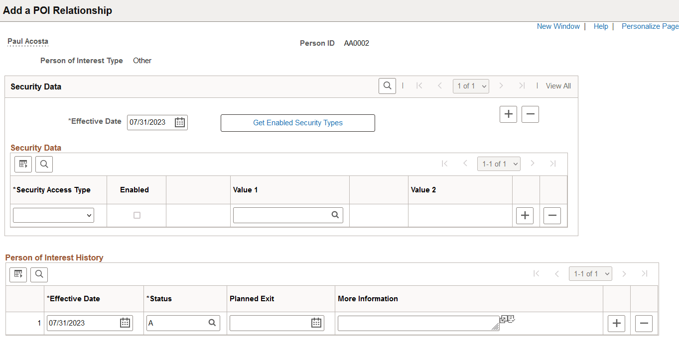

(Classic) Add a POI Relationship or Maintain Person of Interest Page
Use the Add a POI Relationship page or Maintain Person of Interest page (PER_POI_TRANS) to set up and maintain a person of interest's POI type and security access keys using the classic pages.
Navigation:
  • Workforce Administration, and then Personal Information, and then Organizational Relationships, and then Add Person of Interest, and then Add a POI Relationship
  • Workforce Administration, and then Personal Information, and then Organizational Relationships, and then Maintain Person of Interest, and then Maintain Person of Interest
This example illustrates the fields and controls on the Add a POI Relationship page.

Security Data
Field or Control Description
Get Enabled Security Types button
Click to add a row to the Security Data grid for each security type that has been enabled for the people without jobs.
Note: You can enter data for a type that has not been enabled, allowing you to capture additional data on a POI without a job without having to modify the system. To do this, you must create a new security type on the Security Access Type page for the People without Jobs Security Set and enter a new field name. Then use the new field name in this component and capture the required data for this POI.

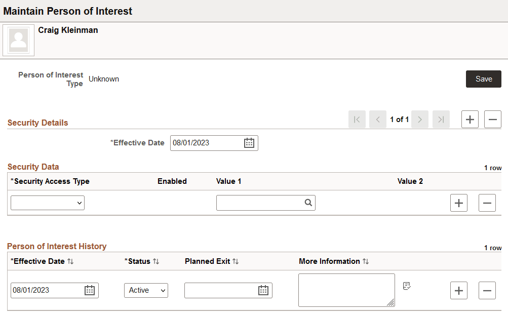

(Fluid) Add Person of Interest or Maintain Person of Interest Page
Use the Add Person of Interest page or Maintain Person of Interest page (PERS_POI_TRANS_FL) to add or maintain a person of interest's POI type and security access keys using the fluid pages.
Navigation:
This example illustrates the fields and controls on the Maintain Person of Interest page in fluid.
See the (Classic) Add a POI Relationship or Maintain Person of Interest Page topic for field definitions.
