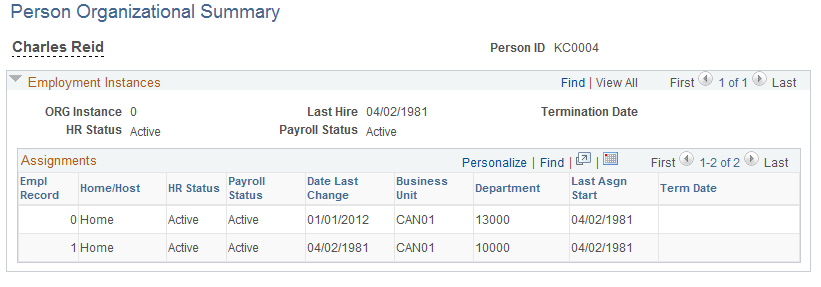

(Classic) Person Organizational Summary Page
Use the Person Organizational Summary page (PERSON_SUMMARY) to review a summary of a person's organizational relationships using the classic pages.
Navigation:
Workforce Administration, and then Personal Information, and then Person Organizational Summary, and then Person Organizational Summary
This example illustrates the Person Organizational Summary page in classic.

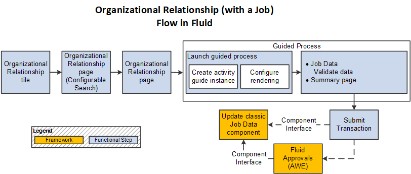

Organizational Relationship (with a Job) Flow in Fluid
Use the following steps to perform the fluid-based approach to quickly create and process a new organizational relationship for a person in the system:
This diagram shows the high-level functional pages and steps to create a new organizational relationship using the fluid pages.
  1. Select the (Fluid) Organizational Relationship Tile to begin the process (Workforce Administrator home page, and then Manage Human Resources tile, and then Create Person of Interest Tile).
  2. Use the configurable search page to find a person record (see Application Fundamentals: Setting Up Search Configuration).
  3. Select a person to continue the to (Fluid) Organizational Relationship Page where you will select to add a relationship.
    You can also access this page when performing a duplicate Search/Match and selecting the Organizational Relationship link for an existing person.
  4. Continue to the Add <Organizational Relationship> Relationship activity guide process.
    There are two steps in this activity guide:
  5. Submit the information to add the Job Data record.
    If approvals are enable for the organization relationship, the request will be routed to the approvers for review prior to saving the information to the system.
See also Fluid Add or Modify Persons, Create Organizational Relationships, and Manage Job Data Architectures.

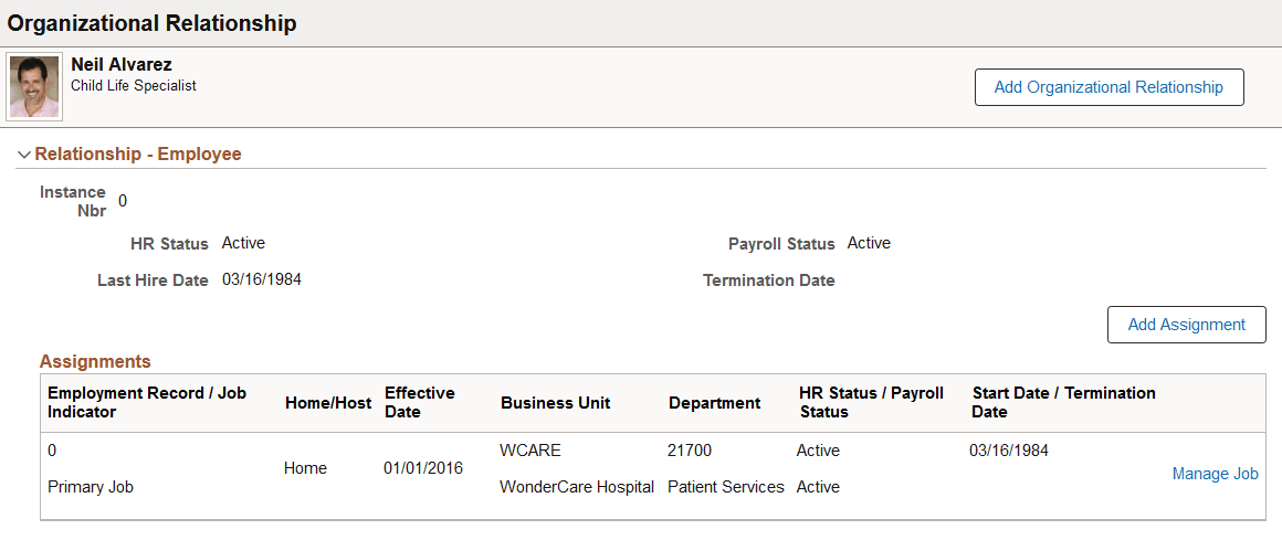

Use the Organizational Relationship page (HR_PERS_ORG_REL_FL) to add or view a summary of a person's organizational relationships using the fluid pages.
Navigation:
This example illustrates the Organizational Relationship page in fluid when adding the first relationship.
(Fluid) Organizational Relationship Page without relationship history
This example illustrates the Organizational Relationship page in fluid when viewing a person with relationship information.
This example illustrates the Organizational Relationship page: Pending Request tab (left scroll) when you have a pending request in progress (1 of 2).
Organizational Relationship page: Pending Request tab (1 of 2)
This example illustrates the Organizational Relationship page: Pending Request tab (right scroll) when you have a pending request in progress (2 of 2).
Organizational Relationship page: Pending Request tab (2 of 2)
This page uses the Employee Header Configuration feature. For more information on defining header fields and layout, see Application Fundamentals: (Fluid) Managing Employee Headers.

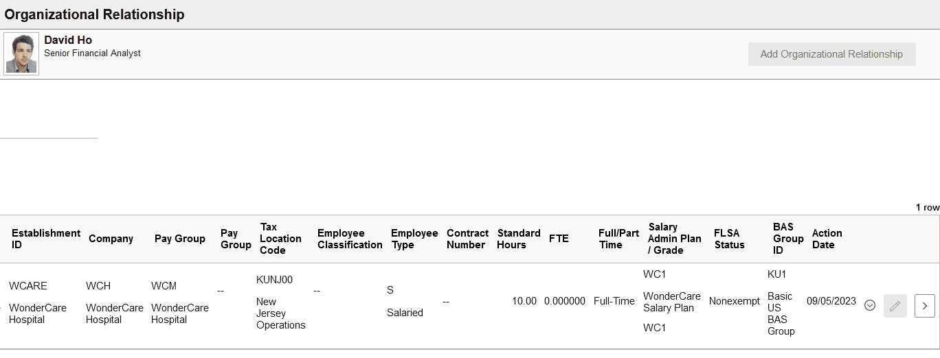

Field or Control Description
Add Organizational Relationship button
Select to access one of the following pages:
Add Assignment button
Select to access the classic Job Data pages to add an additional assignment. See also Adding Additional Assignments.
Manage Job link
Select this link to access the Job Actions Summary Page to view job data rows and initiate the process to create, delete, edit, or view a job data row (based on your user access).

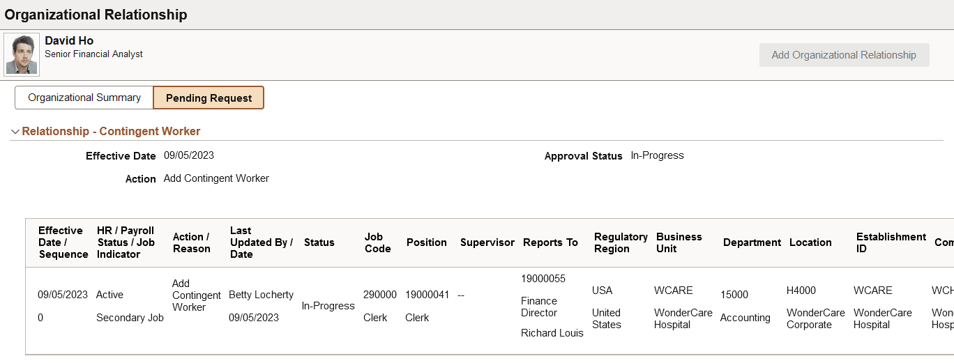

Pending Request tab
Displays the requested job information the organizational relationship request that is still under review.
Related Actions icon button
Select this icon to open the Related Actions popup menu and select from a list of additional action items. Although options may vary, items may include:
  • Approval Chain: Opens the View Approval Chain page, where you can review information about all approvers and their approval status.
  • Withdraw: This option is available when a job row status is In Progress and you wish to remove the Create <Organizational Relationship> job data transaction request.

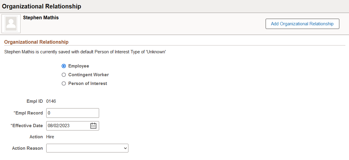

(Fluid) Add Organizational Relationship Page
Use the Add Organizational Relationship page (PERORG_ADD_REL_SCF) to initiate the process to add an organizational relationship to a person.
Navigation:
Select the Add Organizational Relationship button from the (Fluid) Organizational Relationship Page.
This example illustrates the Add Organizational Relationship page in fluid when you have selected the employee or contingent worker relationship.
(Fluid) Add Organizational Relationship page
This example illustrates the Add Organizational Relationship page in fluid when you have selected the person of interest relationship.
(Fluid) Add Organizational Relationship Page for a POI
Employee, Contingent Worker, or Person of Interest radio buttons
Select which type of relationship you want to add. The relationship determine the fields that will appear on this page.
This field is available when you select the Person of Interest option.
Empl ID and Empl Record
The system automatically populates the employee ID and the next employment record number. You can overwrite the employment record number, if needed.
Effective Date
Provides today's date by default. Enter the date the organizational relationship should begin.
Action
Displays Hire for an employee.
Displays Add Contingent Worker for a contingent worker.
Displays Add Person of Interest for a person of interest.
Action Reason
Select the reason that is tied to the action to create this record.
Note: The reason you select here may impact the steps and fields that are available for the Job Data activity guide process.
