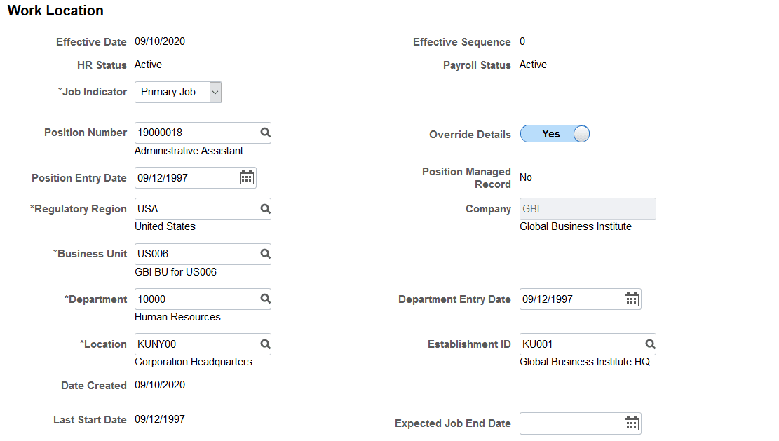

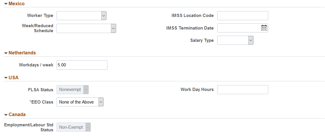

(Fluid) Work Location Page
HR_JOBDATA_WL_FL
Update position and location information for a person's job, including the regulatory region, company, department, and location.

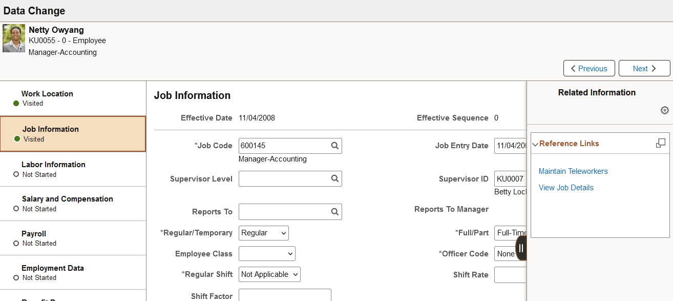

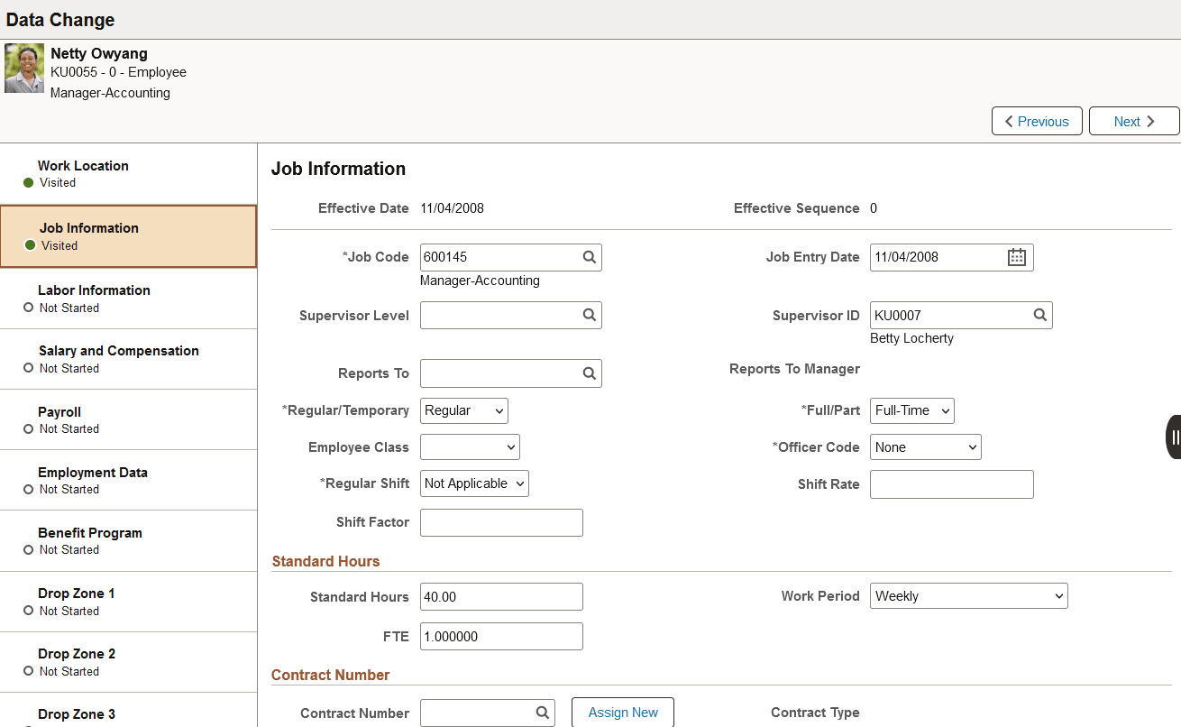

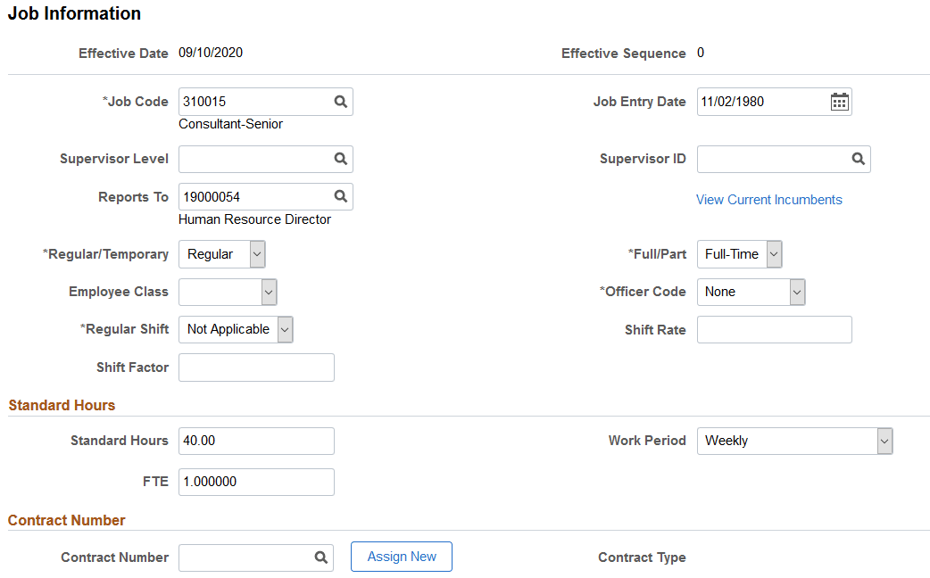

(Fluid) Job Information Page
HR_JOBDATA_JC_FL
Update information about a person's job, including status, employee class, shift, or standard hours.

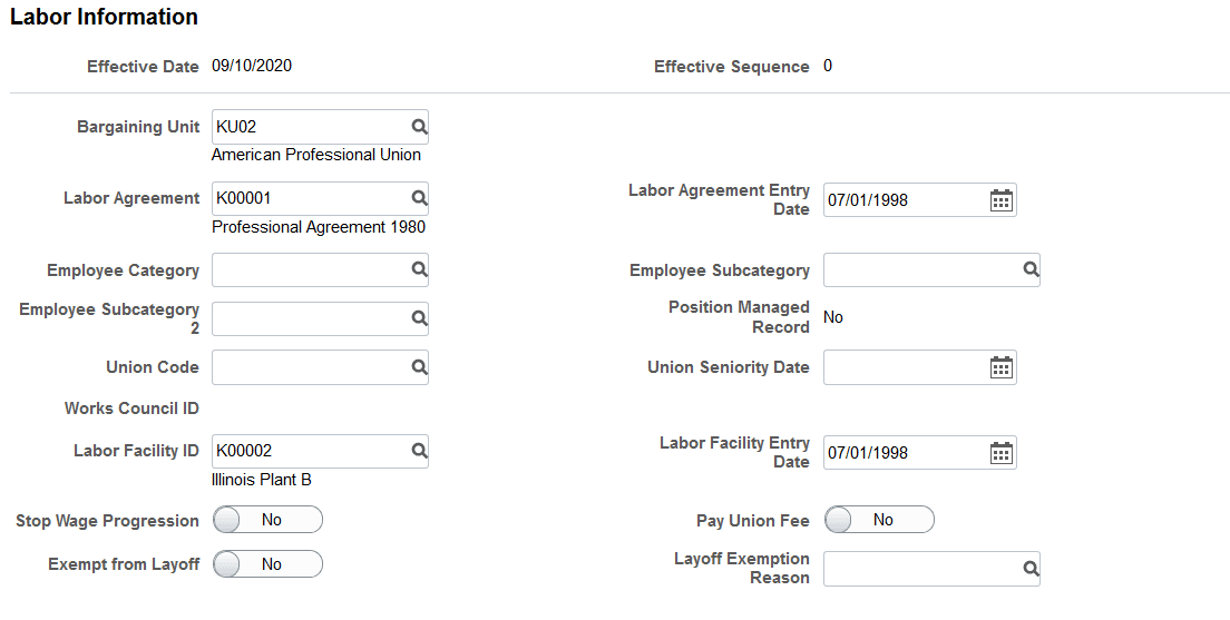

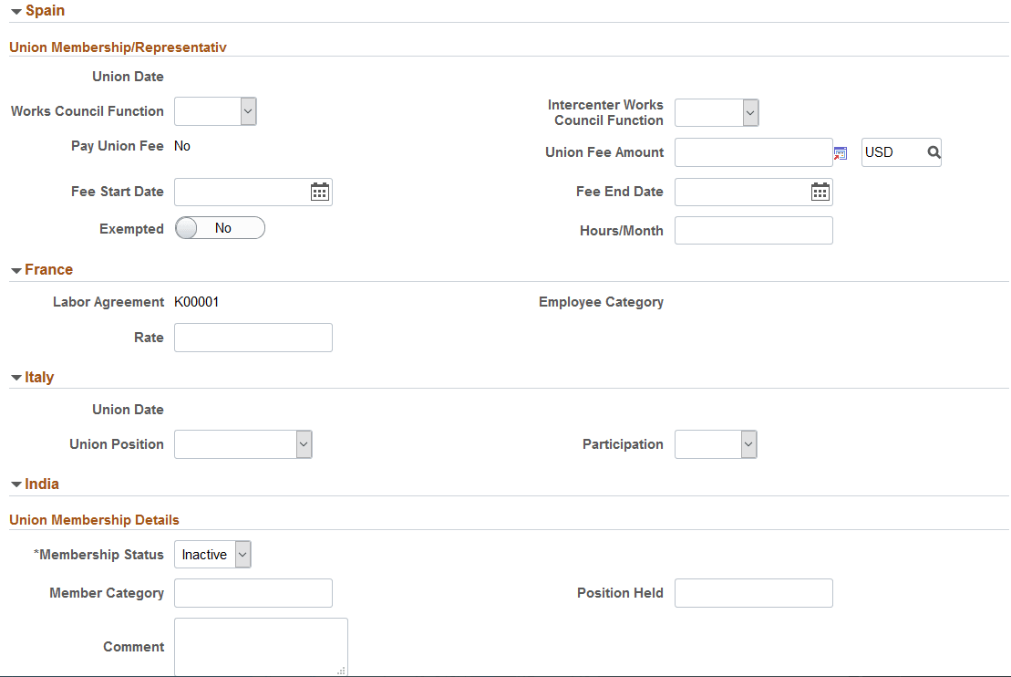

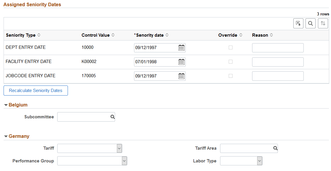

(Fluid) Labor Information Page
HR_JOBDATA_JL_FL
Update National Labor agreement data if the employee or contingent worker belongs to a National Labor agreement.

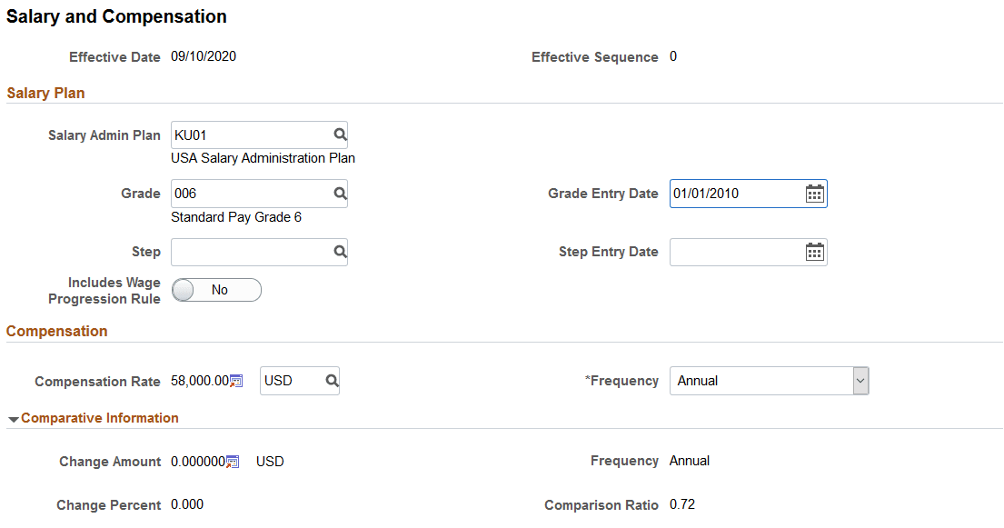

(Fluid) Salary and Compensation Page
HR_JOBDATA_SAL_FL
Update information about a person's salary plan and compensation information.

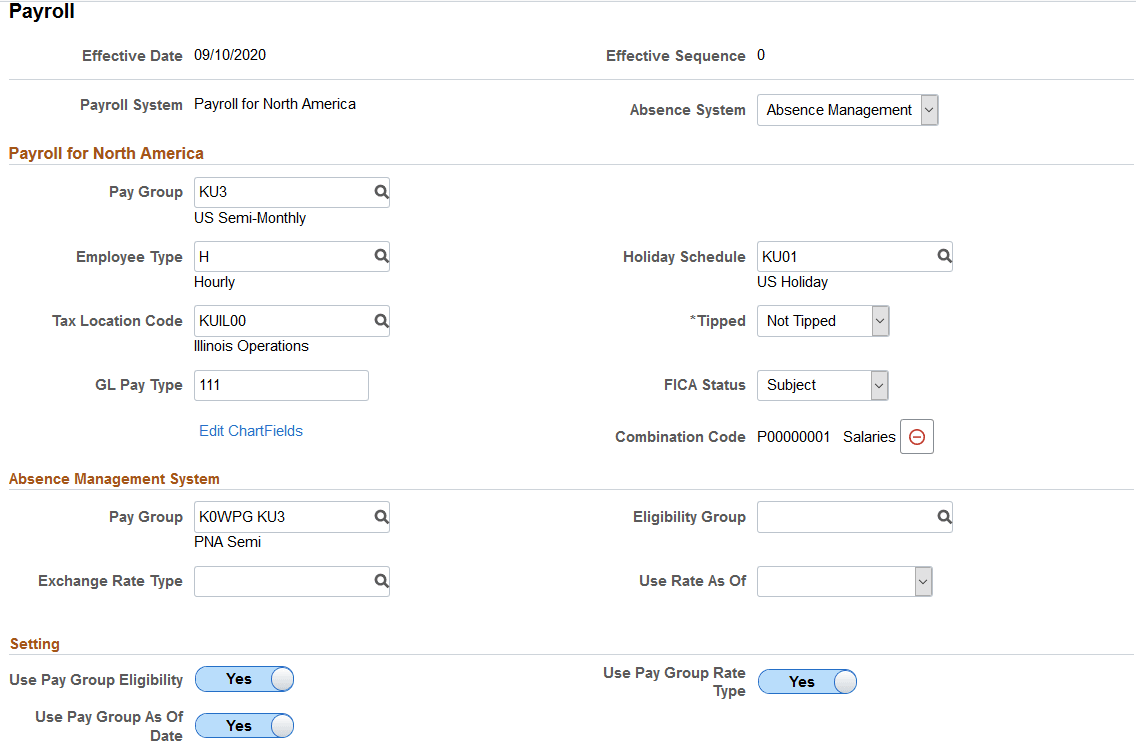

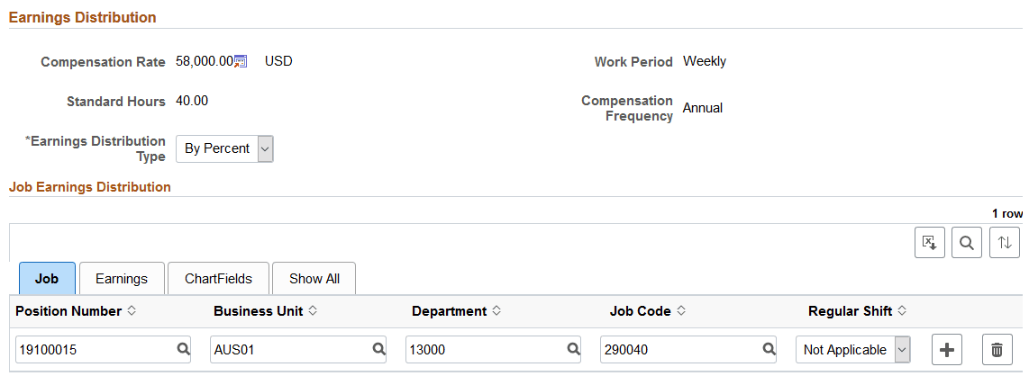

(Fluid) Payroll Page
HR_JOBDATA_PAY_FL
Update payroll processing data. The payroll system and pay group information that you enter here affects component compensation processing on the Salary and Compensation page.
Distribute a person's compensation for one job among different departments, job codes, accounts, shifts, position numbers, or general ledger pay types. If the person's pay is regularly charged to more than one cost center, designate how much to allocate to each cost center.

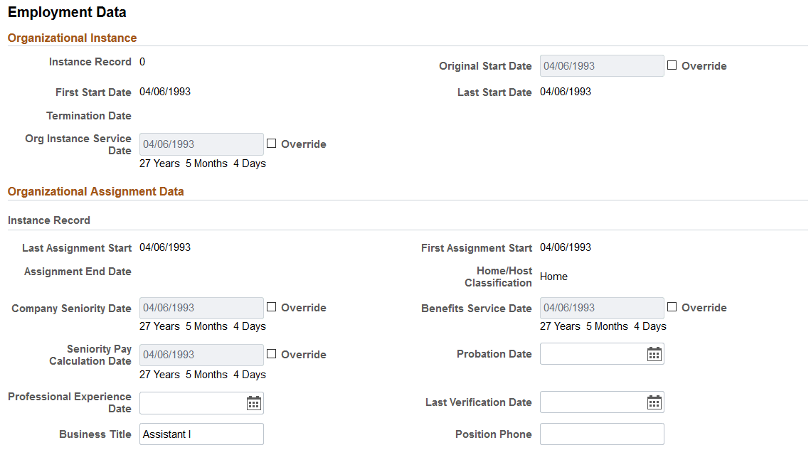

(Fluid) Employment Data Page
HR_JOBDATA_EMP_FL
Update optional employment data, such as a worker's business title.

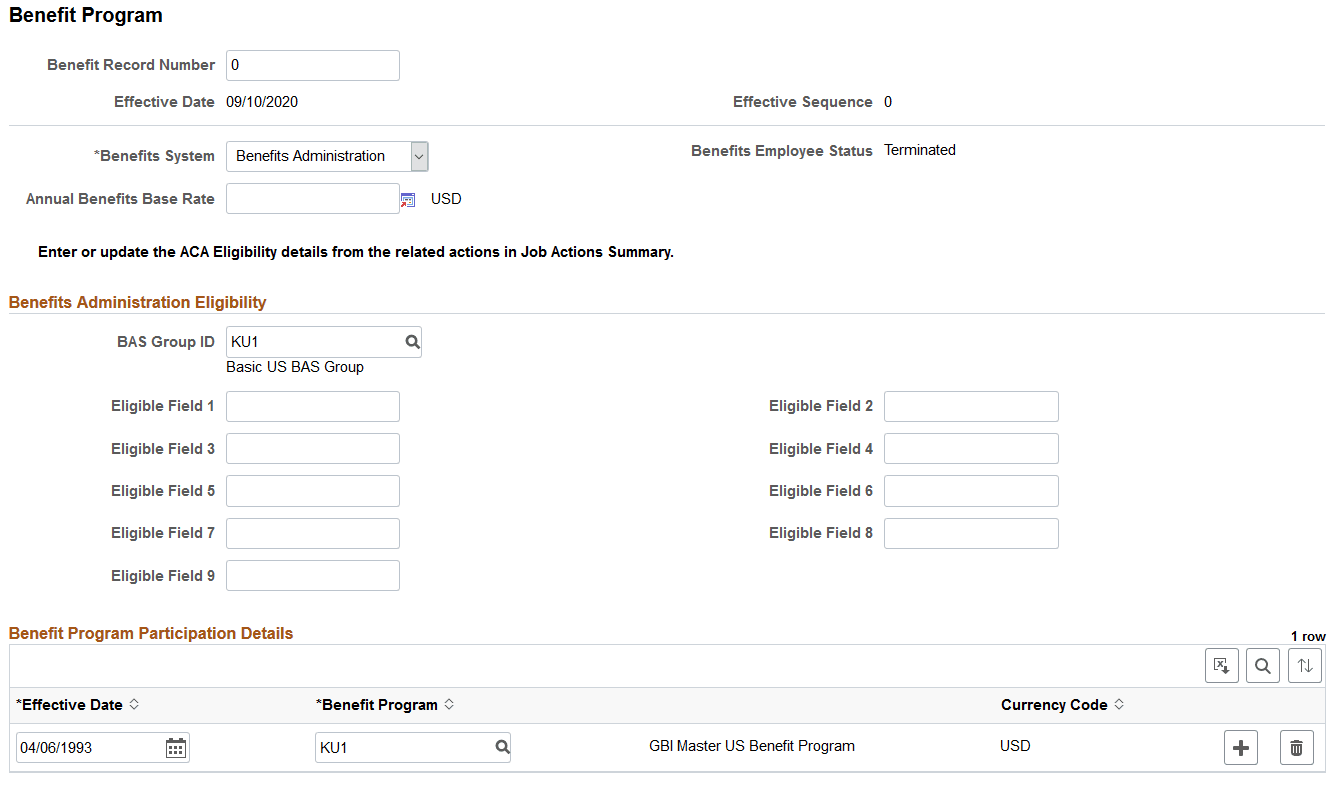

(Fluid) Benefit Program Page
HR_JOBDATA_BEN_FL
Update the benefit program in which a person is enrolled for benefits in PeopleSoft Human Resources or PeopleSoft Benefits Administration.

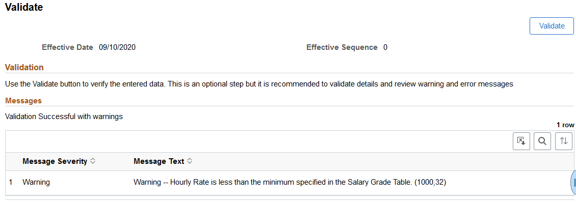

(Fluid) Validate Page
HR_JOBDATA_VAL_FL
Verify the details you have entered during the course of the transaction.

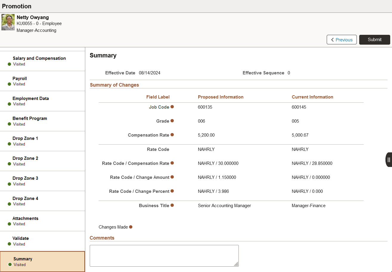

(Fluid) Job Data - Summary Page
HR_JOBDATA_TS_FL
Review a summary of the job row changes prior to submitting the transaction.

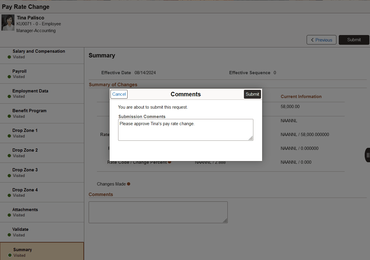

(Fluid) Job Data - Comments Page
HR_JOB_COM_SCF
Add comments and finalize the submitting process for a Job Data change.

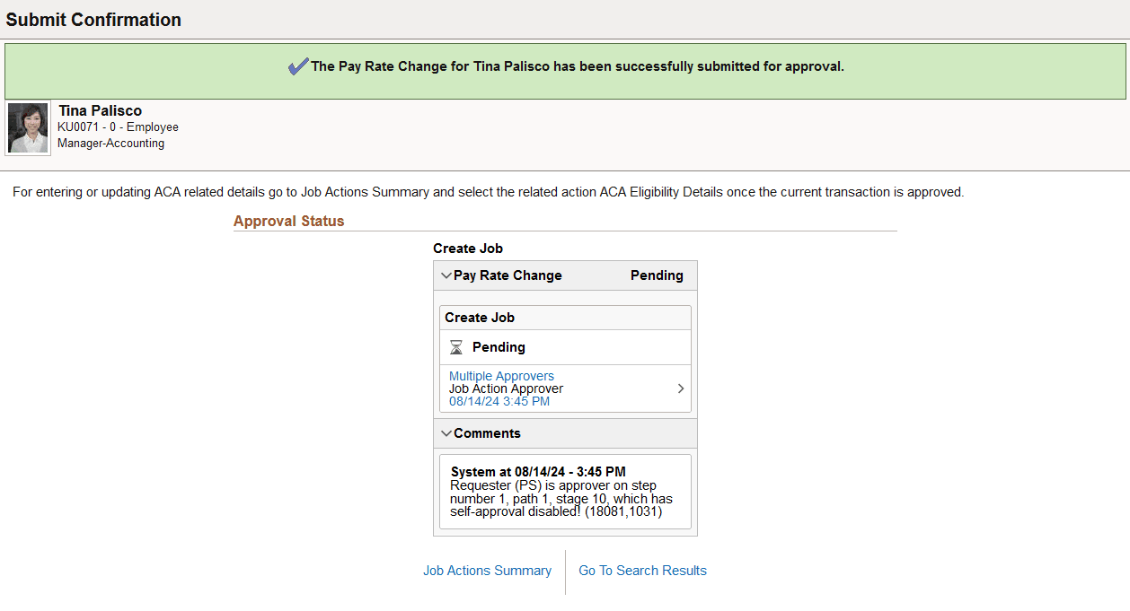

(Fluid) Job Data - Submit Confirmation Page
HR_JB_SUB_CNF_FL
Confirm that your job data updates have been submitted

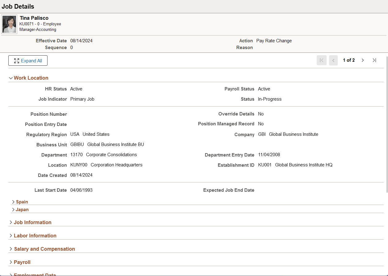

Job Details Page
HR_JOBDATA_VW_FL
View a complete summary of the job data rows for a person by effective date

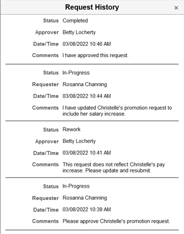

Request History Page
HR_REQ_HIST_SCF
View all the comments related to a job data row.

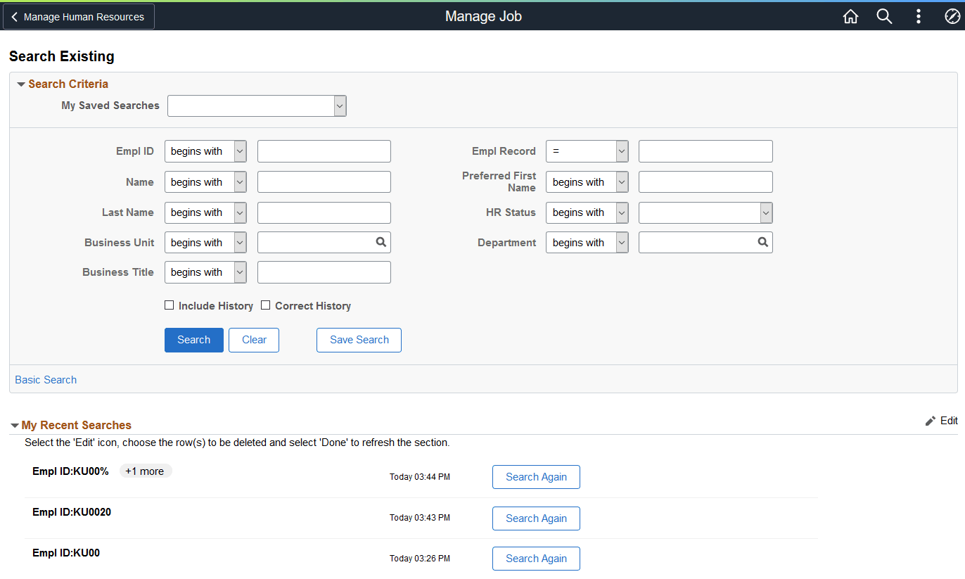

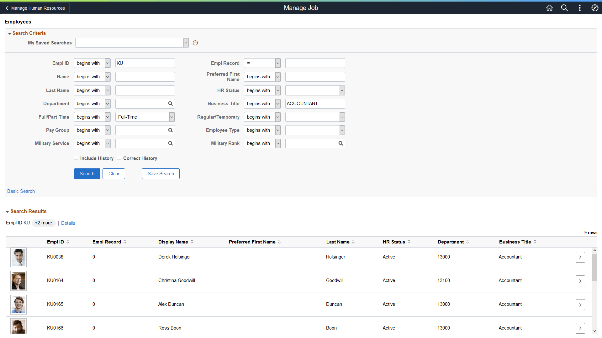

Manage Job - Search Criteria Page
When you select the Manage Job tile, the system displays the configurable Manage Job - Search Criteria page (EOSF_SRCH_FL) to search for job records using fluid.
The page first appears in the Advanced Search mode, where you can use multiple search fields and save your searches, or you can switch to the Basic Search, where you can use the Search By field to retrieve data. Administrators responsible for creating search configurations can modify these options according to the needs of your organization.
This example illustrates the Manage Job - Search Criteria page and recent searches.
Example of the Manage Job - Search Criteria page
This example illustrates the Manage Job - Search Criteria page showing search results.
Manage Job - Search Criteria Page Showing Search Results
For an explanation of additional fields and controls on this page, see the Setting Up Search Configuration, Application Fundamentals: <Transaction Search or Add> Page documentation.
Term Definition
Include History
Select to retrieve all rows for this person. Although you can view all the rows, you cannot make corrections to historical rows in this mode.
Correct History
Select to retrieve all rows for this person. In this mode you can make corrections to historical rows. You many need to select this option to perform reviews when the review process is enabled on the Person and Job Installation - Job Data Page.
Update/Display is the default mode that gets applied if Include History or Correct History is not selected. You can add a new top row in this mode but you cannot view historical rows. Availability to access modes are based on your security access and modes may not be available for all users.

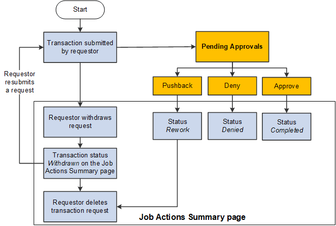

Understanding Job Actions Summary Statuses and the Approval Process
The Job Actions Summary page lists the status for the various job rows. When approvals is enabled, the status of the transaction will vary based on where the transaction is in the approval process.
Submitting a New Transaction Request
When a user submits a new transaction request, the status of the job row is changed to In-Progress and submitted to the approvers. While the request still has an In-Progress status and the approval request is still pending, the user can opt to withdraw the request by clicking the Actions icon on the Job Actions Summary page and selecting Withdraw. When a row has the status of Withdrawn, the user can resubmit the request for approval or delete the job data row by clicking the Actions icon for the row and selecting the Delete option.
When the approver receives the request, he or she can perform one of the following actions:
  • Pushback: Changes the status to Rework and the requestor can delete the transaction request.
  • Deny: Changes the status to Denied or Correction Denied.
  • Approve: Changes the status to Completed.
This diagram illustrates how the status of a job transaction for a new row is updated when an approver responds to a job data request.
Updating Job Action Summary statuses when using approvals

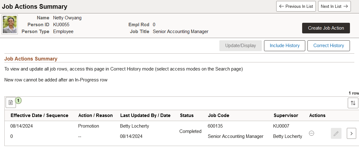

Job Actions Summary Page
Use the Job Actions Summary page (HR_JOBDATA_SUM_FL) to view job data rows and initiate the process to create, delete, edit, or view a job data row (based on your user access).
Navigation:
Click the Continue arrow (>) button for a worker row on the Manage Job - Search Criteria page.
When only one person matches the search criteria, the system will automatically direct you to this page.
This example illustrates the fields and controls on the Job Actions Summary page.
This page shows a quick summary of an employee’s job data. The default mode for accessing this page is Update/Display and typically shows only the most current row, although there may be other rows, such as future-dated or in-progress rows.

View Job Details button (View Job Details) button
This button is available in all modes.
Click this button to open the Job Details Page in a new tab window and view job details.

Create Job Action Page
Use the Create Job Action page (JOB_REQ_ADD_SCF) to add a new effective data job data row and identify the action and reason for the job change.
When updating an existing job data row, the page title will display Correct Job Data.
Navigation:
  • Click the Create Job Action button on the Job Actions Summary Page.
  • Click the Edit button for an existing job data row.
This example illustrates the fields and controls on the Create Job Action page.
The field values entered on this page act as input parameters for the guided process. Meaning, the administrator can use any of these fields to configure the steps and fields in the guided process. In addition to Action and Action Reason, the your organization may want to use fields such as Regulatory Region and the Business Unit of employees to configure the guided steps and page fields that the Page and Field Configurator displays. Regulatory Region and Business Unit fields are disabled by default, but the administrator can enable them based on your organization requirements.

Important: Your job data will not be saved to the system until you click the Submit button.
When approvals are required for updating or creating job data, the request will be sent to the approving managers, where they will use the Pending Approvals - Create Job Page or Pending Approvals - Correct Job Page to take action on a job data request.
Left Panel Navigation
The page framework includes a left panel that lists the page tabs in the Manage Job Data process. Each step displays a status, which is either Not Started or Visited. Users can navigate to steps by clicking the page tab or using the navigation buttons in the header (sub-banner).
The activity guide uses the Page and Field Configurator framework to hide or show page steps and fields based on the Action and Action Reason selected for this job data transaction. For more information on how to configure the pages, see the Enterprise Components: Understanding Page and Field Configurator documentation.

Supplementary Panel for the Manage Job Data Pages
The Manage Job Data pages include a supplementary panel that provides access to related information.
Navigation:
Click the Supplementary Panel tab on any of the Manage Job Data pages.
This example illustrates the supplementary panel options for the Manage Job Data pages.
Supplementary panel options for the Manage Job Data pages
Field or Control Description
Supplemental panel tab (Supplementary Panel) tab
Click this tab to open the Related Information panel and view related content.
Personalize Related Content icon [Personalize RC (Related Content) icon]
This icon appears at the top of the Related Information panel. Click to open the Personalize page. This page lists the available related content so you can choose whether the Related Information panel shows or hides each item.
Display <Related Content Item> in Modal Window icon (Display <Related Content Item> in Modal Window icon)
This icon appears at the top of each individual related content item in the Related Information panel. Click to expand the item to open a modal dialog with a larger interactive version of the content.
Related Information
For fluid Job Data, this supplementary pane includes the following links:
  • Maintain Teleworkers
    Click this link to open the Tracking Teleworkers pages in a new browser tab to track telecommuting information.
  • View Job Details
    Click this link to open the Job Details Page in a new browser window tab and view each job data rows from one page. This allows you to reference job data details while entering data for a new action.
You can add additional links as needed.
Use the Work Location page in Fluid (HR_JOBDATA_WL_FL) to update position and location information for a person's job, including the regulatory region, company, department, and location.
Navigation:
Select to add or edit a job row from the Job Actions Summary Page or select the appropriate tab from the left panel navigation steps.
This example illustrates the fields and controls on the Work Location page (1 of 2).
(Fluid) Work Location page (1 of 2)
This example illustrates the fields and controls on the Work Location page (2 of 2).
(Fluid) Work Location page (2 of 2)
The effective date, effective sequence, and <Action> – <Reason> (shown in the activity guide banner title) are entered on the Create Job Action Page.
For a list of field descriptions, see the Job Data Page - Work Location Section documentation.
Use the Job Information page in Fluid (HR_JOBDATA_JC_FL) to update information about a person's job, including status, employee class, shift, or standard hours.
Navigation:
After accessing the Manage Job component, click the Previous or Next button or select the appropriate tab from the left panel navigation steps.
This example illustrates the fields and controls on the Job Information page (1 of 4).
(Fluid) Job Information page (1 of 4)
This example illustrates the fields and controls on the Job Information page (2 of 4).
(Fluid) Job Information page (2 of 4)
This example illustrates the fields and controls on the Job Information page (3 of 4).
(Fluid) Job Information page (3 of 4)
This example illustrates the fields and controls on the Job Information page (4 of 4).
(Fluid) Job Information page (4 of 4)
For a list of field descriptions, see the Job Data Page - Job Information Section documentation.
Use the Labor Information page in Fluid (HR_JOBDATA_JL_FL) to update National Labor agreement data if the employee or contingent worker belongs to a National Labor agreement.
Navigation:
This example illustrates the fields and controls on the Job Labor page (1 of 3).
(Fluid) Labor Information page (1 of 3)
This example illustrates the fields and controls on the Job Labor page (2 of 3).
(Fluid) Labor Information page (2 of 3)
This example illustrates the fields and controls on the Job Labor page (3 of 3).
(Fluid) Labor Information page (3 of 3)
For a list of field descriptions, see the Job Data Page - Labor Information Section documentation.

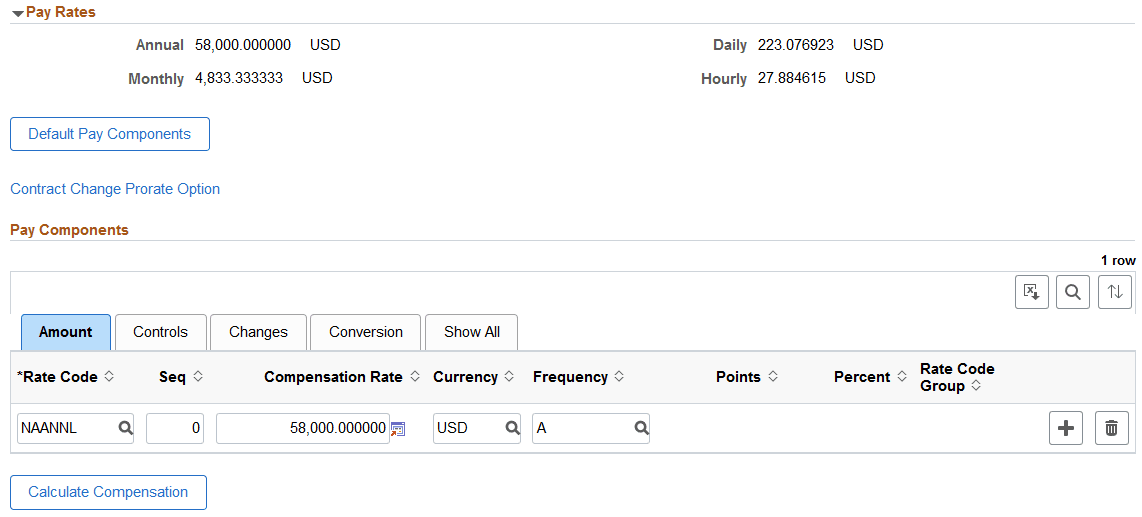

Use the Salary and Compensation page in Fluid (HR_JOBDATA_SAL_FL) to update information about a person's salary plan and compensation information.
Navigation:
This example illustrates the fields and controls on the Salary Plan page (1 of 2).
(Fluid) Salary and Compensation page (1 of 2)
This example illustrates the fields and controls on the Salary Plan page (2 of 2).
(Fluid) Salary and Compensation page (2 of 2)
For a list of field descriptions, see the Job Data Page - Salary and Compensation Section documentation.
Use the Payroll page in Fluid (HR_JOBDATA_PAY_FL) to update payroll processing data. The payroll system and pay group information that you enter here affects component compensation processing on the Salary and Compensation page.
Navigation:
This example illustrates the fields and controls on the Payroll page (1 of 2).
(Fluid) Payroll page (1 of 2)
This example illustrates the fields and controls on the Payroll page (2 of 2).
(Fluid) Payroll page (2 of 2)
For a list of field descriptions, see the Job Data Page - Payroll Section documentation.

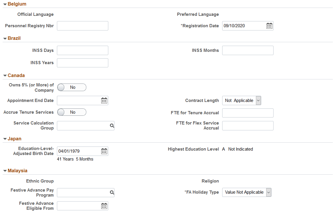

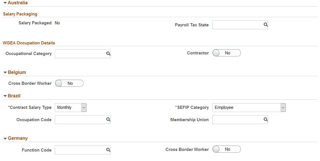

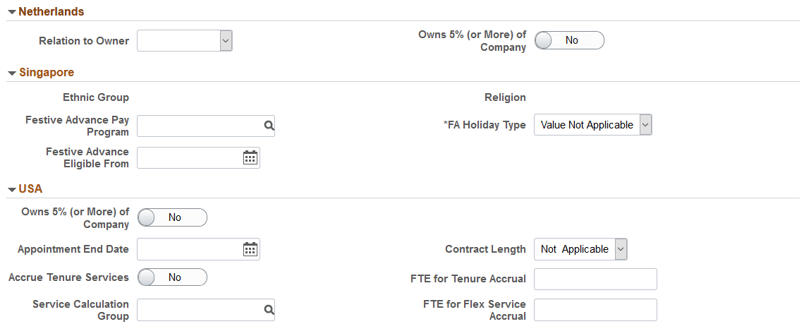

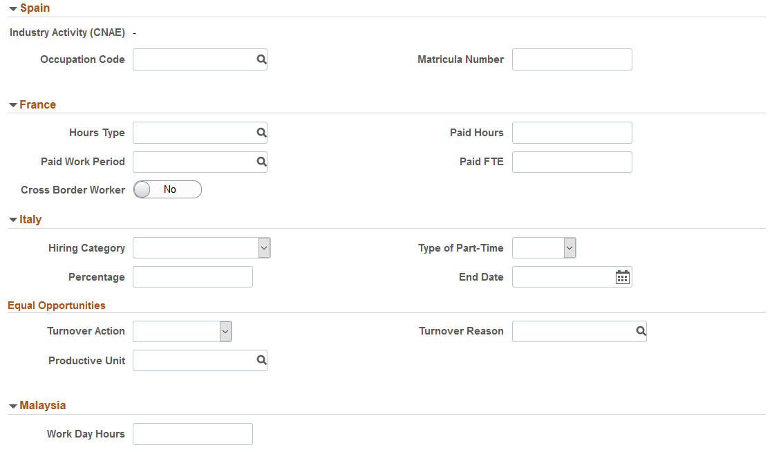

Use the Employment Data page (HR_JOBDATA_EMP_FL) to update optional employment data, such as a worker's business title.
Navigation:
This example illustrates the fields and controls on the Employment Information page (1 of 3).
(Fluid) Employment Data page (1 of 3)
This example illustrates the fields and controls on the Employment Information page (2 of 3).
(Fluid) Employment Data page (2 of 3)
This example illustrates the fields and controls on the Employment Information page (3 of 3).
(Fluid) Employment Data page (3 of 3)
For a list of field descriptions, see the Job Data Page - Employment Data Section documentation.
Use the Benefit Program Participation page (HR_JOBDATA_BEN_FL) to update the benefit program in which a person is enrolled for benefits in PeopleSoft Human Resources or PeopleSoft Benefits Administration.
Navigation:
This example illustrates the fields and controls on the Benefit Program Participation page.
(Fluid) Benefit Program page
For a list of field descriptions, see the Job Data Page - Benefit Program Section documentation.
Use the Validate page in Fluid (HR_JOBDATA_VAL_FL) to verify the details you have entered during the course of the transaction.
Navigation:
This example illustrates the fields and controls on the Validate page when you are updating job data information.
(Fluid) Validate page
Although this step is not required before moving to the Summary step in the guided process, we recommend that you perform the validation to ensure cleaner data entry.
Validate button
Select this button to displays errors or warnings, if any. This allows you to go back and fix information prior to submitting a transaction.
Prior to selecting the Validate button, the Messages section displays that there are currently no exceptions to be displayed. When you click the button, the process triggers a test CI to pre-validate the data against the core Job validations and displays the errors. The Messages section is then updated to indicate if the process ran successfully and lists messages and their severity, if any.
Use the Job Data - Summary page in Fluid (HR_JOBDATA_TS_FL) to review a summary of the job row changes prior to submitting the transaction.
Navigation:
After accessing the Job Data component, click the Next button or select the Summary tab from the left panel navigation steps.
This example illustrates the fields and controls on the Job Data - Summary page when you are updating job data information.
(Fluid) Job Data - Summary page
Summary Of Changes
Use this section to review changes you have made to the job data. The page will display the proposed value side-by-side with the current value for the changed fields followed by an indicator.
PeopleSoft HCM delivers the Manage Job - Summary page with a pre-seeded configuration. Administrators can configure this page to hide or show fields, even those that were not changed using the Transaction Summary functionality. For more information on setting up this information, see the Application Fundamentals: Configuring Transaction Summary documentation.
Comments
Enter comments related to this transaction row.
If approvals are enabled, the approver will be able to see the comments when reviewing the approval request on the Pending Approvals - Create Job Page or Pending Approvals - Correct Job Page.
Comments are stored with the job row and are available to view by selecting the Request History option under the Summary section of the Job Details Page in fluid.
This video provides an overview of tracking comments:
Video: Image Highlights, PeopleSoft HCM Update Image 42: Track Requestor Comments with Job Data Modernization
Submitting a Transaction
Submit button
The Submit button appears on this page only.
Select this button to initiate the process to save and submit job data information you just entered.
Use the (Fluid) Job Data - Comments page (HR_JOB_COM_SCF) to add comments and finalize the submitting process for a Job Data change.
Navigation:
Click the Submit button on the (Fluid) Job Data - Summary Page.
This example illustrates the fields and controls on the Job Data - Comments page.
This final step in the fluid job data transaction process also includes the comments box to ensure remarks are not missed prior to submitting the job data change.
Submission Comments
Enter comments about this job transaction row, if any. If you entered comments on the Summary page, they are carried forward to this page.
Submit button
Select the Submit button to complete the submission process.
If approvals are not enabled, the data will be saved to the HR system.
When approvals are required for updating or creating a job row (see Person and Job Installation - Job Data Page), the request will be sent to the approving managers, where they will use the Pending Approvals - Create Job Page or Pending Approvals - Correct Job Page to take action on a Mange Job data request.
Warning! Your job data changes will not be saved until you click the Submit button. If you exit out of the Manage Job activity guide without submitting your changes, your data will be discarded.
When a job data transaction has been successfully submitted, the system will display the (Fluid) Job Data - Submit Confirmation Page.
On the submission of a job data transaction requiring approvals, the approval chain will appear on the following pages:
Use the Job Data - Submit Confirmation page (HR_JB_SUB_CNF_FL) to confirm that your job data updates have been submitted.
Navigation:
Click the Submit button on the (Fluid) Job Data - Comments Page.
This example illustrates the fields and controls on the Job Data - Submit Confirmation page.
This page uses the Employee Header Configuration feature. For more information on defining header fields and layout, see Application Fundamentals: (Fluid) Managing Employee Headers.
When approvals are enabled, the message at the top of the page will indicate that it was submit for approvals and an Approval Status section will show the approval status and approval chain of the request.
Job Actions Summary link
Click this button to go to the Job Actions Summary Page for this person. You will see your newly created or update job transaction and it’s status in the list.
Go to Search Results link
Click this button to return to Manage Job - Search Criteria page and search for other people (See Understanding the Manage Job - Search Criteria Page).

Job Details Page
Use the Job Details page (HR_JOBDATA_VW_FL) to view a complete summary of the job data rows for a person by effective date.
Navigation:
This example illustrates the Job Details page.
Job Details page
This example illustrates the Job Details page, Summary section showing the Request History option
Job Details page showing the Request History option for comments
The Job Details displays information about the employee, including the job data transaction row you are viewing at the top of the transaction area. Use the previous and next scroll arrows to view other rows.
The page also shows all the sections and fields of the Manage Job Data pages, with the Work Location section expanded by default when you first access the page. Expand each section individually, or use the Expand All and Collapse All buttons, to view additional information.
The Page and Field Configurator, which you can use to hide information in the guided process, does not change the visibility of sections and fields on this page. If needed, you can configure this page using the Page and Field Configurator to display information based on actions. See the Technical Brief for this feature for more information.
Expand All button or Collapse All button sections buttons
Select these buttons to expand or collapse all the sections on this page.
< (previous) and > (next) buttons and row count
Use these buttons to scroll through all the effective dated rows for this person. A job data transaction summary of the row you are viewing will appear at the top of the page below the header.
Attachments section
If attachments are included with a row, select the Attachments link to view the attachment.
Summary section
The section will display the latest comment, if any, under the Comments subheading for the given job details row.
Request History
Select this option to access the Request History Page and view all the comments for a job data row.
Use the Request History page (HR_REQ_HIST_SCF) to view all the comments related to a job data row.
Navigation:
Click the Request History option from the (Fluid) Job Data - Comments Page.
This example illustrates the Request History page.
Request history allows you to view all the comments pertaining to this job transaction request. Multiple comments may happen when the approver has pushed back a request and it has been resubmitted.
