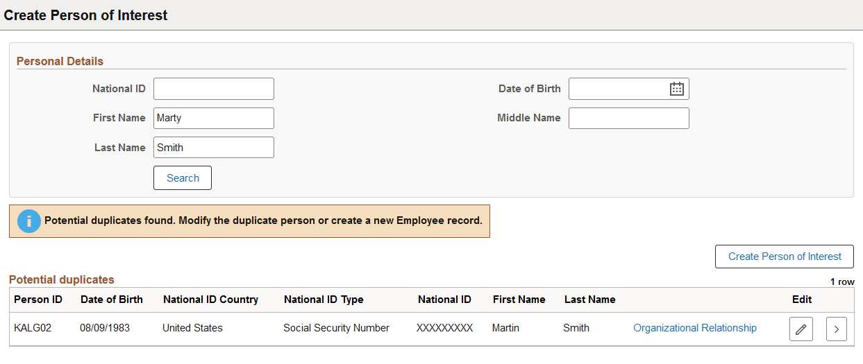

Create Person of Interest Tile
HC_HR_PERS_POIJB_ADD_FL_GBL (this is the cref for this tile)
Create a new Person Data and Job Data record with a person of interest (with a job) relationship.
Create Person of Interest Page
SRCH_PERSON_FL
Perform a search for duplicate IDs (with the ability to view or modify existing person records), and add a person with a person of interest (with a job) organizational relationship.

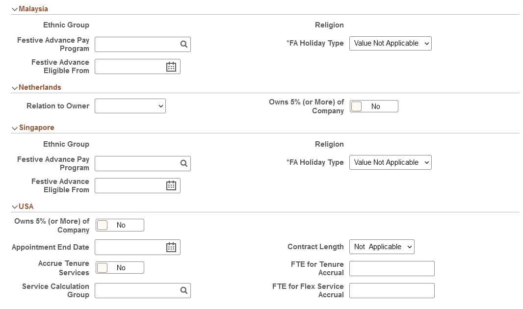

Job Data Page
HR_JOBDATA_ADD_FL
Enter a job instance and work information for a person in fluid.

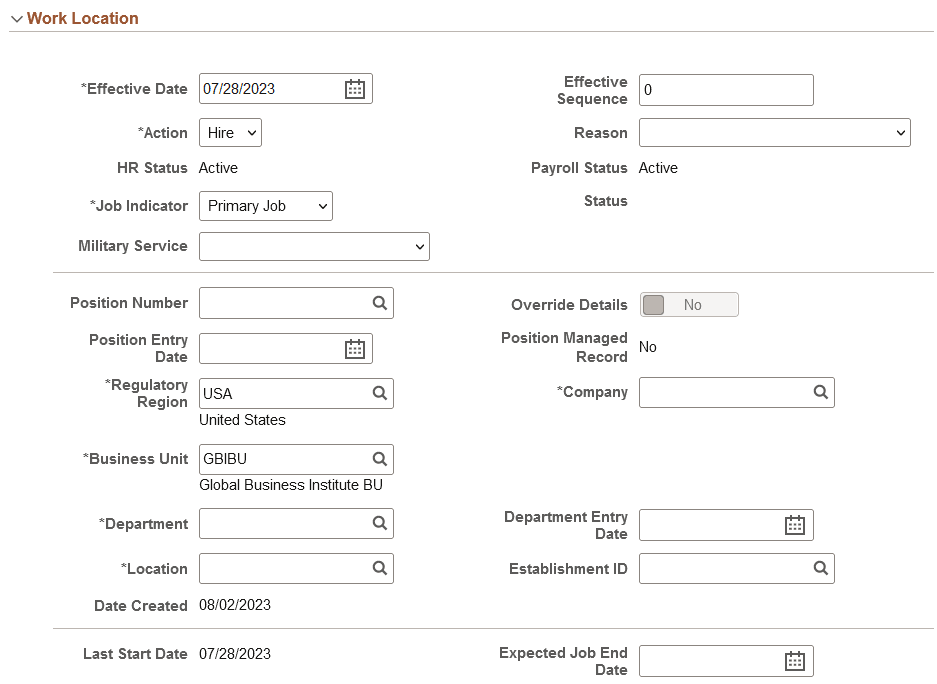

Job Data Page - Work Location Section
N/A
(See the Job Data page)
Enter position and location information for a person's job, including the regulatory region, company, department, and location.

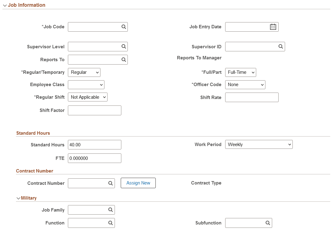

Job Data Page - Job Information Section
N/A
Enter information about a person's job, including status, employee class, shift, or standard hours.

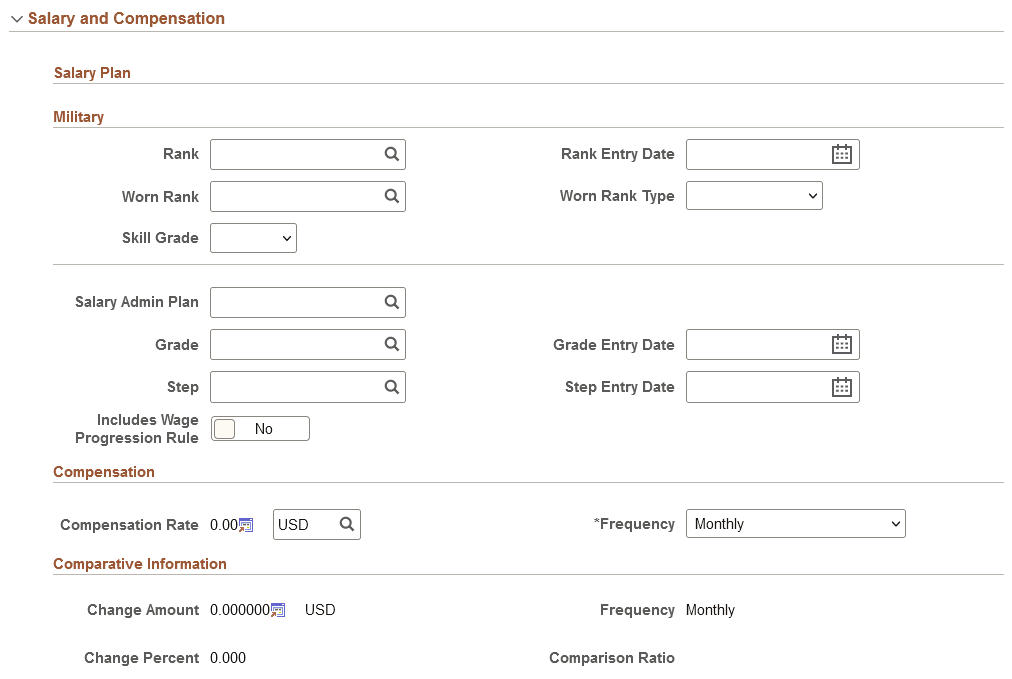

Job Data Page - Salary and Compensation Section
N/A
Enter information about a person's salary plan and compensation information.

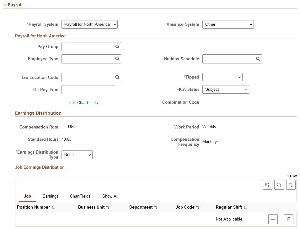

Job Data Page - Payroll Section
N/A
Enter payroll processing data. The payroll system and pay group information that you enter here affects component compensation processing on the Salary and Compensation page.
Distribute a person's compensation for one job among different departments, job codes, accounts, shifts, position numbers, or general ledger pay types. If the person's pay is regularly charged to more than one cost center, designate how much to allocate to each cost center.

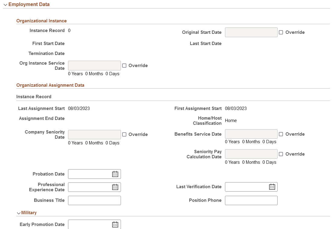

Job Data Page - Employment Data Section
N/A
Enter optional data, such as a worker's business title.

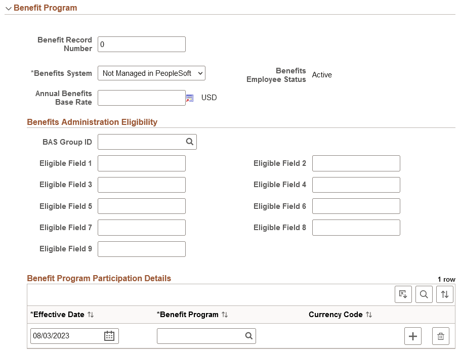

Job Data Page - Benefit Program Section
N/A
Specify the benefit program in which a person is enrolled for benefits in PeopleSoft Human Resources or PeopleSoft Benefits Administration.

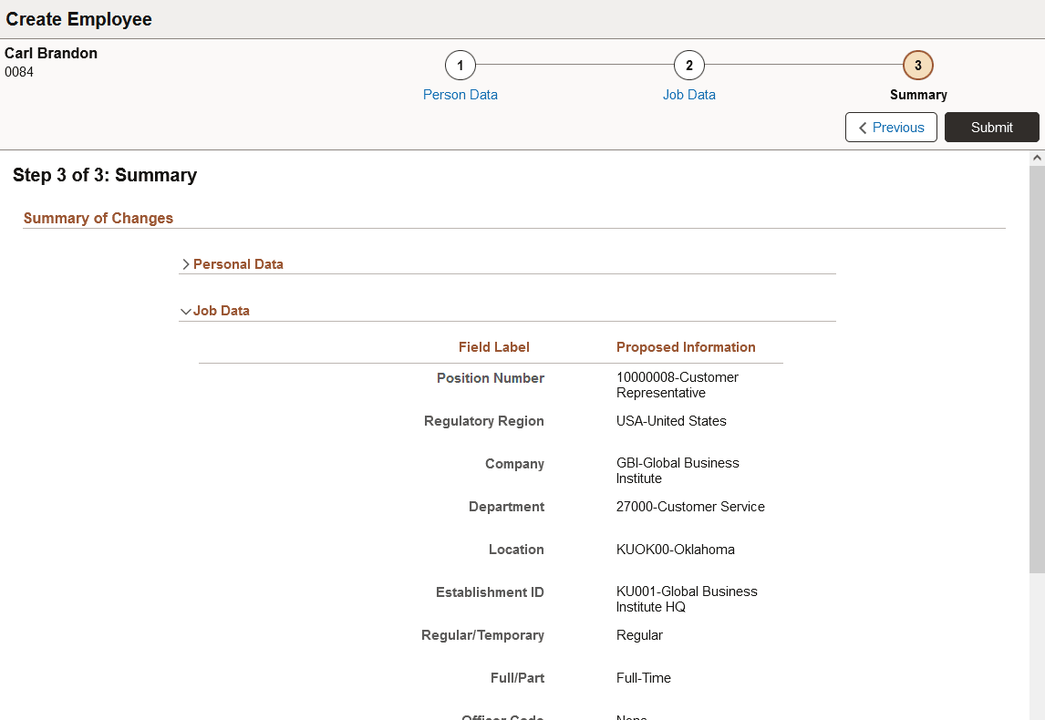

Create <Organizational Relationship> - Summary Page
JOB_DATA_RVW_FL
View the proposed information you are adding for a Person Data and Job Data record prior to submitting the transaction.

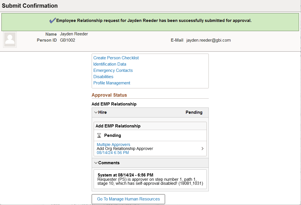

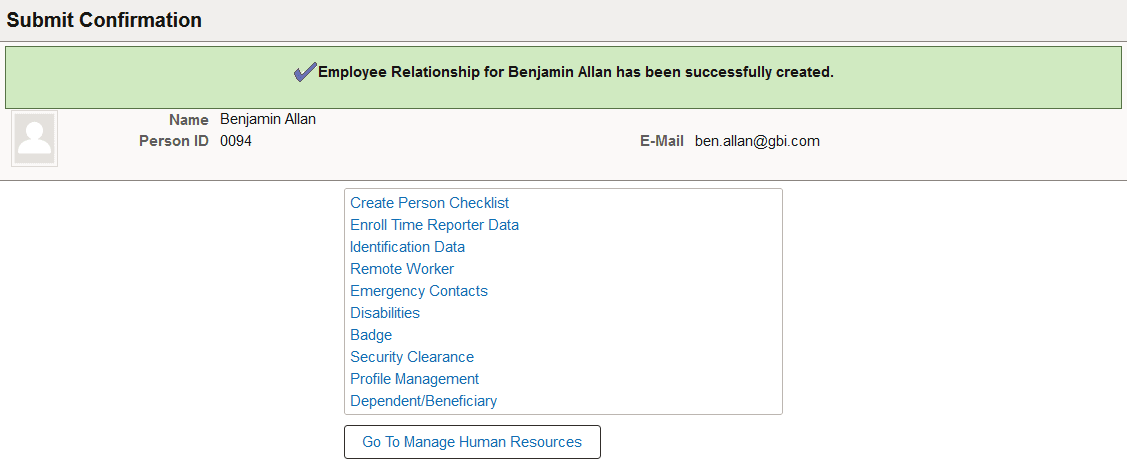

Create <Organizational Relationship> - Submit Confirmation Page
HR_JOB_ADD_SUB_FL
Confirm that a job data instance was successfully created. You can also initiate other transactions from this page.

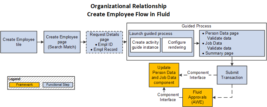

Create Employee Flow in Fluid
Use the following steps to perform the fluid-based approach to quickly create and process a new person and organizational relationship as an employee:
This diagram shows the high-level functional pages and steps to create a new employee using the fluid pages.
  1. Select the Create Employee Tile to begin the process (Workforce Administrator home page, and then Manage Human Resources tile, and then Create Employee Tile).

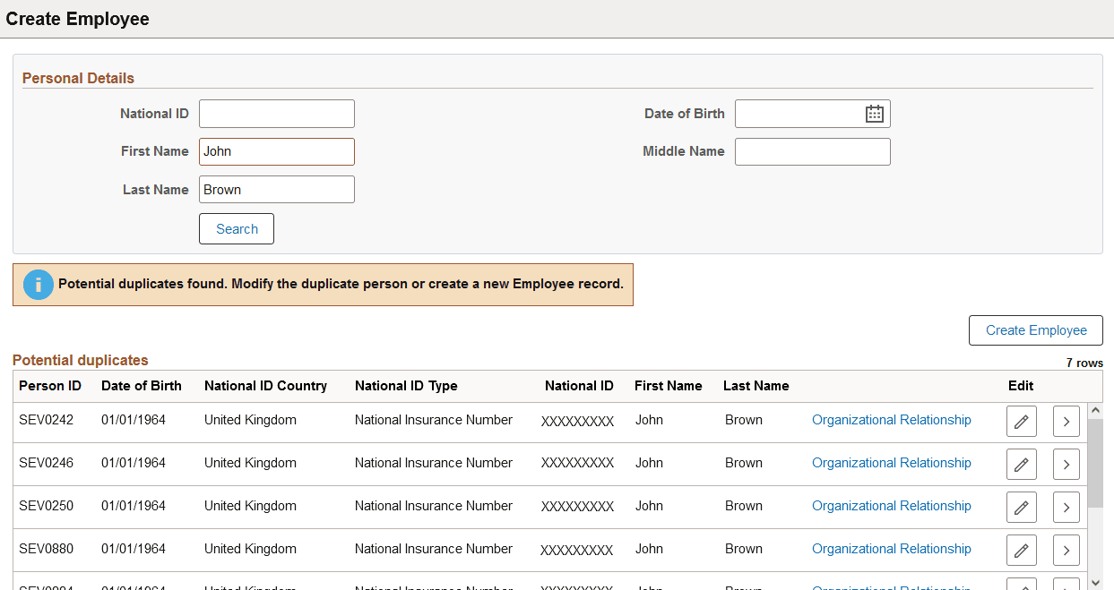

  2. Use the Create Employee Page to perform the Search/Match process to find potential Person Data matches in the system for this person or initiate the process to add a new person record.
    When using Search/Match, one of the following will occur:
    • No duplicate found: the process will continue with the Create Employee process and will move to either the Request Details or Person Data page, depending on your installation settings.
    • Duplicate found: the page will display the Potential duplicates grid for you to review duplicate person information. Options are available to view and add organizational relationships for a person or view or edit existing person data. If there is no person match, select the Create Employee button to continue with the process.
  3. The Request Details Page appears if configured to show the employee ID and/or record entry fields.
    Enter the employee ID or leave the field blank to have the system automatically assign the person's ID (see Understanding Identification Assignment).
    For configuration settings, see Person and Job Installation - Person and Organization Page.
  4. Continue the to Create Employee activity guide process and enter your data.
    There are three steps in this activity guide:
    See also, Understanding the Activity Guide Composer Framework for Person and Organizational Relationship Components in Fluid.
  5. Submit the information to add the Person Data and Job Data records.
    If approvals are enable for the organization relationship, the request will be routed to the approvers for review prior to saving the information to the system.
See also Fluid Add or Modify Persons, Create Organizational Relationships, and Manage Job Data Architectures.

Use the Create Employee page (SRCH_PERSON_FL) to perform a search for duplicate IDs (with the ability to view or modify existing person records) and add a person with an employee organizational relationship.
Navigation:
Select the Create Employee Tile on the Manage Human Resources home page.
This example illustrates the Create Employee page.

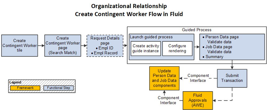

Create Contingent Worker Tile
Administrators use the Create Contingent Worker tile to create a new Person Data and Job Data record with a contingent worker relationship.
The following must be in place to see and access this tile and pages:
--The Fluid Person and Manage Relationship check box must be enabled on the Person and Job Installation - Person and Organization Page.
--You must be assigned the HR Admin Contingent Worker role.
Navigation:
The Create Contingent Worker tile is delivered as part of the fluid Manage Human Resources Dashboard when granted access.
This example illustrates the Create Contingent Worker tile
Select this tile to access the Create Contingent Worker Page and begin the process to add a new person and job record using fluid.
Create Contingent Worker Flow in Fluid
Use the following steps to perform the fluid-based approach to quickly create and process a new person and organizational relationship as a contingent worker:
This diagram shows the high-level functional pages and steps to create a new contingent worker using the fluid pages.
  1. Select the Create Contingent Worker Tile to begin the process (Workforce Administrator home page, and then Manage Human Resources tile, and then Create Contingent Worker Tile).
  2. Use the Create Contingent Worker Page to perform the Search/Match process to find potential Person Data matches in the system for this person or initiate the process to add a new person record.
    • No duplicate found: the process will continue with the Create Contingent Worker process and will move to either the Request Details or Person Data page, depending on your installation settings.
    • Duplicate found: the page will display the Potential duplicates grid for you to review duplicate person information. Options are available to view and add organizational relationships for a person or view or edit existing person data. If there is no person match, select the Create Contingent Worker button to continue with the process.
  4. Continue to the Create Contingent Worker activity guide process and enter your data.

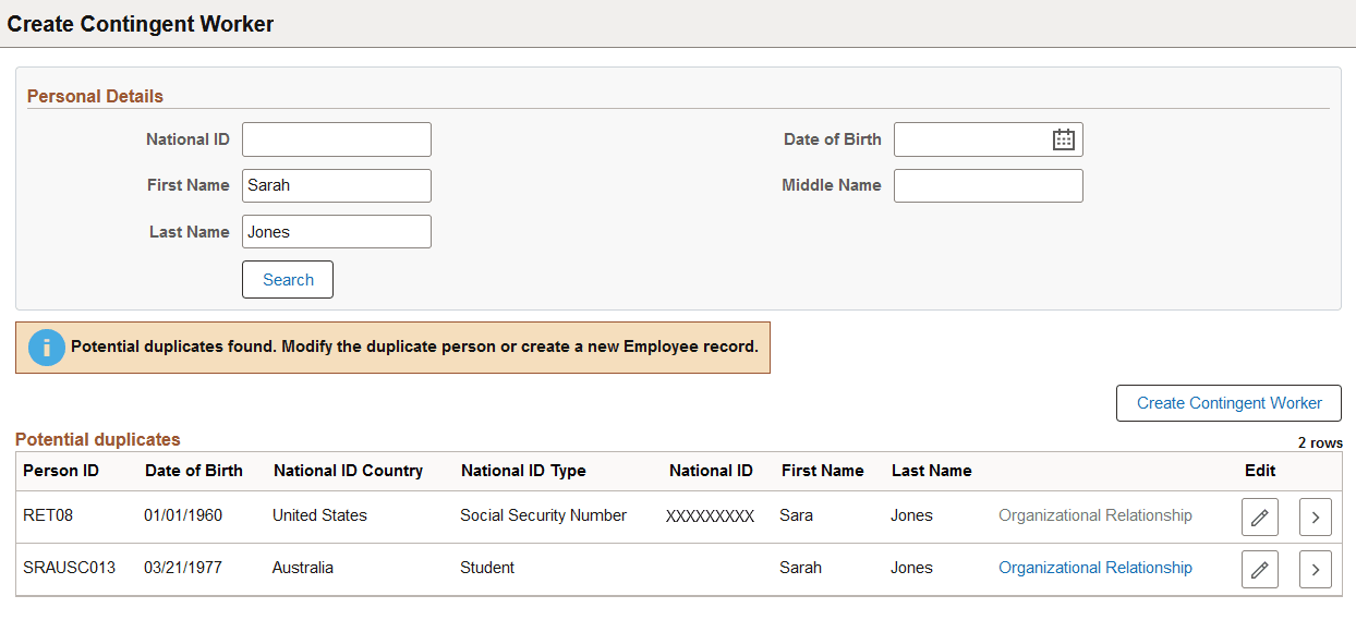

Use the Create Contingent Worker page (SRCH_PERSON_FL) to perform a search for duplicate IDs (with the ability to view or modify existing person records) and add a person with a contingent worker organizational relationship.
Navigation:
Select the Create Contingent Worker Tile on the Manage Human Resources home page.
This example illustrates the Create Contingent Worker page.
The Add Person Tile, Create Employee Tile, and Create Person of Interest Tile access this same page when you select the tile, but the title varies to reflect the transaction you are performing.
For field definitions, see the Add Person Page.

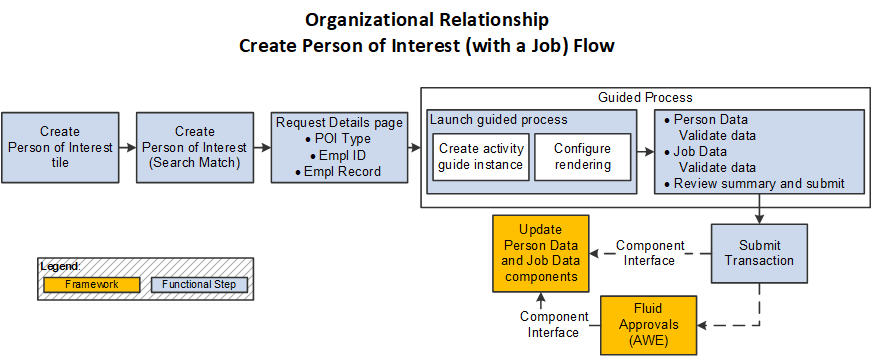

Create Person of Interest with a Job Flow in Fluid
Use the following steps to perform the fluid-based approach to quickly create and process a new person and organizational relationship as a person of interest (POI) with a job:
This diagram shows the high-level functional pages and steps to create a new person of interest with a job using the fluid pages.
  1. Select the Create Person of Interest Tile to begin the process (Workforce Administrator home page, and then Manage Human Resources tile, and then Create Person of Interest Tile).
  2. Use the Create Person of Interest Page to perform the Search/Match process to find potential Person Data matches in the system for this person or initiate the process to add a new person record.
    • No duplicate found: the process will continue with the Create Person of Interest process and will move to either the Request Details or Person Data page, depending on your installation settings.
    • Duplicate found: the page will display the Potential duplicates grid for you to review duplicate person information. Options are available to view and add organizational relationships for a person or view or edit existing person data. If there is no person match, select the Create Person of Interest button to continue with the process.
  3. Use the Request Details Page to select the person of interest type. The page will also display the employee ID and record entry fields, if configured to show.
  4. Continue to the Create Person of Interest Payee activity guide process.
Use the Create Person of Interest page (SRCH_PERSON_FL) to perform a search for duplicate IDs (with the ability to view or modify existing person records) and add a person with a person of interest (with a job) organizational relationship.
Navigation:
Select the Create Person of Interest Tile on the Manage Human Resources home page.
This example illustrates the Create Person of Interest page.
The Add Person Tile, Create Employee Tile, and Create Contingent Worker Tile access this same page when you select the tile, but the title varies to reflect the transaction you are performing.
Use the Work Location section of the Job Data page ((HR_JOBDATA_ADD_FL) in fluid to enter position and location information for a person's job, including the regulatory region, company, department, and location.
Navigation:
Navigate to the Work Location section or page of Job Data in fluid.
Use the Manage Human Resources Dashboard to access the Job Data pages in fluid:
This example illustrates the fields and controls on the Work Location (1 of 2).
Job Data Page - Work Location Section (1 of 2)
This example illustrates the fields and controls on the Work Location (2 of 2).
Job Data Page - Work Location Section (2 of 2)
Field or Control Description
HR Status
Displays the status of the current job record. A person can have an active HR status but an inactive job or payroll status.
Payroll Status or Job Status
The page displays the Payroll Status text for employee employment instances.
The page displays the Job Status text for contingent worker or POI instances.
Displays the payroll status of the current job record. Some changes that you make to this field trigger Retro Pay or Final Check processing.
A Retro Pay Request is triggered by any payroll status change with an effective date that's earlier than or equal to the latest pay end date of a check already paid to the employee.
A Final Check Request is triggered by any payroll status change that's based on one of the action or reason codes that are defined in the Final Check Action/Reason table.
Job Indicator
Indicate whether this is the person's primary or secondary job for this organizational relationship. Select Not Applicable if those selections don't apply to this job. This field is used to process people with more than one organizational instance in a single organizational relationship.
Military Service
This field appears when the Military check box is selected on the Installation Table and you are adding a new Job Data record, when you are not adding a new Job Data record this field is display only.
Select the military service in which the person is serving.
Position Number
If you drive part or all of the system by position, select a position number. Define positions in the Add/Update Position Info component. When you leave the Position Number field, the system completes position-related fields in the Job Data component with default data from the Add/Update Position Info component, including job code, department, location, supervisor level, reports to, and full- or part-time status. The corresponding fields become unavailable for entry.
PeopleSoft Human Resources issues a warning message if you assign a person to a position that is already filled and if the new appointment exceeds the maximum headcount for that position. The system calculates the headcount and displays the appropriate indicator in the Open/Filled field in the Add/Update Position Info component when you change assignments.
When Manage Primary Incumbent is enabled on the PeopleSoft Human Resources Manage Positions: Position Data Installation Page, and you made a change to a person’s position, the system issues a warning message about updating the primary incumbent information and recommends reviewing the PeopleSoft Human Resources Manage Positions: Manage Primary Incumbents Page. This happens when:
  • An employee is no longer the primary incumbent due to a job data change or has an HR or Payroll status change.
    When an employee leaves the position, the system will use the selection method as defined on the Position Management Installation table to assign a new employee as the primary incumbent.
  • An employee enters a new position and is assigned the primary incumbent role because the position does not currently have a primary incumbent.
The system will also send a push notification to the position administrator to review the Manage Primary Incumbents page. For additional information see PeopleSoft Human Resources Manage Positions: Managing Primary Incumbent Information for a Position.
Note: Oracle PeopleSoft delivers Notification Composer Framework to manage the setup and administration of all notifications in one central location. Once you have adopted the Notification Composer feature, you must use it to create new notifications and manage your existing notifications. Notifications delivered with HCM Image 47 or later must use Notification Composer. For more information about Notification Composer Framework, see Enterprise Components: Understanding Notification Composer.
See also PeopleSoft Human Resources Manage Positions: Creating Positions and PeopleSoft Human Resources Manage Positions: Creating Positions Using Fluid.
Override Details
Swipe this option to Yes to enter exceptions to the default position data for this person. This opens up the unavailable fields, including Job Code and Department, and you can override the entries that are in those fields. For example, the worker might have a higher salary grade than the standard grade that is associated with the position.
Warning! When a position override is selected for the purpose of setting a supervisor ID as manager instead of using the defaulted reports to value by leaving it blank, be aware that approval processes that use partial position management will attempt to resolve the position’s reports to manager from the Position Data table before using the supervisor ID supplied in Job Data. The approval process will route the approval to the reports to manager instead of the supervisor.
Note: If you override the defaults for position-related data, you must maintain the employee data manually; the system doesn't update the position data on the Job Data pages with data from the Add/Update Position Info component unless you turn off the override
Position Entry Date
When you enter a position number for this person, the system populates this field with the effective date and this field becomes unavailable for entry. You can override the default by setting the Override Details option to Yes.
If you are entering a transaction that returns a person to active status from an inactive status, the system will populate the field with the effective date of that transaction. For example, if you are rehiring a person as of September 1, 2023, the field will update to reflect this rehire date.
Position Managed Record
The system displays Yes when you make changes to fields in the Add/Update Position Info component that initiate a system update of fields here. A Yes indicates that the system inserted a data row on the Job Data pages.
Regulatory Region
If you have specified a regulatory region for the position you associated with this person, the system enters a default regulatory region and this field becomes unavailable for entry, unless you set the Override Details option to Yes.
If you have not assigned the person to a position, then the system populates the field by default with the regulatory region for the person, based on your user preferences entered in the Org Defaults by Permission Lst component. You can override the default.
Company
If you have specified a company for the position you associated with this person, the system enters a default company and this field becomes unavailable for entry, unless you set the Override Details option to Yes.
If you have not assigned the person to a position and you assigned a company to a department in the Department table, a default company code appears, and this field becomes unavailable for entry. If you did not designate a company on the Department table, select a company here.
PeopleSoft Payroll for North America requires employees and supported types of persons of interest to be associated with companies that have the correct tax report type, as configured on the Company Table - Tax Details page:
  • Employees must be associated with companies with tax report type W-2 or W-2PR (W-2 Puerto Rico).
  • Other Payee and Pension Payee persons of interest must be associated with companies with tax report type 1099R.
  • Student Refund persons of interest must be associated with companies with tax report type Non-Employees or None.
See Application Fundamentals: (USA) Tax Details Page.
Business Unit
If you have specified a business unit for the position you associated with this person, the system enters a default business unit and this field becomes unavailable for entry, unless you set the Override Details option to Yes.
If you have not assigned the person to a position, then the system populates the field by default with the business unit for the person, based on your user preferences. You can override the default.
The business unit that you assign to the person on this page and the setID functionality in PeopleSoft Human Resources Management affect the way that default values work throughout the PeopleSoft Human Resources system. Your entry in this field controls the departments, locations, job codes, salary plans, and so on that you see on the remaining Job Data pages.
Department
If you have specified a department for the position you associated with this person, the system enters a default department and this field becomes unavailable for entry, unless you set the Override Details option to Yes.
If you have not assigned the person to a position, select the department code for this person. When you leave the field, the system inserts a default supervisor or reports to ID on the Job Information section or page if you entered a default supervisor or reports to ID for this department in the Department table.
The system enters default values for the following fields on the Payroll page: Employee Type and Pay Group (which you associate with a company in the Company table). Depending upon other data setup, the system might enter a default holiday schedule.
See Application Fundamentals: Setting Up Holiday Schedules.
Note: Because this page can contain multiple data rows, the system doesn't always warn you that you must complete the Department field. However, if you change data in another field on the page, the system issues a warning and won't let you leave the field until you select a department code.
Department Entry Date
If you have specified a department for the position you associated with this person, the system enters a default department entry date and this field becomes unavailable for entry, unless you set the Override Details option to Yes.
When you leave the Department field, the system displays the date on which the person is first assigned to this department. However, if you are entering a transaction that returns a person to active status from an inactive status, the system will populate the field with the effective date of that transaction. For example, if you are rehiring a person as of September 1, 2023, the field will update to reflect this rehire date.
Location
If you have specified a location for the position you associated with this person, the system enters a default location and this field becomes unavailable for entry, unless you set the Override Details switch to Yes.
If you have not assigned the person to a position and you assigned a location to a department in the Department table, the system displays the department location, if the default location setID that you define in the Department table matches the control location set ID that is defined for that business unit in the TableSet Control - Record Group table. You can change the location code.
If you did not designate a location on the Department table, select a location here.
Note: For workers paid through PeopleSoft Payroll for North America, the location that appears here does not determine the person's primary work state and location that appear on the paysheets. You specify that information by selecting a tax location code on the Payroll page.
Establishment ID
Select the person's establishment.
Establishments are used for several countries for local regulatory reporting. These reports require that each person be assigned to a single establishment.
Establishments in regulatory regions other than USA have a one to one relationship with locations.
Note: (USA) In the USA regulatory region, there is a many to many relationship between locations and establishments. USA regulatory reports require that you associate an establishment ID with a person at the job level.
Note: (FRA) For payroll purposes, you must always assign persons to an establishment. If a person is assigned to a position, the system enters the establishment ID that is associated with the position and makes the field unavailable. If you associate a non-French position with a French person, the field remains available for entry.
Date Created
Displays the date on which you enter this record.
Last Start Date
Enter the most recent start date for this organizational instance.
Expected Job End Date and Expected Return Date
Enter the end date or return date for this job, if known. If you don't know the date initially, you can enter it later.
If this job is a temporary assignment and you do not enter a date in the Expected Job End Date field, you can run the Temporary Assignment w/out End Date report to identify those assignments that do not have an end date. This date is necessary if you want the system to terminate this job and reactivate any substantive job that may be on hold.
The system displays the day before the termination effective date as the termination date.
Use the Job Information section of the Job Data page (HR_JOBDATA_ADD_FL) in fluid to enter information about a person's job, including status, employee class, shift, or standard hours.
Navigation:
Navigate to the Job Information section or page of Job Data in fluid.
This example illustrates the Job Information (1 of 4).
This example illustrates the Job Information (2 of 4).
(Fluid) Job Information page (2 of 4)
This example illustrates the Job Information (3 of 4).
(Fluid) Job Information page (3 of 4)
This example illustrates the Job Information (4 of 4).
(Fluid) Job Information page (4 of 4)
Many values on this page come from the value that you entered in the Department field on the Work Location section or page. You can override most of these default values.
Job Code
If you have specified a job code for the position you associated with this person, the system enters a default job code and this field becomes unavailable for entry, unless you set the Override Details option to Yes in the Work Location section or page.
If you haven't assigned the person to a position, select the job code for this person.
Note: If you are attaching this person to a labor agreement in the Labor Information section or page and that labor agreement is associated with job codes, you must select a job code that is valid for the labor agreement. PeopleSoft Payroll for North America uses this field to create a pay line on a person's paysheets. The system creates a pay earnings record for each active job code on the person's employment record.
See PeopleSoft Human Resources Manage Labor Administration: Job Codes Page.
Job Entry Date
When you leave the Job Code field, the system displays the date on which the person is first assigned to this job code. However, if you are entering a transaction that returns a person to active status from an inactive status, the system will populate the field with the effective date of that transaction. For example, if you are rehiring a person as of September 1, 2020, the field will update to reflect this rehire date. If you are using position management, this field is unavailable for entry, unless you set the Override Details option to Yes in the Work Location section or page.
Supervisor Level
Supervisor levels are a class of position that represent levels of some managerial or supervisory significance and can be used as another type of employee identifier.
If you have specified a supervisor level for the position you associated with this person, the system enters a default supervisor level and this field becomes unavailable for entry, unless you set the Override Details option to Yes.
If you did not assigned the person to a position, select the supervisor level code for this person, if applicable.
See Defining Additional Employment Setup Data.
Supervisor ID
When using full Position Management, this field is unavailable. The system will use the Reports To field, which the position provides by default.
When using partial or no Position Management, this field is available, however, the system will not allow you to save the page when there are values in both the Supervisor ID and Reports To fields. If you want to enter a supervisor ID when using partial Position Management and a person is assigned to a position, set the Override Details option to Yes on the Work Location section or page to enable the Reports To field and remove the value that is provided from the position number.
If you have not assigned the person to a position and you assigned a manager ID to a department in the Department table, a default supervisor ID appears.
If you did not designate a manager ID on the Department table, enter a supervisor ID here, if applicable.
Note: Specify the person's department code before you enter a new supervisor ID. If you enter a supervisor ID before you select a department code, the system overrides the ID each time that you enter or change the person's department.
Reports To and Reports To Manager or View Current Incumbents link
Displays the position number, title, and name of the manager associated with this position. When the Manage Primary Incumbent functionality is enabled on the PeopleSoft Human Resources Manage Positions: Position Data Installation Page, a View Current Incumbents link will appear instead of the Reports To manager’s name. Click the View Current Incumbents link to access the Current Incumbents to view the incumbents for the Reports To position. When there are no incumbents assigned to this Reports To position, the page will issue a message stating that there are no current incumbents to view.
If you have specified a reports to number for the position you associated with this person, the system enters the default value and this field is unavailable for entry, unless you set the Override Details option to Yes.
If you have not assigned the person to a position and you assigned a reports to ID to a department in the Department table, a default reports to ID appears.
If you did not designate a reports to ID on the Department table, enter a reports to ID here, if applicable.
Regular/Temporary
Defaults from the position number you associated with this person, and this field is unavailable for entry, unless you set the Override Details option to Yes.
If you have not assigned the person to a position, the system displays the default value from the Job Code Table. You can override this value.
Full/Part
If you have not assigned the person to a position, indicate whether the worker is full-time or part-time.
Note: The Manage Base Benefits business process uses the values that you select in the Regular/Temporary and Full/Part fields to determine eligibility requirements. PeopleSoft Payroll for North America uses the full-time or part-time information in conjunction with the holiday schedule. When a holiday falls within a pay period, Payroll for North America prorates the holiday hours for part-time workers. However, proration is based on the standard hours for the worker, not for the pay group.
Employee Class
Select an employee class, which provides another method of grouping workers. Examples may include Assignee, Expatriate, or Intern. Employee classes are included in the Employee Class table. To override, access this page in correction mode.
The list of values depends on the regulatory region that is specified in the Work Location section or page and the setID values entered in the Employee Class component.
Note: (CHN) Select the Regular/Temporary field value first and then select the corresponding Empl Class value to enable the company to sort employees correctly. If you select the Regular/Temporary value of Regular, then you should leave theEmpl Class field empty. Normal global payroll taxes will be calculated for the employee. (If you select Regular for Regular/Temporary and Instructor for Empl Class, you can still save the data, but the company will be unable to sort employees correctly or calculate the correct employee number.) If you select Temporary for the Regular/Temporary value, then you can select any of the Empl Class values (Consultant, Contractor, Instructor, Intern, or Others). Remuneration services tax will be calculated in this case. (GBR) The Northern Ireland Fair Employment Monitoring report (UKNI001) uses the employee class to determine the classification of workers. If the organization submits this report, you must use the required employee classes for the report to work correctly. (JPN) Select Host ICT (Hosting Intercompany Transfer) to flag those workers that are hired on an intercompany transfer basis when the company is the host company.
See PeopleSoft Human Resources Meet Regulatory Requirements: Understanding U.K. Regulatory Requirements.
Officer Code
Identify highly compensated workers for the Non-Discrimination Testing - 401(k)/401(m) report (NDT004). The default value is None.
Regular Shift
If the worker is working shifts, select the appropriate shift. If the worker doesn't work shifts, leave the Shift Rate and Factor fields blank. The default value is N/A (not applicable).
Shift Rate and Shift Factor
If you selected the Specified at Employee level option on the Shift table, enter the shift differential for this worker and job.
Enter the shift differential as a rate (flat amount), a factor (percentage), or both. Use the first field to enter a flat amount and the second field to enter a percentage.
Note: To apply the same shift differential to a group of workers who work the same shift, enter shift information in the Shift table in Payroll for North America. If you specify the differential on the Shift table, the system does not use shift rate information from Job data.
See PeopleSoft Payroll for North America: Understanding HCM Information Used in the Payroll Process and PeopleSoft Payroll for North America: Understanding Tables That Support the Payroll Process.
Classified Ind (classified indicator)
(E&G) This field is visible only for departments that have been set up to use commitment accounting. Departments are configured to use commitment accounting on the Comm. Acctg and EG page in the Department component.
Associate the position with an FTE Classification (full time equivalents classification) that you established on the Department Budget FTE page.
Duties Type
For jobs where the action or reason is temporary assignment, select the type of duties for the temporary assignment from the Temporary Duties Type table. You can use this feature only if the Automatic Job Suspension check box is selected on the Installation Table - Product Specific page.
Encumbrance Override
(E&G) Select to override encumbrance processing at the job level when you create a new organizational instance or add a concurrent job for a worker date if the department uses Commitment Accounting.
Standard Hours
The standard hours fields defaults from the position number you associated with this person, and these fields are unavailable for entry, unless you set the Override Details option to Yes. If you have not assigned the person to a position or set the Override Details option to Yes and change the job code, then the system populates the fields by default from the job code. You can override the defaults.
Standard Hours
Displays by default the standard hours for the worker. Change the default value, if required.
Work Period
Select a standard work period, the time period during which workers must complete the standard hours.
The system uses the annualization factor of the standard work period in combination with the standard hours to calculate full-time equivalency.
FTE (full-time equivalency)
Displays the percentage of full-time work that the worker should normally work in this job. The system calculates this value based on the standard hours entry for this job and the standard work period. However, you can override the system-calculated FTE and enter any value. The system issues a warning if you enter a value that is greater than 1.0.
Combined Std Hours (combined standard hours) and FTE
Displays the total standard hours that are assigned to the worker for all active jobs combined and the worker's total FTE status for all active jobs combined.
For example, if a worker holds two jobs, one as a professor with an FTE of .5 and one as a physician with an FTE of .35, the worker's combined FTE is .85 (.5 + .35 ). You can't change or delete this information.
Note: The combined FTE that appears here may be different from the total FTE that is calculated for benefits administration eligibility. Combined FTE on this page is the sum of a worker's individual FTEs from active jobs only.
Contract Number
Contract Number and Assign New
Select the worker's contract number or click the Assign New to associate a contract with a person, if applicable.
Note: Existing contracts that have a value in the End Date field (the system displays this field on the prompt page) are not valid selections. The system populates the contract end date when the contract is terminated. If you know when the contract will end, enter the date in the Contract Expected End Date on the Contract Status/Content page.
Note: (ESP and FRA) This is a required field when the action is hire, rehire, or transfer for workers who belong to a Spanish or French regulatory region. View the prompt values in the Contract Number field to view all active contracts for that worker. If the worker has no active contracts in the system, click the Next Contract Number button; the system assigns a new contract number. When you save, the system warns you that you must update the contract information for the new contract number that is automatically created for this worker. Access the Contract Data component using the new contract number, and make the necessary updates.
Note: (BRA) When you enter a contract number and saves the page, a PeopleCode is run to populate the contract type on the (BRA) Additional Contract Data Page for the worker based on these scenarios: If a contract number is specified and the contract type is populated, the system takes the contract type and identifies the associated legal contract type that is set up on the Legal Contract Type Page of the Legal Contract Type component. If no contract number is specified, or if a contract number is specified but the contract type is not available, the system takes the employee class from the Job Information section or page, and identifies the associated legal contract type that is set up on the By Employee Classification Page of the Legal Contract Type component. The identified legal contract type is then populated to the Additional Contract Data page as the contract type.
Contract Type
Displays the contract type that is associated with the contract number that you select.
See Tracking Workforce Contracts.

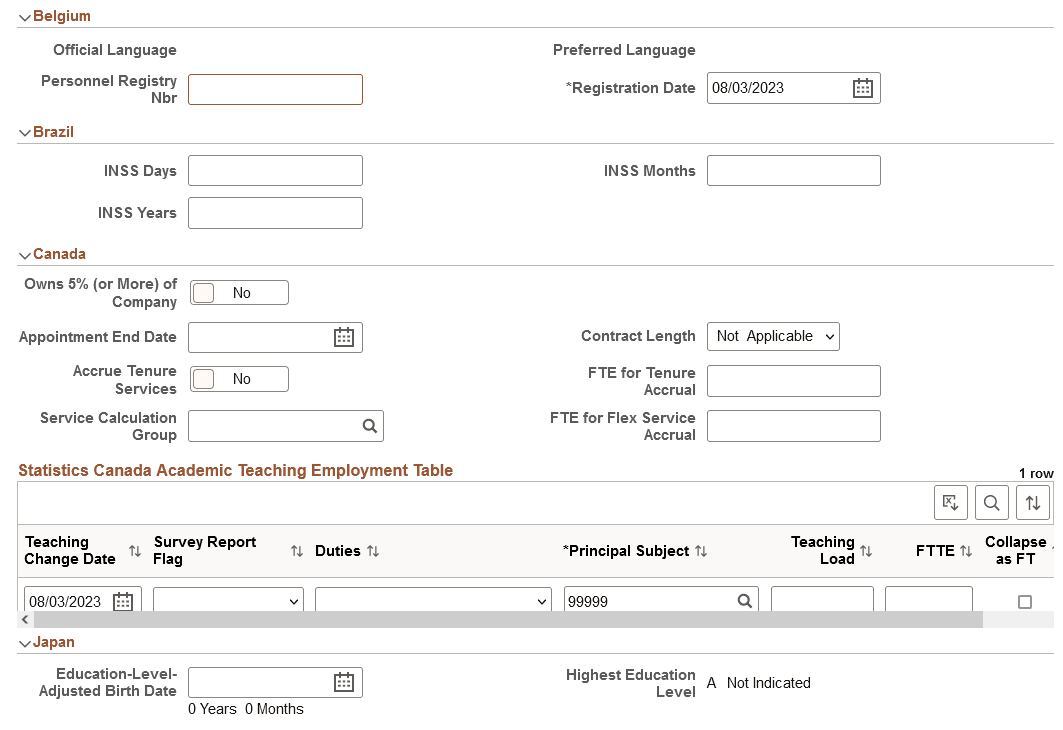

(BEL) Belgium
Subcommittee
Enter the subcommittee of the union.
Use the Salary and Compensation section of the Job Data page (HR_JOBDATA_ADD_FL) in fluid to enter information about a person's salary plan and compensation information.
Navigation:
Navigate to the Salary and Compensation section or page of Job Data in fluid.
This example illustrates the fields and controls on the Salary Plan section of Job Data page (1 of 2).
Job Data Page - Salary and Compensation Section (1 of 2)
This example illustrates the fields and controls on the Salary Plan page (2 of 2). You can find definitions for the fields and controls later on this page.
Job Data Page - Salary and Compensation Section (2 of 2)
Military
The section appears when military functionality is enabled on the Installation Table. Select a military service for a person on the Work Location page prior to entering a rank or worn rank.
Rank
Enter the service member's earned rank. Valid ranks are defined on the Military Service - Service Ranks page.
Rank Entry Date
Enter the date the member received this rank.
Worn Rank
Enter the service member's rank insignia while serving in a particular post.
The default value for this field comes from the Rank field but it can be overwritten. Changes to the Rank field value will also change the value in this field.
Note: To have the system display the worn rank in front of the employee's name at the top of the Personal Data, Job Data, and military pages, you must have Military, Event Manager, and Publish/Subscribe enabled in the system and the Domain status should be active. When a rank is changed on the current row, the event AssignmentMilitaryRankChanged is raised and the Event Manager triggers the handler to update the Names in Personal Data Component.
See Events and Notifications Framework: PeopleSoft Events and Notifications Framework Overview
Worn Rank Type
Indicate why the individual is on worn rank.
Skill Grade
Select the overall grade level for which the individual has been evaluated
When military rank information is defined for a service member, the system restricts the salary plan to those plans associated with military ranks on the Military Service table. In addition to this, only the salary grades associated with the specified ranks are available. Therefore, the salary defaulting logic does not apply to military users.
Salary Plan
Salary Admin Plan
Displays the salary administration plan code. This field will default from the position number you associated with a person, and is available for entry regardless if you use the Override Details option.
If you are not using position management and you associate salary administration plans with locations or job codes, the value that is in this field comes from either the Location or Job Code table, based on setID matching. You can override the default.
Note: If you have salary administration plans associated with more that one of these tables, the system uses the default from the last table value entered. For example, first you enter a location that is associated with salary plan KU02 where this salary plan defaults to this page. Then, you enter a job code that is associated with salary plan KU03, and the system will update the salary plan to KU03.
If you change the location (and a salary plan is defined in the Location table), then the system does not automatically display a default value for this salary plan. Instead, the system checks if the existing grade and step are still valid for this new salary plan. The existing grade and step must also be defined for the new salary plan. If the grade and step are defined for this new salary plan, then the system displays by default from the Location table the value for the new salary plan. If the grade and step are not defined for this new salary plan, then the system does not change to the salary plan from the Location table.
To use auto-calculated premium processing for this person, select a plan that has Auto Calculated Premium selected and an absorbing or nonabsorbing (or both) premium rate code assigned in the Salary Plan table. The system displays auto-calculated-premium-related fields on the Compensation page only if you select an auto-calculated premium plan here.
Note: If this worker has a labor agreement and job code with a wage progression salary plan, the system populates this field by default and makes it unavailable for entry.
Grade
If you associate a grade with the person's position or job code, the system displays the default value from the appropriate table.
Grade Entry Date
Displays the date on which the person first joined this grade. You can override this value.
If you are entering a transaction that returns a person to active status from an inactive status, the system will populate the field with the effective date of that transaction. For example, if you are rehiring a person as of September 1, 2020, the field will update to reflect this rehire date.
Step
If you associate a step with the person's position or job code, the system displays the default value from the appropriate table.
Step Entry Date
Displays the date on which the person first joined this step, or if you are entering a transaction that returns a person to active status from an inactive status, the system will populate the field with the effective date of that transaction. For example, if you are rehiring a person as of September 1, 2014, the field will update to reflect this rehire date. You can override this value.
Note: The system verifies the combinations of salary administration plans and grades that you select.
Includes Wage Progression Rule
Indicates if the salary plan includes wage progression.
Compensation
Use the Payroll section of the Job Data page (HR_JOBDATA_ADD_FL) in fluid to enter payroll processing data. The payroll system and pay group information that you enter here affects component compensation processing on the Salary and Compensation section or page.
Navigation:
Navigate to the Payroll section or page of Job Data in fluid.
This example illustrates the fields and controls on Payroll.
Payroll System
Select the payroll system that is used to process this person's paycheck. The Payroll System field is available for entry only if the Action that was entered on the Work Location page is Change of Pay System or a hire-related action such as Rehire or Additional Job.
Note: PeopleSoft Payroll for North America does not process payroll for contingent workers. Customers using the E&G contract pay functionality need to add contract workers using the Add Employment Instance component or the Organizational Relationships page.
Absence System
Select the absence system that is used to process this person's absences.
If you use PeopleSoft Payroll for North America or PeopleSoft Payroll Interface to process this person's paycheck, complete these fields:
Pay Group
Select a pay group. Available values are the valid pay groups for the country selected on the Company table (not the regulatory region selected in the worker's job data).
Employee Type
Displays the employee type; the value depends on the pay group. The system completes the field with the default value from the Pay Group table. If an employee type doesn't exist for this pay group, establish one in the Pay Group table.
Holiday Schedule
If you defined a default holiday schedule for the employee's location, the system displays it here. If you left the holiday schedule blank on the Location Profile page and entered a default on the Pay Group table, the system displays it here.
Tax Location Code
Select a tax location code. Available values are the valid tax locations for the country selected on the Company table (not the regulatory region selected in the worker's job data).
Note: Do not change a person's tax location code more than once for the same effective date (using effective sequence). The system creates tax records according to the first tax location change only. Tax records for the second tax location change on the same date are not created; instead, the system issues an error message.
Tipped
Indicate whether this worker receives tips. This field is available only if you define tips processing in the Company table. Values are:
Directly: Select for workers who normally receive tips directly from customers (for example, food servers).
Indirectly: Select for workers who do not normally receive tips directly from customers, but who might receive tips occasionally (for example, cooks and kitchen helpers).
Not Tipped: Select for workers who are not tipped.
GL Pay Type (general ledger pay type)
Organizations can use this field for customized general ledger interfaces. Payroll for North America does not use this field.
FICA Status
Indicate whether the person status is exempt, subject, or Medicare only.
Edit ChartFields
Click this link to access the ChartField Detail page (HMCF_CHRTFLDDTL_FL) to enter a combination code and select ChartField details.
Combination Code
(Optional) Select the appropriate labor distribution to which to post the hours and earnings for this person. Enter the general ledger combination code in the employee's job data only on an exception basis. If you do not want the employee's earnings charged to the default combination code that is mapped to the earnings code and department, you can enter a different combination code here. For example, you might want to temporarily charge the employee's earnings to a different department. Use Correct History mode to enter or remove the temporary combination code.
You can delete this combination code, if needed.
Earnings Distribution
Use the Job Earnings Distribution section to distribute a person's compensation for one job among different departments, job codes, accounts, shifts, position numbers, or general ledger pay types.
Review these guidelines prior to entering data in the Job Earnings Distribution section:
  • Skip this section if you don't need to distribute standard earnings for the person.
    Payroll for North America uses the department, job code, account, shift, position number, and general ledger type that you enter on the Work Information and Payroll pages to calculate pay earnings records.
  • The system hides this section when all job rows in the component use PeopleSoft Global Payroll.
    However, if the selected job row has a payroll system other than Global Payroll (for example, PeopleSoft Payroll for North America or Payroll Interface), then the system displays the section.
  • Don't use this section to distribute special earnings, such as holiday pay or bonuses; instead, use the processes in PeopleSoft Payroll for North America for handling special earnings.
  • If you enter a parameter such as department in this section, the parameter overrides the same field on the job record.
    If you leave a parameter blank, the system uses the field from the job record.
Standard Hours and Work Period
If you are using position management and click the Override Details option to Yes, these fields become available. If you change these values on this page, it will also update the same fields on the Job Information page.
Earnings Distribution Type
Select an earnings distribution type. Values are:
  • None: Select to indicate that you don't allocate earnings for this person. The system calculates and charges person compensation according to the information that is listed in the Job Data component. If you select this option, the Job Earnings Distribution section grid fields will not be available for entry.
    Note:You must select None if you want the system to use the proration rule that you select on the Pay Group Table - Paysheets page when prorating partial pay.
    See Application Fundamentals: Understanding Pay Groups.
  • By Amount: Available only for salaried workers. This enables you to apportion the worker's total earnings for a period on the basis of an amount.
    Select to instruct the system to total the amounts that are in the distribution lines and check the total against the total in the Compensation Rate field on the Salary and Compensation page. The total earnings distribution amount must equal the compensation rate amount. If the amounts are not the same, the system generates an error when you try to save the record. You will need to resolve the discrepancy to save the Job Data record.
    For example, to charge 3,000 of a worker's regular earnings to the worker's regular department (on the job record), 544 to department 105, and 1,000 to department 10503, you set up three distribution lines:
    • On the first line, leave Department blank (so that the system uses the worker's regular department from the job record) and enter 3000 in the Amount field.
    • On the second line, enter 105 in the Department field and 544 in the Amount field.
    • On the third line, enter 10503 in the Department field and 1000 in the Amount field.
    The amounts that are in the distribution lines total 4,544, so the system checks that amount in the Compensation Rate field on the worker's job record equals this total.
  • By Hours: Available only for hourly or exception hourly workers. Select to instruct the system to total the hours that are in the distribution lines and update the total in the Standard Hours field on the Job Information page. The Standard Hours field that appears at the top of this page also changes.
    Enables you to apportion the worker's total earnings for a week on an hourly basis. The system totals the hours in all distribution lines and inserts the total in the Standard Hours field on the worker's job record.
    For example, if a worker works a 40-hour week, and you want to charge 30 hours of regular pay to the worker's regular department (on the job record) and 10 hours to department 103, you set up two distribution lines:
    • On the first line, leave Department blank (so that the system uses the worker's regular department (from the job record) and enter 30 in the Standard Hours field.
    • On the second line, enter 103 in the Department field and 10 in the Standard Hours field. The hours that are in the distribution lines total 40, so the system inserts 40 in the Standard Hours field on the worker's job record.
  • By Percent: Available to all workers. The sum of the percentages that are in the distribution lines must equal 100.
    Enables you to apportion the worker's total earnings for a period on a percentage basis.
    For example, to charge 80 percent of regular earnings to the worker's regular department (on the worker's job record) and 20 percent to department 100, set up two distribution lines:
    • On the first line, leave Department blank (so that the system uses the worker's department from the job record) and enter 80 in the Percent field.
    • On the second line, enter 100 in the Department field and 20 in the Percent field.
Job Earnings Distribution grid and Add button
Click the Add button to display the Job Earning Distribution grid, where you can enter the distribution information.
Global Payroll
You will see this information if you use PeopleSoft Global Payroll to process a person's paycheck.
This example illustrates the fields and controls on the Payroll section or page for Global Payroll.
Job Data Page - Payroll Section for Global Payroll
Pay Group
Select a pay group.
The payroll system that you select on the Installation Table - Products page determines what value appears here. If Global Payroll is selected, the Global Payroll pay groups appear.
Note: The Global Payroll Pay Group field is different from the Payroll for North America Pay Group field. Pay group is very important in Global Payroll. Selecting Global Payroll as your payroll system on the Installation Table - Products page and selecting a pay group is what helps select a payee into the payroll process.
Holiday Schedule
Enter a holiday schedule. If you leave this field blank, Global Payroll processing uses the holiday schedule assigned to the payee's pay group, but does not enter that holiday schedule here.
Eligibility Group
This field is blank if Use Pay Group Eligibility is set to Yes. If you want to override the pay group default, set to No and select an eligibility group which specifies earnings, deduction, and absence elements that a payee might be eligible to receive.
Exchange Rate Type

Use Pay Group Eligibility, Use Pay Group Rate Type, and Use Pay Group As Of Date
When you select a pay group, these fields are automatically set to Yes.
Leave them set to Yes to use the default values from the pay group definition. Swipe to No to override the default values.
Use the Employment Data section of the Job Data page (HR_JOBDATA_ADD_FL) in fluid to enter optional data, such as a worker's business title.
Navigation:
Navigate to the Employment Data section or page of Job Data in fluid.
This example illustrates the fields and controls on the Employment Information section or page (1 of 3).
Job Data Page - Employment Data Section (1 of 3)
This example illustrates the fields and controls on the Employment Information section or page (2 of 3).
Job Data Page - Employment Data Section (2 of 3)
This example illustrates the fields and controls on the Employment Information section or page (3 of 3).
Job Data Page - Employment Data Section (3 of 3)
The dates on this page are used in reports and to enable you to track a person's work history.
Organizational Instance
Instance Record
The number of the instance associated with this job data record. The organizational instance record number is the same as the ERN of the controlling instance.
You can only modify the organizational instance dates when you review this page for the controlling instance.
Note: When you review this page for a non-controlling instance, the system makes the rest of the fields in this group box display only because non-controlling instances inherit the instance dates from the controlling instance.
Original Start Date
Displays the earliest date that this job data record (emplID/ERN instance) was associated with the organization. The date is provided by default from the effective date of the job record with an action of Hire, Add Contingent Worker, or Add POI Instance. This is not the date the job was created in the system, like the Date Created field on the Work Location page. You can override this date to enter an earlier start date, for example if the person has previously worked for the company or an affiliate or, depending upon company policies, for special cases like jobs with probationary periods, mergers and acquisitions, and so on.
See Understanding Job Data.
First Start Date
Displays the first start date for this organization instance. The system populates this field with the effective date of the first job data row with the action of HIR (for employees) or ADD (for contingent workers) from the controlling instance.
The system uses this date as the hire date in reports.
Note: The system does not refresh this date again unless you enter a new row in the controlling instance with one of these actions. You would normally not do this unless you needed to reset the hire date.
Last Start Date
Displays the most recent start date for this organization instance. The system populates this field originally with the effective date of the controlling instance's job data row with the action of HIR and then refreshes it with the effective date of job data rows with the actions REH (for employees) or RNW (for contingent workers).
This date is different from the first start date if this organization instance has been inactive and then reactivated.
Termination Date
Displays the day before the effective date of the controlling instance's job data row with the action of TER or COM, if applicable.
If you rehire or renew a person's controlling instance, the system deselects this field.
Org Instance Service Date (organizational instance service date) and Override
Displays the effective date on which the service of a person commenced with the organization. The date is provided by default from the effective date of the job record with an action of Hire, Add Contingent Worker, or Add POI Instance. Select the Override check box to override this date to enter an earlier service date, for example if the person has previously worked for the company or an affiliate.
Provider ID
For contingent workers, displays the ID of the service provider.
Organizational Assignment Data
Assignments are the job data records tracked under an organizational instance, each identified by a unique emplID/ERN combination. Track the start and completion dates of individual assignments at the assignment level.
Last Assignment Start Date
Displays the most recent start date for this assignment. The system populates this field with the effective date of the job data row with an action that reactivates the assignment. This date is different from the first assignment start date if this assignment has been inactive and then reactivated.
First Assignment Start
Displays the first start date for this assignment. The system populates this field with the effective date of the first job data row with an action that activates the assignment (such as HIR or ADD).
Assignment End Date
Displays the effective date of the job data row with the action of TER or COM, if applicable.
Home/Host Classification
For workers who are on assignments, this field specifies whether the current job is at the worker's home location or the assignment location.
Time Reporter Data
Click to review the PeopleSoft Time and Labor data for this worker. If you don't use PeopleSoft Time and Labor, this link is unavailable.
Company Seniority Date or Engagement Date and Override
This field normally displays as the Company Seniority Date field. However, when military functionality is enabled on the Installation Table and this person is a person associated with a rank, this field displays as the Engagement Date field. Based on the date that you enter here, the system calculates the number of years, months, and days of seniority or engagement for a person. Select the Override check box to change the date.
Benefits Service Date and Override
Based on the date that you enter here, the system calculates the total years, months, and days of service for a worker, including any credit for military leave or the total amount of time that the worker works for multiple companies in the organization. This date is used to calculate benefits eligibility. Select the Override check box to change the date.
Seniority Pay Calculation Date and Override
Enter the date that the system should use to calculate seniority-based pay. Select the Override check box to change the date.
Probation Date
Enter the date on which the worker is placed on probation.
Professional Experience Date
Displays the earliest date on which the worker started working in a job that required skills that are directly related to the worker's current position.
Last Verification Date
Displays the latest date on which the worker verified his or her personal data in the system.
Business Title
Enter the worker's official title, which might be different from the job title.
If the employee is in a position, the system displays the current title from the worker’s position. When this field gets its value from the position, and position data is not overridden, you should run the Refresh Person Org Assignments (HR_PERORGASN) process to update the Employment Data record with future dated rows that have become current. For more information on this process, see the PeopleSoft Human Resources Manage Positions: Refresh Person Org Assignments Page.
Position Phone
Track the worker's primary work phone number. You can also update this field by using the Add/Update Position Info pages.
If you drive part or all of the system by position, the system enters the default phone number for the position number that you assign to the worker on the Work Location page. When this field gets its value from the position, and position data is not overridden, you should run the Refresh Person Org Assignments (HR_PERORGASN) process to update the Employment Data record with future dated rows that have become current. For more information on this process, see the PeopleSoft Human Resources Manage Positions: Refresh Person Org Assignments Page.
When you enter a new row with an action of HIR, ADD, POI, ADL, or ASG and save the component, the system sets the Company Seniority Date, Benefits Service Date, and Seniority Pay Calc Date (seniority pay calculation date) fields on this page to the effective date that you enter on the Work Location page as long as the Override date check box is not selected. You can override these fields after saving the component. The system calculates and displays the worker’s service months and days based on the information that you enter in the Company Seniority Date, Service Date, and Seniority Pay Calc Date fields.

(BEL) Belgium
The system displays the official language, based on the company official language, unless the company is located in Brussels-Capital Region, in which case the preferred language is the default.
Personnel Registry Nbr (personnel registry number)
Enter the number under which the worker is registered in the personnel register.
(BRA) Brazil
INSS Days, INSS Months, and INSS Years (Instituto Nacional de Securidade Social days, months, and years)
Enter the number of days, months, and years that the worker makes social security contributions before being hired by the company.
(CAN) Canada
Owns 5% (or More) of Company
Set to Yes if the person owns five percent or more of the company. The system uses this field to identify highly compensated employees for the Non-Discrimination Testing in the Manage Base Benefits business process of PeopleSoft Human Resources.
Accrue Tenure Services
Set to Yes to activate the tenure accrual.
FTE for Tenure Accrual
Enter the FTE to be used in tenure accruals. FTE cannot be greater than 1.0. On multiple jobs, the sum of the FTEs of all the jobs selected to accrue tenure cannot be greater than 1.0.
Service Calculation Group
Select the service calculation group that represents a group employees who have the same calculation rules applied to their service accrual process.
FTE for Flex Service Accrual
Enter the FTE value to be used in prorating the worker's accrued service.
(CAN) (E&G) Statistics Canada Academic Teaching Employment Table
The fields in this table are used in the Canada Academic Teaching Surveys business process, a regulatory requirement for Canadian higher-education, degree-granting institutions. Complete this table for all faculty staff if you are required to submit Academic Teaching Surveys to Statistics Canada. Review the information in this table to ensure that it is up-to-date every time that you change a worker's record.
Teaching Change Date
The system adds a new teaching change date row only if you choose to add one.
Insert a new row for each teaching appointment if the institution uses the same employee record number to record successive appointments. For the Part-Time Academic Teaching Survey, the system reports the Academic Teaching Employment record that is effective on the end date of the appointment or at the end of the period that is being reported.
Survey Report Flag
Displays the report flag value, as specified on the Job Code Table - Job Code Profile page. If the value is N/A, this record isn't reported in academic teaching surveys. You can override this default value.
Duties
Displays the duties value, as specified on the Job Code Table - Job Code Profile page. You can override this default.
Principal Subject
Select the principal subject that is taught by the worker.
Teaching Load
Enter the worker's teaching load during the academic teaching employment. For example, if the worker is teaching three full courses, enter 3.0. If the worker is teaching one full course and one-third of another, enter 1.33.
FTTE (full-time teaching equivalency)
Enter the ratio of the teaching load to the full-time teaching equivalency. For example, if teaching four courses constitutes full-time and the worker is teaching three courses, enter .75.
Collapse as FT (collapse as full-time)
Select if the employment can be collapsed into the reportable full-time job for the purpose of consolidating salary amounts from jobs that make up a full-time job.
Use this field only if the worker:
  • Has two or more part-time jobs in different departments that function as a single full-time job.
  • Receives an administrative stipend under another employee record number that doesn't accrue benefits but counts toward the worker's full-time salary.

(JPN) Japan
Education-Level-Adjusted Birth Date
Select the worker's education-level-adjusted birth date. The day and the month are the organization's standard calculation birth date (SCB—usually April 1); the year comes from the worker's education-level-adjusted birth date (ELABi). Although the system calculates this date, you can overwrite it (for example, to give a worker credit for special work experience).
Years Months
Displays the worker's highest education level as specified in the Personal Data component. This education level is the starting point for education-level age-related calculations.
(MYS and SGP) Malaysia and Singapore
After you set up festive advance calculation rules and the pay programs, and associated job codes with pay programs, the eligible workers that are in the workforce are granted festive advances. Assigning the festive advance type to the worker occurs during the hire process after you assign the ethnic group, religion, and job code. However, before you accept those defaults, you might still have some issues to resolve. If you decide that any of the worker's festive advance details should be different, change them on this page.
Ethnic Group and Religion
Displays the values that you enter on the Personal Data - Regional page.
Festive Advance Pay Program
Displays the value from the Job Code Table - Job Code Profile page. You can change this default.
FA Holiday Type (festive advance holiday type)
Select a festive advance type. Values are: Chinese New Year, Christmas, Deepavali, Hari Raya, and N/A.
The default value is the festive holiday that is appropriate to the ethnicity or religion that you enter for this person on the Personal Data - Regional page. You can change this selection. If a person chooses not to receive a festive advance, select N/A.
Festive Advance Eligible From
Displays the festive advance eligible from date. If the firm has a probation period that must be served before a worker is entitled to a festive advance, the probation period must be monitored.
When you set the probation period in the Festive Advance Pay Program, you set the number of days or months. The system adds this information to the worker's hire date to determine the festive advance eligible from date; this date appears as the default on the FA Employee Details page.
When you process the festive advances, the system checks the festive advance eligible from date against the date on which to pay the advance. If the festive advance eligible from date is not yet passed, the worker is not paid a festive advance.
Note: This date is used by the festive advance calculation process and the festive advance calculation rule to determine if the worker has served enough time to be eligible for a festive advance. The date is derived from the job commencement date and the probation period in the Festive Advance Pay Program.
(NLD) Netherlands
Relation to Owner
Select the worker's relationship to the owner, as appropriate.
(USA) United States of America
Swipe to Yes to activate the tenure accrual.
Use the Benefit Program Participation section of the Job Data page (HR_JOBDATA_ADD_FL) in fluid to specify the benefit program in which a person is enrolled for benefits in PeopleSoft Human Resources or PeopleSoft Benefits Administration.
Navigation:
Navigate to the Benefit Program section or page of Job Data in fluid.
This example illustrates the fields and controls on the Benefit Program Participation section or page.
Benefit Record Number
Displays the benefit record number, which is an identifier that links two or more jobs for benefits purposes. The system sets the value to 0. You can override this value to attach this job to a different benefit record number. The system deselects the benefits program data and repopulates it with values that are attached to the benefit record number that you enter.
Benefits System
Select the appropriate benefits system. Select Not Managed in PeopleSoft (benefits managed by a system other than PeopleSoft) to filter out persons who have insufficient employment and job information to support benefit enrollment.
Benefits Administration Eligibility
Eligible Field 1–9
Enter values to further filter persons' eligibility for a specific benefit. These are client-definable fields.
Benefit Program Participation Details
Add Benefits Program button
Select to add participation details.
Benefit Program
Displays the code that corresponds with the benefits program for the person's pay group, which you specify in the Pay Group table. You can override this value.
Currency Code
Displays the code of the currency that is specified for the benefit program in the Benefit Program table.
Use the Create <Organizational Relationship> - Summary page in fluid (JOB_DATA_RVW_FL) to view the proposed information you are adding for a Person Data and Job Data record prior to submitting the transaction.
Where <Organizational Relationship> represents Employee, Contingent Worker, or Person of iInterest.
Navigation:
Select the Next > button on the Job Data Page in fluid, provided there are no validation errors or you have chosen to proceed with the warnings.
This example illustrates the fields and controls on the Create <Organizational Relationship> - Summary page when you are adding job data information.
This page uses the Employee Header Configuration feature. For more information on defining header fields and layout, see Application Fundamentals: (Fluid) Managing Employee Headers.
Previous button
Select this button to correct or add additional information before you submit.
Submit button
Select this button to submit and save the information to the system.
When approvals are enabled for organizational relationships on the Person and Job Installation - Person and Organization Page, you will be taken to the Create <Organizational Relationship> - Submit Confirmation Page to view that your request has successfully been submitted for approval, view the approval status, and take other actions normally available from the Manage Human Resources Dashboard.
Note: Managers use fluid Approvals to view Add Employee, Add Contingent Worker, and Add Person of Interest data requests using the Pending Approvals - Add <Organizational Relationship> Page.
When approvals are not enabled for an organizational relationship, you will be taken to the confirmation page to view that your entry has been created and allow you to initiate HR transactions.
PeopleSoft HCM delivers the Summary page with a pre-seeded configuration. Administrators can configure this page to hide or show fields, even those that were not changed using the Transaction Summary functionality. For more information on setting up this information, see the Configuring Transaction Summary documentation.
Use the Submit Confirmation page (HR_JOB_ADD_SUB_FL) to confirm that a job data instance was successful created. You can also initiate other transactions from this page.
Navigation:
Select the Submit > button on the Create <Organizational Relationship> - Summary Page in fluid, provided there are no validation errors or you have chosen to proceed with the warnings.
This example illustrates the Submit Confirmation page when approvals are required for this transaction.
Create <organizational relationship> - Submit Confirmation Page
This example illustrates the Submit Confirmation page when approvals are not required to save this transaction.
Submit Confirmation Page when approvals is not enabled
Use this page to view the submission status and start a new transaction.
Create Person Checklist link
Select to access the Person Checklist Page to perform all the required administrative tasks for the person you added.
Enter Time Reporter Data link
Select to enter time reporter data for this person.
Approval Status
This section appears when approvals is enabled for an organizational relationship on the Person and Job Installation - Person and Organization Page.
Use this section to review the approval information for this request.
