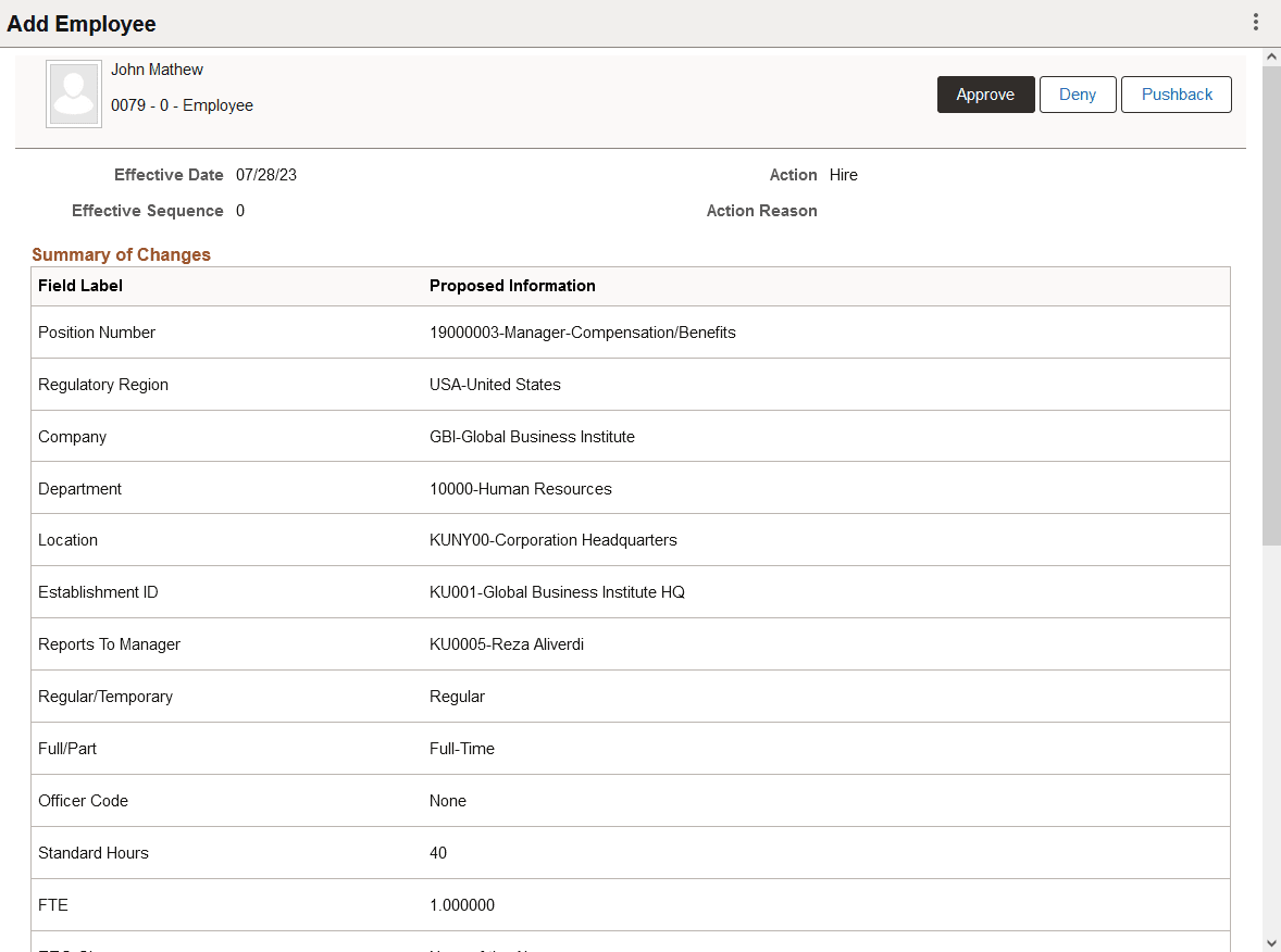

This example illustrates the fields and controls on the Pending Approvals - Add <Organizational Relationship> page (1 of 2).
Pending Approvals - Add <Organizational Relationship> Page (1 of 2)

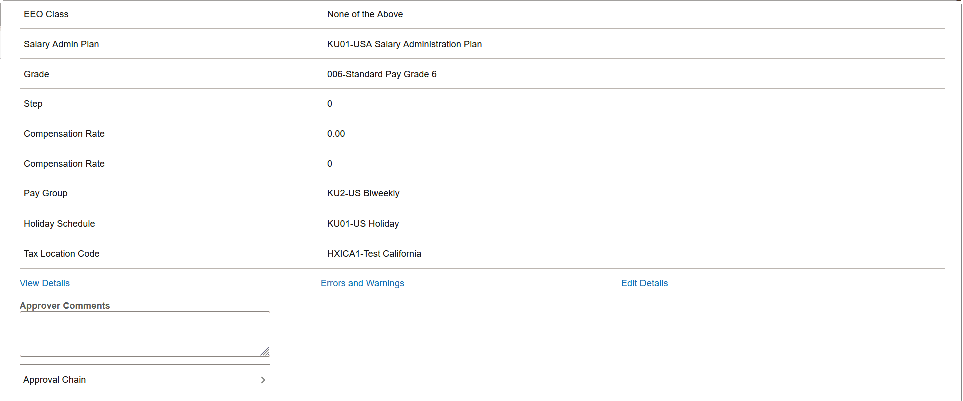

Pending Approvals - Add <Organizational Relationship> Page (2 of 2)
Approval Options
The approval options on this page are common to all fluid approval transactions, as described in the documentation for the Application Fundamentals: Pending Approvals - <Transaction Details> Page.
Field or Control Description
Approve , Deny, and Pushback buttons
Use these buttons to take action on the requested approval.
Summary of Changes
Use this section to view summary information identifying the fields that were updated in the transaction that you are being asked to approve. The section will show proposed values requested for the person’s job record.
Additional Details
View Details
Click this link to open a new browser window tab to access the Job Data Page where the person added the instance. You can review details about the person’s job row instance from this page.
Note: The approver must have access to the Job Data page to review this information.
Errors and Warnings link
Click this link to access the View Exception(s) Page to review warnings and errors for this request.
Edit Details link
Select this link to access the fluid Job Data Page, where you can make updates to the job record, if needed, prior to approving.
Note: You need access to all the steps in the activity guide process to ensure all necessary edits and errors are corrected. After you submit the changes, you will be returned to the approval pages where you will see your changes. You will need to approve the request for these changes to take place.
Approver Comments
Approver Comments
Enter any comments related to the approval action you take.
Approval Chain
Click this item to open the Approval Chain page, where you can review information about all approvers for the transaction.
