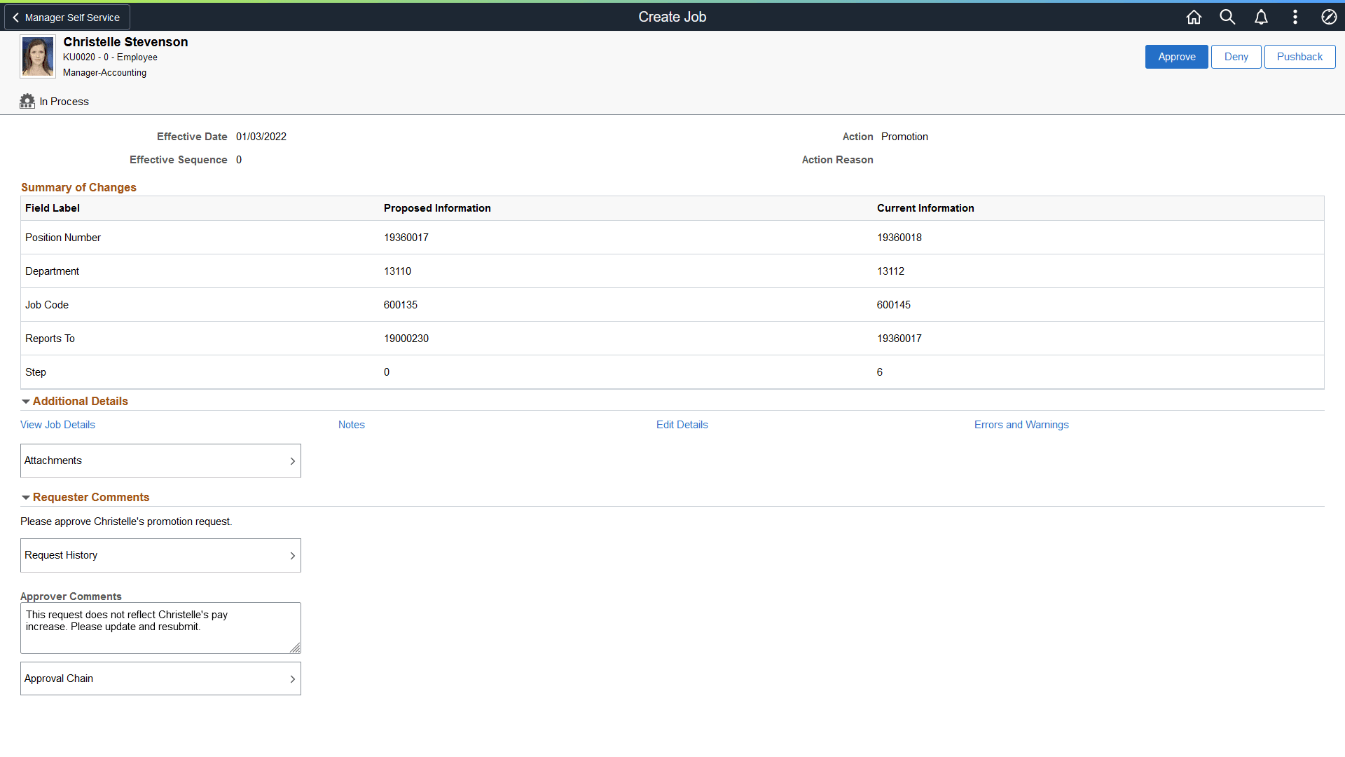

This example illustrates the fields and controls on the Pending Approvals - Create Job page.
Pending Approvals - Create Job Page

Summary of Changes
This section is available when field changes have been made to the person’s job record or configured to display through the Transaction Summary pages (see Application Fundamentals: Configuring Transaction Summary).
Use this section to view summary information identifying the fields that were updated in the transaction that you are being asked to approve. The section will show proposed changes requested for the person’s job record next to the person’s current values.
Additional Details
Field or Control Description
View Job Details link
Click this link to open a new browser window tab to access the Job Details Page, where you can review details about the person’s job rows from one page.
Note: The approver must have access to the Job Details page to review this information.
Notes link
Click this link to open a new browser window tab and access the Job Data Notepad page where you can view or update notes for this job transaction.
Edit Details link
This link is available for the final approver in the approval chain when given the HR Admin Correction Apvr Fluid or HR Admin Approver Fluid role. It is also recommended that you assign this user the Job Data AG Administrator role.
Click this link to access the fluid Manage Data component in fluid (see (Fluid) Updating Job Data), where you can make updates to the job record, if needed. Note that you will have access to all the steps in the Job Data activity guide process to ensure all necessary edits and errors are corrected. You will be returned to the approval pages where you will see your changes. You will need to approve the request for these changes to take place.
This video provides an overview of edit capabilities:
Video: Image Highlights, PeopleSoft HCM Update Image 48: Fluid Person Data Edit Capabilities for Approver
Errors and Warnings link
Click this link to access the View Exception(s) Page to review CI exceptions.
When CI exceptions exist, you will be directed to the Job Data pages to review the information.
When there are no exceptions, the page will produce a message notifying you that no exceptions exist.
Click this item to open the Attachments Page where you can review the attachments associated with this job transaction.
Many of the pages that link from this page use the Employee Header Configuration feature. For more information on defining header fields and layout, see Application Fundamentals: (Fluid) Managing Employee Headers.
Requester Comments
The section will display the latest comment associated with this request, if any, under the Comments subheading. Previous comments can be viewed by selecting the Request History item.
Request History
Select this option to access the Request History Page and view all the comments pertaining to this transaction request. Multiple comments may happen when the approver has pushed back a request and it has been resubmitted.
Approver Comments
Enter any comments related to the approval action you take.
Approval Chain
Click this item to open the Approval Chain page, where you can review information about all approvers for the transaction.
This video provides an overview of tracking comments:
Video: Image Highlights, PeopleSoft HCM Update Image 42: Track Requestor Comments with Job Data Modernization

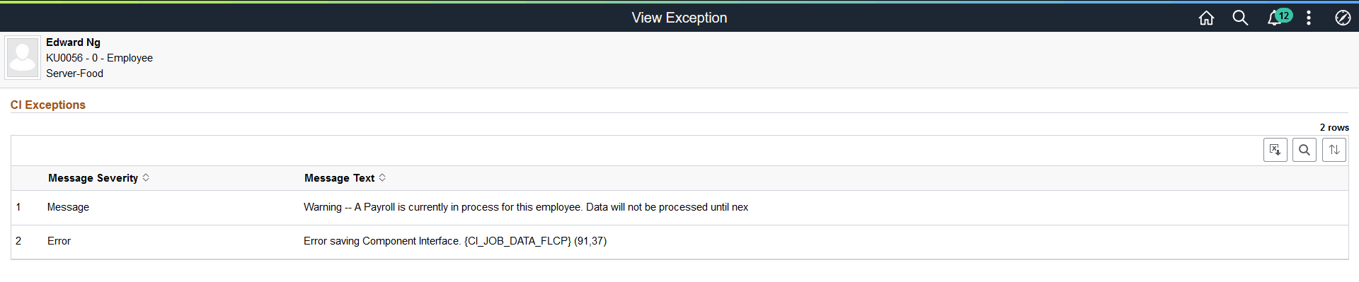

Use the View Exception page (HR_JOB_CIEXCEPT_FL) to view component interface errors or warnings for this job data request.
Navigation:
Click the Errors and Warnings link on the Pending Approvals page.
This example illustrates the View Exception page.
View Exception page
