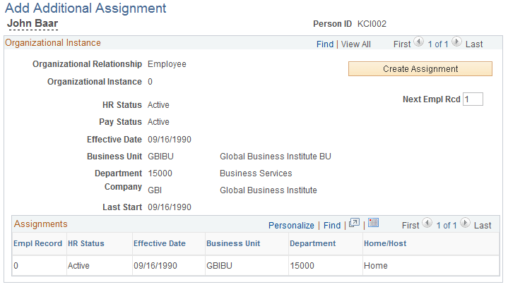

Add Additional Assignment Page
Use the Add Additional Assignment page (PER_ORG_INST_ASGN) to enter additional worker assignments and access the Concurrent Job Data component to create new assignments.
Navigation:
Workforce Administration, and then Job Information, and then Add Additional Assignment, and then Add Additional Assignment
This example illustrates the fields and controls on the Add Additional Assignment page. You can find definitions for the fields and controls later on this page.
Field or Control Description
Create Assignment
Click to access the Job Data record to enter specific information about the new assignment.
Org Relation (organizational relationship)
Displays the person's organizational relationship.
Organizational Instance
Displays the instance number for this relationship.
Next Empl Rcd (next employee record)
Enter the employment record number for the next assignment. This number should be unique from all other employment record numbers currently held by this person.
Assignments
Lists the assignments under this organizational instance by employment record number.
