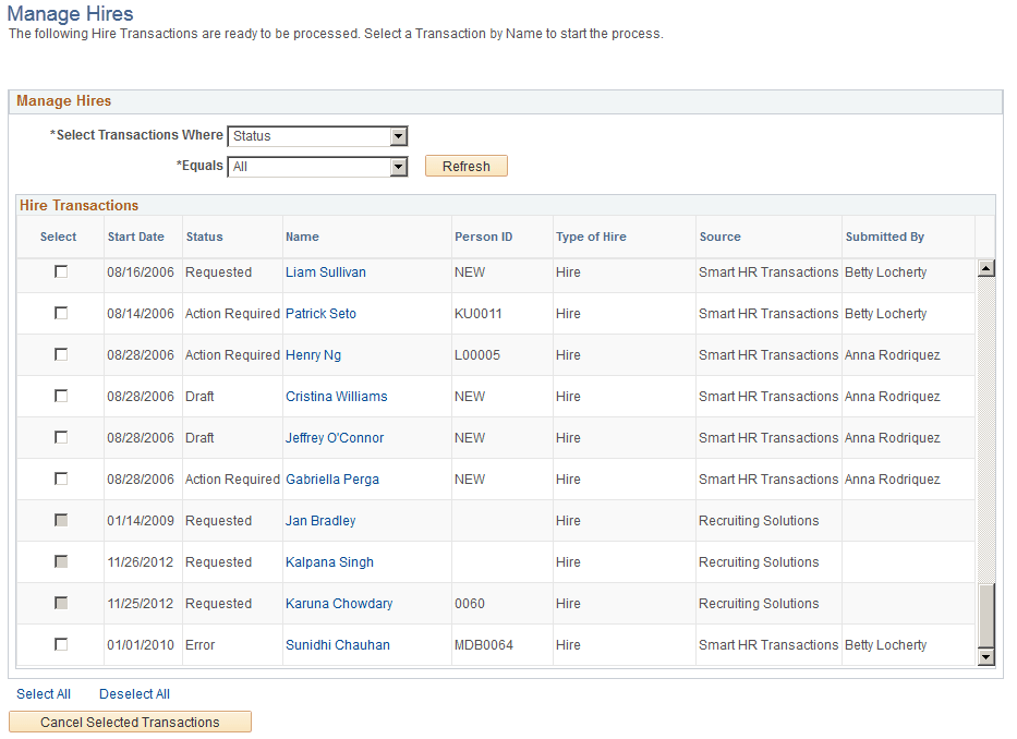

Manage Hires Page
Use the Manage Hires page (HR_MANAGE_HIRES ) to manage hires.
Displays a list of people who are ready to be hired. The list includes applicants who have been readied for hire in PeopleSoft Recruiting Solutions. The list also includes persons who have gone through the Smart HR transaction process.
Navigation:
Workforce Administration, and then Personal Information, and then Manage Hires, and then Manage Hires
This example illustrates the fields and controls on the Manage Hires page. You can find definitions for the fields and controls later on this page.
Manage Hires page
The HR administrator uses the Manage Hires page to view hires that may be in draft status that the end user started, to view hires that require HR review prior to committing to the database, or to review hires that encountered errors upon saving and require an HR administrator's review to complete the hire process.
When the template administrator sets up the templates, he or she can select or deselect the Automatic Database Update check box. If selected, the end user is able to save the hire to the database or save the hire in draft status. If deselected, then the end user only has the option to save the hire as a draft or to submit the hire to HR. In these instances, the HR administrator uses the Manage Hires page to view people and continue with the hire process.
Field or Control Description
Select Transactions Where
Select the value that represents how you want the search to produce results.
Valid values are:
  • Source, Status, and Type of Hire – When selecting any of these option, the system displays the Equals field.
  • Start Date – When selecting this option, the system displays the From and To date fields.
Equals
Select a value that will assist viewing and managing hires.
This field is visible if the when you select Source, Status, or Type of Hire in the Select Transaction Where field.
This list indicates the Equals values that are available based on the following Select Transaction Where field option you selected:
  • Source – Values in this field are Recruiting Solutions and Smart HR Transactions.
  • Status – Values in this field are Action Required, All, Draft, Error, and Requested.
  • Type of Hire – Values in this field are Add Concurrent Job, Add Contingent Worker, Hire, Rehire, and Transfer.
From: andTo:
These fields are visible when you select Start Date in the Select Transaction Where field.
Enter a date range for hire requests submitted within a specified time period.
Refresh
Click to update the list of applicants or hires in the Hire Transactions region when you change the value of the Select Transaction Where field and/or the Equals field.
Select
Use this check box to select transactions that you want to cancel. The check box is active only for rows where the Source is Template (template-based hire).
You cannot use this page to cancel transactions where the source is Recruiting (recruiting solutions); instead, you must cancel the transaction using the Withdraw from Hire action on the Job Opening page in PeopleSoft Recruiting Solutions.
Status
Status values include Action Required, Draft, Error, Requested, and All.
The initial status for job applicants who were processed through PeopleSoft Recruiting Solutions is Requested. If the hiring request is cancelled from the Recruiting Solutions application when the hiring process is partially complete (you have created a personal data record, but not a job record), then the status changes to Action Required, indicating that an HR administrator needs to reverse the incomplete hiring process.
Name
Click a person's name to access the person's data in the Manage Hires Detail page, where you can review job details and initiate the hiring process.
Person ID
This field is blank when you have not yet begun the hire process for a person. Otherwise, it displays the person ID that was assigned when you created a personal data record for the person.
Source
View hire requests submitted by Recruiting Solutions (Recruiting) or by the Smart HR Templates (Smart HR Transactions) process.
Select and Cancel Selected Transactions
Select the check box for a person and click the Cancel Selected Transactions button to cancel the hire request.
You cannot select transactions where the source is Recruiting (recruiting solutions).
Although you cannot cancel recruiting transactions from this page, recruiting users can withdraw a hire request. If the transaction request is Requested at the time the withdraw hire message is received, the system cancels the transaction and the transaction no longer appears on this page.

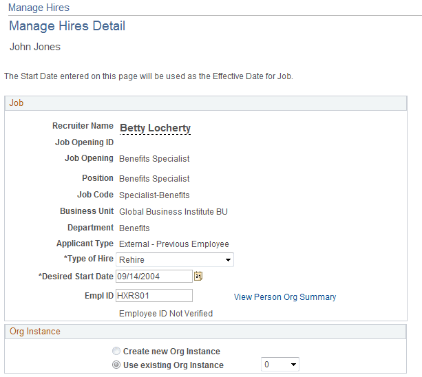

Manage Hires Detail Page
Use the Manage Hires Detail page (HR_MNGHIRE_DET) to review hire details and initiate or complete the hiring process.
Navigation:
Click the name link for a person.
This example illustrates the fields and controls on the Manage Hires Detail page (1 of 2). You can find definitions for the fields and controls later on this page.
This example illustrates the fields and controls on the Manage Hires Detail page (2 of 2). You can find definitions for the fields and controls later on this page.
Job
The Job group box displays information about the job for which the person is to be hired.
Type of Hire
Select Hire or Add Contingent Worker. The default value comes from the recruiting application.
Desired Start Date
Displays a default start date that comes from the recruiting application. You can override this value.
This date becomes the default effective date of the job record that you create when you hire this applicant.
Empl ID (employee ID)
If you have initiated the hire process and saved a personal data record for the person, the person's employee ID is displayed, but is not editable.
If the field is blank, then the system generates a unique employee ID when you save the person's personal data record.
If an editable value appears, the system uses this value as the employee ID when you create the person's personal data record. If the employee ID already exists, a warning appears when you click the Add Person button to begin the hire process.
PeopleSoft Recruiting Solutions provides a default employee ID if the applicant was associated with an existing employee ID (for example, the person is an internal transfer or a rehire). A text message on the page indicates whether the value provided by the recruiting application has been verified.
View Person Org Summary
If an employee ID exists, click this link to open the Person Organizational Summary page for the person in a new window.
