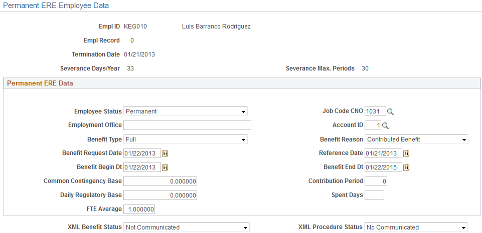

Permanent ERE Employee Data Page
Use the Permanent ERE Employee Data page (ERE_PERM_EE_X_ESP) to enter additional details for employees affected by permanent ERE.
Navigation:
Click the Details icon for an employee on the Permanent ERE page.
This example illustrates the fields and controls on the Permanent ERE Employee Data page. You can find definitions for the fields and controls later on this page.
Field or Control Description
Employee Status
Select the employment status for the employee.
Job Code CNO
Enter the official occupation code for the employee.
Employment Office
Enter the unemployment office that manages the subsidy for the employee.
Account ID
Enter the employee’s bank account ID.
Benefit Type
Select whether the employee has Full or Partial benefits.
Benefit Reason
Select whether the reason for the benefit. Values are Contributed Benefit and Replenish Benefit Entitlement.
Benefit Request Date
Enter the date on which the benefit is requested.
Reference Date
Enter the date that the system uses to calculate the maximum and minimum ceilings for the contributive unemployment benefit.
Benefit Begin Dt and Benefit End Dt
Enter a date range for the benefit.
Common Contingency Base
Displays the sum of common contingencies bases for the last 180 contribution days.
For customers who have PeopleSoft Global Payroll installed, the system calculates and populates the value for this field when you run the Process ERE Data (ERE_UDTA_ESP) process.
Contribution Period
Displays the contribution days used to calculate the daily regulatory base.
Daily Regulatory Base
Displays the Daily Regulatory Base that is derived from the Professional Contingencies bases (without overtime) for the last 180 contribution days.
Spent Days
Enter the number of unemployment days that the employee has used as part of a prior ERE event.
The Process ERE Data (ERE_UDTA_ESP) process updates the Decimal 4 field on the Absence Event Input Detail page to account for these days during the payroll process.
FTE Average
Displays the average FTE for the last 180 days. System calculates the value automatically when running the Process ERE data (ERE_UDTA_ESP) process. However, you can also manually update it.
XML Benefit Status
Displays the status of employee’s Benefits registration.
  • Not Communicated
  • XML Generated
  • XML Sent/Confirmated
XML Procedure Status
Select the status of the employee’s ERE report in XML. The values are:
The values are:
  • No Communicated
  • XML Generated

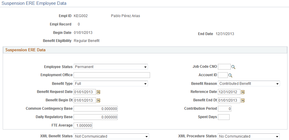

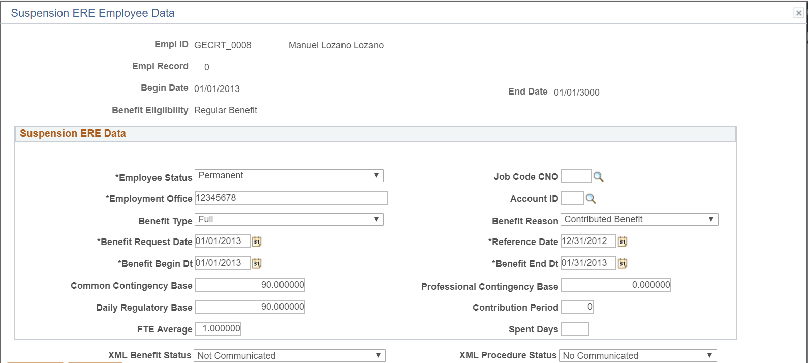

Suspension ERE Employee Data Page
Use the Suspension ERE Employee Data page (ERE_SUSP_EE_X_ESP) to enter additional details for employees affected by suspension ERE.
Navigation:
Click the Details icon for an employee on the Suspension ERE page.
This example illustrates the fields and controls on the Suspension ERE Employee Data page. You can find definitions for the fields and controls later on this page.
The fields on this page are identical to those on the Permanent ERE Employee Data page.

This example illustrates the fields and controls on the Work Reduction Employee Data page. You can find definitions for the fields and controls later on this page.
Schedule Distribution
Click the link to open the Schedule Reductn Distribution page wherein you enter reduction periods and work schedules for each employee.
Employee Status
Job Code CNO
Employment Office
Account ID
Sched Reduction Reason
Select the reason for the schedule reduction.
Work Reduction Pct
Displays the work schedule reduction percentage during the temporary ERE.
Benefit Type
Benefit Reason
Reference Date
Contribution Period
Displays the number of contribution days used to calculate the daily regulatory base.
Professional Contingency Base
Displays the Daily Regulatory Base that is derived from the Professional Contingencies bases (without overtime) for the last 180 contributing days.
Spent Days
FTE Average
XML Benefit Status
  • Not Communicated
  • XML Generated
Select the status of the employee’s XML ERE report. The values are:
The values are:
  • No Communicated
  • XML Generated
