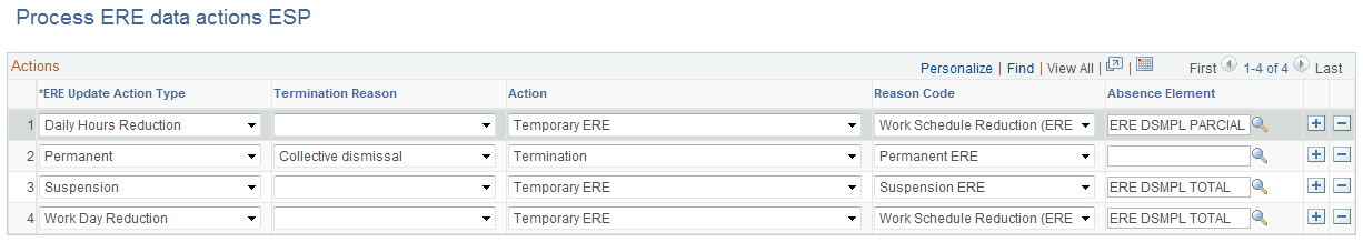

Process ERE data actions ESP Page
Use the Process ERE data actions ESP page (ERE_UDTA_ACTN_ESP) to define ERE data actions.
Navigation:
Set Up HCM, and then Install, and then Country Specific, and then Process ERE data actions ESP
This example illustrates the fields and controls on the Process ERE data actions ESP page. You can find definitions for the fields and controls later on this page.
Use this page to determine how the system updates job and payroll data for employees for each of the different types of ERE actions.
Field or Control Description
ERE Update Action Type
Select the ERE update action type you are defining. Valid values are: Daily Hours Reduction, Permanent, Suspension, and Work Day Reduction.
Termination Reason
Select the termination reason that the system uses when updating the Manage Terminations ESP page when you run the Process ERE Data (ERE_UDTA_ESP) process. Typically you select a value in this field only for the Permanent ERE update action type.
Action
Select the action that the system uses when updating the Work Location page of the Job Data component when you run the Process ERE Data (ERE_UDTA_ESP) process.
Reason Code
Select the reason that the system uses when updating the Work Location page when you run the Process ERE Data (ERE_UDTA_ESP) process.
Absence Element
Enter the absence take element that the system uses to update the Absence Event Entry page when you run the Process ERE Data (ERE_UDTA_ESP) process.
Oracle delivers the following ERE absence takes:
  • ERE DSMPL PARCIAL: This should be mapped to the daily hours reduction ERE action type.
  • ERE DSMPL TOTAL: This should be mapped to the suspension and work day reduction ERE action types.
