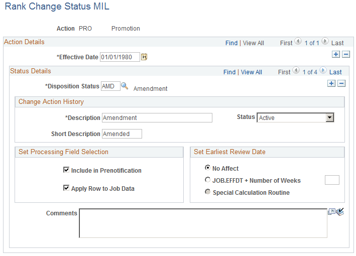

Rank Change Status MIL Page
Use the Rank Change Status MIL page (MIL_RANK_CHNG_STAT) to specify the allowable Action table values for change rank processing.
Only those action and disposition status combinations defined here are available for military rank change templates and requests.
Navigation:
Set Up HCM, and then Product Related, and then Workforce Administration, and then Workforce Data MIL, and then Military Rank Change Status, and then Rank Change Status MIL
This example illustrates the fields and controls on the Rank Change Status MIL page. You can find definitions for the fields and controls later on this page.
Field or Control Description
Action
Select a value from the Action table that can be used for military rank change requests.
Disposition Status
Enter the disposition statuses eligible for this action type. Only those action and rank change disposition status combinations defined here are available for selection in the Action and Disposition Status fields on the Template Change Control page for military rank change templates or Military Rank Change page to record a service member's rank change request.
Valid values are AMD (Amendment), CNA (Cancel by Administrator), CNC (Cancel by Command), and NEW (new).
Change Action History
Identify the rank change status descriptions that the system will display to a user during the Rank Change process. You can also activate or inactivate a specific disposition status for the action.
Set Processing Field Selection
Use this section when configuring prenotification and the push of rank change requests to Job Data for an action and disposition status combination.
Include In Prenotification
Select this check box to generate a prenotification for stakeholders when a person has this action and disposition status combination. If this check box is not selected, prenotification will not be generated for stakeholders.
Note: Prenotification must be enabled on the Military Processing Definition page in order for prenotification to occur.
Apply Row to Job Data
Select this check box to have the system push the rank change request to Job Data. If this check box is not selected, the system will not apply the rank change to Job Data. For example, a cancellation of a rank change request would not need to be recorded in Job Data, and therefore would have this check box deselected.
Set Earliest Review Date
Use this section to determine how the system should calculate the Early Promotion Date field value on the Job Data - Employment Information page use after the rank change row has been inserted into Job Data.
No Affect
Select this if there is no impact to the earliest review date when the Job Data row is inserted. This is the default value selection.
JOB.EFFDT + Number of Weeks (job effective date plus number of weeks)
Select this option to calculate a review date using the effective-date of the rank change row in Job Data plus the number of weeks specified here. If this option is selected, you must also enter the number of weeks (up to a 3-digit number) in the edit box after this field. The system uses this date to populate the Early Promotion Date on the Job Data - Employment Information page. In the case of a demotion or reversal, you may need to enter a negative number.
Note: To use this option, you must enter an Application Date value on the Military Rank Change page.
Special Calculation Routine
Select this option if your organization has created their own customized calculations. The PeopleSoft application does not deliver calculations for this field.

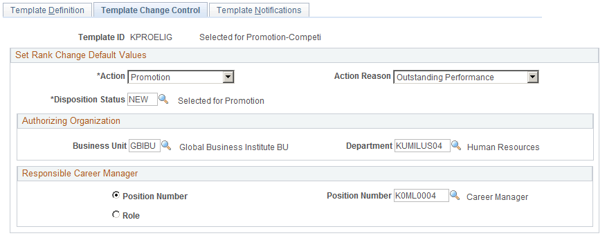

Military Rank Change Template - Template Change Control Page
Use the Military Rank Change Template - Template Change Control page (MIL_TMPL_CHNG_CNTL) to enter military rank change control criteria.
This page enables you to define default specific personnel action and reason values as well as the rank change status values (New, Amendment, Cancel by Command, Cancel by Admin) to be associated with the template. Enter default values for the authorizing organization's business unit and department as well as the position or user role that should be used when determining the responsible career manager. The system will use these values to populate the Military Rank Change page fields in the Military Rank Change component.
Navigation:
Set Up HCM, and then Product Related, and then Workforce Administration, and then Workforce Data MIL, and then Military Rank Change Template, and then Template Change Control
This example illustrates the fields and controls on the Military Rank Change Template - Template Change Control page. You can find definitions for the fields and controls later on this page.
Use this page to define default values the system will use to populate fields in the Military Rank Change component when creating a rank change request. The only required fields for defaulting are Action, Disposition Status, and the Responsible Career Manager selection.
Action
Select a default action value. Valid actions for rank changes are defined on the Rank Change Status MIL page.
Reason
Select a default reason that will be associated with the action, if applicable. Valid reasons for actions are defined in the Action Reasons table.
Disposition Status
Select the disposition status that will be provided by default when using this template. Valid values are defined on the Rank Change Status MIL page for an action.
Business Unit andDepartment
Enter the authorizing organization's business unit and department for this template.
Use this selection to specify how the default career manager is derived. The system uses this information for notification purposes.
Position Number andPosition Number
Select this option if the career manager is decided by position. When you select this option, the Position Number field becomes available and you can enter the position number associated with the career manager for defaulting purposes or leave it blank.
Role andRole Name
Select this option if the career manager is decided by a role. When you select this option, the Role Name field becomes available and you can enter the name of the role associated with the career manager user ID for defaulting purposes or leave it blank.

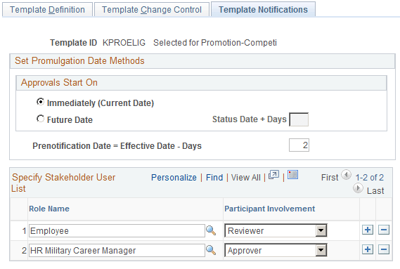

Military Rank Change Template - Notifications Page
Use the Template Notifications page (MIL_TMPL_NOTIFY) to specify the stakeholder notification details such as default roles that should be associated with a template and indicate when to start the approval and notification process.
Navigation:
Set Up HCM, and then Product Related, and then Workforce Administration, and then Workforce Data MIL, and then Military Rank Change Template, and then Template Notifications
This example illustrates the fields and controls on the Military Rank Change Template - Template Notifications page. You can find definitions for the fields and controls later on this page.
Use this page of the template to configure for an immediate start of the approval process (when the rank change request is saved) or configure the approval process to start on a future date, to be calculated by the system. This page also enables the user to associate a prenotification date, which is essentially a final notification to stakeholder that the rank change is being applied to Job Data.
Immediately (Current Date)
Select this method to have the system populate the Start Approvals On field in the Military Rank Change component with the system date. This will start the approval process upon saving the request in the Military Rank Change component.
Future Date and Status Date + Days
Select this method to have the system populate the Start Approvals On field in the Military Rank Change component with a future date based on the Status Date field value in the Military Rank Change component.
When you select this option, the Status Date + Days field becomes available. Enter the number of days (up to two digits) the system should wait before sending out the approval notices.
For example, you create a template indicating that approvals should be sent out on a future date. You enter 14 in the Status Date + Days field. Later, the HR manager enters a request for an employee rank using this template with a Status Date value of September 1. The system automatically populates the Start Approvals On field with the date of September 15 on the Stakeholder page of the Military Rank Change component, 14 days after the status date of this request. The HR manager can accept this default value or override this value with another date.
Prenotification Date = Effective Date - Days
Enter the number of days prior to the rank change being applied to the person's Job Data record that the stakeholders should be notified of the change being made in the system. The system calculates the prenotification date using the Application Date value on the Military Rank Change page in the Military Rank Change component minus the number of days entered in this field. The system then enters this date in the Prenotification Date field on the Stakeholder page of the Military Rank Change component. The HR manager can accept this default value or override this value with another date when creating the rank change request.
Note: Prenotification must be enabled on the Military Processing Definition page in order for prenotification to be performed.
Role Name
Identify the roles, or stakeholders, that should be notified in the rank change notification process.
Participant Involvement
Identify the level of involvement of the stakeholder. Values are Approver or Reviewer.
Oracle PeopleSoft delivers Notification Composer Framework to manage the setup and administration of all notifications in one central location.
Once you have adopted the Notification Composer feature, you must use it to create new notifications and manage your existing notifications.
Notifications delivered with HCM Image 47 or later must use Notification Composer.
For more information about Notification Composer Framework, see Enterprise Components: Understanding Notification Composer.
