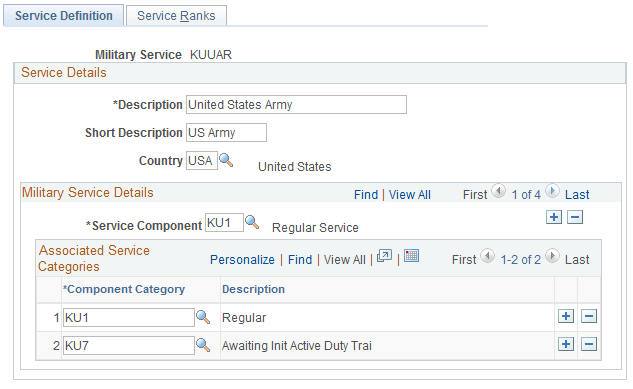

Military Service - Service Definition Page
Use the Service Definition page (MIL_SERVICE_DEFN) to define military service details by associating service components and categories to a military service and country.

This example illustrates the fields and controls on the Service Definition page. You can find definitions for the fields and controls later on this page.
Field or Control Description
Country
Enter the country to which this military service applies.
Service Component
Select one or multiple service components related to this military service. When a user associates a military service with a position or military service member, only those service components associated with that military service are available to the user.
Component Category
Associate service categories to service components. When a user associates a service component with a military service member, only those component categories associated with that service component are available to the user.

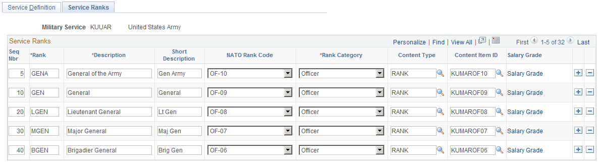

Military Service - Service Ranks Page
Use the Service Ranks page (MIL_SERVICE_RANKS) to define service ranks that you will later associate with military service members. Identify the hierarchy and structure of the ranks within a specified military service.

This example illustrates the fields and controls on the Service Ranks page. You can find definitions for the fields and controls later on this page.
Service Ranks page
Seq Nbr (sequence number)
Specify the overall rank sort order to specify the military's hierarchical structure. This field enables users to sort rank codes where these service ranks have the same NATO ranks, such as the OF-1 (1st and 2nd Lieutenant ranks). This field also enables you to specify individual rank order sequences for military services that are not part of the NATO structure and hierarchy.
Rank
Define rank code designations specific to this military service.
NATO Rank Code
Select the NATO code associated with this rank, if available. Valid values are provided using translate values. This field is optional since it does not apply to all militaries, such as the US Warrant Officer rank categories.
The system displays a warning message upon saving if the NATO rank code is blank and the Military Rank Category is Officer or Other Ranks.
Rank Category
Categorizing ranks based on NATO's definitions. Valid values are Officer, Other Ranks, and Warrant Officer.
Content Type
Enter the content type that defines the rank (for example, rank, competency, degree). The PeopleSoft system delivers the content type RANK to record ranks.
When a military service member's rank is updated in Job Data, the system will update that person's profile, if an organization has set up the Event Manager accordingly.
See PeopleSoft Human Resources Manage Profiles: Understanding the Content Catalog.
Content Item ID
Select a content item that further defines the RANK content type. The system uses this information to manage a person's job profile.
See .PeopleSoft Human Resources Manage Profiles: Understanding the Content Catalog
Salary Grade
Click to access the Salary Grades - Military Ranks page and define which salary plans and grades fit the pay attributes of this respective rank code.
