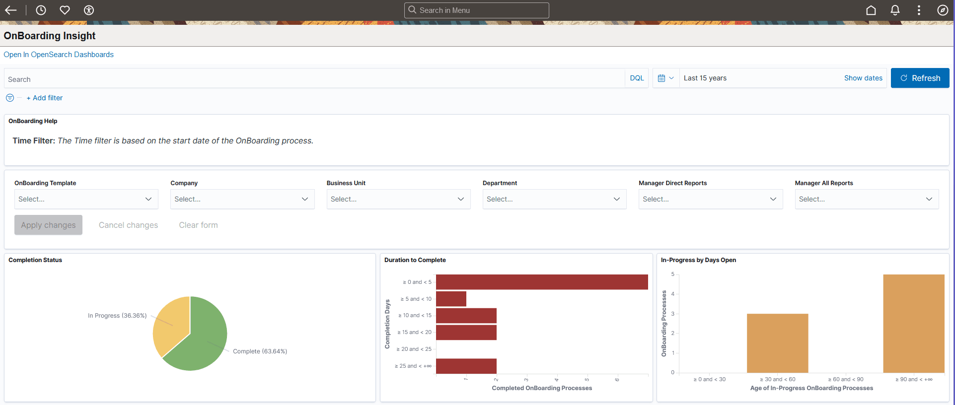

OnBoarding Insight Dashboard (for Administrators)
Administrators use the OnBoarding Insight dashboard to review and analyze OnBoarding data using visualizations.
Navigation:
Workforce Administrator home page, and then OnBoarding Insight tile
You must be assigned the OnBoarding Administrator role to view this dashboard.
This example illustrates the fields and controls on the OnBoarding Insight Dashboard (1 of 2).
OnBoarding Insight dashboard for administrators (1 of 2)
This example illustrates the fields and controls on the OnBoarding Insight Dashboard (2 of 2).
OnBoarding Insight dashboard for administrators (2 of 2)
WARNING:
PeopleSoft Insights dashboards may not render properly if you access them using unsupported platforms.
When you select filters or chart items, or modify the date range, PeopleSoft Insights dynamically updates all visualizations using the source from the index.

OnBoarding Insight Visualizations
The OnBoarding Insight dashboard provides you with the following collection of interactive visualizations to view and analyze OnBoarding data for your organization.
The data displayed is based on the security defined for the search index.
Important:
For optimal performance, only the first 500 rows of data are displayed on the Insights dashboard. Use filters to refine the set of data you wish to visualize using the dashboard.
Visualization Description
Completion Status pie chart
This panel displays what percentage of OnBoarding activity guide processes are in progress and what percentage are complete.
Duration to Complete horizontal bar chart
This visualization displays the calculated number of days individuals used to complete the OnBoarding activity guide process.
In-Progress by Days Open Vertical bar chart
This visualization displays the number of activity guide processes that have been in progress less than 30 days, between 31 to 60 days, those that have been in progress 61-90 days, and those that are over 90 days.

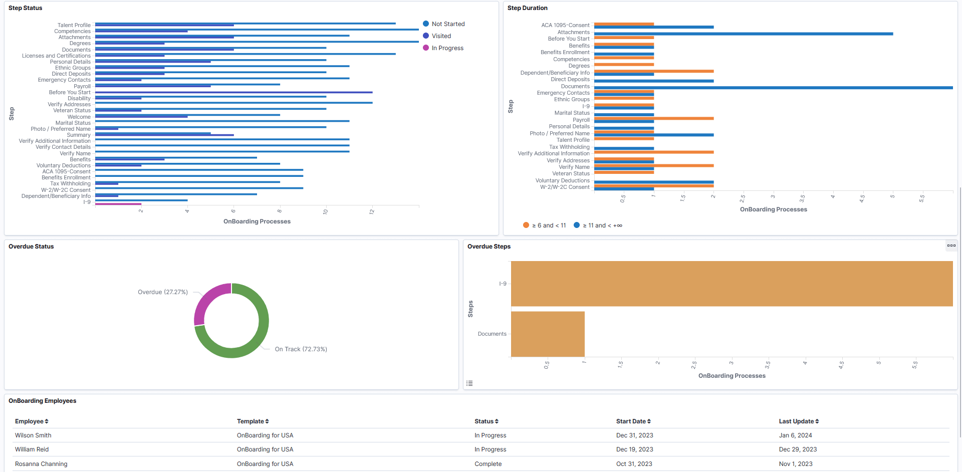

Step Status horizontal bar chart
This bar chart displays the steps within the OnBoarding activity guide and the number of OnBoarding processes by step status for each step. Step statuses are Not Started, In Progress, Visited, and Complete.
Step Duration horizontal bar chart
This visualization displays how long individuals completing activity guide processes have been on a step. These include less than 5 days, between 6 to 10 days, and those that have been on the step for 11 or more days.

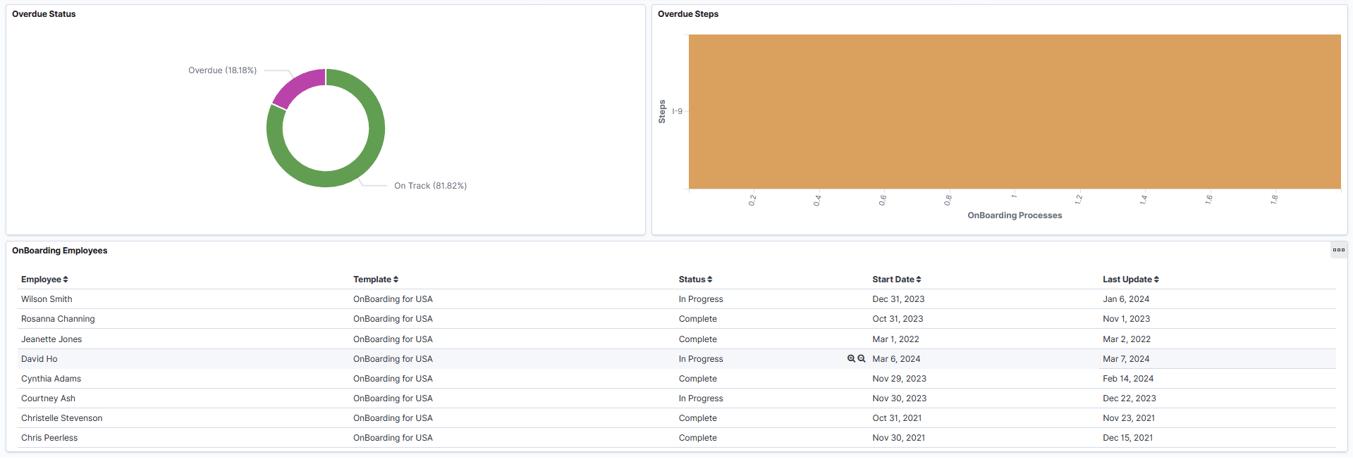

Overdue Status donut chart
This chart displays the percentage and count of activity guide processes that are on track (completed before the due date of a step) and those that are Overdue (contain one or more steps that are beyond the resolution date).
Overdue Steps horizontal bar chart
This visualization displays the steps and the number of in progress activity guide processes that were not completed by the minimum due date.
OnBoarding Employees (Details Grid)
This grid lists the employees, which are presented in visualizations, in a tabular format.

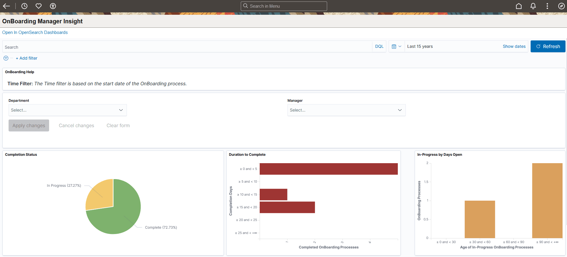

OnBoarding Manager Insight Dashboard (for Managers)
Managers use the OnBoarding Manager Insight dashboard to review and analyze visualizations of OnBoarding data for employees under your supervision.
Navigation:
Manager Self Service home page, and then OnBoarding Manager Insight tile
You must be assigned the OnBoarding Manager role to view this dashboard.
This example illustrates the fields and controls on the OnBoarding Manager Insight Dashboard (1 of 2).
OnBoarding Manager Insight dashboard for managers (1 of 2)
This example illustrates the fields and controls on the OnBoarding Manager Insight Dashboard (2 of 2).
OnBoarding Manager Insight dashboard for managers (2 of 2)

Filter By
For a list of filters available for the OnBoarding Manager Insights dashboard, see the Common Elements and Controls section in this documentation.
OnBoarding Manager Insight Visualizations
The OnBoarding Manager Insight Dashboard provides you with the following collection of visualizations to view and analyze OnBoarding data as a manager.
The data displayed is based on the security defined for the search index. For example, a manager will only have access to their direct and indirect reports.
Important:
This panel displays what percentage of OnBoarding activity guide processes for your employees are in progress and what percentage are complete.
This visualization displays the calculated number of days individuals under your supervision took to complete the OnBoarding activity guide process.
In-Progress by Days Open vertical bar chart
This visualization displays the number of activity guide processes under your supervision that have been in progress less than 30 days, between 31 to 60 days, those that have been in progress 61-90 days, and those that are over 90 days.
This chart displays the percentage and count of activity guide processes that are on track (completed before the due date of a step) and those that are Overdue (contain one or more steps that are beyond the resolution date) for your team members.
This visualization displays the steps and the number of in progress activity guide processes for your employees that were not completed by the minimum due date.
