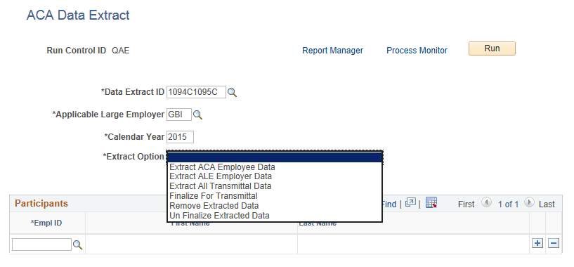

ACA Data Extract Page
Use the ACA Data Extract page (ACA_DTEX_RUNCTL) to extract, clean up, or finalize data needed for forms transmittal.
Navigation:
Benefits, and then ACA Annual Processing, and then Create ACA Form Data, and then ACA Data Extract
This example illustrates the fields and controls on the ACA Data Extract page.
Field or Control Description
Data Extract ID
Enter the Data Extract ID that defines data to be extracted.
Applicable Large Employer
Select the ALE Member for the data extract.
Calendar Year
Enter the tax filing year.
Extract Option
The options available are:
  • Extract ACA Employee Data – Extract data for selected employees only. Specify the employees in the Participant(s) grid below
  • Extract ALE Employer Data – Extract data for Form 1094-C only. This is used after running the Merge Process or after Employee Transmittal Data was modified manually. This process will sync up the counts.
  • Extract All Transmittal Data – Extract data for Forms 1094-C and 1095-C.
  • Finalize for Transmittal – Flag as Final the highest Sequence extracted data with Process Status of PeopleSoft Extracted, User Modified, or Merged with Data Load.
  • Remove Extracted Data – Select this option to delete all extracted data where Process Status is not Finalize for Transmittal or Transmittal Created.
  • Un Finalize Extracted Data – Reset the highest sequence extracted data with Process Status of Finalize to its previous status.
If an extract has already been run for an ALE/Calendar Year, the same extract ID should be used for that calendar year. Otherwise, an error message will be generated.

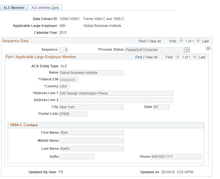

ACA Employer Transmittal Data Pages
Use the ACA Employer Transmittal Data page (ACA_ALE_XMIT_PART1 and ACA_ALE_XMIT_PART2) to view or modify the employer transmittal data after the data extraction process.
Navigation:
Benefits, and then ACA Annual Processing, and then Create ACA Form Data, and then ACA Employer Transmittal Data
This example illustrates the fields and controls on the ACA Employer Transmittal Data page - ALE Member tab.
Process Status
Defines the status of Data Extract, such as, PeopleSoft Extracted, User Modified, Merged with Data Load, VOID, Finalized for Transmittal, and Transmittal Created. You can add a ‘User Modified’ row to modify data before creating the 1094-C transmittal file.
Address is extracted based on the country format.

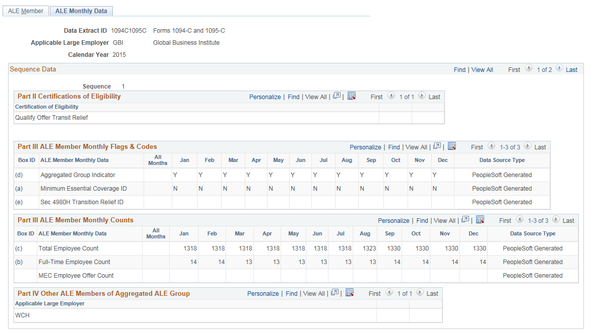

This example illustrates the fields and controls on the ACA Employer Transmittal Data page - ALE Monthly Data tab.

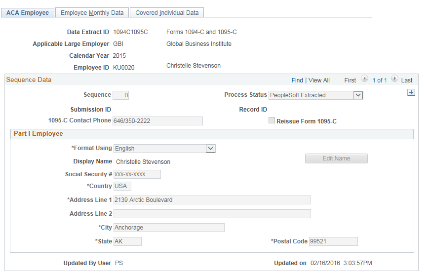

This example illustrates the fields and controls on the ACA Employee Transmittal Data page – ACA Employee tab.
ACA Employee Transmittal Data page - ACA Employee tab
Employee Address is extracted based on the address type table order (ADDR_TYPE_TBL component) that you have set up.
Reissue Form 1095-C
Between the time when Form 1095-Cs is furnished to employees but the Transmittal File has not been submitted to IRS, administrator can reissue Form 1095-C to their employees. Add a user modified row with the changes required and select the Reissue check box to indicate this data row is for issuing a reissue form. Once changes are verified, set the Process Status to Finalized for Transmittal and run the Create XML File (Reissue) process.

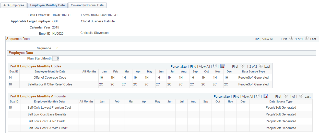

This example illustrates the fields and controls on the ACA Employee Transmittal Data – Employee Monthly Data tab.
ACA Employee Transmittal Data page - Employee Monthly Data tab
Plan Start Month
This is an optional field for 2015. The system defaults it to ‘00’.
Box ID 15: Employee Monthly Data
The data from the first row Self Only Lowest Premium Cost populates the corresponding box in the Form 1095-C. The Self Low Cost Base Benefits, Self Low Cost BA No Credit and Self Low Cost BA With Credit are three working rows used to calculate cost and credits.

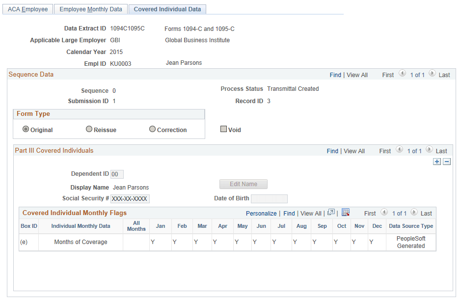

This example illustrates the fields and controls on the ACA Employee Transmittal Data page – Covered Individual Data tab.
ACA Employee Transmittal Data page - Covered Individual Data tab

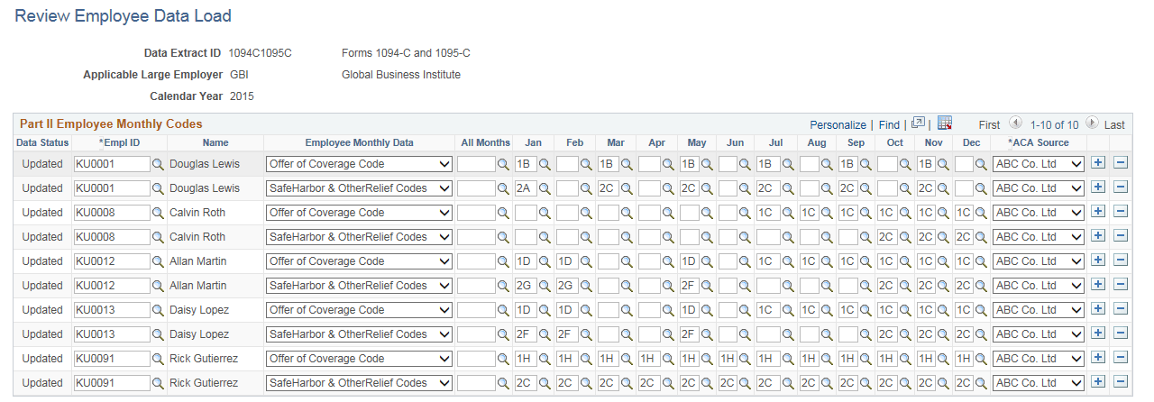

Review Employee Data Load Page
Use the Review Employee Data Load page (ACA_EMP_DATA_LOAD) to review/modify employee CI loaded monthly codes.
Navigation:
Benefits, and then ACA Annual Processing, and then Create ACA Form Data, and then Review Employee Data Load
This example illustrates the fields and controls on the Review Employee Data Load page.
Data Status
Display/modify the status of the data reviewed. The options available are Error, Initial Load, Merged, Updated, Void, and Warning.
ACA Source
Display/modify the source of data loaded using Excel-CI Load.

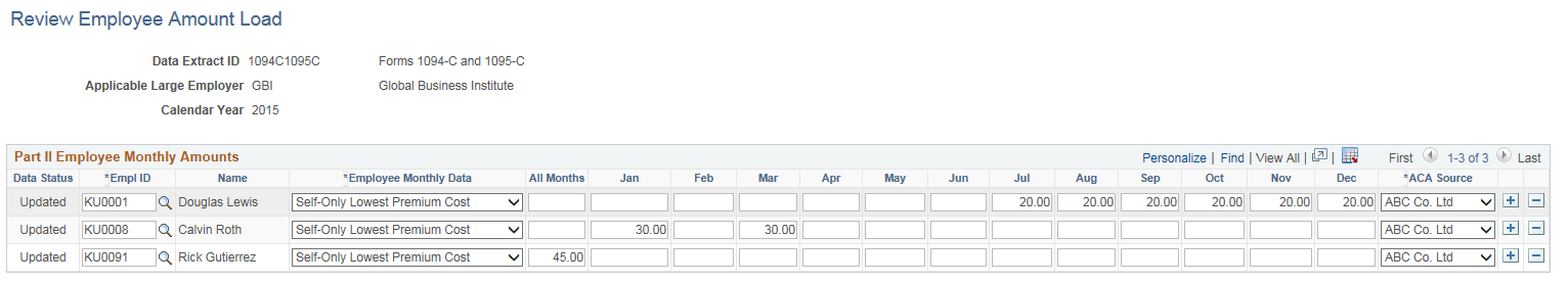

Review Employee Amount Load Page
Use the Review Employee Amount Load page (ACA_EMPMDATA_LOAD) to review/modify employee share of lowest cost monthly premium for self-only minimum value coverage.
Navigation:
Benefits, and then ACA Annual Processing, and then Create ACA Form Data, and then Review Employee Amount Load
This example illustrates the fields and controls on the Review Employee Amount Load page.

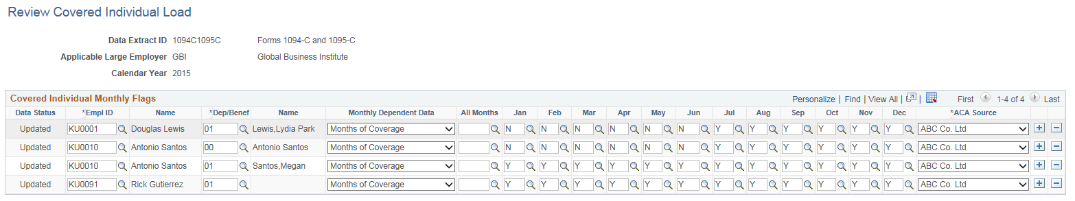

Review Covered Individual Load Page
Use the Review Covered Individual Load page (ACA_DEP_DATA_LOAD) to review/modify data for employee or covered dependent enrollment to employer-sponsored self-insured health coverage.
Navigation:
Benefits, and then ACA Annual Processing, and then Create ACA Form Data, and then Review Covered Individual Load
This example illustrates the fields and controls on the Review Covered Individual Load page.
