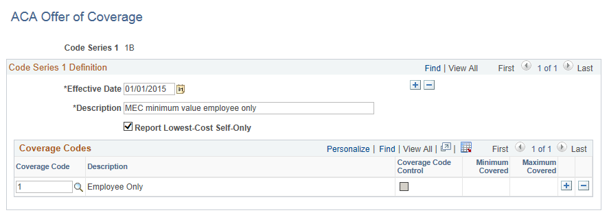

ACA Offer of Coverage Page
Use the ACA Offer of Coverage page (ACA_CODE_SERIES1) to define eligible coverage codes and whether to Report Lowest Cost Self-only per Code Series 1 as defined in the IRS Instructions for Forms 1094-C and 1095-C. You do not need to define these rules as this is delivered as system data. However, you can add other coverage codes as required.
Navigation:
Set Up HCM, and then Common Definitions, and then Affordable Care Act, and then ACA Offer of Coverage
This example illustrates the fields and controls on the ACA Offer of Coverage page.
Field or Control Description
Code Series 1
Employee Offer of Coverage Codes (Code Series 1) published in IRS Instructions for 1095-C. The valid codes are 1A – 1I for tax year 2015.
Report Lowest-Cost Self-Only
Select this check box to indicate that Employee Share of Lowest Cost Monthly Premium is reported for the Code Series 1. For example, if code 1B, 1C, 1D, or 1E is reported on line 14 of Form 1095-C, the lowest self-only cost will be reported on line 15 of Form 1095-C. For this reason, for codes 1B, 1C, 1D, and 1E, the checkbox is selected.
Coverage Code
List coverage codes that are associated with certain Code Series 1 (e.g. 1B, 1C, 1D, or 1E).

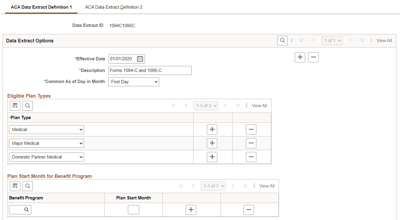

Data Extract ID
Assign a Data Extract ID for each set of data extract rules.
Data Extract ID 1094C1095C is system delivered for extracting employer and employee data for Forms 1094-C and 1095-C.
Data Extract Options
Common As of Day in Month
Select the common date to be used for effective date extract of all monthly data.
The options available are First Day, Specified Day, or Last Day.
Specified As of Day
This edit box appears only when you select Specified Day from the Common As of Day in Month drop-down menu.
Specify the day to use for each month.
Eligible Plan Types
Plan Type
Select the plan types that are eligible for this extract.
Plan Start Month for Benefit Program
Benefit Program
Select the benefit program that is eligible for this extract.
Plan Start Month
Enter the start month for the benefits plan.

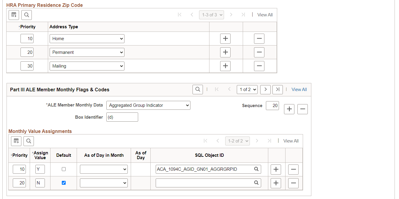

HRA Primary Residence Zip Code
Priority
Enter a number to define the priority of the address type to be used for the extract.
Address Type
Select the address type to be used for the extract. This includes values such as Home, Permanent, Mailing and Business.
Part III ALE Member Monthly Flags & Codes
ALE Member Monthly Data
Valid ALE Member Monthly Data options are:
  • Aggregated Group Indicator
  • Minimum Essential Coverage ID
  • Sec 4980H Transition Relief ID
Sequence
Specify the order of processing in the main extraction process.
Box Identifier
Enter the box number or letter used in Form 1094-C and Form 1095-C.

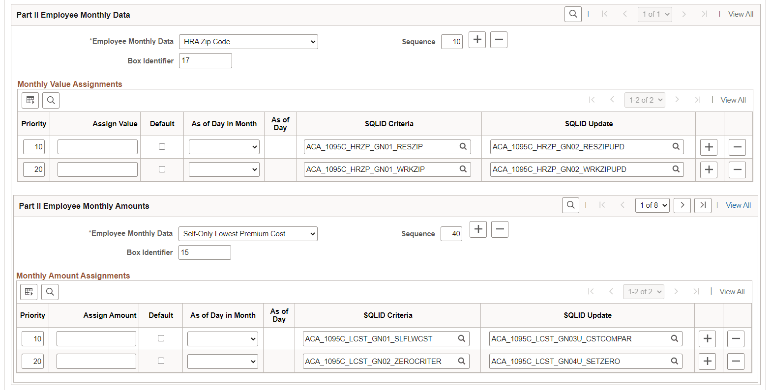

SQLID Object
Enter the SQL that defines the data subject to data extraction.

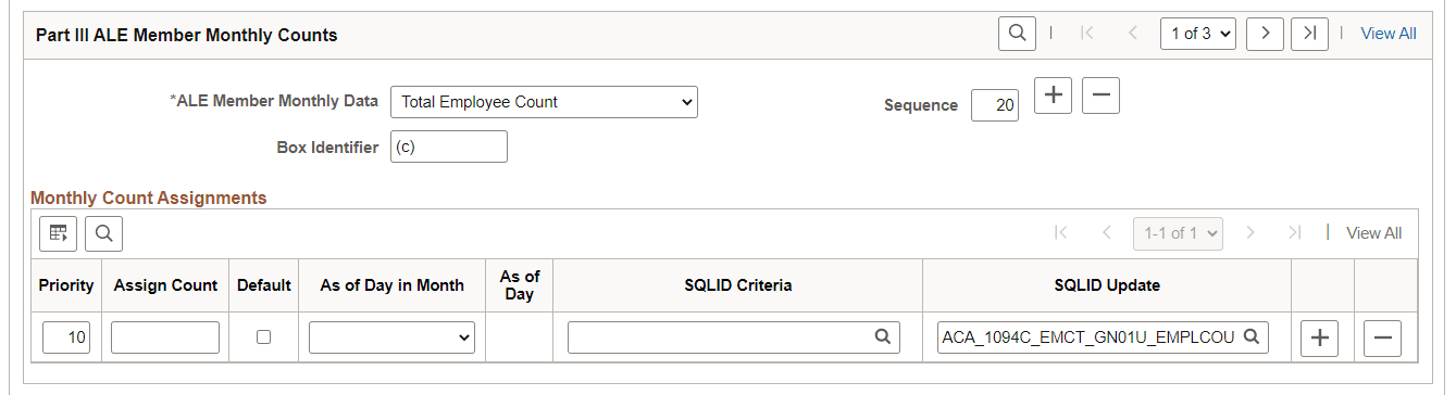

Part III ALE Member Monthly Counts
  • Full-Time Employee Count
  • MEC Employee Offer Count
  • Total Employee Count
Note: MEC Employee Offer Count is not reported on Form 1094-C but is needed in determining Column (a) Minimum Essential Coverage Offer Indicator (e.g. the employer offered MEC to at least 95% of full-time employees)
Monthly Count Assignments
Priority
Specify the order of processing within the monthly data type.
Assign Value
Enter the value, count, or amount according to the corresponding monthly data type.
Default
Select this check box to use the Assign Value as default.
As of Day in Month
If specified, this As of Day in Month overrides Common As of Day in Month for effective date extract of this monthly data value assignment.
The options available are First Day, Specified Day or Last Day.
As of Day
This edit box appears only when you select Specified Day from the As of Day in Month drop-down menu.
SQLID Criteria
SQLID Update
Enter the SQL that will provide update to monthly data extraction.
User defined SQL objects can be created in PeopleSoft Application Designer to provide SQLID Criteria and SQLID Update for data extraction and SQL name should start with ‘ACA’.

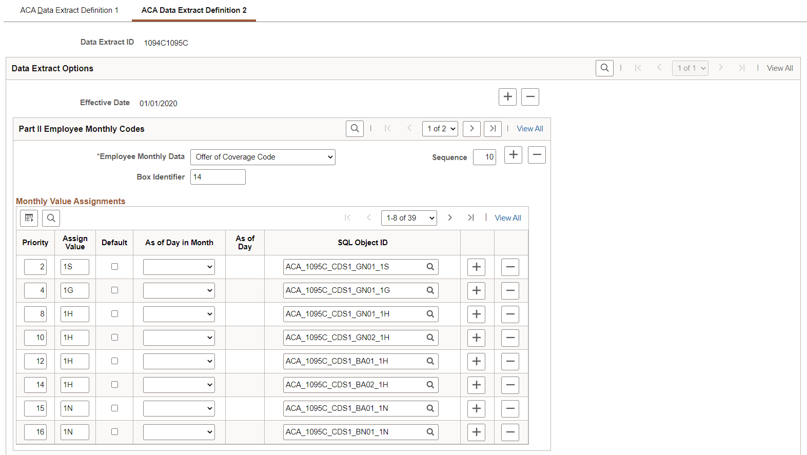

Part II Employee Monthly Codes
Employee Monthly Data
Monthly codes to report for the employee. Valid options are:
  • Offer of Coverage Code
  • Safe Harbor & Other Relief Codes
Part II Employee Monthly Amounts
Monthly amounts to report for the employee. Valid option is Self-Only Lowest Premium Cost.

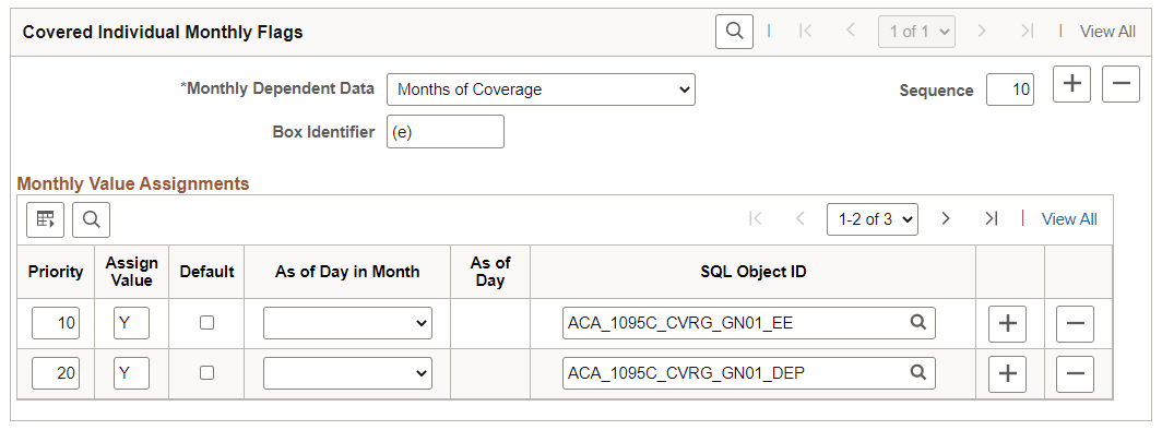

Covered Individual Monthly Flags
Monthly Dependent Data
Valid option is Months of Coverage.
