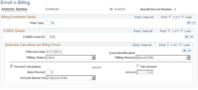

This example illustrates the fields and controls on the Enroll in Benefits Billing page. You can find definitions for the fields and controls later on this page.
Enroll in Billing page
Field or Control Description
ID
When you first enter the Enroll in Billing page, you are prompted for the ID of the employee whom you want to enroll or update.
You cannot create Benefits Billing enrollment records that cover all of an employee's multiple jobs at once.
Plan Type
You can enter multiple plan types, including:
  • Simultaneous active and COBRA billing enrollments.
  • Multiple COBRA billing enrollments.
COBRA Event ID
This value is automatically assigned by the COBRA batch process, but can also be entered. The value is 0 for non-COBRA billing.
Effective Date
You can have multiple effective-dated billing records for COBRA and non-COBRA events.
Event Identification
Indicates whether the record was created through Event Maintenance or Open Enrollment. This field is for records created through Benefits Administration processes only.
Billing Status
Controls billing calculations for each plan type. Values are:
Active: You are billing the employee for this plan type.
Hold Billing: Charges are not calculated for this plan type. If you change the status to Active after Hold Billing has been in effect, the system retroactively calculates charges the next time that you run the Benefits Billing calculation process. While Hold Billing is selected for a particular plan type, the system continues to bill for other plan types and continues to produce statements.
Inactive: You are no longer billing for this plan type.
Billing Reason
Identifies the source of the billing entry and the reason that the employee is being billed; for reference only. Values are:
Manual: Indicates that you are entering the billing enrollment record manually.
Arrears: Indicates that the participant cannot gross enough to cover deductions.
If the system has automatically enrolled the employee or dependent into Benefits Billing through Benefits Administration or COBRA batch processes, the system selects either Benefits Administration or COBRA to identify the process by which this enrollment record was entered into the system.
Percent Calculation and Flat Amount
Determine how to modify the deduction calculation for billing purposes.
Select Percent Calculation to use the system deduction calculation routines with either the normal Employee Rate or the Total Rate to calculate the amount that is owed for each billing period. The system then multiplies the calculated value by the percentage that is entered. The percentage can be more than 100 percent.
Select Flat Amount to add a dollar amount to the amount calculated by the Percent Calculation settings. If the Percent Calculation check box is deselected, the system bills the employee the flat amount for each billing period. The amount can be a negative number.
