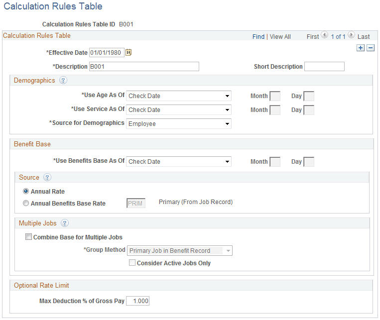

Calculation Rules Table Page
Use the Calculation Rules Table page (CALC_RULES_TABLE) to define calculation rules by specifying salary, age, and service as of dates, as well as coverage, calculation, and rounding options for the rule.
Navigation:
Set Up HCM, and then Product Related, and then Base Benefits, and then Rates and Rules, and then Calculation Rules Table, and then Calculation Rules Table
This example illustrates the fields and controls on the Calculation Rules Table page. You can find definitions for the fields and controls later on this page.
Field or Control Description
Effective Date
Must be the same as or prior to the effective dates of the one or more benefit program and benefit plan combinations that you associate the calculation rules with.
Demographics
Use Age As Of
Used to calculate rates for life plans that you associate with age-graded rates.
Use Service As Of
Used to calculate rates for plans that you base on months of service.
Source for Demographics
Designate whose personal information to use. Values are:.
  • Covered Dependent: This is useful for dependent life plans defined as sum of dependent coverage because each covered dependent has an independent coverage amount, and the premium is typically based on that individual's age, gender, and smoker status.
  • Employee
  • Spouse/Partner: This is useful for spousal life plans.
If the system cannot locate a birth date for a dependent or spouse, it generates a warning that a birth date was not located and uses the employee's age instead, while still retaining the dependent's sex and smoker status.
Benefit Base
Use Benefits Base As Of
Enter the date to use when retrieving the employee's salary if the system needs to use an employee's salary to determine a rate (for example, a compensation-banded rate table or a percent-of-salary rate table).
Source
Annual Rate
Select to make calculations using the regular compensation base entered on the Job Data - Compensation page.
Annual Benefits Base Rate
Select to make calculations using an annual benefit base rate (ABBR.)
The ABBR selected can be either the primary ABBR found on the Job Data - Benefit Program Participation page or any alternate ABBR from the ABBR Update page.
Note: Set a maximum benefits base rate by assigning each employee an ABBR that is not higher than the desired maximum.
Note: For federal users, ABBR corresponds to the Total Pay field on the Expected Pay page of the PAR Compensation Data component.
Multiple Jobs
Combine Base for Multiple Jobs
Select if you want to aggregate salary from multiple jobs as a basis for a rate determination. Selecting this rule activates the Group Method options.
Group Method
If you selected Combine Base for Multi Jobs, select the group method to use for selecting jobs to contribute to the total benefit base. Choose from:
  • All Flagged Jobs: All flagged jobs, regardless of benefit record number, are included in the calculation.
    Note: This means that the job has the Include in Deductions check box selected on the Maintain Primary Jobs Flags page.
  • Flagged Jobs in Benefit Record: All flagged jobs within the current benefit record number are included in the calculation.
  • Primary Job in Benefit Record: Only the primary job within the current benefit record number is included in the calculation.
Consider Active Jobs Only
If you selected Combine Salary for Multi Jobs, select this option to have the system look only at jobs with a status of Active in the Job Data components.
Optional Rate Limit
Max Deduction % of Gross Pay (maximum deduction percentage of gross pay)
If you have employees in Hawaii, state laws mandate that employers charge no more than 1.5% of gross wages for employee-only coverage.
Use this field to establish a calculation rule with the maximum deduction percent of gross pay set to a value of 1.5 or lower. This rule will be attached to the cost row of the benefit plan coverage code associated with employee-only coverage.
This deduction calculation is performed when:
  • The Pay Calculation process is being run.
  • The plan type is Health.
  • The coverage code is Employee Only.
  • The calculation rule ID is defined.
  • The values for maximum percent of gross pay, deductions, and gross pay are all greater than zero.
The maximum deduction percent of gross pay calculation looks like this:
Deduction = (Max Percent of Gross Pay) × (Federal Taxable Gross Pay) ÷ 100.
The smaller deduction appears on the paycheck.
