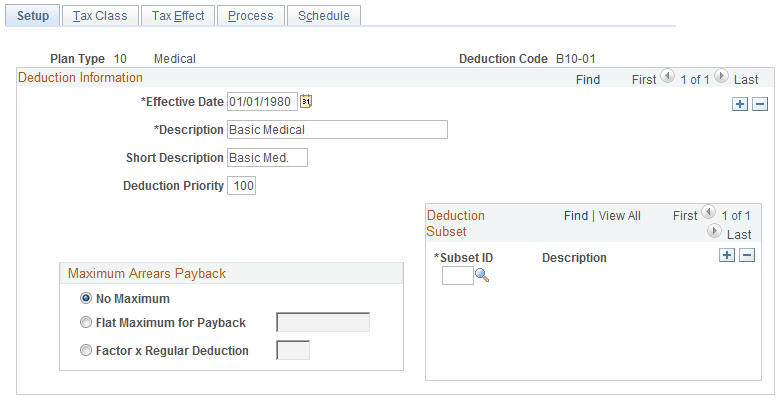

Deduction Table - Setup Page
Use the Deduction Table - Setup page (DEDUCTION_TABLE1) to create deduction codes.
Navigation:
This example illustrates the fields and controls on the Deduction Table - Setup page. You can find definitions for the fields and controls later on this page.
To create a deduction code, enter the effective date and the long description.
If you are using PeopleSoft Payroll for North America or Payroll Interface, refer to the documentation for those products for information about how to set up the Deduction Table component (DEDUCTION_TABLE).
See PeopleSoft Payroll for North America: Setting Up Deductions.
See PeopleSoft Payroll Interface: Setting Up and Maintaining General Deductions.
