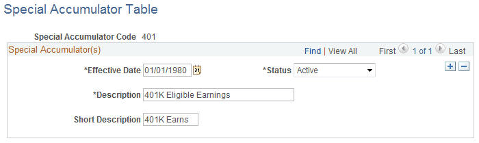

Special Accumulator Table Page
Use the Special Accumulator Table page (SPCL_EARNS_TABLE) to enter special accumulator information.
Navigation:
Set Up HCM, and then Product Related, and then Payroll for North America, and then Compensation and Earnings, and then Special Accumulator Table, and then Special Accumulator Table
This example illustrates the fields and controls on the Special Accumulator Table page. You can find definitions for the fields and controls later on this page.
