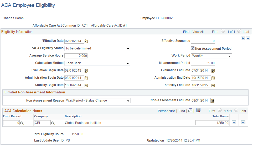

Use the ACA Employee Eligibility page (ACA_ELIGIBILITY) to enter ACA eligibility information for an employee.
Navigation:
  • Click the ACA Eligibility Details link on the Job Data - Benefit Program Participation page.
  • Benefits, and then Employee/Dependent Information, and then ACA Employee Eligibility, and then ACA Employee Eligibility
This example illustrates the fields and controls on the ACA Employee Eligibility page. You can find definitions for the fields and controls later on this page.
Field or Control Description
Effective Date
Enter the date on which the ACA eligibility status becomes effective.
The effective date is usually the start of a stability period, but can be different if required.
ACA Eligibility Status
Choose the ACA eligibility status from the following values:
  • Always Eligible: For example, a salaried full-time employee who is always eligible for benefits.
  • Eligible: An employee whose average hours is equal to or above the minimum hours/week or hours/month so that the employee is considered Benefits Full Time. The employee is eligible for benefits.
  • Excluded: For example, volunteer employees, student employees, members of religious orders.
  • Ineligible: An employee whose average hours is below the minimum hours/week or hours/month so that the employee is considered Benefits Part Time. The employee is not eligible for benefits.
  • To Be Determined: Unable to determine whether the employee is Benefits Part-Time or Full-Time. Human Resources needs to review and determine the employee’s ACA Eligibility status.
Non-Assessment Period
Choose whether the employee is in a non-assessment period.
On selecting the Non-Assessment Period checkbox, the Limited Non-Assessment Information section will be displayed to enter further information about the employee’s non-assessment period. The effective date represents the start of the non-assessment period.
Average Hours of Service
Enter the average hours based on all the jobs the employee has under the same ACA Common ID.
Work Period
Choose whether the work period for the average hours of service is Weekly or Monthly.
Calculation Method
Choose the calculation method used to determine ACA eligibility. The values are:
  • Monthly
  • Look Back
Measurement Period
The measurement period corresponds to the Look Back calculation method. The measurement period should be between 3 to 12 months if the work period is Monthly, and 12 to 52 weeks if the work period is Weekly.
Evaluation Period Begin Date
Enter the start date of the Look Back period to be used to determine the employee’s average service hours.
Evaluation Period End Date
Enter the end date of the Look Back period to be used to determine the employee’s average service hours. The evaluation period cannot be less than three months or more than 12 months.
Administration Period Begin Date
Enter the next date after the evaluation period end date.
Administration Period End Date
Enter a date within 90 days from the administration period begin date.
ACA Stability Period Begin Date
Enter the start date of the stability period in which the ACA eligibility status or average hours of service is effective.
The ACA stability period begin date must be after the evaluation period end date.
ACA Stability Period End Date
Enter the minimum end date that stability period has to be provided to the employee if ACA eligibility is yes, and the maximum end date that stability period provided to the employee if ACA eligibility is no, according to the rules of the Look Back method.
The date must be later than six months after the ACA stability begin date.
Non-Assessment Reason
Enter the reason of the non-assessment period:
  • First Year as ALE Period: January through March of the first calendar year in which an employer is an ALE, but only for an employee who was not offered health coverage by the employer at any point during the prior calendar year. For example, 2015 is not the first year that an employer is an ALE, if that employer was an ALE in 2014.
  • Initial Period - Hire: Variable hour employee, seasonal employee or part-time employee at the initial measurement period due to hire.
  • Initial Period - Rehire: Variable hour employee, seasonal employee or part-time employee at the initial measurement period due to rehire.
  • Initial Period - Status Change: The employee is reasonably expected to be a full-time employee at waiting period, and the employment status then changes to be a variable hour employee, seasonal employee or part-time employee.
  • Wait Period - Hire: The employee is reasonably expected to be a full-time employee at waiting period due to hire.
  • Wait Period - Rehire: The employee is reasonably expected to be a full-time employee at waiting period due to rehire.
  • Wait Period - Status Change: A variable hour employee, seasonal employee or part-time employee at the initial measurement period, whose employment status then changes to a position that is reasonably expected to be a full-time employee.
Non-Assessment End Date
Enter the end date of the non-assessment period. The date must be after the effective date.
Last Updated User ID/Updated On
Review the timestamp to keep track of when and by whom the data was previously updated. This can be a system update, manual update by the HR Administrator, or data from template-based hire.
The ACA Calculation Hours grid lists the Total Hours for the measurement period for multiple jobs handled by the employee (e.g. Employee Record) and companies that belong to the same parent ACA Common ID.
Currently, no automatic BAS Activity trigger is generated when ACA Employee Eligibility Status is updated. Hence if an ACA Eligibility Status update needs to be accounted for in Benefits Administration Event processing, as a Benefits Administrator, you need to manually enter a BAS Activity trigger. It is recommended to set the Event Date to coincide with the Stability Begin Date or when the new coverage should begin, based on ACA requirements. Here, it is assumed that the BAS Action for the trigger is attached to the Event Rule where the Coverage Begin Date is set at ‘On the Event Date’.
