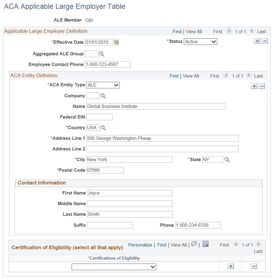

ACA Applicable Large Employer Table Page
Use the ACA Applicable Large Employer Table page (ACA_ALE_TBL) to add a Company that is identified as an ALE (Applicable Large Employer) Member. There must be a valid entry in the ACA Applicable Large Employer Table for each employer that will use the employee consent process to provide Form 1095-C electronically. An entry can be added to the ACA Applicable Large Employer Table only for a Company that is identified as an ALE Member.
Navigation:
Set Up HCM, and then Common Definitions, and then Affordable Care Act, and then ACA ALE Member, and then ACA Applicable Large Employer Table
This example illustrates the fields and controls on the ACA Applicable Large Employer Table page. You can find definitions for the fields and controls later on this page.
Field or Control Description
ALE Member
Applicable Large Employer Member is a single person or entity that is associated to Form 1094-C Reporting. Can be associated with one Company or group of Companies that share the same EIN.
Aggregated ALE Group
If the ALE Member is a member of an Aggregated ALE Group, the Aggregated ALE Group ID will be added here. Otherwise, blank.
Employee Contact Phone
This phone number will appear on the contact phone of Form 1095-C.
ACA Entity Type
‘ALE’ for ALE Member information.
‘DGE’ for Designated Governmental Entity information.
Each ALE Member must have a business name, Federal EIN, address and contact information under ACA Entity Type ‘ALE’.
If a Designated Governmental Entity is filing on behalf of a Governmental Unit, the Governmental Unit is an ALE Member and the Designated Governmental Entity information is entered under ACA Entity Type ‘DGE’.
Same as Company/Agency Table
If the Federal EIN and address of the ALE Member or Designated Governmental Entity is the same as in the Company Table, enter the Company here. The Company information from the Company Table will be populated onto the lines below and the fields will become display only. Otherwise, these fields can be entered manually.
Name
Employer’s name.
Federal EIN
9-digits including dash.
Country
Look up from Country Table.
Address
Employer’s complete address including address, city, state, and postal code.
Contact Information
Contact First Name, Middle Name, Last Name, Suffix and Phone are used on the Employer Form 1094-C transmittal file.
Certification of Eligibility
Enter all the applicable Certifications that the ALE Member applied for. This information will be included on the Employer Form 1094-C transmittal file.

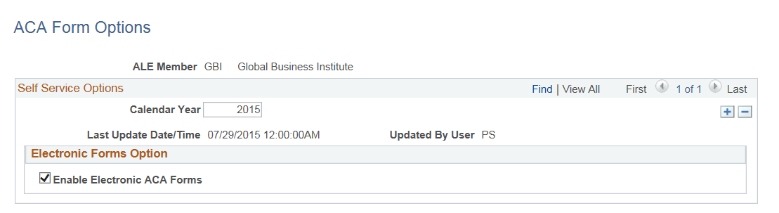

ACA Form Options Page
Use the ACA Form Options page (ACA_FORM_OPTS) to enable the electronic option for Form 1095-C. This step is required to enable employees to grant consent to receive electronic forms.
Navigation:
Benefits, and then ACA Annual Processing, and then ACA Preparation, and then ACA Form Options
This example illustrates the fields and controls on the ACA Form Options page. You can find definitions for the fields and controls later on this page.
Calendar Year
Create a new row each tax year.
Enable Electronic ACA Forms
Select this check box to enable the ALE Member to provide XMLP PDF forms in the eBenefits Self Service transaction.
If this check box is not selected, employees cannot request or withdraw consent or view Form 1095-C.
After employees have granted/withdrawn consent, an administrator can disable this option by deselecting this check box and running the Reset 1095-C Consent Status process.

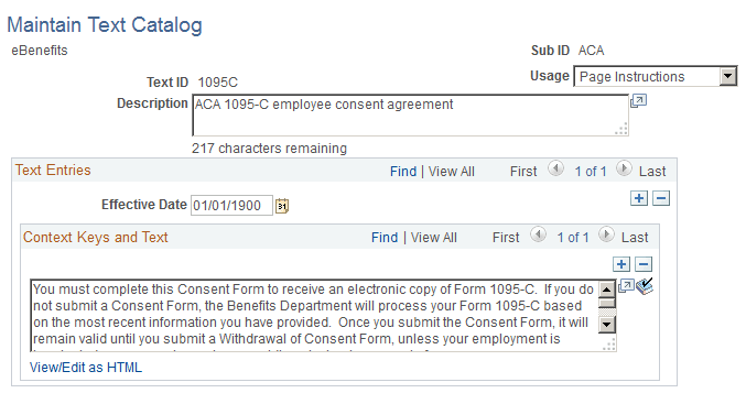

Maintain Text Catalog Page
Use the Maintain Text Catalog page (HR_SSTEXT_TEXT) to select the type of consent form or email text that you want to enter or update.
Navigation:
Set Up HCM, and then Common Definitions, and then Text Catalog and Notepad, and then Maintain Text Catalog
This example illustrates the fields and controls on the Maintain Text Catalog page.
Text ID Usage Text Type Description
1095C
Page Instructions
Consent Agreement
Instructional text displayed on the Form 1095-C Consent page to request consent.
1095R
Page Instructions
Consent Agreement after Reset
Instructional text displayed on the Form 1095-C Consent page to request consent after the Consent has been reset by employer.
1095W
Page Instructions
Withdrawal Agreement
Instructional text displayed on the Form 1095-C Consent page to withdraw consent.
CC
Consent Confirmation
Confirmation text displayed on the Form 1095-C Consent page after Consent is submitted.
CW
Withdrawn Confirmation
Confirmation text displayed on the Form 1095-C Consent page after Consent Withdrawal is submitted.
EMCS
E-Subject
Consent Email Subject
Notification Email Subject to employee that Consent is received.
EMC
E-Body
Consent Email Body
Notification Email Body to employee that Consent is received.
EMWS
E-Subject
Withdraw Consent Email Subject
Notification Email Subject to employee that Consent is withdrawn.
EMW
E-Body
Withdraw Consent Email Body
Notification Email Body to employee that Consent is withdrawn.
EMRS
E-Subject
Reset Consent Email Subject
Notification Email Subject to employee that Consent is reset by employer.
EMR
E-Body
Reset Consent Email Body
Notification Email Body to employee that Consent is reset by employer.
Consent Instruction Requirements
The instructional page text that you create for granting and withdrawing consent should include these details:
  • Notification that a paper copy will be provided if consent is not given.
  • The scope and duration of the consent.
  • Post-consent requests for paper statements.
  • Option to withdraw consent.
  • Conditions under which the employer will no longer furnish electronic statements.
  • Procedures for updating information.
  • Hardware and software requirements.
    For example, inform employees that Adobe Reader is required to view the forms.
  • Contact information.
