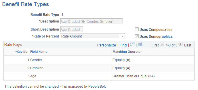

Benefit Rate Types Page
Use the Benefit Rate Types page (BN_RATE_TYPE) to define benefit rate types.
Navigation:
Set Up HCM, and then Product-Related, and then Base Benefits, and then Rates and Rules, and then Benefit Rate Types, and then Benefit Rate Types
This example illustrates the fields and controls on the Benefit Rate Types page. You can find definitions for the fields and controls later on this page.
Field or Control Description
Rate or Percent
Select Rate if you are specifying either flat amounts or rates per-unit-of-coverage, or Percent if the rate is calculated as a percentage of compensation.
Uses Compensation
This field is automatically selected if either the rate type is Percent or any of the key fields that are used will use the employee's compensation data to determine the rate.
Uses Demographics
This field is automatically selected if any of the key fields that are used will use demographic data to determine the rate.
Rate Keys
Key Nbr (key number)
The key number controls the order in which the keys appear when you create a rate table.
Field Name
The application field to use as a key in the Benefit Rate table. This list of available fields is fixed and limited to:
Note: The source of any biographical information is determined by the Source of Demographics field on the Calculation Rules Table page.
  • Age (in years): The covered person's (employee, spouse, or other dependent) age, calculated using their birth date and the Age-As-Of field on the Calculation Rules Table.
  • Benefit Base: The employee's compensation base, calculated using the several benefit base-related attributes in the Calculation Rules Table.
  • Benefit Plan: The employee's enrolled benefit plan.
  • Coverage Code: The employee's enrolled coverage code.
  • Covered Person Type: The covered person type (Employee, Spouse, Domestic Partner, Child, and so on) of the individual whose rate component is being calculated.
  • Gender: The covered person's gender.
  • Months of Service: The employee's length of service, calculated using his or her service date and the Service-As-Of attribute in the Calculation Rules Table.
    Note: The service calculation is frozen as of a termination date.
  • Smoker Status: The covered person's smoker status.
Matching Operator
Specify the type of comparison operation the system uses when attempting to match a value with the keys of a benefits rate table. Use this field to resolve each key ("=" for discrete keys such as codes, and ">," ">=," "<," and "<=" for numeric brackets.)
Note: You can define only one numeric bracket, and it must be the last key.

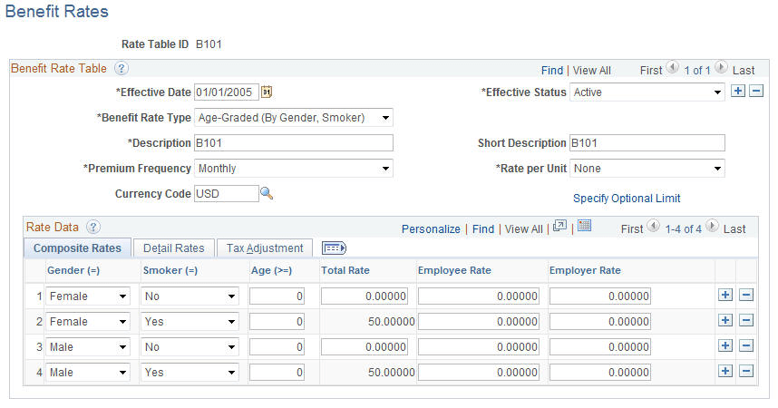

Benefit Rates Page
Use the Benefit Rates page (BN_RATE_TABLE) to enter benefit rate information.
Navigation:
Set Up HCM, and then Product Related, and then Base Benefits, and then Rates and Rules, and then Benefit Rates, and then Benefit Rates
This example illustrates the fields and controls on the Benefit Rates page. You can find definitions for the fields and controls later on this page.
Benefit Rates page
WARNING:
PeopleSoft Base Benefits delivers a set of rates with an ID of IRS. PeopleSoft Payroll for North America uses these IRS rates to calculate imputed income. The IRS table ID set should not be changed.
Benefit Rate Table
Use the Benefit Rate Table group box to define the structure of the rate table.
Benefit Rate Type
Select from one of the system-delivered or custom rate types.
This controls the overall structure of this rate table, especially the keys in the Rate Data section
Premium Frequency
Define how you quote the cost of benefit rates.
If the employee's pay frequency differs from the premium frequency, the system annualizes the coverage rates and divides by employee pay frequency to determine the pay period rate.
Rate per Unit
  • For a flat rate, select None.
  • For a rate that applies to each $100 of coverage, select Per Hundred.
  • For a rate that applies to each $1,000 of coverage, select Per Thousand.
Currency Code
(Optional) Select a currency code to indicate the currency in which the rate data is specified. This is for informational purposes only—the system does not perform any currency conversion during deduction or cost calculations. However, the system does use this information when you are in the Benefit Program Table pages to match available benefit rates against the currency code associated with the benefit program.
Specify Optional Limit
Click to access the Amount Subject to Limit page.
See Amount Subject to Limit Page.
Rate Data
Use this group box to enter composite rates, detail rates, or tax adjustments. Composite rates are based on a specific dollar amount. Composite rates define rates as either Employee or Employer without defining a tax class. The actual tax class used is determined dynamically during processing based on the tax classes defined within the applicable deduction code. Tax classes A and B (after-tax and before-tax) are employee classes, and classes T and N (taxable and nontaxable) are employer classes. The deduction code cannot define more than one employee tax class or employer tax class unless a GTL (group term life) or DPL (dependent life) effect is involved, in which case both N and T are allowed because the T class will be managed by the imputed income processing.
You can enter rates using either the Composite method or theDetail method, but not both.
Composite Rates
Enter the rates that are based on a specific dollar amount. The appearance of the grid is based on the benefit rate type.
Age (>)
You can enter the keys based on your criteria from the benefit rate type.
Total Rate
Enter the total cost of the coverage. Include any administrative fee that you may charge.
Employee Rate
Enter the rate charged to the employee and deducted through the paycheck. This is either after-tax or before-tax, depending on the deduction code definition.
Employer Rate
Enter the rate the employer pays to subsidize the cost of a benefit. This is either taxable or nontaxable, depending on the deduction code definition.
Employee Percent
Enter the employee's portion of contribution. If you've specified a percent, this represents the percentage of base that the employee pays for the benefit.
Employer Percent
Enter the percentage of base that the employer contributes towards the benefits.
The fields that appear in the Rate Data group box depend upon the rate type that you select.

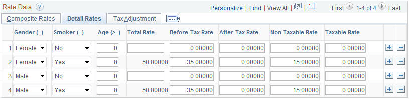

Detail Rates
Access the Detail Rates tab on the Benefit Rates page.
This example illustrates the fields and controls on the Benefit Rates page: Detail Rates tab. You can find definitions for the fields and controls later on this page.
Use the Detail Rates grid to split employee premiums across Before and After Tax, or to split employer premiums across taxable and nontaxable.
An example is premiums for domestic partner health coverage in the US, where the cost for qualified individuals can be Before Tax, but non-qualified individuals are After Tax.
Before-Tax Rates, After-Tax Rate, Non-Taxable Rate, and Taxable Rate
Allocate the total rate across the tax classes as desired. The classes here have the same meaning and impact as those specified in the deduction code. Any given tax class rate will be taken only if the deduction code being processed also has that tax class defined. You should not specify a taxable rate component for use in plans that are subject to imputed income. The system expects to generate the taxable cost for these plans.
Before-Tax Percent, After-Tax Percent, Non-Taxable Percent, and Taxable Percent
Allocate the percentages across the tax classes as desired.

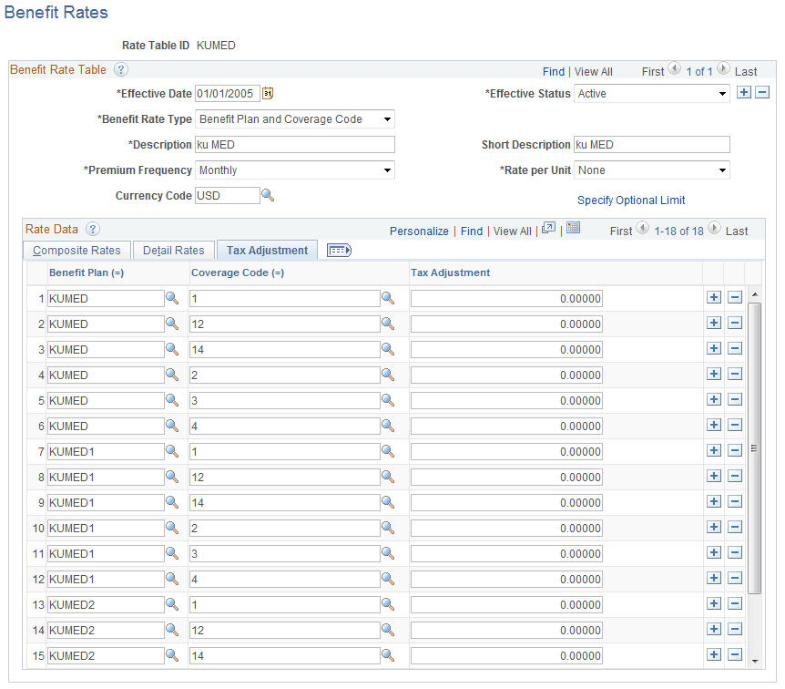

Access the Tax Adjustment tab on the Benefit Rates page.
This example illustrates the fields and controls on the Benefit Rates page, Tax Adjustment tab. You can find definitions for the fields and controls later on this page.
The tab displays a column for the Non-Taxable Before-Tax benefit deduction class (labeled Tax Adjustment). Define the rates applicable to adult children here. For the Percent of Base rate type, the column label is Adjustment Percent.
The Tax Adjustment tab has the same attributes as the rate columns on the existing tabs:
  • Default zero amount, numeric 5 decimals, etc., for amount rates.
  • Percent of Base Rate Type Adjustment Percent field attributes have the same attributes as the other percentage rate fields on the page.
  • The Total Rate column formulae on the two existing tabs does not include the rate on the tax adjustment tab.
The functionality is targeted at the two rate types that are most suited to health care deductions:
  • Benefit Plan and Coverage Code
In addition, the Percentage of Base type is included.

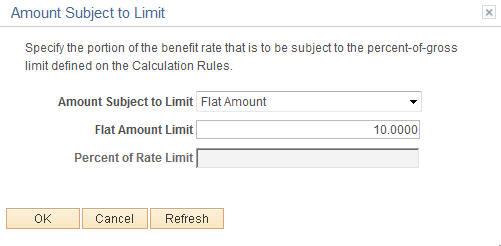

Use the Amount Subject to Limit page (BN_RATE_LMT_SEC) to define the percent-of-gross limits.
Navigation:
Click the Specify Optional Limit link on the Benefit Rates page.
This example illustrates the fields and controls on the Amount Subject to Limit page. You can find definitions for the fields and controls later on this page.
Specify the portion of the benefit rate to be subject to the percent-of-gross limit defined in the Calculation Rules Table page.
Select whether the limit amounts is:
  • Entire Rate Amount
  • Flat Amount Limit
  • Not Applicable
  • Percent of Rate
Flat Amount Limit
This field is available if you selected Entire Rate Amount in the Amount Subject to Limit field.
Enter the amount that is subject to the limit.
Percent of Rate Limit
This field is available if you selected Percent of Rate in the Amount Subject to Limit field.
Enter the percentage amount of the employee rate that is subject to the limit.
