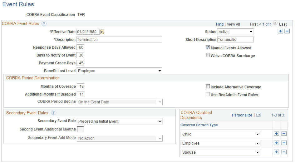

Event Rules Page
Use the Event Rules page (COBRA_EVENT_RULES1) to identify the events that result in the loss of health plan coverage for a qualified beneficiary.
Navigation:
Set Up HCM, and then Product Related, and then Base Benefits, and then COBRA, and then Event Rules, and then Event Rules
This example illustrates the fields and controls on the Event Rules page. You can find definitions for the fields and controls later on this page.
Event Rules page
COBRA Event Rules
Field or Control Description
Effective Date
Enter or select the date on which this COBRA event goes into effect. The system always uses the record with the effective date that is closest to but not past the current date.
Status
Select whether this COBRA event is Active or Inactive.
Description
Enter a description of the COBRA event using up to 30 characters.
Short Description
Enter a brief description of the COBRA event using up to 10 characters.
Response Days Allowed
Specifies the maximum number of days that a beneficiary has to elect coverage from the date of notification. COBRA eligibility expires after the response period.
Days to Notify of Event
Identifies the number of days an employee or dependent has to notify the organization following a qualifying COBRA event.
Payment Grace Days
Enter the number of payment grace days employees will be given to submit a payment after they send in an election.
Manual Events Allowed
Select if you want to allow manual entry of the event.
Waive COBRA Surcharge
Select if, for this event classification, you want the system to disregard the COBRA surcharge percentages defined in the Benefit Program Table.
Benefit Lost Level
Define whether the COBRA event affects the employee only, the dependent only, or both. Values are Employee, Dependent (a COBRA-qualified beneficiary), and neither.
COBRA Period Determination
Months of Coverage
Identifies how long coverage will extend for a particular qualifying event. COBRA coverage generally extends for 18 or 36 months following a qualifying event.
Additional Months if Disabled
Enter the extension for disabled participants. Regulations allow an extension up to 11 months past the original 18 months for termination of employment and reduction in work hours events for disabled participants.
Include Alternate Coverage
Select to set up a grace period.
COBRA Period Begins
Select a value to define when COBRA coverage begins. Values are:
On the Event Date: The COBRA period begin date is the same as the day of the event. COBRA coverage actually begins the day after the event date or the day after the grace period ends.
On Month-Begin After Event: The COBRA begin date is on the first day of the month after the event.
On PayPeriod Begin After Event: The COBRA begin date is on the first day of the pay period after the event day.
Secondary Event Rules
Secondary Event Role
Indicates whether the displayed COBRA event classification can be considered a secondary event. Values are:
Succeeding Second Event (S): This indicates that the COBRA event classification is a secondary event.
Preceding Initial Event (P): If this field has a value of P, then the other two secondary event rules fields will be unavailable for data entry.
Second Event Additional Months
If Secondary Event Role is selected, the Second Event Additional Months field defines the number of months that the original COBRA coverage will be extended.
Secondary Event Add Mode
Defines whether the system adds second event additional months to the original coverage begin date of the initial event or to the COBRA event date of the secondary event.
In the event classifications that the PeopleSoft application delivers, the Death, Divorce, Married Dependent, and Overage Dependent events have a Second Event Add Mode value of E (Extended) while the Medicare Entitlement event has a Second Event Add Mode value of A (Added).
Note: For the Divorce COBRA Event Classification, the sole-defined COBRA qualified beneficiary is X (Ex-Spouse).
COBRA Qualified Dependents
Covered Person Type
Select from the following values to define the relationship you have to the dependent.
Child, Domestic Partner, Employee, ExSpouse, Non-Qualified Dependent, Other Qualified Dependent, Spouse.
