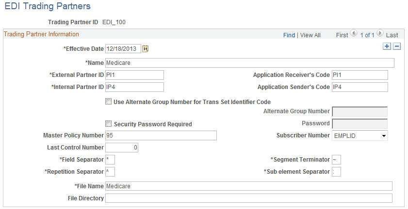

EDI Trading Partners Page
Use the EDI Trading Partners page (BN_EDI_PARTNERS) to define the information needed for the EDI Interchange Control segments for each partner receiving 834 transaction transmissions.
Navigation:
Set UP HCM, and then Product Related, and then Base Benefits, and then EDI Trading Partners, and then EDI Trading Partners
This example illustrates the fields and controls on the EDI Trading Partners page. You can find definitions for the fields and controls later on this page.
Field or Control Description
Name
Enter the name of the EDI trading partner.
A trading partner can be one of your health care providers but doesn't have to be.
External Partner ID
Identify the receiving partner.
This ID must be agreed upon by both the sender and receiver.
Internal Partner ID
Identify the sending partner.
Application Receiver's Code
Enter a value.
Application Sender's Code
Enter a value.
Use Alternate Group Number for Trans Set Identifier Code
Select to enter a value in the Alternate Group Number field.
If you selected the Use Alternate Group Number for Trans Set Indenitfier Code field, then you must enter a value. The system uses the alternate group number in place of the external partner ID when creating the concatenated transaction set identifier code.
Security Password Required
Select to enter a value in the Password field. This indicates there is security information associated with the HIPAA file.
Password
If you selected the Security Password Required field, then you must enter a 10-character password. The systems sets the ISA03 value to 01 in the ISA segment and then sends the password value in position ISA04.
Master Policy Number
Enter a value.
In the header of the HIPAAA file, the system includes a new REF segment (Transaction Set Policy Number) with a reference ID qualifier of 38 along with the master policy number that you entered in this field.
Subscriber Number
Select from the following values:
EmplID: The HIPAA process uses the emplID of the subscriber as the REF02 value in the REF*0F segment in loop 2000.
SSN The HIPAA process uses the social security or national ID number of the subscriber instead of the emplID. The records for dependents also use the subscriber's ID number for the REF02 value.
Note: If you select SSN and the subscriber does not have a social security number, the file uses the emplID for that subscriber and his or her members' records.
Last Control Number
The system increments this number with each transmission to the partner.
Initially the control number is set to 0. You can manually reset the control number, if necessary.
Field Separator
Enter the character to use to separate fields in each segment of the EDI file.
The default value is an asterisk (*), which is the value suggested by the reporting standard.
Segment Terminator
Enter the character to use to mark the end of each segment of the EDI file.
The default value is a tilde (~), which is the value suggested by the standard.
Subelement Separator
Enter the character to use to separate component data elements within a composite data structure of the EDI file.
The default value is a colon (:), which is the value suggested by the standard.
Note: This delimiter is not used in PeopleSoft-delivered 834 transaction segments.
Repetition Separator
Enter the character to use to separate repeated data in the EDI file.
The default value is a carat (^). You can change this, but you must not enter any character used as a delimiter or terminator by another field.
File Name
Enter the name for the EDI file.
File Directory
Enter the directory where the file will be created.
If this field is left blank, the file will be created in the directory PS_SERVDIR.

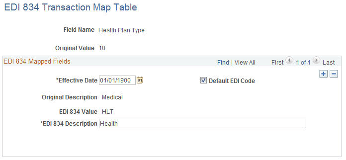

EDI 834 Transaction Map Table Page
Use the EDI 834 Transaction Map Table page (BN_834_MAP_TBL) to view the delivered code maps or set up new code maps for any new codes you have added to the system.
Navigation:
Set Up HCM, and then Product Related, and then Base Benefits, and then EDI 834 Transaction Map Table, and then EDI 834 Transaction Map Table
Some of the codes required by the ASC X12.834 Implementation Guide need to be mapped from PeopleSoft codes or customer-defined codes. Oracle delivers the mapping for existing PeopleSoft codes. If you add your own codes, you need to map those codes to EDI 834 codes.
This example illustrates the fields and controls on the EDI 834 Transaction Map Table page. You can find definitions for the fields and controls later on this page.
Default EDI Code (default electronic data interchange code)
Each plan type has one default EDI code used in the HIPAA file, for example, HLT for Plan Type 10.
Note: If you do not enter a value in the EDI Insurance Line Code field on the Benefit Plan Table page, the system uses the mapped value for the plan type as the Default EDI Code value in the HIPAA file.
Original Description
The description of the code that is being mapped.
EDI 834 Value
The ASC X12.834 value corresponding to the PeopleSoft code or customer-defined code.
EDI 834 Description
The ASC X12.834 code description.
