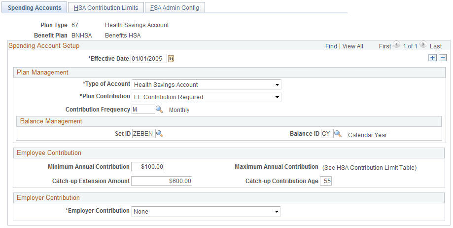

Spending Accounts Page
Use the Spending Accounts page (FSA_BENEFITS_TABLE) to define spending account plan details for US and Canada.
Navigation:
Set Up HCM, and then Product Related, and then Base Benefits, and then Plan Attributes, and then FSA Benefits Table, and then Spending Accounts
This example illustrates the fields and controls on the Spending Accounts page. You can find definitions for the fields and controls later on this page.
Field or Control Description
(CAN) Employer Carryforward Choice
Carry forward credit or claim amounts from one plan year to the next.
(CAN) Future Borrowing
Select to allow plan enrollees to spend FSA credits prior to their inclusion within the plan year.
Plan Management
Type of Account
Select whether the spending account is a Flexible Spending Account or a Health Savings Account.
If you are using PeopleSoft Benefits Administration, the system shows the HSA Contribution Limits page when you select Health Savings Account.
Plan Contribution
Indicate whether employees are expected to contribute to the plan by selecting one of the following options:
  • EE Contribution Optional
  • EE Contribution Required
  • Employer Only (No EE)
Contribution Frequency
Select a frequency to define how you quote amounts for this spending account plan.
If, when you are entering an employee's election, an employee contribution percentage is specified in addition to an annual pledge, then it is specified in terms of this contribution frequency.
Balance ID
The system uses the pay period end date or check date and the schedule of balance periods associated with this balance ID to calculate deductions.
Employee Contribution
Minimum Annual Contribution
Enter the minimum contribution employees can make annually.
Maximum Annual Contribution
Enter the maximum contribution employees can make annually either here or on the HSA Contribution Limits page.
See Entering HSA Contribution Limits.
Catch-up Extension Amount
Enter the annual HSA catch-up extension amount as defined by the IRS.
Catch-up Contribution Age
Enter the age as of which employees can contribute the additional catch-up amount.
Employer Contribution
Indicate whether and how an employer matches contributions to this plan:
  • None: No employer match is contributed.
  • Flat Amount: Matches the employee contribution with a flat amount that you enter, up to a chosen percentage.
  • Percent of Employee Contribution: Matches a percent of the employee contribution that you enter, up to a limit that you define.
  • Special Calculation Routine: Uses a custom routine not supported by the standard PeopleSoft system.
Note: HSA plans only use the None and Flat Amount options.
Flat Contribution Amount
If you are using Benefits Administration, enter the employer contribution on the HSA Contribution Limits page only if the plan is an HSA plan. If the plan is an FSA, then enter the contribution amount on this page.

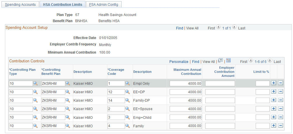

HSA Contribution Limits Page
Use the HSA Contribution Limits page (HSA_CONTRIB_LIMITS) to define the contribution limits for HSA plans.
This page is only available when using Benefits Administration.
Navigation:
Set Up HCM, and then Product Related, and then Base Benefits, and then Plan Attributes, and then FSA Benefits Table, and then HSA Contribution Limits
This example illustrates the fields and controls on the HSA Contribution Limits page. You can find definitions for the fields and controls later on this page.
Employees can contribute to an HSA only if they are covered by an HDHP. Their contributions to an HSA are determined by the HDHP and the coverage code. For each controlling plan you enter, make sure that you include a row for each coverage code.
Contribution Controls
Controlling Plan Type
Select the benefit plan type whose membership controls eligibility for this plan.
Controlling Benefit Plan
Select the HDHP benefit plan whose membership controls eligibility for this plan.
Coverage Code
Select the plan's coverage code.
Enter the maximum annual amount that can be contributed to the HSA when an employee is covered by this plan and coverage code. This maximum is the total limit for both employee and employer contributions combined.
Employer Contribution Amount
Enter the amount that employers will contribute based on the Employer Contribution Frequency to the HSA for employees covered by this plan and coverage code.
Limit to % (limit to percent)
Leave blank because employer contributions must be nondiscriminatory.

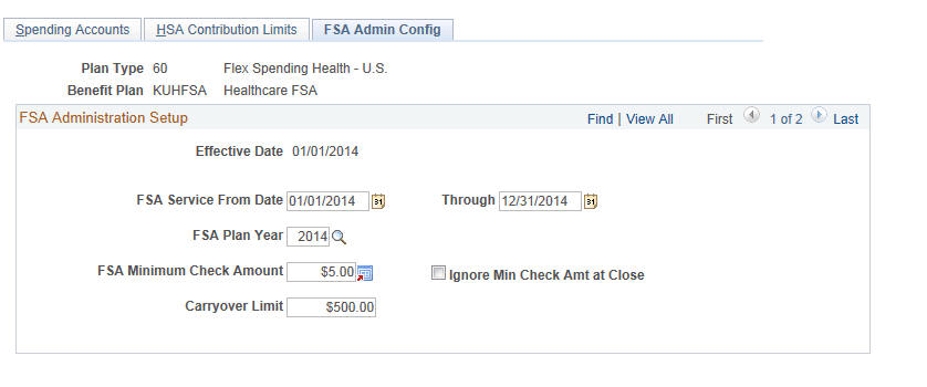

FSA Admin Config Page
Use the FSA Admin Config page (FSA_ADMIN_CONFIG) to define the FSA Admin Configuration.
Navigation:
Set Up HCM, and then Product Related, and then Base Benefits, and then Plan Attributes, and then FSA Benefits Table, and then FSA Admin Config
This example illustrates the fields and controls on the FSA Admin Config page. You can find definitions for the fields and controls later on this page.
FSA Benefits Table page
Use the following fields to determine the service dates that are valid for submitted claims:
FSA Service From Date
This field by default displays the effective date of the plan and must be within the service date range to be paid under the plan.
This value can also be longer than 12 months and overlap the service dates of other plans that the employer offers and in which the employee is enrolled.
Through
This field by default displays the date that is 12 months after the effective date of the plan.
FSA Plan Year
Select the year pertaining to this plan.
FSA Minimum Check Amount (flexible spending account check amount
Enter a cost below which the system does not pay out any claims.
Ignore Min Check Amt at Close (ignore minimum check amount at close)
Select to close out the plan and process and pay out any approved, pending claims below the minimum amount. All claims are paid when the system runs the closure process for the benefit plan.
Note: If this option is not selected, all claims below the minimum amount remain unpaid. If the pending claim has a service date that overlaps two FSA plans in which an employee is enrolled, the system moves the claims to the second FSA plan until enough claims exist to meet the minimum check amount of the second FSA plan.
Carryover limit
Define the maximum FSA carryover limit.
Note: The maximum carryover amount should not exceed $500.
For more information on setting the FSA carryover, see Understanding U.S. Health FSA Carryover

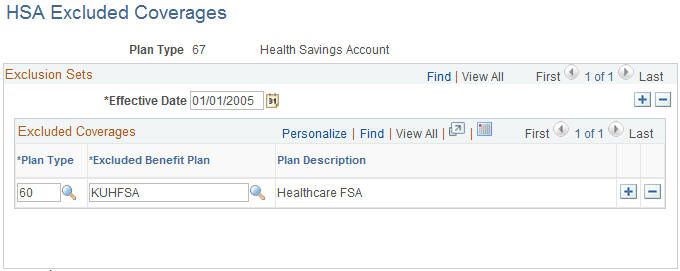

HSA Excluded Coverages Page
Use the HSA Excluded Coverages page (HSA_EXCLUDED_CVRGS) to define specific plans that will be excluded from coverage when one selects an HSA.
Navigation:
Set Up HCM, and then Product Related, and then Base Benefits, and then Program Structure, and then HSA Excluded Coverages
If an employee enrolls in an HSA, he or she cannot enroll in some plans. These nonpermitted plans are defined in an HSA Excluded Coverages table by plan type and plan. This table validates all HSA enrollments through eBenefits and Benefits Administration.
This example illustrates the fields and controls on the HSA Excluded Coverages page. You can find definitions for the fields and controls later on this page.
