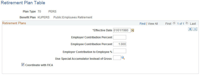

This example illustrates the fields and controls on the Retirement Plan Table page. You can find definitions for the fields and controls later on this page.

Employer Contribution to Employee % (employer contribution to employee percentage)
Define how much the employer contributes to the employee's total contribution percentage.
Use Special Accumulator Instead of Gross
To have the system use a special accumulator instead of the total gross, enter the desired accumulator code here.
To use a special accumulator, work with your payroll department to define the code and its detail. You can set up special accumulators—as many as you need—to process savings, retirement, and pension plans.

Select OASDI Offset for retirement plans that have employee contributions offset by employee contributions to OASDI. The system reduces employee retirement plan contributions by the OASDI contribution amount and the following pre-tax deductions (Medical (plan type 10), Dental (plan type 11), Vision (plan type 14), Flex Spending Health - U.S. (plan type 60), Flex Spending Dependent Care (plan type 61) and Health Savings Account (plan type 67)) until the maximum OASDI/FICA contribution level is reached.
You must define a special accumulator for the system to track the Basic Pay Wages that are used in the retirement deduction calculation.
