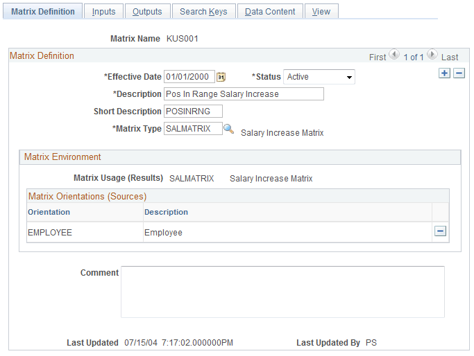

Matrix Definition Page
Use the Matrix Definition page (WCS_LK_TBL_DEFN) to define and maintain matrices.
Navigation:
Set Up HCM, and then Common Definitions, and then Configurable Matrices, and then Define Configurable Matrices, and then Matrix Definition
This example illustrates the fields and controls on the Matrix Definition page.
All matrices are created with a status of Inactive. You must change the status to Active to use them.
Field or Control Description
Matrix Type
Select the matrix type on which the configurable matrix should be based. Values are:
  • MARKETPAY (market pay surveys).
  • RATE (rate tables).
  • SALMATRIX (salary increase matrices).
Orientation
The orientation indicates the starting point for associating the employee ID to other related fields. If all sources used in the matrix can be evaluated using EMPLOYEE and JOB records only, then you only need the EMPLOYEE orientation. If sources can be evaluated starting from worker's Position information, then you can add POSITION as another orientation.
Note: You must have at least one orientation. You can, however, have both orientations.
If the information available to the calling program is only position data and not the employee ID, then you need POSITION as an orientation to allow the matrix to evaluate the sources.

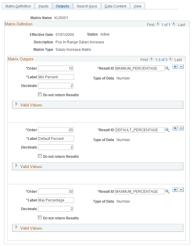

Outputs Page
Use the Outputs page (WCS_LK_TBL_OUTPUTS) to define outputs of the matrix.
Navigation:
Set Up HCM, and then Common Definitions, and then Configurable Matrices, and then Define Configurable Matrices, and then Outputs
This example illustrates the fields and controls on the Outputs page.
Outputs page
Results that are available on this page will differ depending upon the matrix type.
Matrix Outputs (Result Columns)
Order
Enter a numerical value that indicates the order in which the outputs should appear in the matrix.
Result ID
Select a value that the configurable matrix should return as an output. These values come from the Results ID table.
Label
Enter the label that will appear in the matrix.
Type of Data
This display-only field indicates if the result ID has a character, number, or date format.
Decimals
If the result ID has a number format, then you can enter the number of decimal places that you want to appear in the matrix.
Do not return Results
Select this check box if the result is to be used as a reference only for a calculation in another result. For example, if you have a PCNTOFBASE type result that uses BASERATE as its reference, then you can set this check box on the BASERATE result ID. The calling program will only receive PCNTOFBASE as an output result ID; it will not receive any other output from the matrix.
Note: You will see all defined result IDs on matrix displays, even though this check box may be selected for some results.
Valid Values
Select a table, a field, and, if appropriate, a setID to use to designate a list of values for an output column. The system uses the record and field designations as an edit table for the output values.

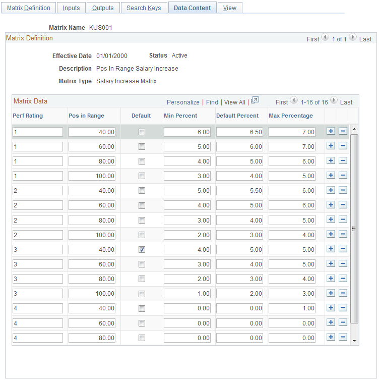

Data Content Page
Use the Data Content page (WCS_LK_TBL_DATA) to enter values for the output data.
Navigation:
Set Up HCM, and then Common Definitions, and then Configurable Matrices, and then Define Configurable Matrices, and then Data Content
This example illustrates the fields and controls on the Data Content page.
Data Content page
This page lists the combinations of search keys for all inputs that the matrix will evaluate. For each combination, it lists all outputs fields. You can add the character, date, or numerical values of each output here. The columns that appear on this page vary depending on the fields you define on the Inputs page and Outputs page. The columns to the left of the Default check box are defined on the Inputs page. The columns to the right of the Default check box are defined on the Outputs page.
All inputs appear to the left of the Default column, and all outputs appear to the right of the Default column.
Default
(Optional) Select the row that you want to use as default results if the system does not find a match between the worker data and any combination of input rows. In the previous example, you were able to choose a default for a worker who was above or below the 40 and 100 ranges or who did not have a performance rating.
A good practice is to select a default for a rate matrix that is attached to a rate code that is associated with a salary step.
Note: You can only select one row as a Default.
