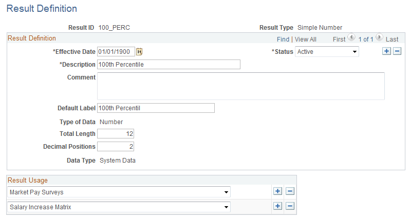

Result Definition Page (SIMPLENUM Result Type)
Use the Result Definition page (SIMPLENUM Result Type) (WCS_RES_SIMPLENUM) to maintain results returned from configurable matrices using the SIMPLENUM result type.
Navigation:
Set Up HCM, and then Common Definitions, and then Configurable Matrices, and then Define Matrix Results, and then Result Definition
Select SIMPLENUM (simple number) as the result type on the Define Results search page.
This example illustrates the fields and controls on the Result Definition page - SIMPLENUM result type.
This type of result stores simple numbers that represent different values. For example, the 50_PERC result ID can be used in salary increase guidelines matrices and in market pay matrices to track the 50th percentile values for different numbers, such as compa-ratios and base compensation market rates.

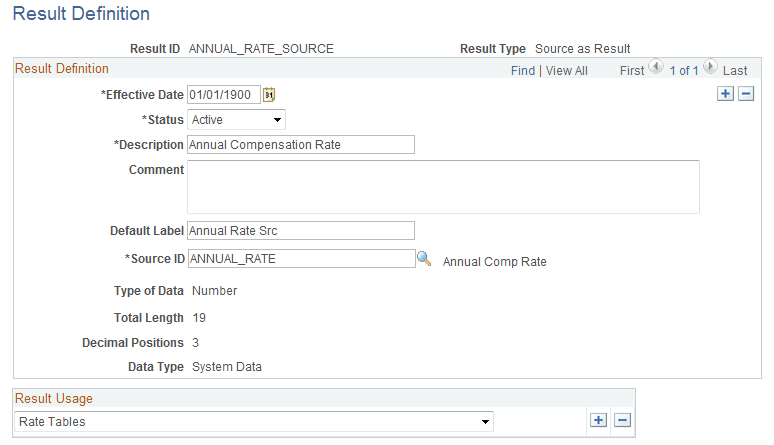

Result Definition Page (SOURCE Result Type)
Use the Result Definition page (SOURCE Result Type) (WCS_RES_SOURCE) to maintain results returned from configurable matrices using the SOURCE result type.
Navigation:
Select SOURCE as the result type on the Define Results search page.
This example illustrates the fields and controls on the Result Definition page - SOURCE result type.
Field or Control Description
Source ID
Select a source ID that this result ID will implicitly evaluate and return the source's value as the final result. The list of possible source ID values comes from the Sources Definition.
This type of result ID returns the value of a referenced source ID as its value. The final result is the value of the source. As an example, assume you needed to create a rate matrix for calculating bonuses as a percentage of workers' annual compensation rates. However, the bonus percentages will vary by department. Therefore, the single input to the matrix is Dept, and the two results are Annual Rate and Bonus Pct.
The matrix looks like this:
Dept (Source) ANNUAL_RATE_SOURCE (Result) Bonus Percent (Result)
101
ANNUAL RATE
4
102
ANNUAL RATE
4
103
ANNUAL RATE
5
104
ANNUAL RATE
6
Since you do not know each worker's annual rates, you define one result ID of type of SOURCE, called ANNUAL_RATE_SOURCE, and associate it to the Source ID ANNUAL_RATE. Then, you define a second result ID of type PCNTOFBASE, called BONUS_PCT, which tracks the bonus percentages. You specify the ANNUAL_RATE_SOURCE result ID as the target result ID to which the bonus percentage is applied. When this matrix is evaluated, the following actions will occur:
  1. Since Dept is the required input, the system looks up the worker's department (for example, 103).
  2. The system looks up results for Dept 103.
  3. For the Annual_Rate_Source result, the system looks up the ANNUAL RATE of the worker and returns that value (for example, 10,000 USD).
  4. For the Bonus Pct result, the system applies the bonus percent, 5, to 10,000 USD and returns a value of 500 USD.

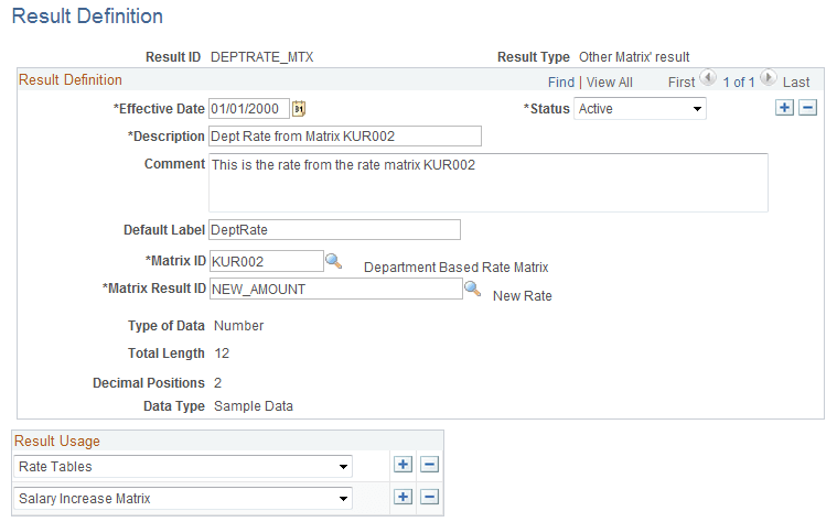

Result Definition Page (MATRIX Result Type)
Use the Result Definition page (MATRIX Result Type) (WCS_RES_OTHER_LKUP) to maintain results returned from configurable matrices using the MATRIX result type.
Navigation:
Select MATRIX as the result type on the Define Results search page.
This example illustrates the fields and controls on the Result Definition page - MATRIX result type.
Matrix ID
Select the matrix on which this result should be based.
Matrix Result ID
Select a result ID (for the matrix) on which this result should be based.
This type of result uses one of the result IDs of another matrix as its value. When a matrix using this result is evaluated, the system evaluates the referenced matrix to get the final value. For example, assume that you want to set up a payment structure for health benefits, and you decide that the company will pay health benefits at 20 percent of the standard compensation rate by department. To determine a worker's health benefit rate, you need to determine their department's standard compensation rate. However, the standard compensation rate itself is dynamically set based on Salary Grade steps. Assume that the standard rate is derived using the KUR001 rate matrix, which has NEW_AMOUNT as the result. Then, the system would use the NEW_AMOUNT result of that matrix as the reference rate. The system can now apply a percentage of that result (using PCNTOFBASE) to get a final health benefit rate.
In this case, the Matrix ID is KUR001, and the Matrix Result ID is NEW_AMOUNT.
