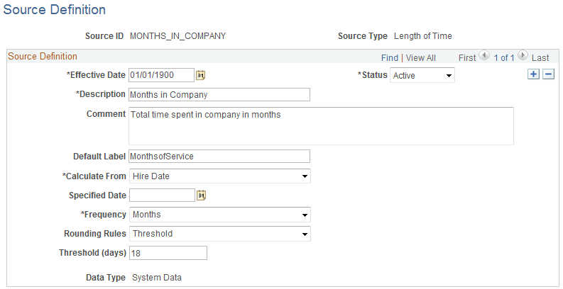

Source Definition Page (TIMESPAN Source Type)
WCS_SO_TIME
Define sources that are based on the length of time.

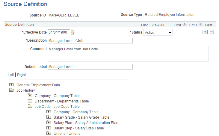

Source Definition Page (EMPRELATED Source Type)
Use the Source Definition page (EMPRELATED Source Type) (WCS_SO_RELATED) to define sources that are based on related employee information.
Navigation:
Set Up HCM, and then Common Definitions, and then Configurable Matrices, and then Define Matrix Sources, and then Source Definition
Select EMPRELATED as the source type on the Define Sources search page.
This example illustrates the fields and controls on the Source Definition page - EMPRELATED source type (1 of 2).
This example illustrates the fields and controls on the Source Definition page - EMPRELATED source type (2 of 2).
Click the folder icon in the tree to open the appropriate related table and then select the appropriate element by clicking the leaf node.
This tree allows you to derive a value from any table related to worker's Job record using the EmplID as a starting point. For example, if you want to use the Manager Level of the worker's Job Code as the source, you can link to it by opening the JOBCODE folder and clicking the Manager Level leaf node. You can use this source type to create source IDs for fields that are not available as system-defined source IDs.

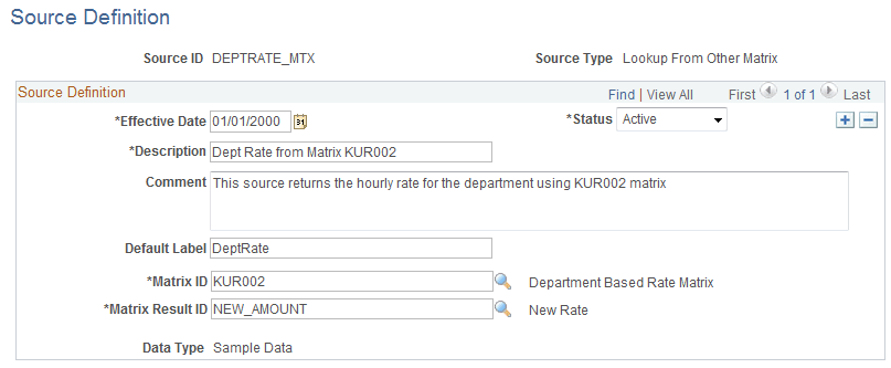

Source Definition Page (MATRIX Source Type)
Use the Source Definition page (MATRIX Source Type) (WCS_SO_OTHER_LKUP) to define sources that are based on a matrix.
Navigation:
Select MATRIX as the source type on the Define Sources search page.
This example illustrates the fields and controls on the Source Definition page - MATRIX source type.
With this source, the system evaluates the key for the input dynamically by referring to another matrix and using one of the results from that matrix as the key value.
See Inputs Page.
Field or Control Description
Matrix ID
Select from the list of available matrices.
Matrix Result ID
Select the result ID (output) from the matrix that will be used as the source ID.
Example: Health Benefits Rates Using a MATRIX Type Source ID
Suppose you are creating a matrix to determine health benefit allowance amounts. However, you want to base the health benefits on standard hourly rates for each department. If the hourly rates are below a certain amounts, then you will give health benefits. The matrix may look like this example:
Standard Hourly Rate Health Benefit Rate
10–12
4
13–15
3
16–20
2
21–100
0
In this case, you need a way to dynamically get hourly rates for the worker's department. A source of type Matrix is useful in this case. In the previous example, you define a source that will return the rate for the worker's department. You specify which matrix has department rates and which result ID from that matrix is the rate value.
In the health benefits table, the Std Hourly Rate would be defined using the DEPTRATE_MTX source ID.

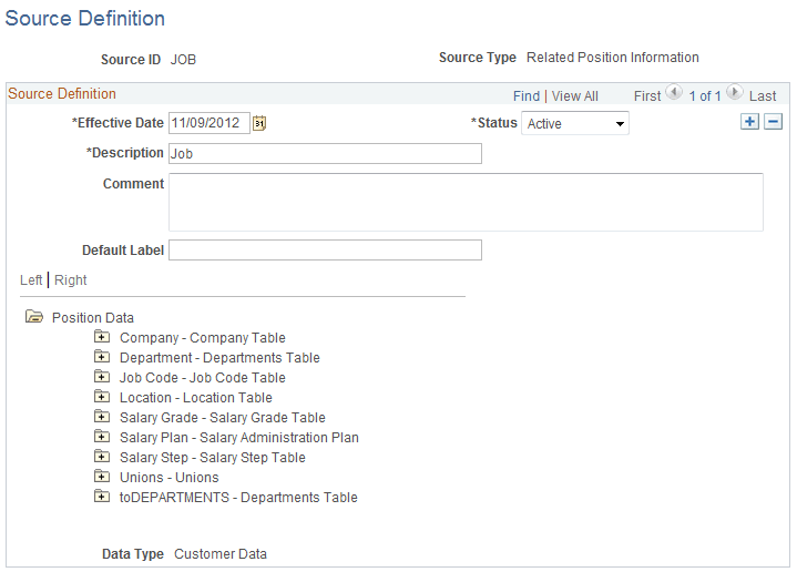

Source Definition Page (POSRELATED Source Type)
Use the Source Definition page (POSRELATED Source Type) (WCS_SO_RELATED) to define sources that are based on related position information.

Select POSRELATED as the source type on the Define Sources search page.
This example illustrates the fields and controls on the Source Definition page - POSRELATED source type.
View various worker related information such as general employment data, job history, names, and so on.
Position Data
This tree allows you to derive a value from any table related to the position of the worker using the position number as a starting point. For example, if you want to use the Grade of the worker as the source, you can link to it by opening the Salary Grade folder and clicking the Grade leaf node.

Select TIMESPAN as the source type on the Define Sources search page.
This example illustrates the fields and controls on the Source Definition page - TIMESPAN source type.
This source allows you to define as input the length of time elapsed between current (as of) date and a specified reference date. For example, if you want to create a rate matrix that will include pay rates based on how long the worker has been in the company, in that job, or in that grade, then you define a source of this type.
Calculate From
Select the type of date from which you want the length of time to be calculated. The available dates are:
  • Date of Last Increase
  • Date of Last Var Comp Award
  • Hire Date
  • Seniority Date
  • Specific Date
  • Start in Current Grade
  • Start in Current Job
  • Start in Current Position
  • Start in Current Step
  • Termination Date
Specified Date
Enter the specific calendar date from which you want the length of time to be calculated.
Note: The Specified Date and Calculate From options are mutually exclusive. If you enter a specified date, you cannot select a date in the Calculated From field. If you select a date in the Calculated From field, you cannot enter a specified date.
Frequency
Select the frequency with which you want the length of time to be calculated. You can select Hours, Days, Weeks, or Months.
Rounding Rules
Select a value that will represent the type of rounding to be applied to the timespan.
  • Anniversary: This type of rounding will use anniversary date or time to round up or down. The calculations are performed as follows:
    • Hours and Days: This option does not apply. The system simply returns hours or days based on actual timespan.
    • Weeks and Months: This option will always round down to the nearest whole unit. For example, 4 weeks and 6 days will be rounded to 4 weeks, and 8 months and 29 days will be rounded to 8 months.
  • Threshold: This type of rounding offers more granular control on rounding. The calculations are performed as follows:
    • Hours and Days: No rounding.
    • Weeks and Months: Rounding depends on the threshold.
      If the number of days in the threshold is less than or equal to the remainder from the calculated timespan, the system adds one more unit. For example, assume that the frequency was set to Weeks and the threshold was set to 5 days. If the timespan was calculated as 4 weeks and 5 days, the system would return 4 + 1 = 5 weeks as the final value. However, if the threshold was 6 days, the system would return 4 weeks.
      For a frequency of Months, if the timespan was 2 months and 15 days and the threshold was set to 20 days, the system returns 2 months. If the threshold was 15 days or less, the system would return 3 months.
Threshold (Days)
Enter the number of days to be used with the Rounding Rules field.
