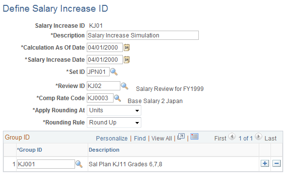

Define Salary Increase ID Page
Use the Define Salary Increase ID page (SALINC_ID_TBL_JPN) to define a salary increase ID and associate a rate code, which must be of class DFRPAY and of type Flat Amount, and worker groups with it.
You run the salary increase simulation by salary increase ID.
Navigation:
Compensation, and then Base Compensation, and then Percentage Increase JPN, and then Define Salary Increase ID, and then Define Salary Increase ID
This example illustrates the fields and controls on the Define Salary Increase ID page.
Field or Control Description
Calculation As Of Date
Enter the effective date that the system uses to determine from which job compensation record it should get the worker's current data to calculate new data. For example, if the worker's review band earns a worker a 6 percent increase, the system must get the existing rate code amount to calculate the new rate code amount.
Salary Increase Date
Enter the effective date of the new job record that the system inserts for the worker for the review-based increased amount. The action and reason are Pay Rate Change and Salary Increase by Percentage.
Comp Rate Code (compensation rate code)
Enter the rate code. It must be of the class Defined Range Pay (DFRPAY) and of the type Flat Amount.
You can add only one compensation rate code for each salary increase ID, and only one salary increase ID is associated with each simulation run. To run a simulation for a different compensation rate code, you must define additional salary increase IDs.
Note: You cannot have more than one rate code of class DFRPAY on a single worker's Job Data - Compensation record.
The process that populates the Salary Increase Simulation table includes all workers in the groups that you specify who have this compensation rate code as well as the currency code and frequency set in the Compensation Rate Code table for this rate code.
If you have changed the default currency code or frequency from that set on the compensation rate table in the workers' job compensation record, then those workers go into error and are not included in the simulation.
Apply Rounding At
Select the numerical "place" at which to apply the rounding rule you select.
Rounding Rule
Select the rounding rule for the simulation process based on this salary increase ID. Options are:
  • Round
  • Round Down
  • Round Up
Group ID
Enter the group IDs for the workers being included in this process.
You must enter at least one group ID to complete this process. If a worker in a group that you specify does not have the compensation rate code that you specified for processing, the system skips the worker without processing.
This salary update method retrieves the required percentage increase from the salary matrix table where you linked review bands to percentage increases, quartile by quartile.

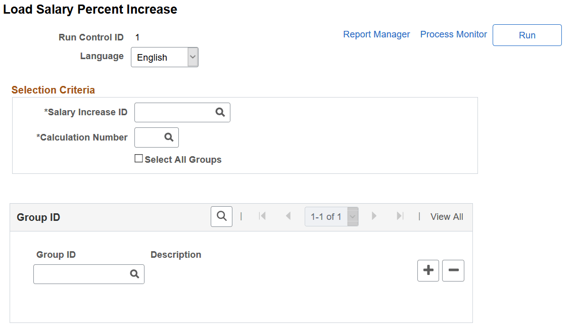

Load Salary Percent Increase Page
Use the Load Salary Percent Increase page (RUN_UP_SALINC_JPN) to update worker job compensation records with the results of the salary increase and adjustment results.
Navigation:
Compensation, and then Base Compensation, and then Percentage Increase JPN, and then Load Salary Percent Increase, and then Load Salary Percent Increase
This example illustrates the fields and controls on the Load Salary Percent Increase page.
Salary Increase ID
Enter the salary increase ID for which you ran the simulation and for which the results are to be loaded to worker job compensation records.
Calculation Number
Enter the calculation number of the particular simulation results to be loaded.
Select All Groups
Select to have the system populate the Group ID section with all the groups that you originally associated with this salary increase ID and calculation number combination.
Group ID
If you do not want to run the simulation for all the groups that you associated with this salary increase ID for this calculation number, deselect the Select All Groups check box and enter only groups that you want processed.
