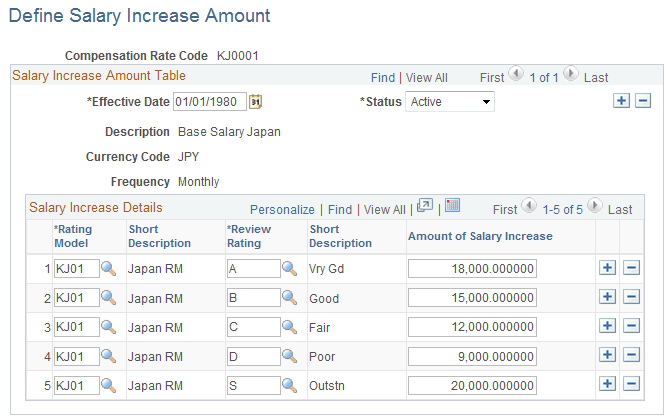

Define Salary Increase Amount Page
Use the Define Salary Increase Amount page (SALINC_AMT_TBL_JPN) to define the salary increase amount for a particular compensation rate code, rating model, and review rating.
Navigation:
Compensation, and then Base Compensation, and then Amount Increase JPN, and then Define Salary Increase Amount, and then Define Salary Increase Amount
This example illustrates the fields and controls on the Define Salary Increase Amount page.
Enter the compensation rate code whose value you are updating. The compensation rate code must not be of class SENPAY and must be of type Flat Amount.
Field or Control Description
Rating Model and Review Rating
Enter the rating model and review rating for which to enter a salary increase amount.
Amount of Salary Increase
Enter the amount of the salary increase for workers whose review results put them in the rating model that you specified.

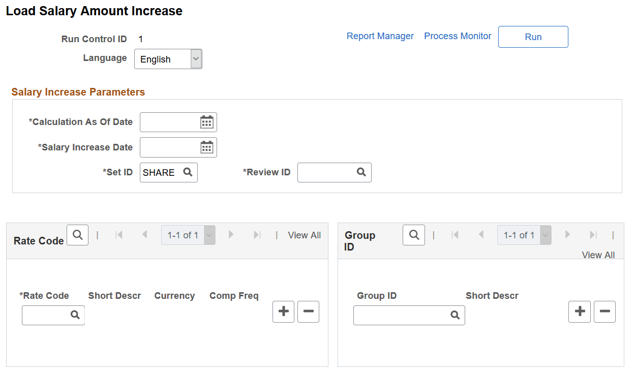

Load Salary Amount Increase Page
Use the Load Salary Amount Increase page (RUN_UPSALAMT_JPN) to run the salary update process using the values that you set up in the Sal Inc Amount table.
Navigation:
Compensation, and then Base Compensation, and then Amount Increase JPN, and then Load Salary Amount Increase, and then Load Salary Amount Increase
This example illustrates the fields and controls on the Load Salary Amount Increase.
Calculation As Of Date
The effective date that the system uses to determine from which job compensation record it should get the worker's current data to calculate new data. For example, if the worker's review band earns the worker an increase, the system must get the existing rate code amount to calculate the new rate code amount.
Salary Increase Date
Becomes the effective date of the new job record that the system inserts for the worker for the review-based increased amount. The action and reason are Pay Rate Change and Salary Increase by Amount.
Rate Code
Enter the rate codes for which you defined a salary increase to include in this load process. The system displays the short description, currency, and compensation frequency associated with each rate code.
Note: You defined your salary increases by compensation rate code and review band. You can run the process for multiple rate codes.
Group ID
Enter group IDs for workers to be included in this process. Leave this blank to have job compensation records updated for all workers who have the rate code that you specified. If a worker in a group that you specify does not have the compensation rate code that you specified for processing, the system skips the worker without processing.
