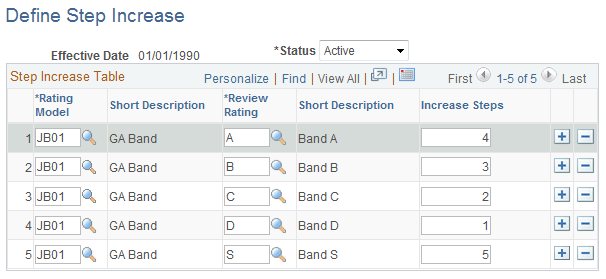

Define Step Increase Page
Use the Define Step Increase page (STEPINC_TBL_JPN) to associate several salary step increases with a rating model and review rating.
Navigation:
Compensation, and then Base Compensation, and then Step Increase JPN, and then Define Step Increase, and then Define Step Increase
This example illustrates the fields and controls on the Define Step Increase page.
Field or Control Description
Rating Model and Review Rating
Enter the rating model and review rating.
Increase Steps
Enter the number of salary step increases to associate with the rating model that you entered. Workers in this rating model receive the salary that is associated with the step to which they move. For example, if they increase three steps for being in Rating Model A, then they increase from the salary for Step 2 to the salary for Step 5.
