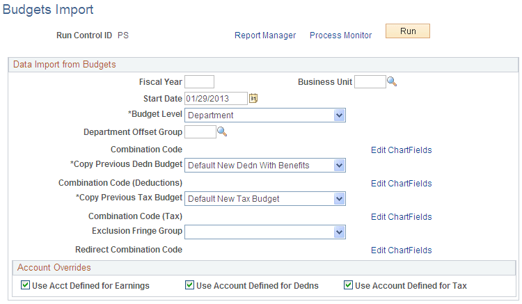

Budgets Import Page
Use the Budgets Import page (RUNCTL_BUD008) to run the Data Import from Budgets (BUD008) process, which downloads fiscal year budget information from PeopleSoft Budgets to PeopleSoft HCM.
Navigation:
Set Up HCM, and then Product Related, and then Commitment Accounting, and then Process Budgets, and then Import Data From Budgets, and then Budgets Import
This example illustrates the fields and controls on the Budgets Import page.
Budgets Import page
Field or Control Description
Fiscal Year
Enter the fiscal year for the budget information you want to import. The year you enter is the fiscal year of the budget you are creating with this process.
Start Date
Enter the date that starts the fiscal year budget you are creating with this process.
Budget Level
Based on the Budget Level you specify, the system combines appointment and position data and creates a budget at appointment, position, position pool, or department levels.
  • Appointment: Creates a budget at the appointment (or job data) level, as well as an overall department budget. If data is provided for a blank or invalid employee ID, the process won't create an appointment budget but instead adds the budget dollars to the department level budget.
  • Department: Creates a budget at the department level only. The system automatically creates a department level budget regardless of the budget level you choose (that is, appointment, department, job code, position, and position pool). By selecting Department, you are asking the system to create only an overall department level budget.
  • Jobcode: Isn't supported by Data Import from Budgets process. If you select this option, the system displays an explanatory error message.
  • Position: Creates a budget at the position level (including unoccupied positions), as well as an overall department budget. If data is provided for a blank or invalid position number, the process won't create a position budget but instead adds the budget dollars to the department level budget.
  • Posn Pool (position pool): Creates a budget at the position pool level, as well as an overall department budget. If data is provided for a blank or invalid position pool ID, the process won't create a position pool budget but instead adds the budget dollars to the department level budget.
Note: Although a budget level determined by job code exists within the Department Budget table in PeopleSoft HCM, the Data Import from Budgets process won't combine appointment or position data into a single job code budget.
Department Offset Group
Enter the default department offset group. If previous budget data exists for a department, the system obtains the department offset group from that budget. However, if a previous department offset group can't be selected, the system uses this default value.
Combination Code
Select the combination code to be used as the default if there are blank or invalid earnings combination codes in the input budget data.
Select the Edit ChartFields link to search for an existing combination code or select a unique combination of ChartFields on the ChartField Detail page.
See Application Fundamentals: Editing ChartField Combinations in HCM Transactions.
Copy Previous Dedn Budget (copy previous deduction budget)
Select Copy Previous Dedn Budget (copy previous deduction budget) to copy previous deduction information for each department budget processed and for each budget created at the appointment, position, or position pool levels. Select Default New Dedn No Benefits or Default New Dedn With Benefits to assign 100 percent of the deduction budget to the Account Code (Deductions), described next.
Combination Code (Deductions)
Select the combination code (deductions) to be used as the default if there are blank or invalid deductions combination codes in the input budget data.
Copy Previous Tax Budget
Select Copy Previous Tax Budget to copy previous tax budget information for each department budget processed and for each budget created at the appointment, position, or position pool levels. Select Default New Tax Budget to assign 100 percent of the tax budget to the Account Code (Tax), described next.
Combination Code (Tax)
Select the combination code (tax) to be used as the default if there are blank or invalid tax combination codes in the input budget data.
Exclusion Fringe Group
Select a group of fringe expenses that should not be funded by the earnings combination code. If you leave this blank, all fringe expenses are funded by the earnings combination code unless a tax or deduction override combination code is specified for a particular fringe expense.
Redirect Combination Code
If you have specified a fringe group, you can select a combination code to fund the fringe expenses included in the selected group.
Account Overrides
Use Acct Defined for Earnings, Use Acct Defined for Dedns, and Use Acct Defined for Tax
Select to enable account mapping for earnings, deductions, or taxes. The Actuals Distribution will use the account mapping you set up on the account mapping tables to map earnings, deductions or taxes to a different account than the one associated with the specified combination codes.
Run
Select to run this request.
