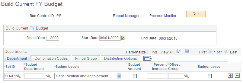

Build Current FY Budget Page
Use the Build Current FY Budget (build current fiscal year budget) page (RUNCTL_BUD005) to create a budget for the current fiscal year.
Navigation:
Set Up HCM, and then Product Related, and then Commitment Accounting, and then Process Budgets, and then Build Current FY Budget
This example illustrates the fields and controls on the Build Current FY Budget page.

The Build Current FY Budget process enables you to specify which Department IDs the system should use and to establish budget information in your human resources system.
Field or Control Description
Fiscal Year
Enter the fiscal year of the budget you are creating.
Start Date and End Date
Enter the fiscal year's beginning date. The system then calculates the End Date by adding 365 days to the Start Date you enter. (If February 29th falls within your budget year, modify the Structured Query Report (SQR) program file to set the Dayinyear variable to 366.)
Run
Select to run this request.
Department
For each department, enter a SetID and the following information:
Budget Department
Select the department for which you are creating a fiscal year budget.
Budget Levels
Enter a budget level for each department. Budget levels control how the Build Current FY Budget process runs, which data the system uses, and how the resulting data appears in the Department Budget component. Select a Budget Level number:
  • Position and Appointment: The system looks at all job records (in order of position number) for the selected department for the fiscal year.
    If a position is specified and the Position Override check box is deselected on the Job Data − Work Location page, the system lists the information at the position level. If a position isn't specified on the Job Data - Work Location page, then the process lists information at the appointment level. Once all job records have been processed, vacant positions are listed at the position level.
  • Dept, Position and Appointment: The process works the same as with Position and Appointment, except that it also creates a department level budget using the specified earnings combination code.
    If you select Budget Amount (see next field), the system calculates the budget amount and overall cap in the Department Budget component by adding all position and appointment level entries.
  • Department Only: When selected, this value creates only a department level budget using the specified earnings combination code.
    If you select Budget Amount (see next field), the system calculates the budget amount and overall cap in the Department Budget component by adding all position and appointment level entries. If Budget Amount isn't selected, the system creates a department level budget without a budget amount and overall cap. Additionally, the system sets the percentage of distribution to 100 percent and uses the combination code you specify on this page.
  • Department and Position: When you select this value, the system looks at the department's position records (not at the appointment records) to create a position level and a department level budget as in Dept, Position and Appointment. Use this option only if all appointments have positions.
  • Department and Position Pool: If you select this value, the system looks at the position records associated with the selected department. Use this option only if all appointments have positions. The system looks first at positions attached to position pools and creates a position level budget. It then summarizes the remaining positions.
    If you select Budget Amount, all positions within the department (whether or not they are associated with a position pool) are reflected in the Budget Amount attached to the department level budget. Although a position level budget isn't created, all positions associated with the selected department are included in the department level budget.
Budget Amount
Select to establish dollar limits for a particular budget level. If selected, the system populates the Budget Amount field on the Department Budget Earnings page. The sum of the budget amounts for each budget level appears in the Budget Level Cap field.
If Budget Amount isn't selected, the system populates the percent of Distribution field on the Department Budget Earnings page and sets the Budget Level Cap to zero.
Percent Increase
If you select the Budget Amount check box, specify a positive or negative percentage in the Percent Increase field. The system uses the percentage you enter to increase or decrease the calculated salary before populating the Budget Amount and Budget Level Cap fields on the Department Budget Earnings page.
Offset Group
Enter an offset group to specify an offset combination code to be used for each type of transaction.
Budget Leave
Select if you want to include employees on leave without pay. The system treats them as if they were active employees. Select this option if your organization "backfills" for employees on leave. Organizations that backfill count the salaries of employees on leave with the assumption that they need a substitute person in that position.
